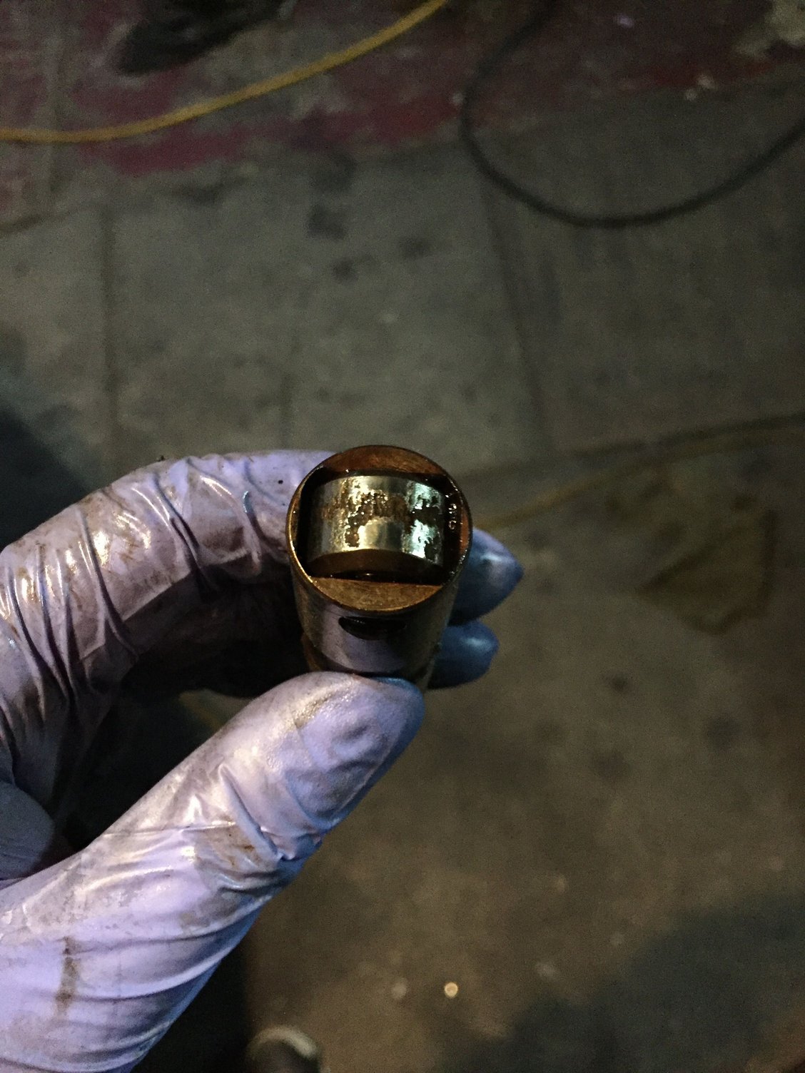

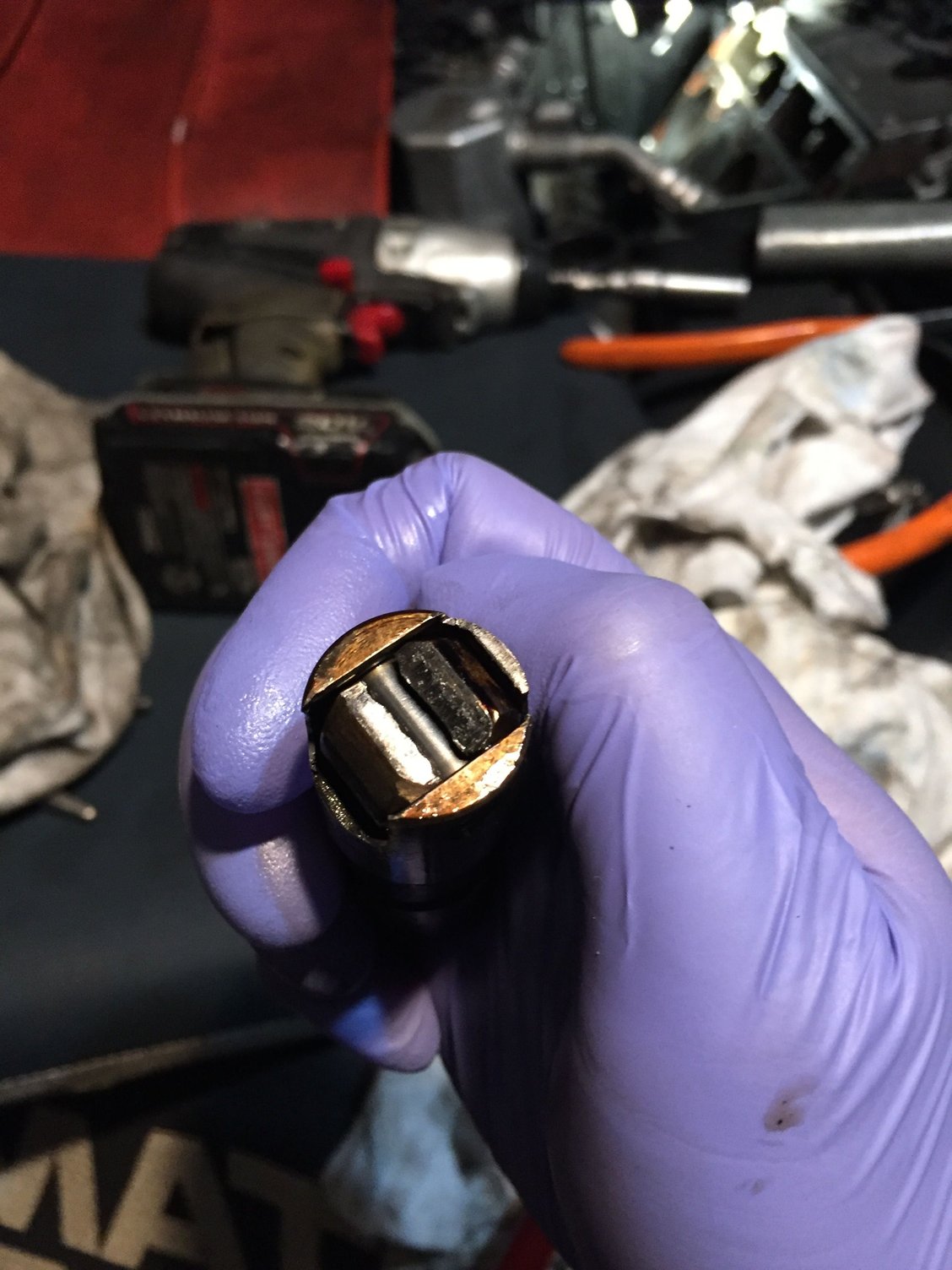

got the car running... driven it for almost 400 miles with new ls7 clutch, but before i got it to run i had issues.
wow so i basically just swapped the ls1 accessories and cam and took me about 7 days to do everything from dropping the k member getting the clutch to come in during the holiday rush from black friday and getting the car to start... super exited because wanted to drive the car beginning of December.but when i started lifters was all bad knocking like crazy so i cut it right away... and i remembered when i pulled the lr4 cam i didnt look at it cause it was dark and getting late when i pulled it... come to find out the were groves on the cam smh
so now i had a decision to make either drop the kmember again to pull the heads out; glad i ended up just pulling it from the top its was a mess and it was harder but again this is my first 4th gen dropping kmember and doing first time doing cam head swap ect kinda learning as i go. I believe i was also being cheap about the head bolts because i didnt want to buy them in the first place and assuming the $400 motor i bought was a steal but i guess why they pulled it in the first place. Luckily, i had the ls1 motor still down the st cause i gave it to a buddy he wanted the crank so gave him the whole motor one rod was bent and the block went through so no need for it. I went back and took out all the lifters and installed them in the lr4.
Now finally after 3 days pulling heads waiting for bolts and gasket to ship to me from summit got the car running, drive it for 100 miles then torque arm bracket bushing come out the tranny making rear end noises thinking its the rear end
i fix it then the dam radiator starts leaking crack somewhere man one thing after another with this car. I felt like this car was suppose to be an easy swap not a project like my 67, and 69 camaros that i dropped an ls1.
Right now its running great still breaking in the clutch, I just replaced the D window motor, new thermostat and radiator. i still need to change the crack windshield and tires soon.
I just want to thank everyone that helped out in the process of this car i got oh i forgot threw a code the other night also p0410 but i deleted it and hasnt come back on i hope it doesn't come back on cause i need to get the car smogged soon.
going to attach photos of those lifters i pulled after i first started the car
