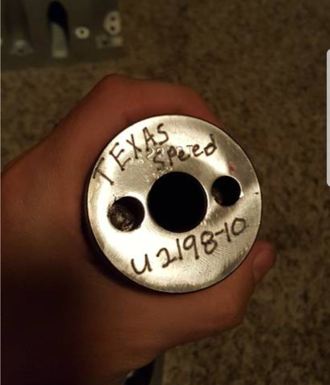

Can anyone help identify this cam??

I have a feeling Texas Speed would know...

Yeah since it says Texas Speed right on it, your work looks pretty simple and cut out for you

I sent Texas speed a message but haven't heard back from them. I was hoping somebody here might know.

That's a Comp Cams serial number. It has to be looked up at Comp, but I just sent them a message asking what it was. I'll let you know what they say.

It's a 228/236 .588/.601 117+4
