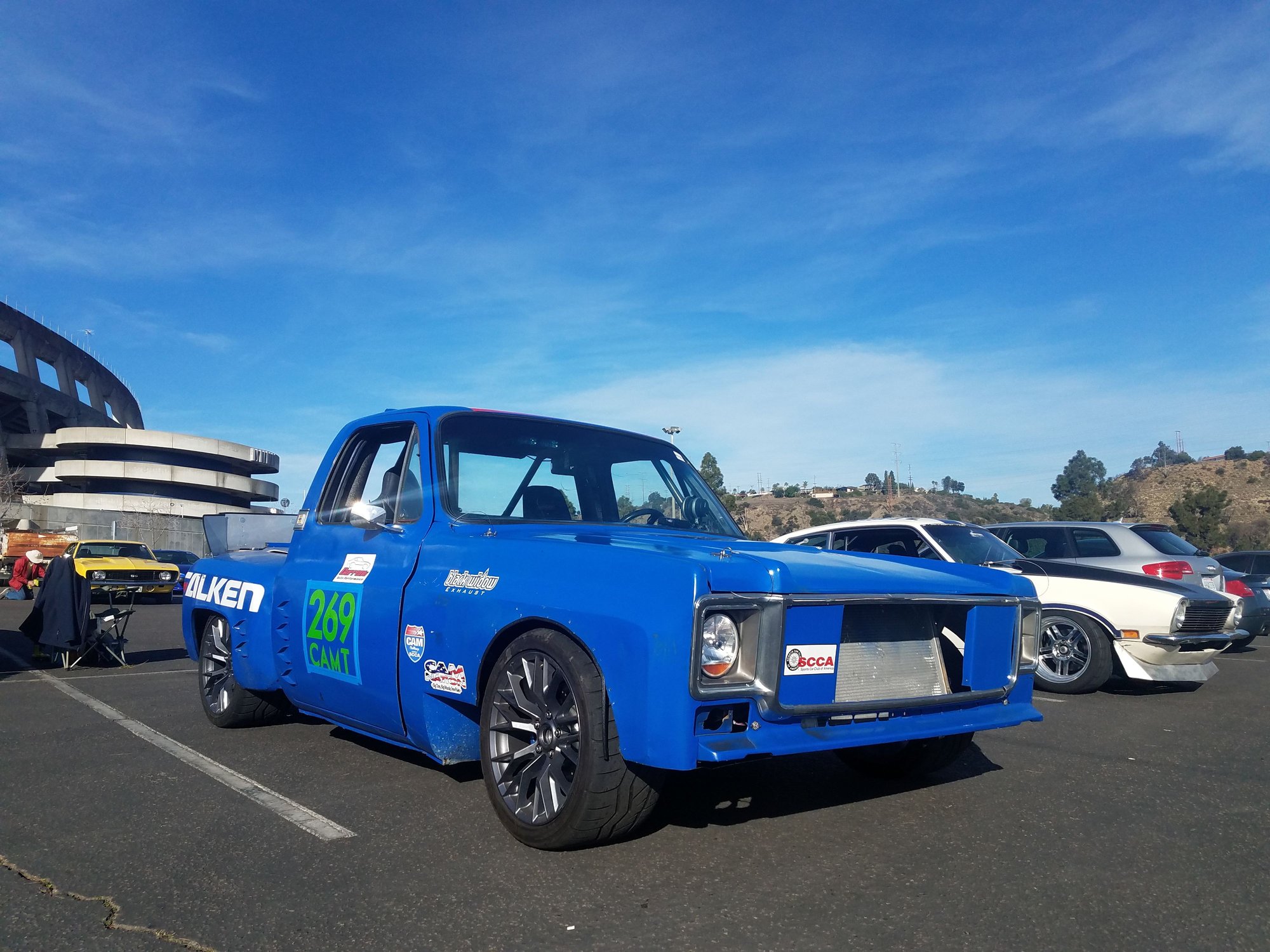

A little background. This engine is going in a 3100 pound race truck which is solely purposed for autocross. I currently have a 5.3l and z06 cam and want more torque over a broad powerband.
enter a 6.0l short block. I have a spare set of 862 heads in a drawer. I know the intake valve and shrouding issue. I also have ls1 2" intake valve to throw in these heads. I plan to to a mild polish job have get a vavle job to cut in the 2" intake valves. Also sitting on the shelf is a nnbs intake and 87mm tb. I was planning a l33 build but i found a good deal on a 6.0 short block. Im thinking with a mild mill of .020 or .030 and sometging like a mild ASA cam i should have a decent motor. My main questions are can i mill .020 or .030 and be ok with an ASA cam? Is there a better budget friendly cam? Im building mainly from craigslist parts so used is my best freind. Thanks in advance.

There's a few ways around the reluctor like running the pcm for the motor you buy, conversion boxes, swapping the reluctor itself on the crank, swapping cranks.. whatever it is I would want the gen 4 6.0 over the old one, less likely to need as much rebuilding etc and will come with either the newer cathedral intake or will come with square port heads and awesome intake. (I know you said you already have one) but the new stuff is better than the old and the gen 4 rods will be happier at high rpm
I think you're on the right track with the plans and I love the truck man
Tell us more about it though, auto or stick? If auto whats the stall? Gears? Do you mainly stick it in one gear around the track? What rpm range do you need peak power?
Is a 6.2, or any other aluminum block used motor out of the budget?
You should be okay to mill with the ASA cam, but we really need to know if the block will have flat top pistons or dish, if you mill 862's and have flat tops compression is going to be approaching 12:1 and that will need to be strongly considered for fuel and the cam
