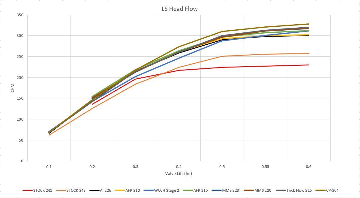

So this is just a little chart I have been adding to over the last year as I see head flow numbers and new ones show up. Obviously flow numbers are like dyno numbers and are to be taken with a grain of salt but at least it's something to go off of.
