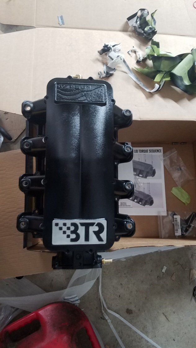

Looks like I'll be getting a BTR equalizer intake . Tried to find information on it and not a lot out there so I'll try it and see if it works

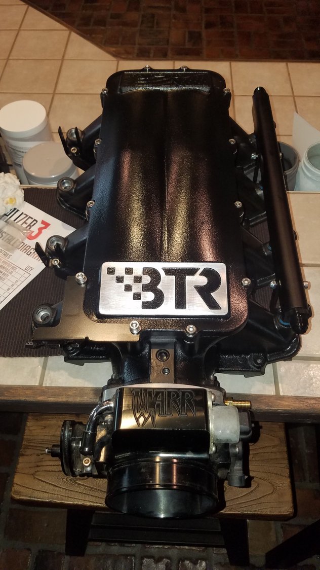

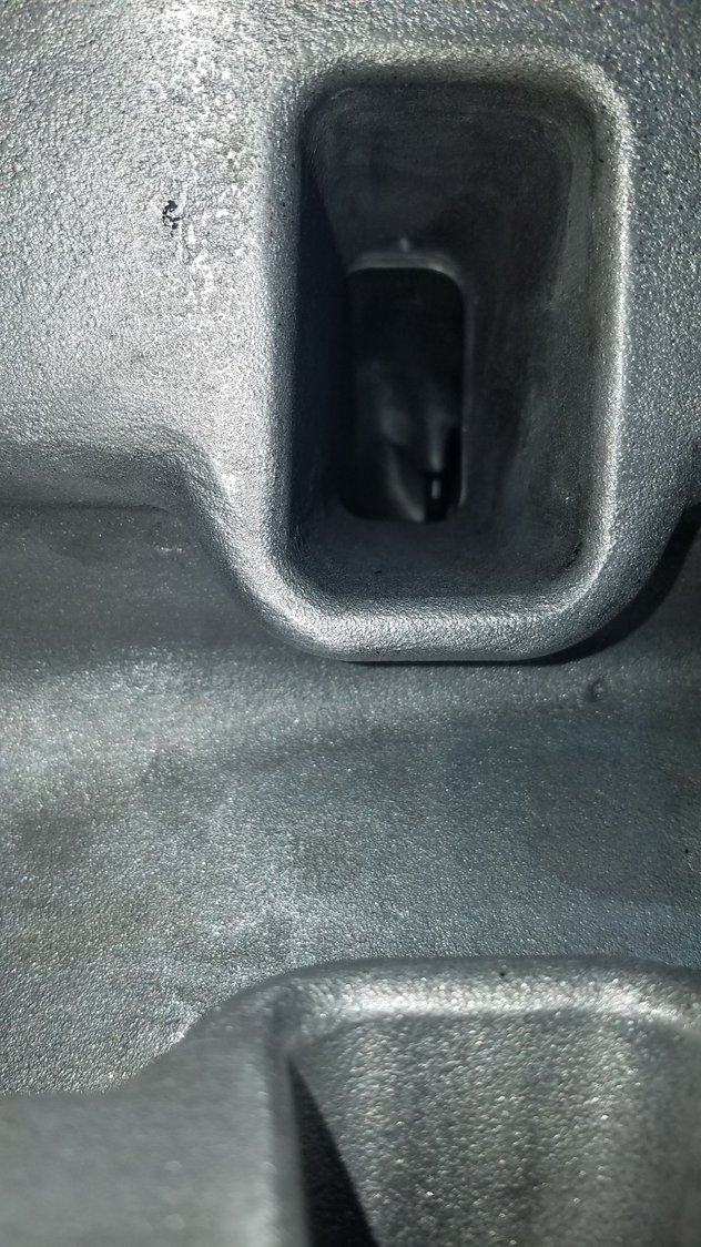

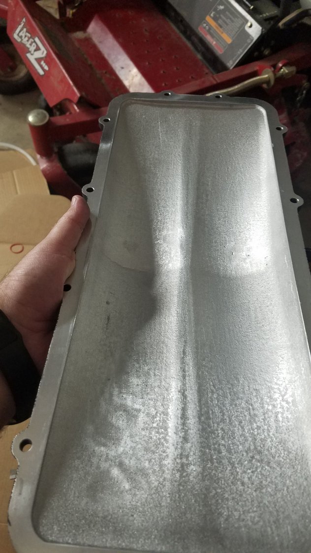

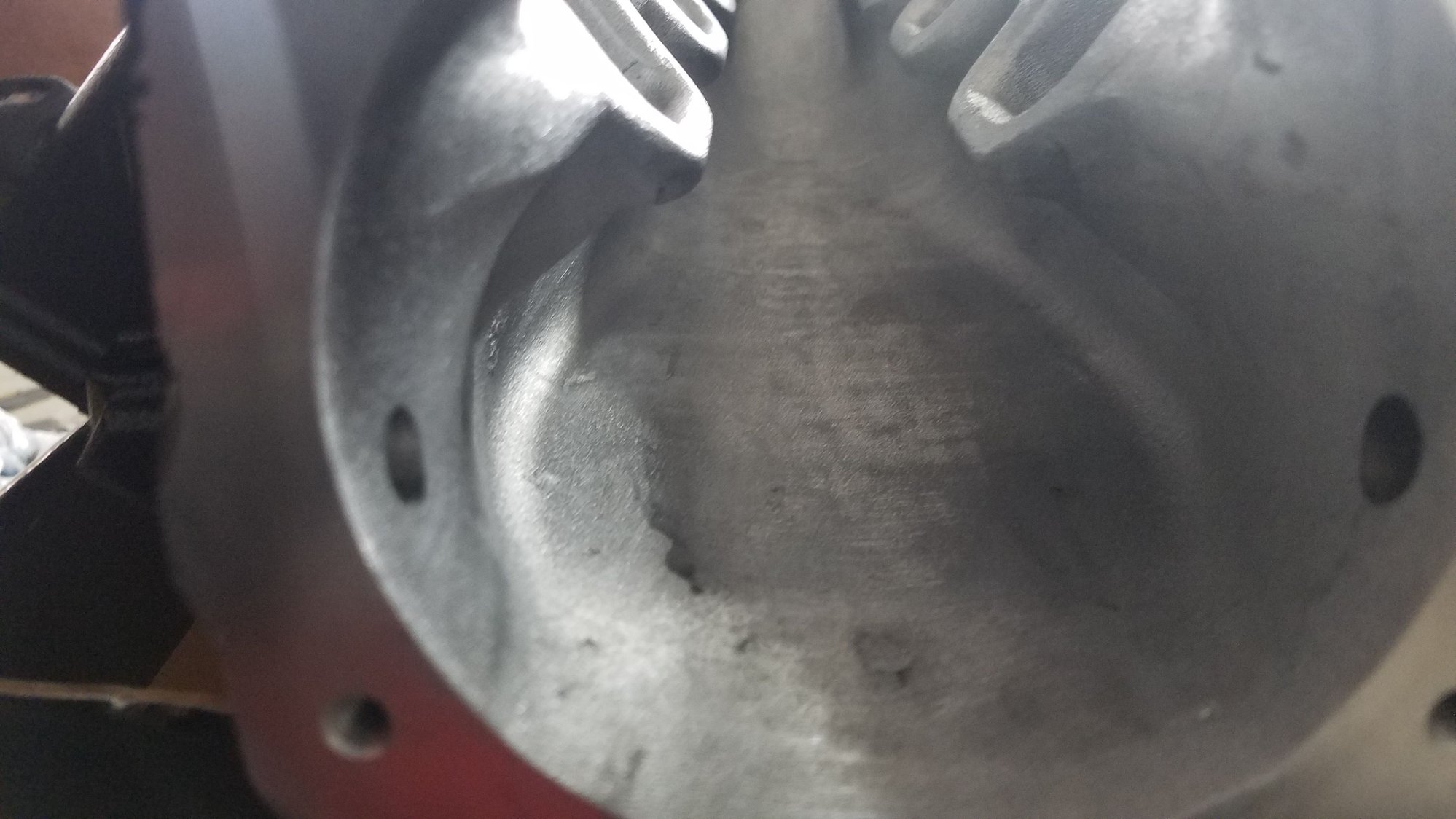

Btr intake is last horsepower mod for a while. It came in satin so I painted it up and hand sanded the inside with 60 grit then 180 grit to smooth it out some.
need new orings for injectors for ls3, and it will be going on soon. Once its street tuned I'll take it to Eps and throw it on the dyno to see how the shape of the curve looks

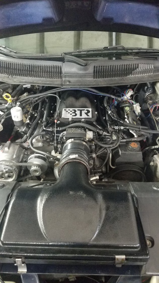

Its on and running. Got to figure out my vacuum pump issue,then I'll be scheduling a dyno

Nice clean install, mang!

thanks. Honestly I get frustrated with how cluttered it is trying to retain every thing that came on the car

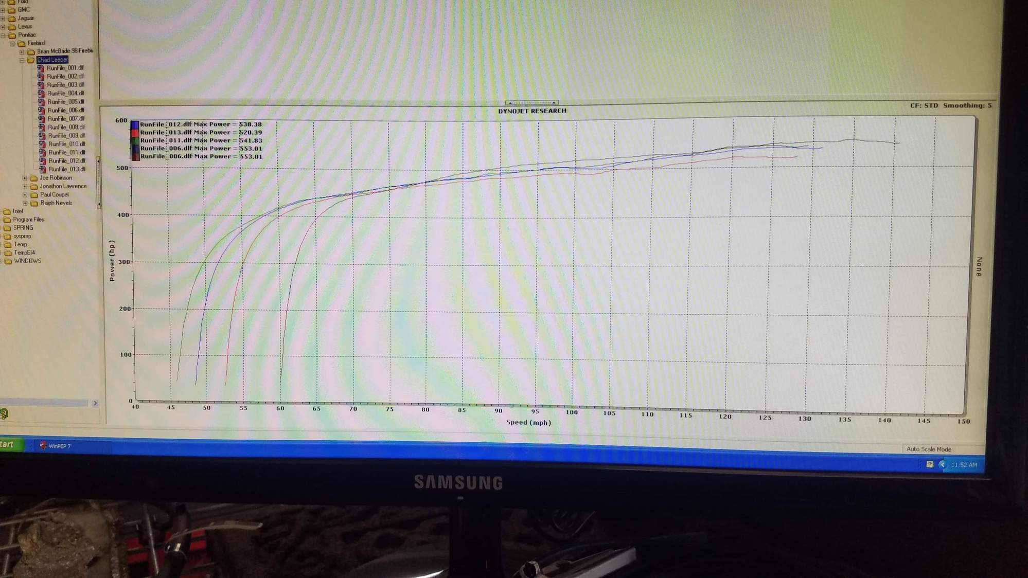

Dyno tomorrow with the 2" headers and BTR intake. Motor should pick up but it's hard to say what it will show as since last time on the dyno , I also changed the electric water pump for a stock water pump, converter got loosened up as well. But motor also broke in good.
really just want to see the shape of the curve.

yep. Shape of the curve was just like the sniper.
made a little less but to be expected since I loosened converter up since.
553 rwhp with sniper with a 5500 stall and falling back 1800 on shifts. Electric water pump ,1-7/8" kooks headers and open 3"x18"long extensions to now
542 with stock water pump, 6000 stall that only falls back 1400 on shifts, 2" tsp headers, 3" speed engineering dual exhaust .
yesterday was raining and hot as hell,56% humidity and high 80's temperature.
last time was 23%humidity and low 70's on a clear day.
correction was on but still will effect it some.
Also note, when it dynoed 553,I was on 295x45x17 mt drag radial.
this time 275x40x17 Mickey Thompson street radial. 2" shorter tire. So the curve shuts off sooner based on mph.
geoffs signal was cutting off on rpm so that curve looked crazy but we were shutting off at 7900

That bottom line was me turning the meth kit on to see if it wanted it with more timing. Lost 20hp with winter grade washer fluid vs e40.
make that note too. Car was on 93 when I dynoed last year.
on e40. Yesterday.
it does not need e40 so this also could have cost a few hp

Full dual exhaust vs collector extensions and EWP vs mechanical... I'd say you were making about the same all things considered if not a little more at the flywheel than before.
The sniper low pro continues to be a bit of a sleeper intake...gets a bad rap but on the right combo the thing works pretty well.

I agree,the sniper works well . However it developed a fuel rail leak and Holley sent me a new set of rails 2 years later which was awesome. But I figured while I had new rails to offer with the intake, I'd sell and get the btr.
btr quality is nicer , easy to install and get to the fuel injectors when needed.
I feel ill go quicker than I have before so I'm happy with it.
later when I decide to get after market heads ,the btr will get port matched and have it worked over as well. Mostly why I swapped. In preparation for better heads later
