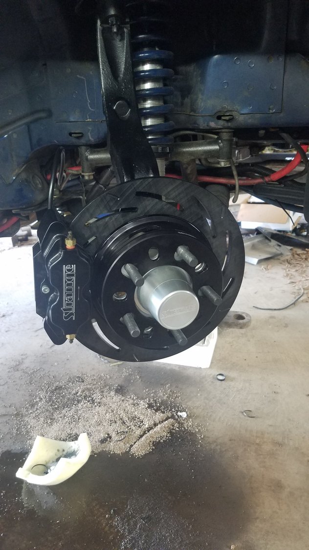

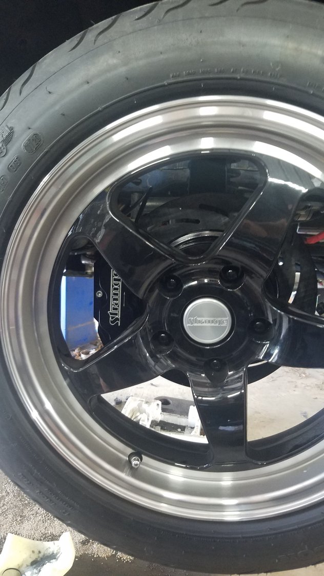

then purchased some strange front brakes from Madman. Strange pro2 kit for my car since its heavy and a street car. Thicker calipers and better suited to the heat.
32 lbs off front of car and a huge drop in drag from stock to these. Stock would barely turn without me continuing to turn by hand on a lift. Strange will spin freely 7 to 8 full rounds with out much effort . Well worth the swap . My forgestar center cap wouldn't fit so luckily the strange dust cap looks good

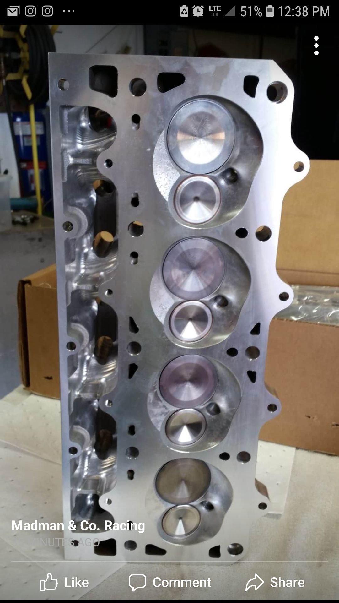

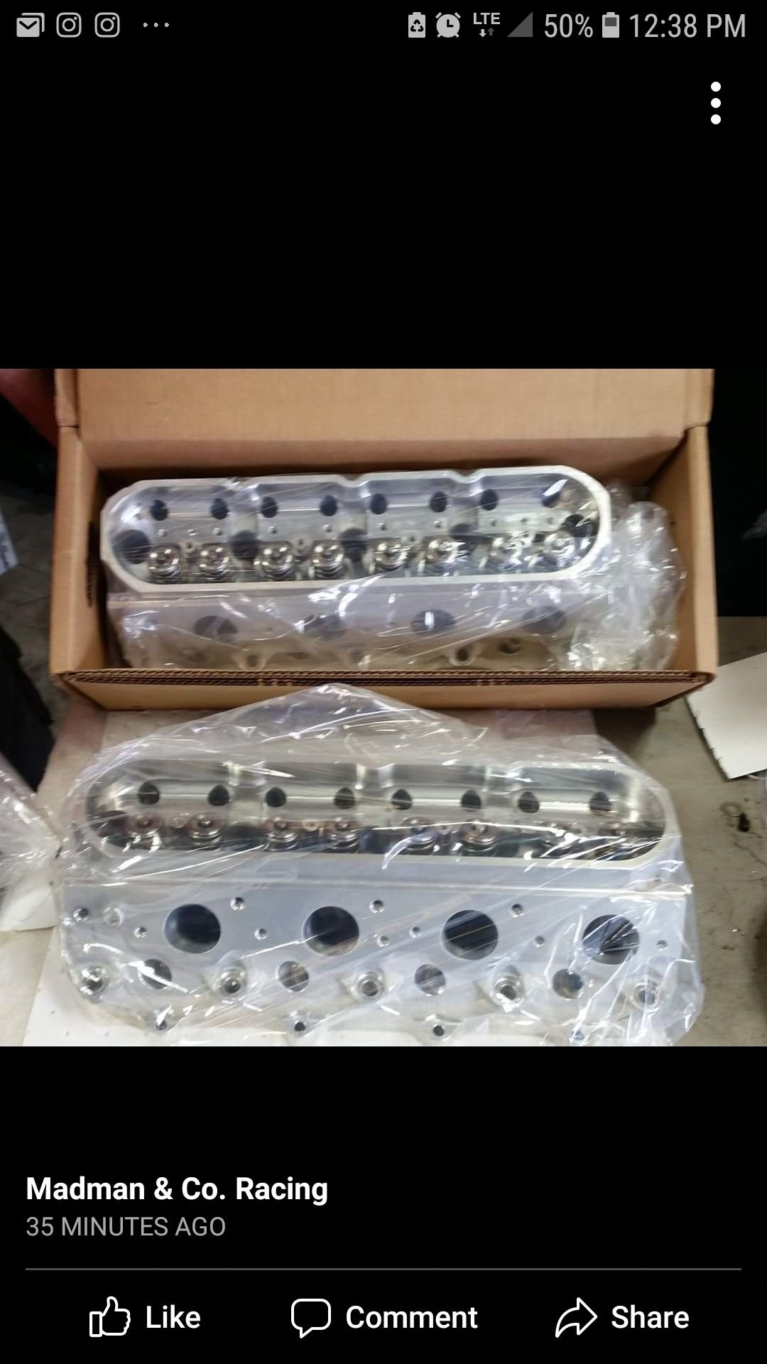

Looks like I will most likely be using my BTR intake with CBM adapters to the Ls7 heads.
Carbuff on here used them on his set up and still made really good power with the same intake on his mamo ls7 heads over his Frankenstein ported trickflow ls3 heads . 53more horsepower and 15 rwtq so going to use what I have to start and see what it does.
I am going to take advantage of the 6bolt block and heads so I ordered 6bolt cometic. 040 gaskets and an arp head stud kit for the Dart Block.
when I get the old heads off I plan to cc the chamber and verify what my compression was, it seems it is something between 11.0 and 11.6 .
going up to 12.26 with ls7 heads so I believe that my same cam will give me the rpm I need and also add tq everywhere from the DCR bump.

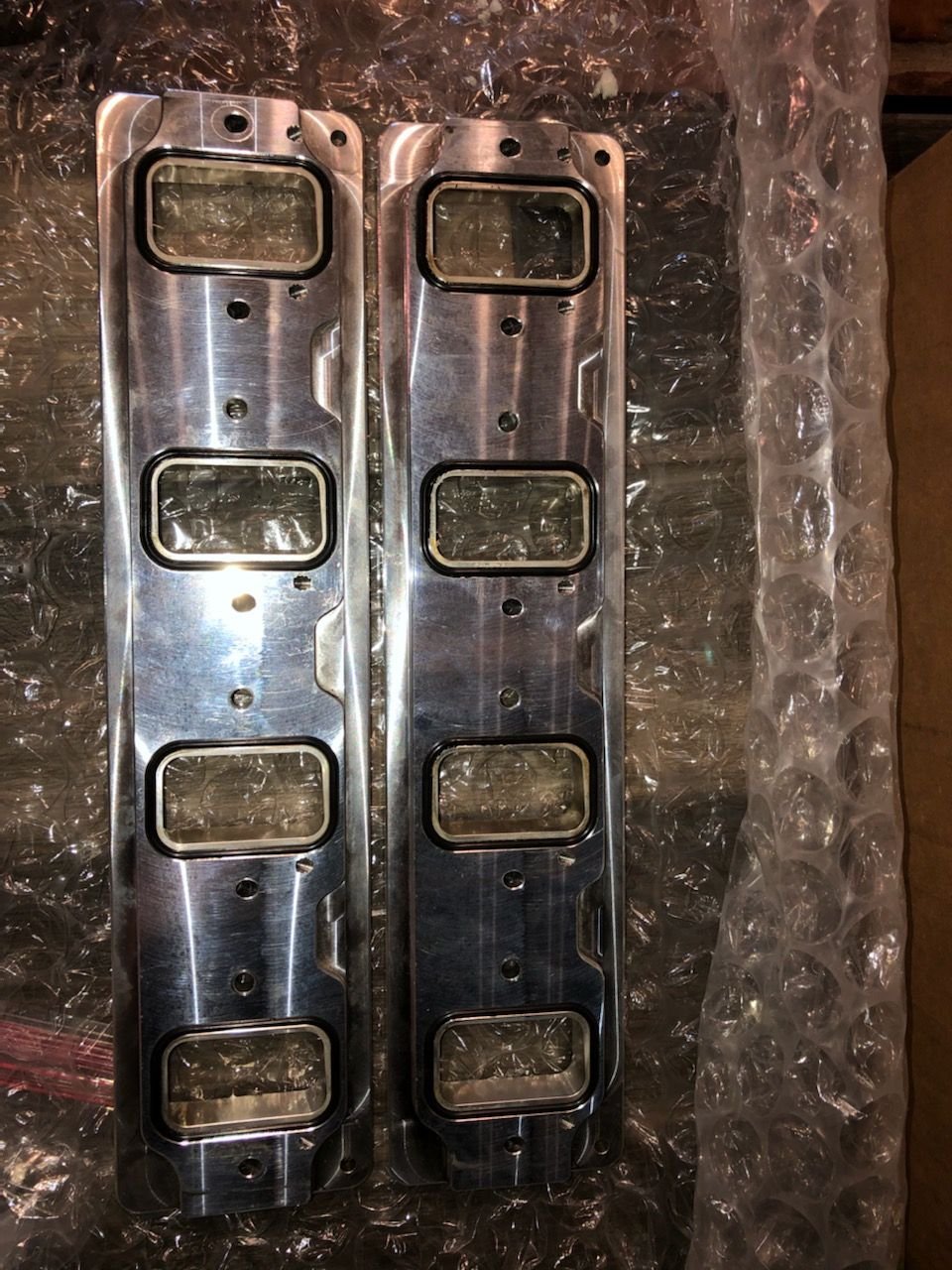

I purchased these ls7head to ls3 intake adapters from a member here. Thanks Carbuff (Bryan)
I will be running my BTR intake. Plan is to flow the new heads with and without the adapters to see what effect they have. Probably be next Wednesday or Thursday doing that.

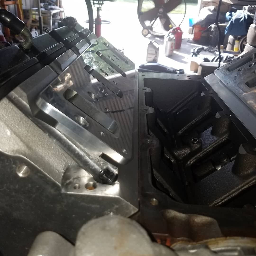

Cbm adapters bolted on to the heads to use my btr ls3 intake with ls7 heads.
not to bad but will get port matched

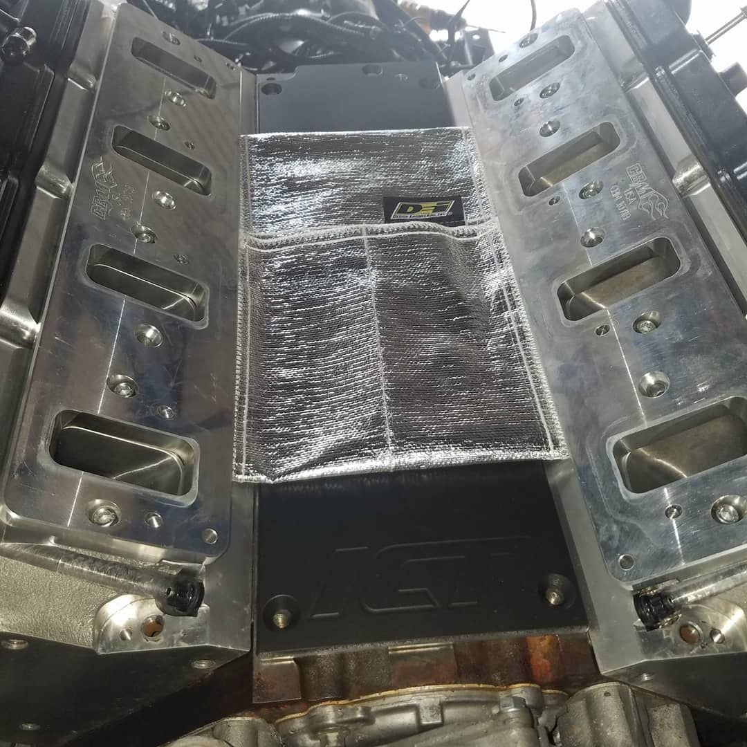

Heads are swapped, this time using 6 bolt per cylinder stud kit to keep the gaskets sealed.
. Verified cc of old heads and they were not 63 like id asked. They were 66.5cc. This dropped the compression from 12.08 to 11.59. Now im going to 60 cc which is 12.49.
. Cerekote my headers and valley cover, added a starter heat wrap under the intake also to reduce heat getting in to my intake.
waiting on new pushrods to deliver today so I can set the valves then I can wrap it up.
