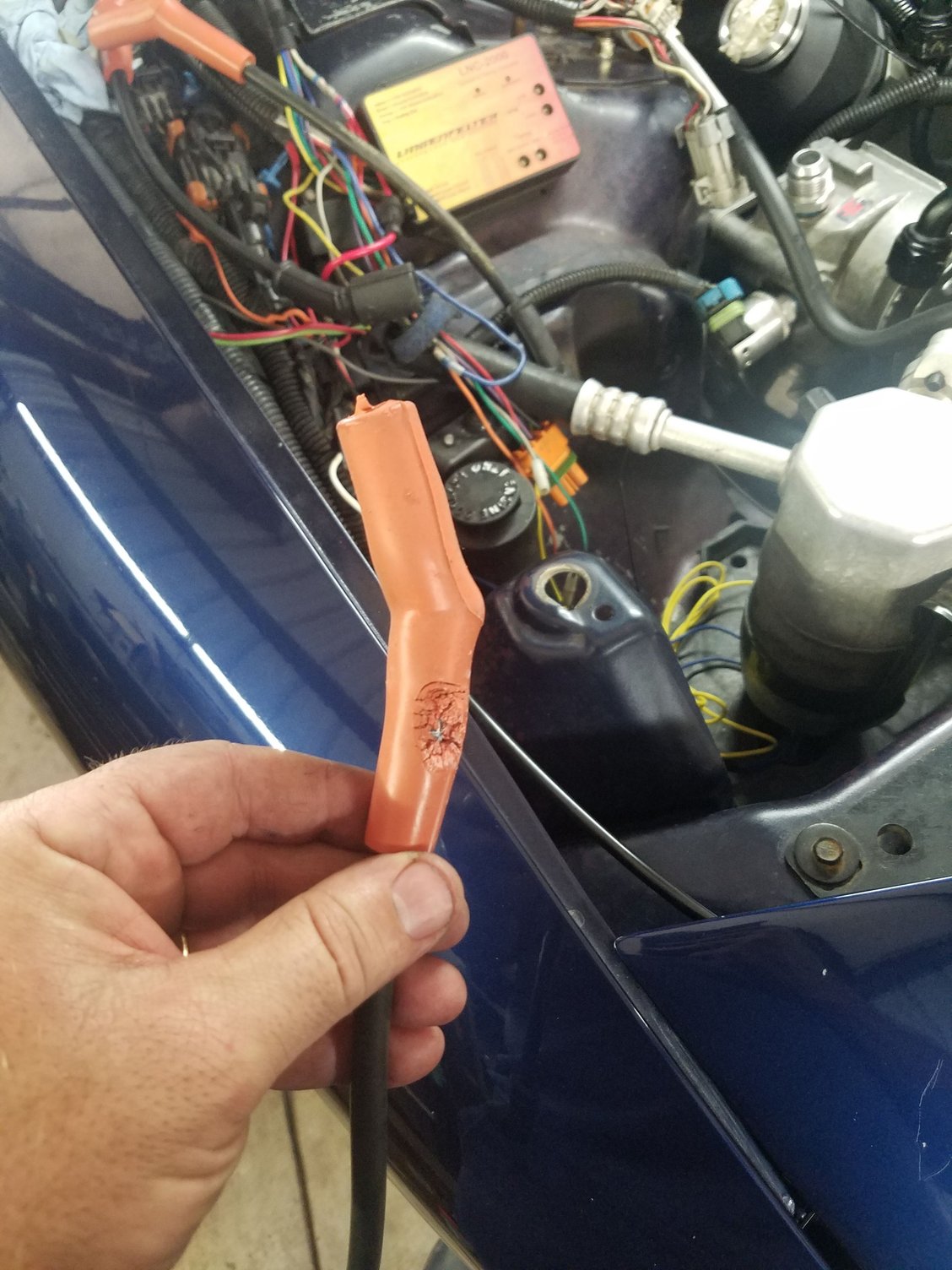

Figured I'd do an update. I got my plug wires back from Firecore and put them on, put new tr6 plugs in and running good. There is still some issues like header bolts backing out and my exhaust pushed off yesterday. Fixed that and went out driving and tuning yesterday. I have ltft's dialed in to within 2% so I'm happy with that.

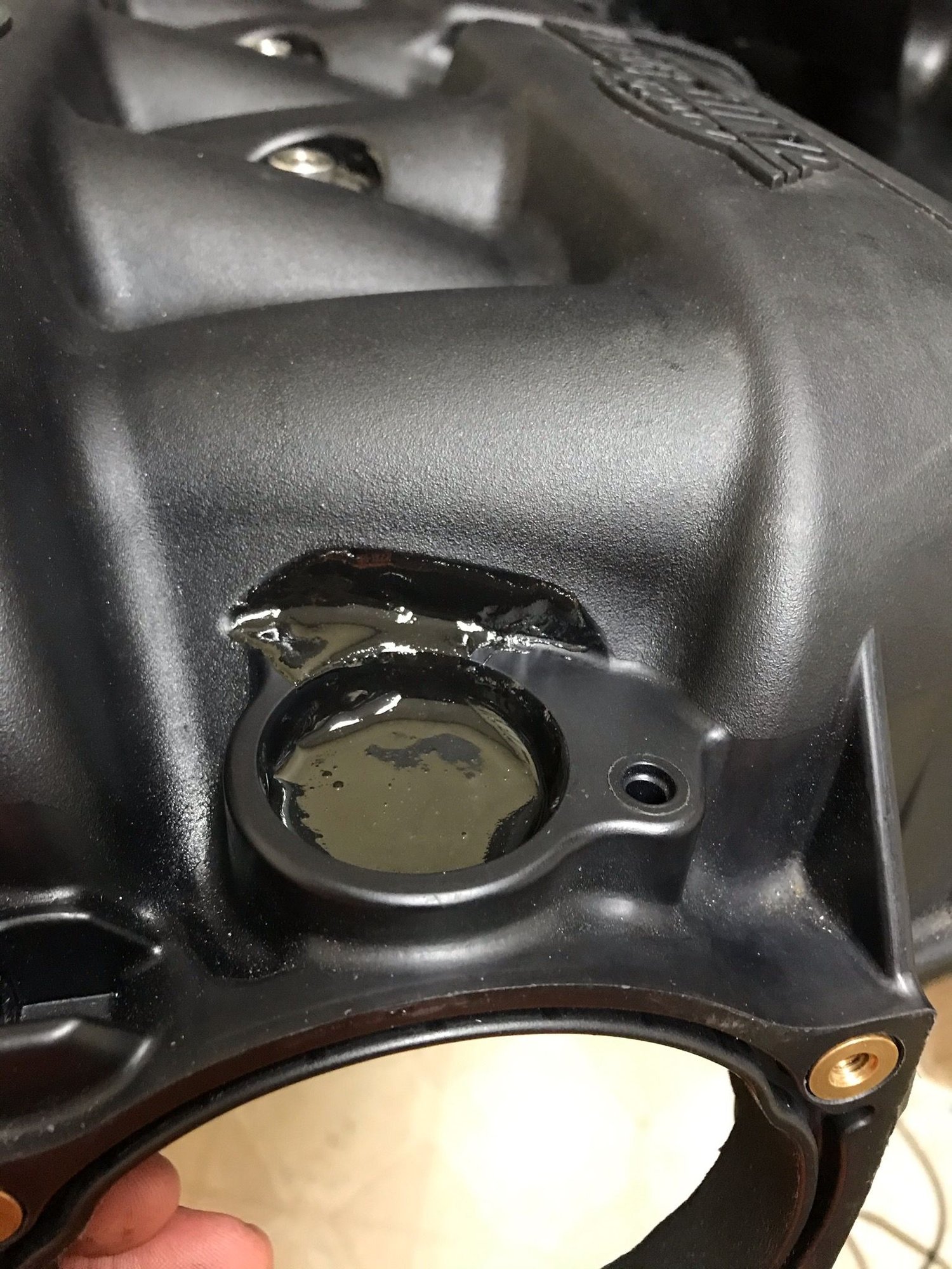

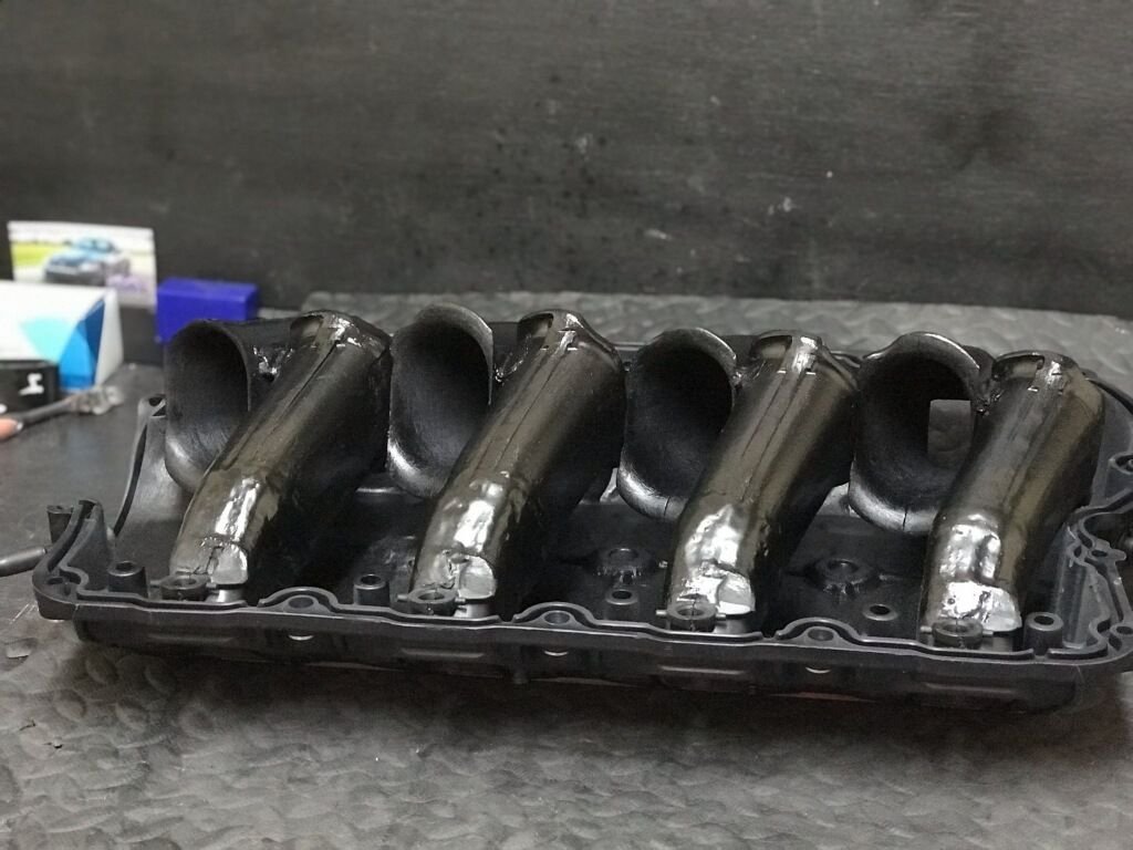

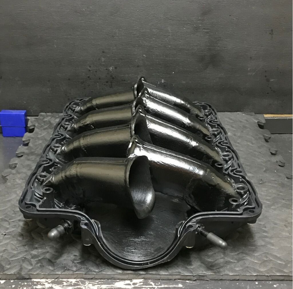

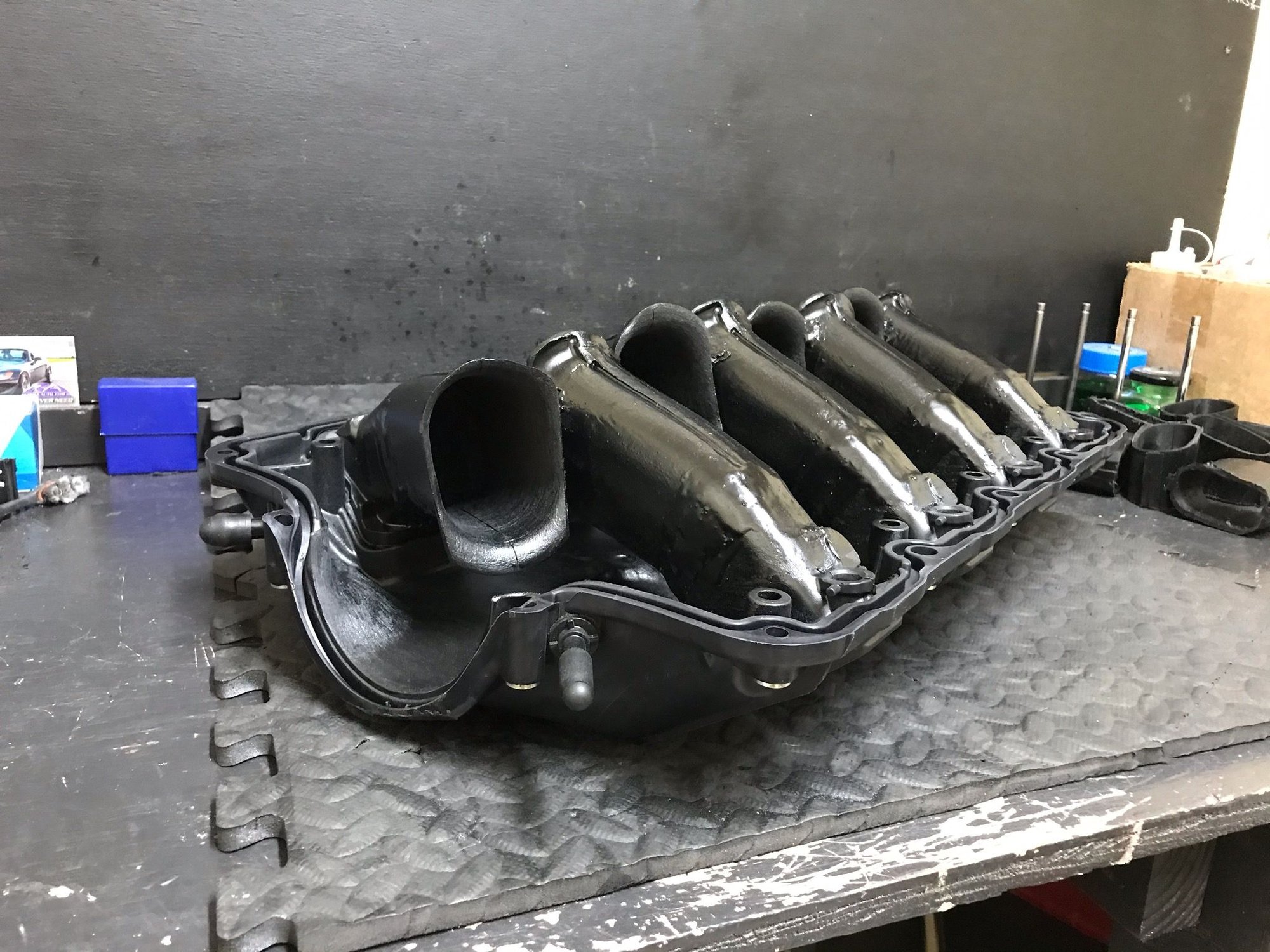

Update on cutting the runners. BRENTON done a great job with them. He cut them down to 6.75" long . Car is running with the intake back on, I do have a coolant leak on a steam port on passenger rear of head. I'll have to lower the k member down and see if I can reach it or pull intake back off.
anyone needs any port work done,I highly recommend Iron mask airflow innovation. Very meticulous with his work and puts a lot of time in doing it right.

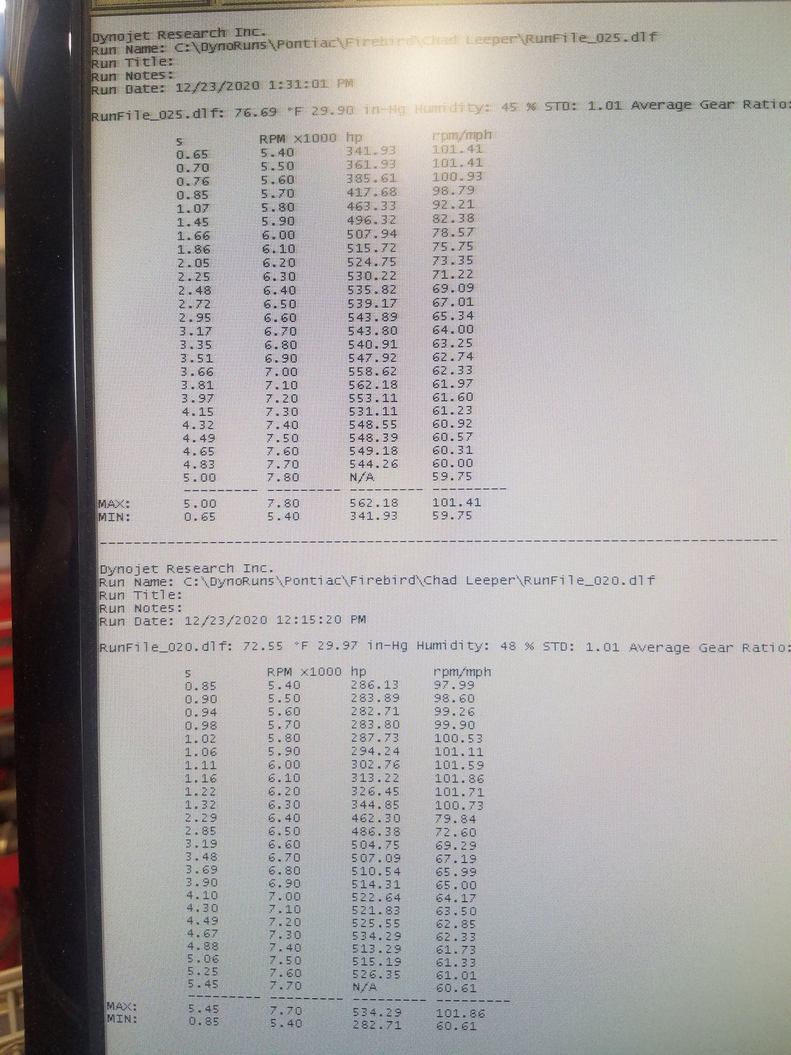

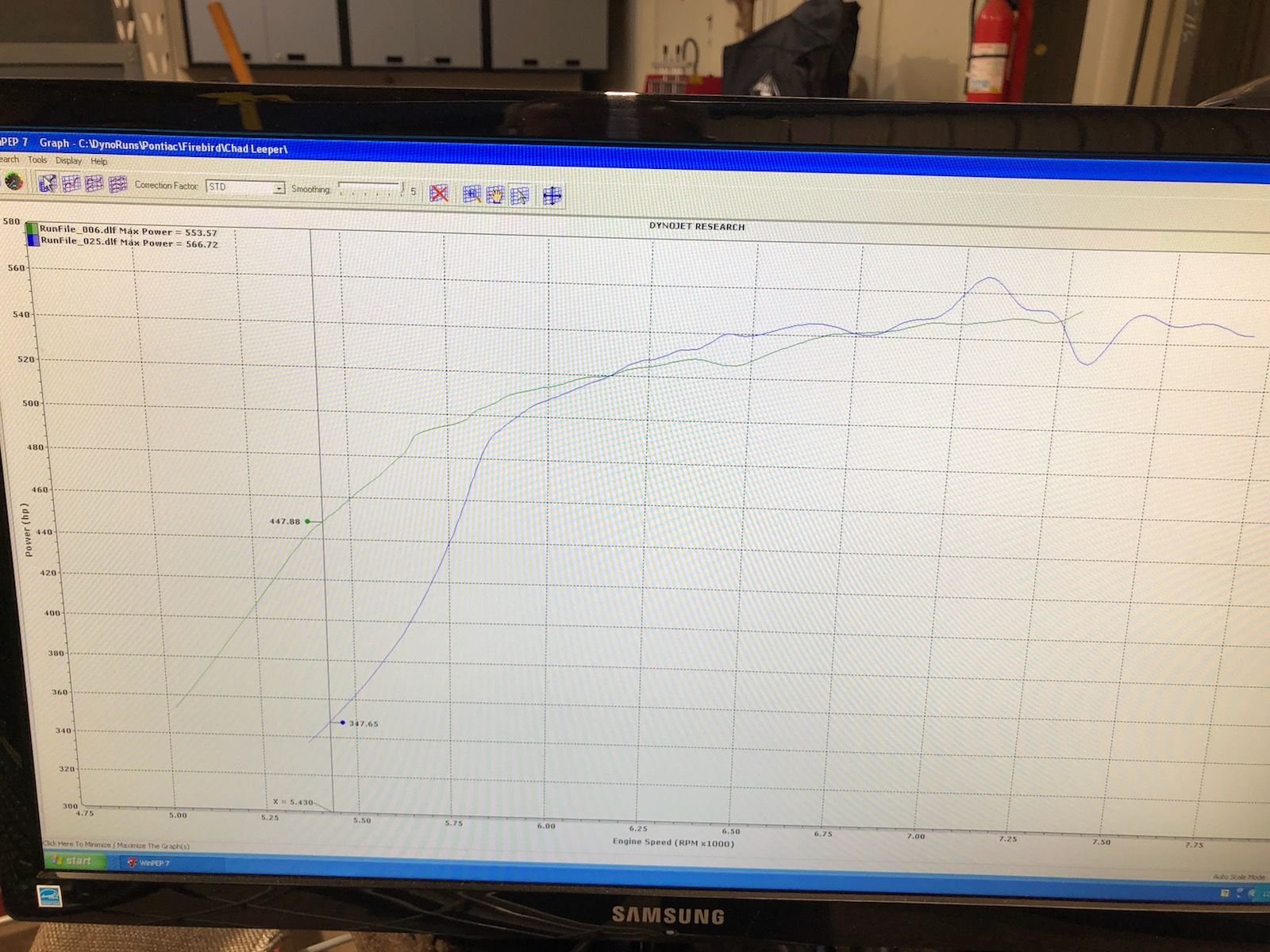

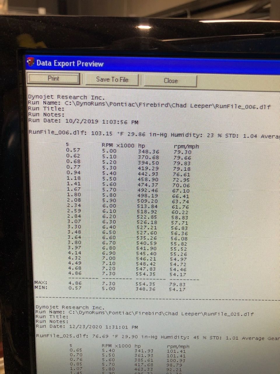

Old ls3 head combination
Old ls3 head combination vs new mast ls7 heads with a modified MSD sr intake with some tire spin and looser converter
Top is final pull bottom is first pull on ls7 heads aet up. Also tuning in e70 fuel
dyno done at Engine power systems by Geoff Skinner.

So the new Mast top end didn't increase quarter mile performance (mph) that much? I am really surprised.
Weight didn't change between the two packages right?
Old Jan 3, 2021 | 08:10 PM
  #439
AINT SKEERED's Avatar
Joined: Apr 2002
Posts: 3,990
Likes: 361
From: Albany La
it wasnt as much as I expected honestly. The best ever with ls3 heads was 10.29 at 131.8 in -800 Da
went 1 time with ported msd but stock length runners and mast top end. Went 3 back to back 10.35 passes at 131.6 in plus 350 da.
My converter really needs to be able to rpm more than 7200 so I had runners cut down ,now peaks at 7100 and pulls all the way to 7800 maybe more. So next time track is open I'll see if that improves anything.
car was 3841 with half tank of fuel how I run it
