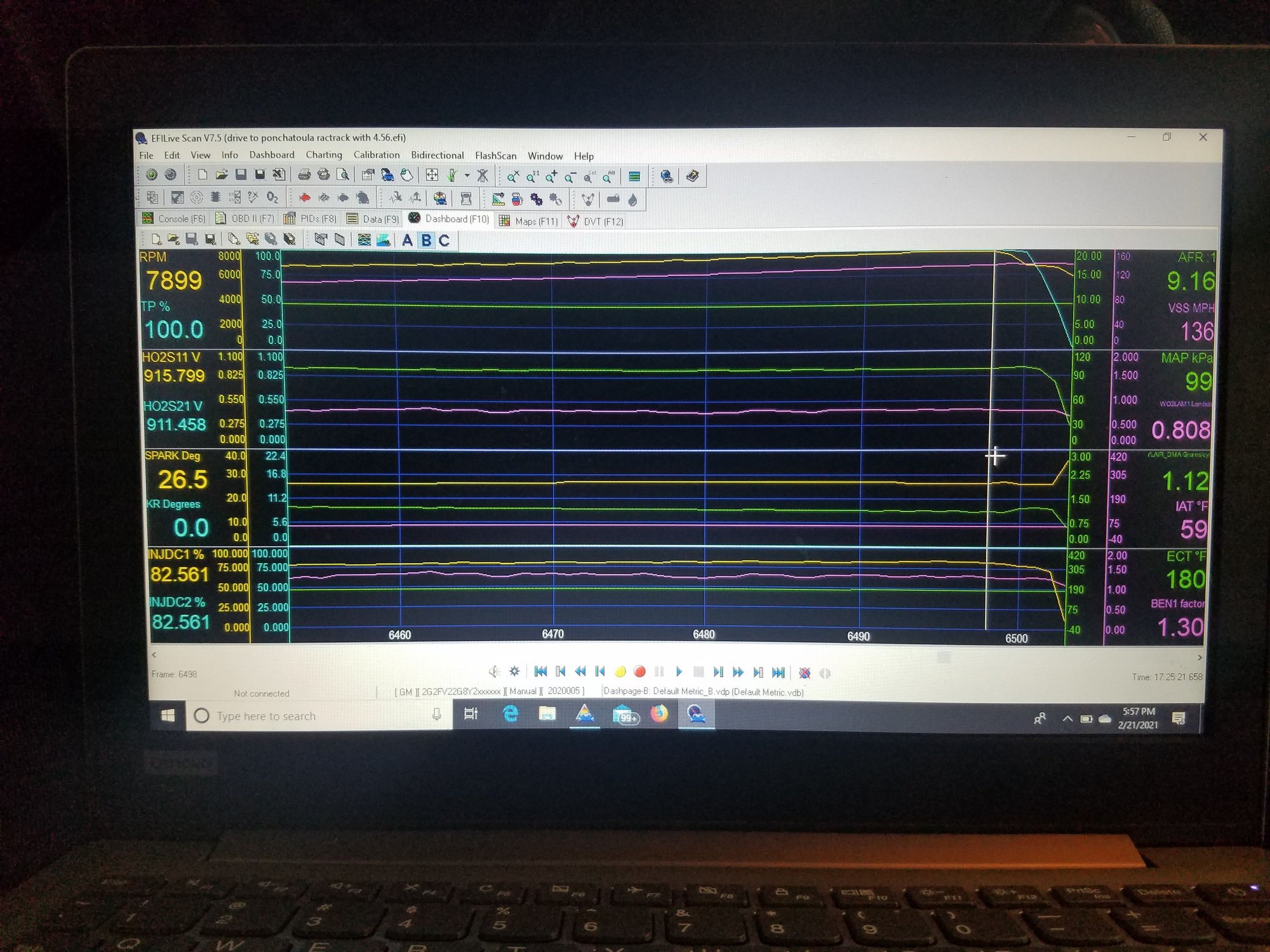

Nice, I couldn't remember but I was checking out you duty cycle and was curious. I'm running the deka 80's and will see how far they'll go on E85 eventually.

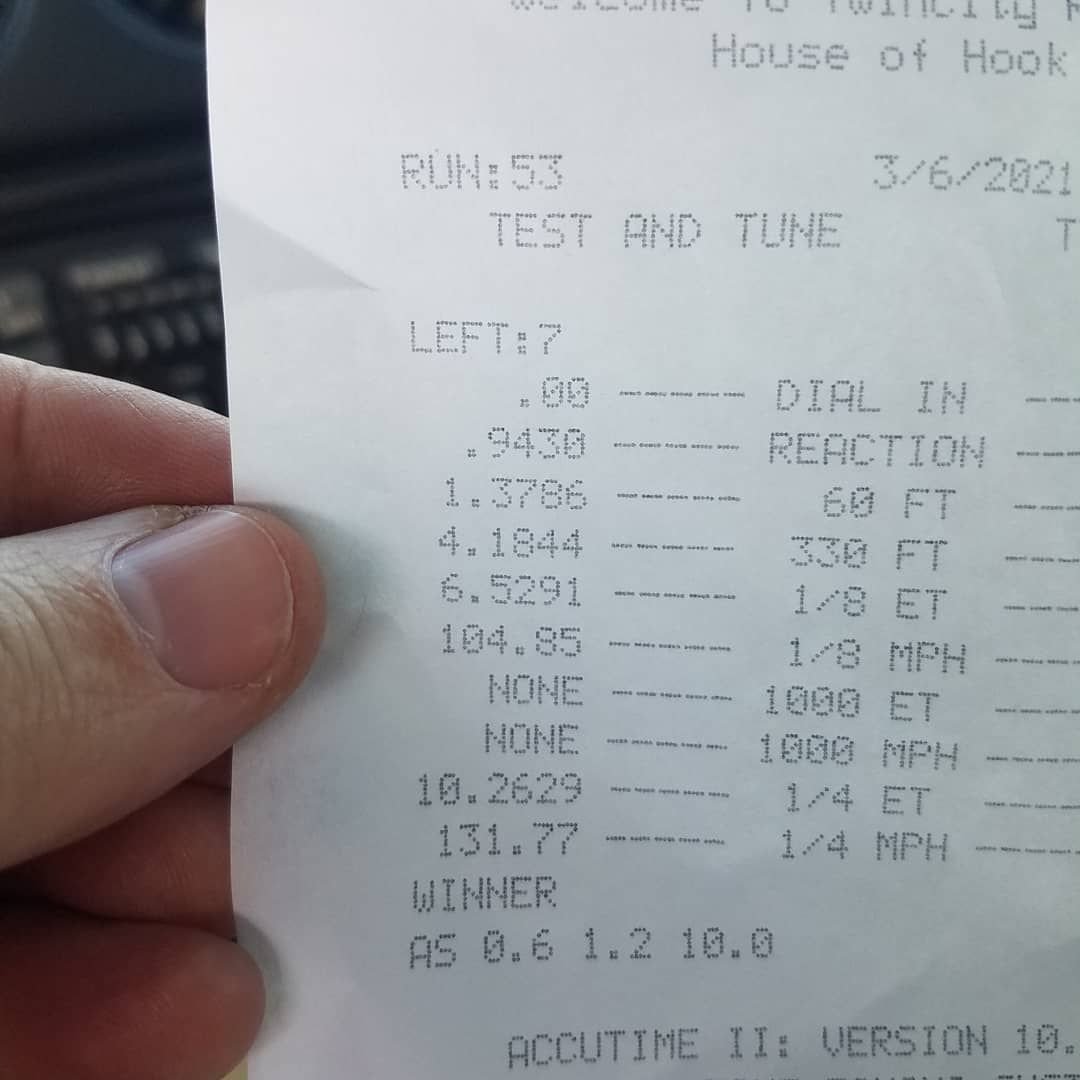

new best. Swapped to 4.56 gear, and short runner msd intake. 300 above DA

Chu look at that 60', nice run man.

Now we cookin! You are a blink of an eyelid away from going 9’s. What’s next?

Very nice! 7,800 rpm, wow that's crazy. I always like to see how you're car is doing.
Every thing I've seen says that the LS7 and LS3 heads don't need timing like the cathedral ports so I'm surprised to see 26.5 degrees.

it's the e85. On 93 and boostane it like 20degree timing

I wanted it to hook leaving at 4600 but 3800 was all i could get it to take that day. It's on a 28x9 pro bracket radial now too.
well i have a sniper intake to test just to compare with the msd but aside from that test, not to much. Maybe rear brake kit and get rid of the abs module under hood but there isn't too much im willing to remove to get weight off. Horse power is there as is. Just need to optimize it .
. If the motor ever comes out, jacob has an idea on a cam specific to my needs. My cam was done for the ls3 heads
