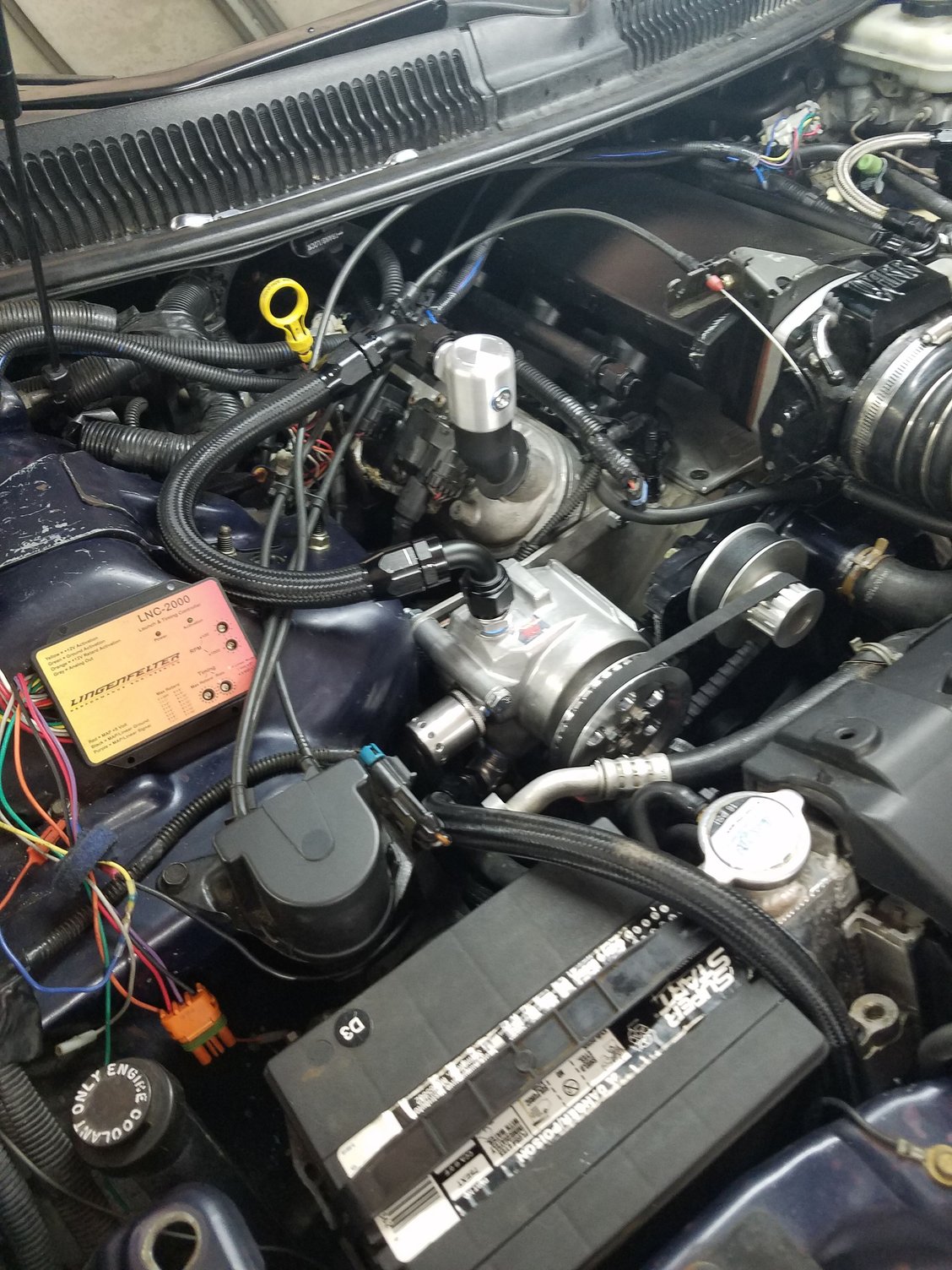

need a 90 deg 12 an fitting to turn hose down so it dont cross the battery but this thing raps up super fast now. Not sure how it is supposed to be at idle but its seeing 7inches vacuum. When I bring revs up it sees 15inches. I'll dial it back in upper rpm to 12.
Flex fuel sensor hooked up and swapped to the 02 Tahoe operating system tune but getting a fuel composition sensor error and its stuck on 21.9% ethanol.
I tested the fuel which is only 93 and it is 10% so I need to test my wires and make sure I have a good sensor for my system.
I swapped back to old tune until I figure it out

My battery died on me just after loading a flex fuel tune and new operating system. Battery tested bad so I ordered a battery Darth is running,
Save weight, makes room for my ac accumulator to go there since it had to he moved to allow the vacuum pump install.

This battery is a beast. Cranks this 427 like its a 4 cylinder.
Cant seem to get flex fuel tune to cooperate so been playing with ethenol . First tank on e35. And just added more and tested at e55. Set stoich to 11.6 .haven't added any timing yet ,just toying around with it. I may add a couple degrees to see how it responds tomorrow.
Have a dyno day set up with Geoff for October 2nd. Then heading to Biloxi gulf coast for cruising the coast.
