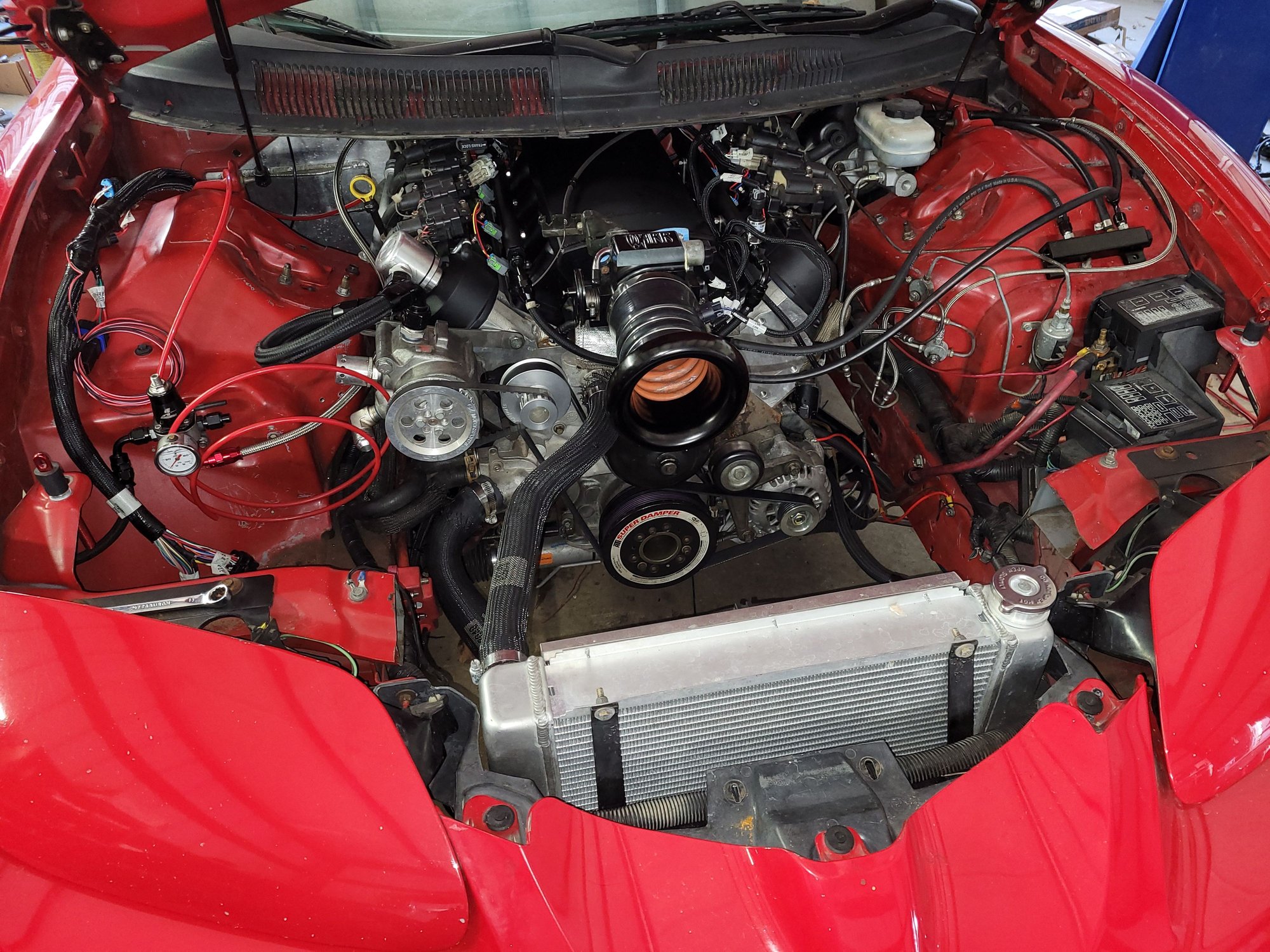

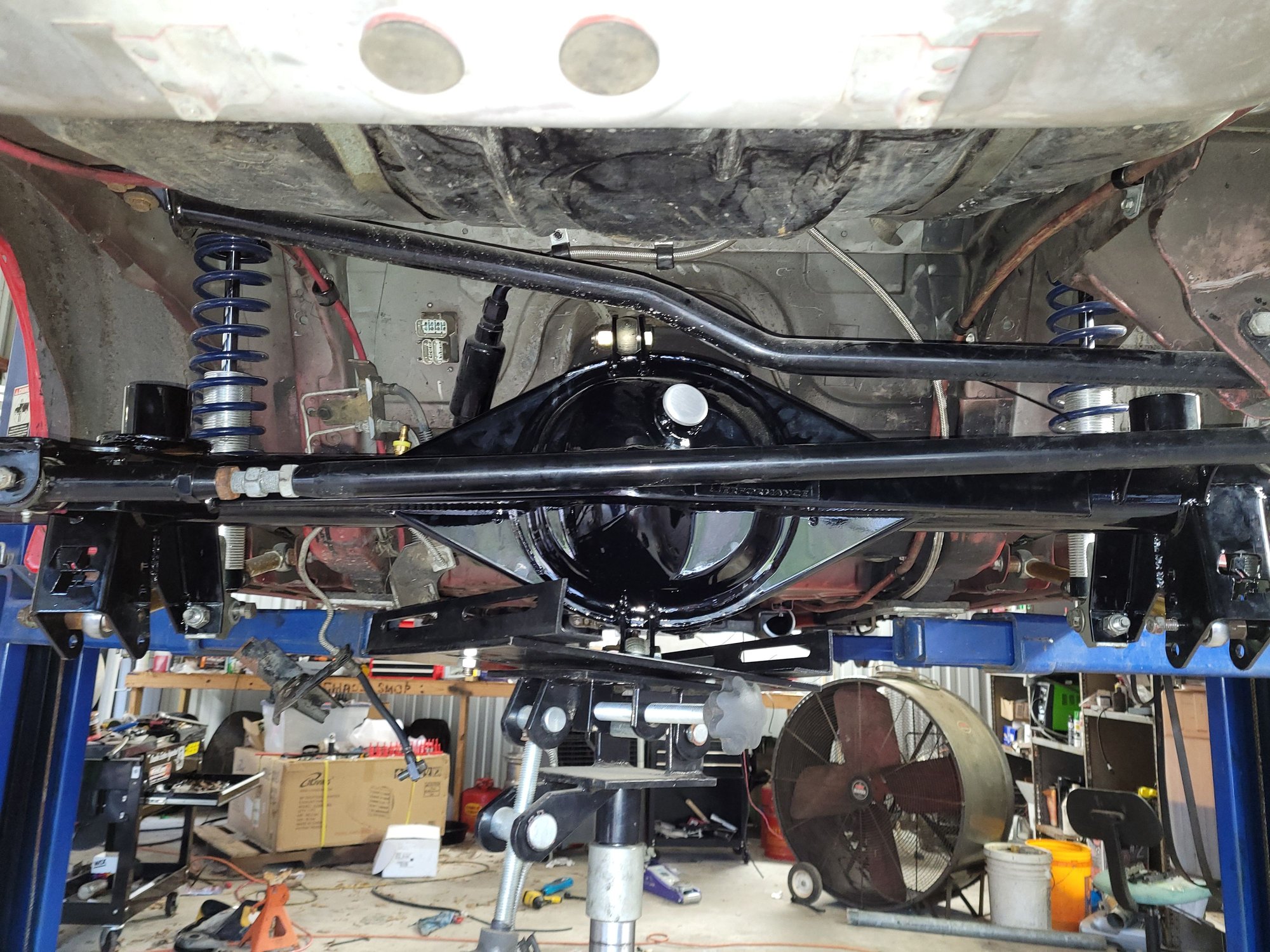

Made some progress this week
Mostly just need to wire up the holley terminator x for this to be finished.
Put in the fab 9. Still have to put the axles in once i get the brake backing plates off the 10 bolt axles. Down side, drive shaft from the blue car is almost 4 inches to short.

Update. This rear end was not built with the correct bolt pattern axle housings for stock backing plates. Strange race brakes ordered for correct Bolt pattern

New changes. Since 12 bolt in my blue car has 4.56 gears and that's what the motor combination seemed to want yet the 9" has 3.73 which is closet to what I want in a street car I swapped them. 9 inch in blue along with all strange brakes.
. Red car Is wired up. Has power to holley and spins over. I don't have gas in the tank yet, ordered a sending unit for the fuel tank. While tank is empty and the rear is still out for cleaning and painting I'll fix that first.
So next week off I'll fix sending unit and put rear in. Then it should be time to make noise

Thanks to Project GatTagO,I got oil pressure. He helped me get it fired up yesterday for just 5 seconds since I don't have water in it yet. I have to get a fitting welded in the radiator to connect my steam port to.
I'll try to add the short clip to YouTube and post it

I also don't have exhaust extensions so I didn't want to let it run to long for that. Rear end going in this weekend . Maybe tomorrow
exhaust extensions are being welded to the vbands so when I get them back I will be fine. I ordered a nipple to weld into radiator also for steam port to return to. I've been patient so hearing it crank gave me some new motivation.

I took my vbands and exhaust extensions to a local chassis builder to get welded so I'll have extensions. Also my radiator to get a bung welded on it to connect my steam port to. Once I get them back I'll be able to let run.
. I have the 12 bolt installed all accept my tq arm. It's being a pain in azz. Once that is in I have everything else I need to get car dialed in.
I didn't spend as much time on it as I'd hoped on this 28 days home but honestly I spent as much as I felt like doing. I have a week left before I go out for 28 days so I'll get the rear end finished today or tomorrow. (My blue car is out side until it's done so it has to be completed)
