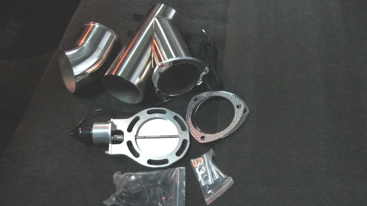

I'm using an ebay china 4" electric cut out and it has been good better than I expected. It doesn't seal 100% but it barely leaks. I've read that if you run a bead of hi temp silicone sealer around the butterfly and let it set, the cut out will seal 100%.
I will get a pic of my exhaust next time I can. I have 3" y-pipe merging into single 4" and going under the rear axle (yes, it works, with the pipe flattened a little either side) and then into the 4" cut out, and I orientated the cut out so the straight through part goes direct to a 4" pipe dumping at the rear bumper, and the Y side of the cut out I ran a 2.5" pipe under fuel tank across to the other side, thermo wrapped it, and into a small 2.5" muffler dumping at rear bumper, and it is well hidden. From the back of my car you can only see the 4" dump pipe. When I'm cruising I switch the cut out so it blocks the straight through 4" side, and exhaust pumps through the crossover 2.5" with muffler and it is decently quiet. Hit the cut out switch and it's a straight through 4" exhaust all the way, no muffs. Sounds very strong but nowhere near open header loud. And it probably wouldn't be more than 1 tenth slower in the 1/4 than open headers. (i haven't track tested it yet)
This is the cut out (old pic I took before i fitted it)

I've read about the bead of silicon but haven't seen any actual pictures of how they done it. So on the blade or around where blade seals?

From memory I think around where the blade seals but mine doesn't leak enough for me to have bothered trying it.

I'll probably try them then as I do like my exhaust I have
