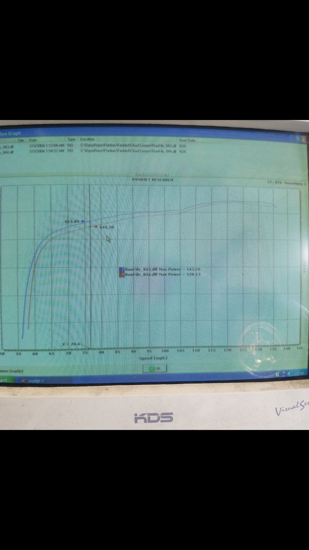

this is the difference between open headers and bassani dual 2.5" exhaust

I was hoping for more but with a beastly 4l80 and unlocked converter it's an animal. I can only imagine what 600would be like in this thing
Keep trying to tell people, you get to a certain point and the maf is a flow restrictor. Very nice results!!!!!
I now read 100kpa through whole pull on dyno. Should be that or better on road with air forcing in.
thanks jacob for all the advice and email replies through this build
it's my pleasure. That 80 is sucking down some power. I'm sure first and second are worthless without slicks of some sort. 600 would be about like driving on ice, but all the time.

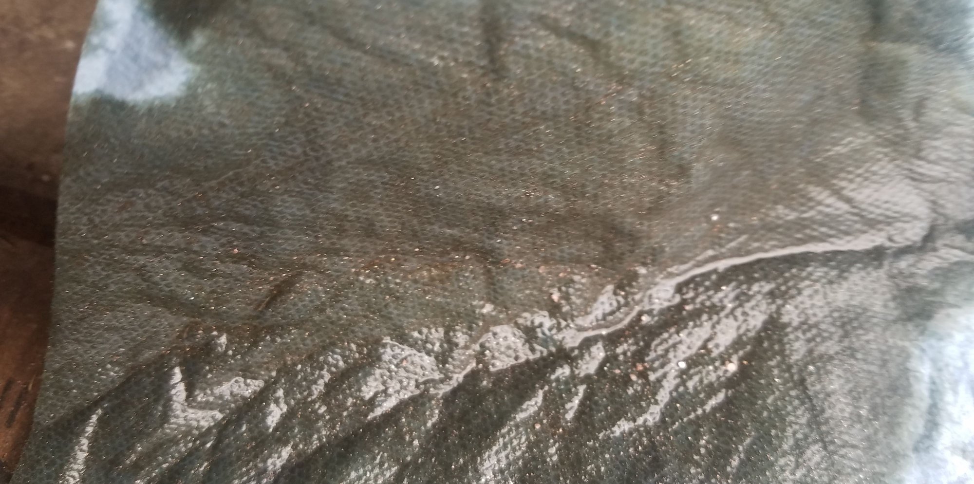

Well I got to the track today and made 2passes. First I left soft but pulled a 1.54 60ft. Only ran 10.85@124.34 mph.
should have been quite a bit higher,130-134 with my power and the da was good today. -929 da at 1 p.m
second pass was down to 122mph
and on return road I noticed low oil pressure. Got to the trailer and loaded up. Stayed and watched for a bit but when I came home decided to pull the oil filter and cut open.

I wonder if the drop in power when you put the exhaust back on was more related to the bearing issue and not any sort of restriction from the exhaust. Sucks to see. Good luck on the rebuild.

Posts: 4,582

Ughhh! How low pressure? Any noises? Either way it’s coming back apart. Happens to us all. Mine went 40 easyish street miles, before I went back in for rings, due to an oily plug issue, and found I’d badly overheated bearings and they were coming apart. Use this as a learning experience while your in there.

It was 20psi at 2000 rpm and at idle dropped to almost zero. I kept it up until I got on trailer. Then when it started going down I killed it.
yes it is coming back apart next week some time. I go back to the boat for a week on Tuesday so I will pull it back out next Tuesday.
