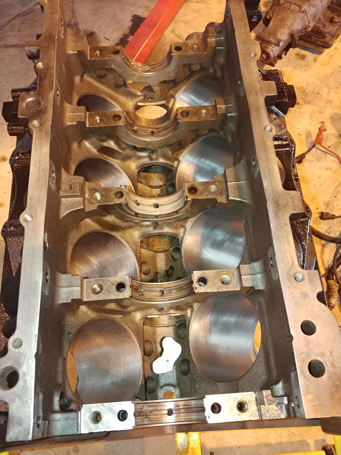

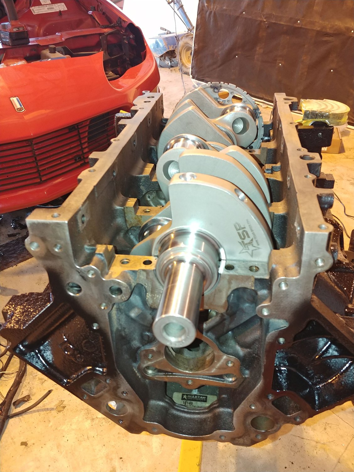

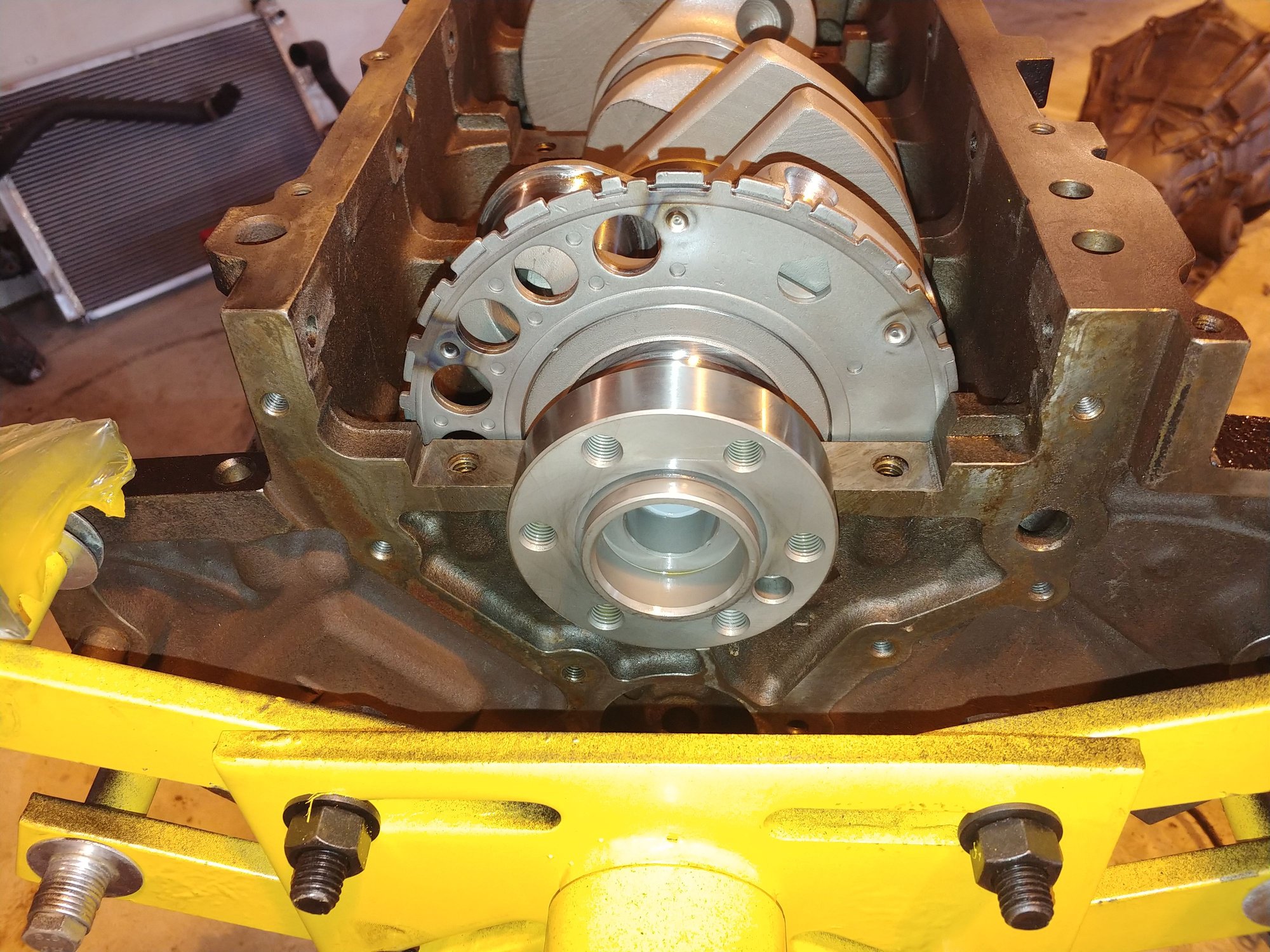

Take some pictures and post them. The more the better. Someone might see something that you're doing wrong.
Old Jul 1, 2018 | 09:34 PM
Philhippy45's Avatar
Joined: Mar 2016
Posts: 458
this is all I currently have.

I meant pictures of the bolts, where they're breaking, which holes you're putting them in, your angle gauge, etc.
On an unrelated note, the bottom of your cylinders don’t look like they have been debirred. Before you assemble this, be sure that there is a nice smooth radius. A sharp edge on the bottom of the cylinder will shave the skirts away with a stroker.
Old Jul 2, 2018 | 09:37 AM
Joined: Mar 2016
Posts: 458
ok I can get them when I get home. And they are smooth to the touch maybe just the pic look weird.
