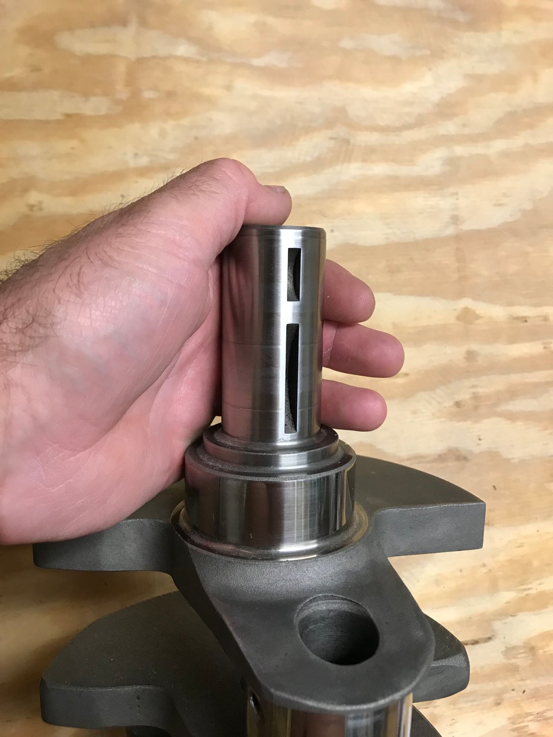

Originally Posted by Philhippy45
Ok another ? Do I need woodruff keys for the tsp crank if it's na or no? And also are they the same size key in both slots?
LS cranks don't have woodruff keys. That's why some people pin them when they use a blower.
Thats odd cause I just read an LS rebuild book and they talked about installing them.

OP said TSP crank...prolly uses keys.
Are You sure? OP said something about TSP crank. You must have only seen stock cranks.

Idk about stock cranks if they have then or not but the crank I was referring to is a tsp 4" forged crank and that has the key slots. I do know the stock crank in the original ls1 I had didn't come with them from factory. And as for the head bolts there is the like 2 or 3 different revisions from my understanding. You just gotta shove a piece of metal in there and see if there the same length or not.
