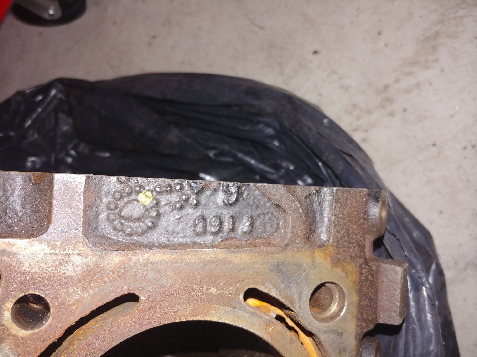

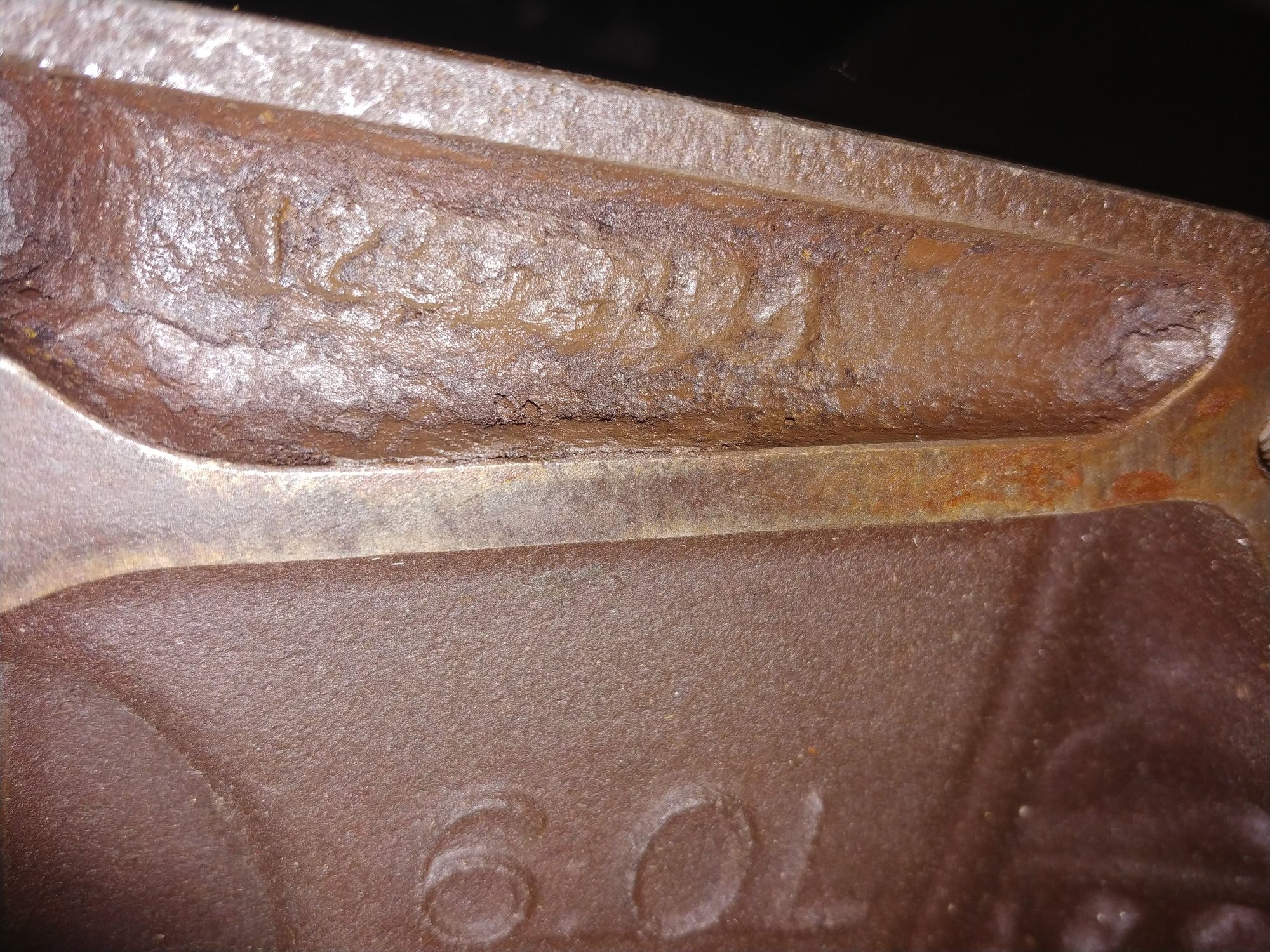

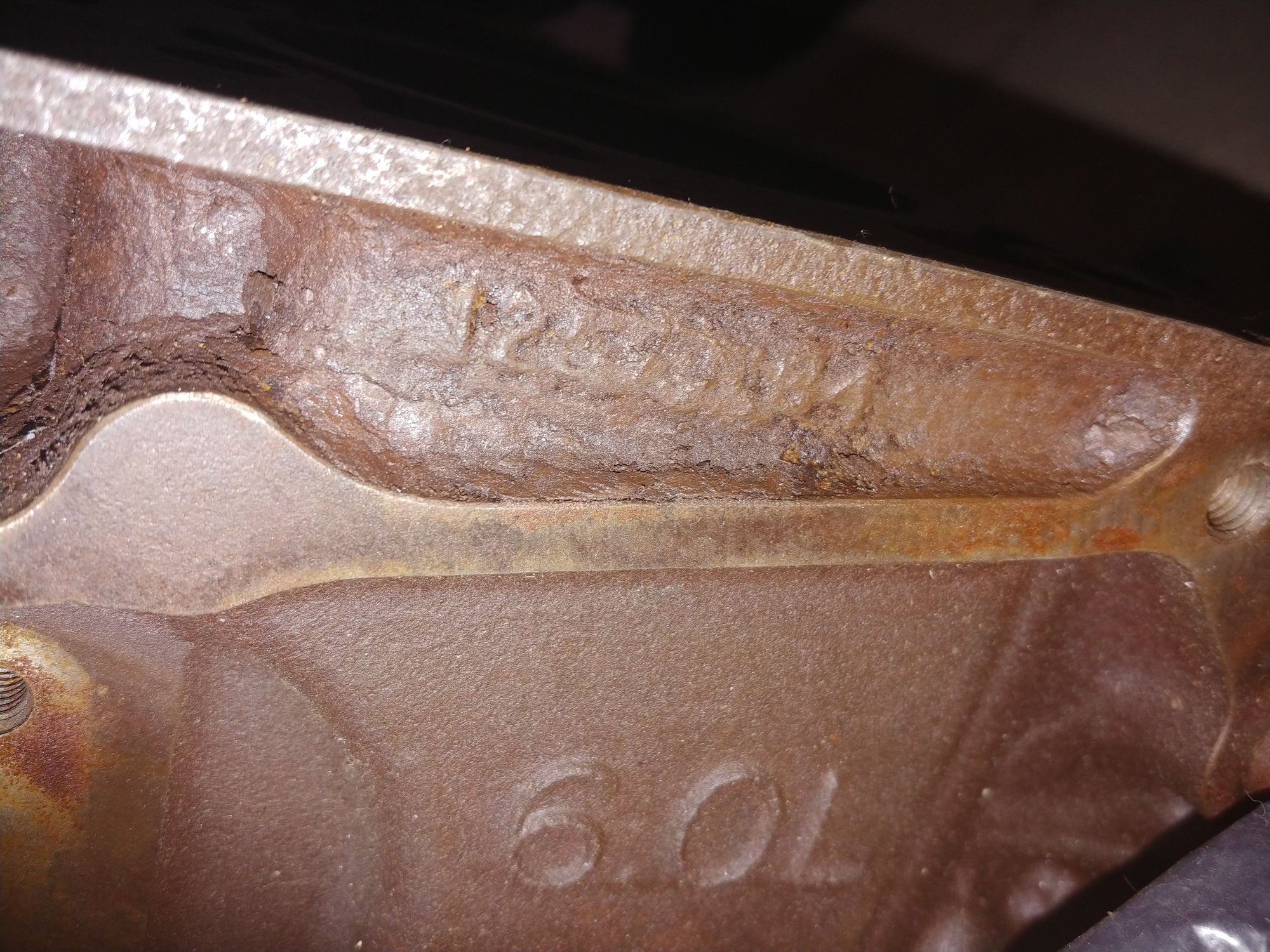

Can anyone tell me what this clock stamp says? It appears the block was made in 05. I need to know so I can get new cam bearings for my build.

Look down the headbolt holes and see which Gen block it is. The cam bearings design will usually correspond to the head bolt design.

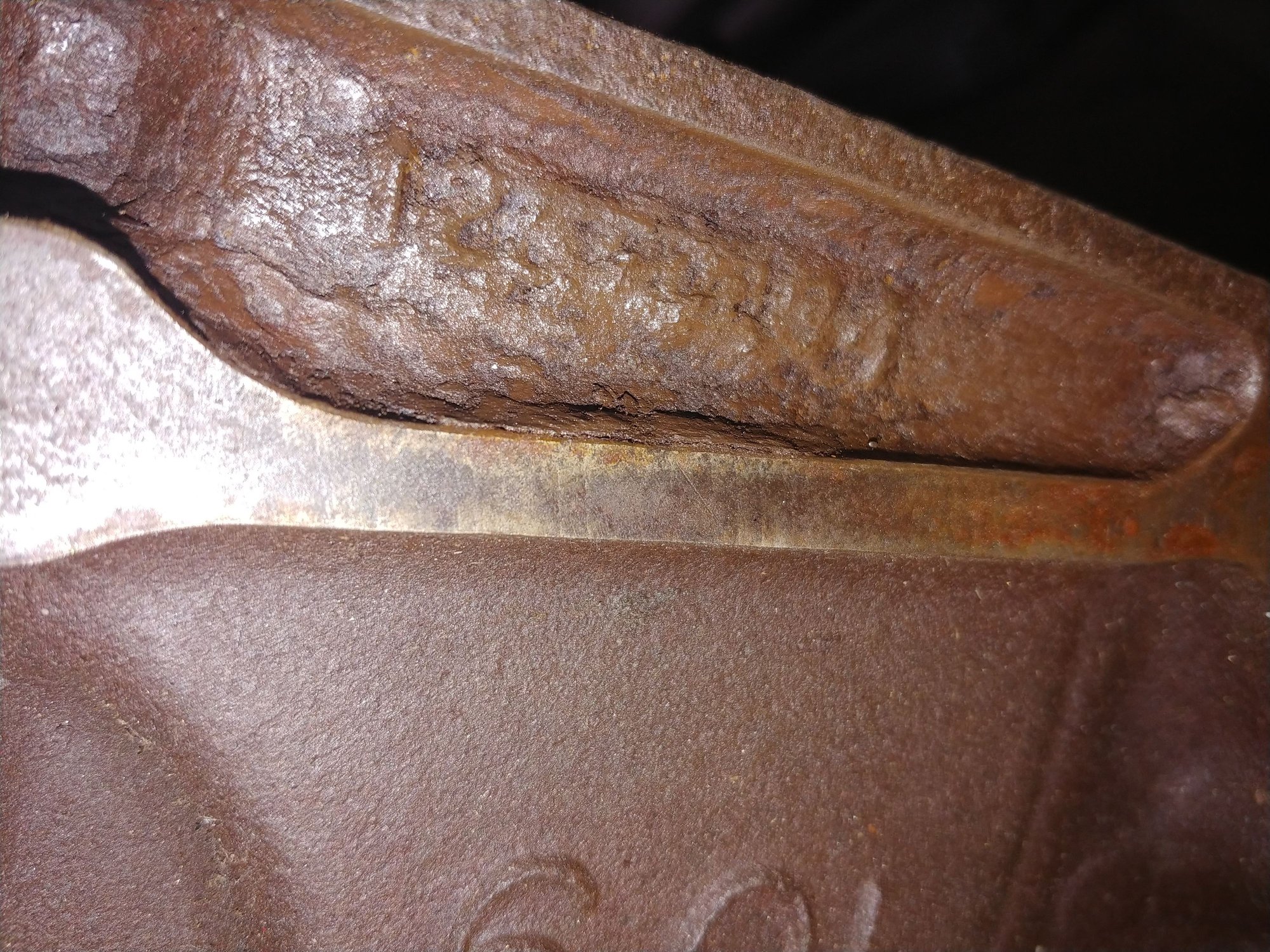

right now it's just a bare block with 6.0 on the side and #12557184 on it that's all I know plus this stamp.

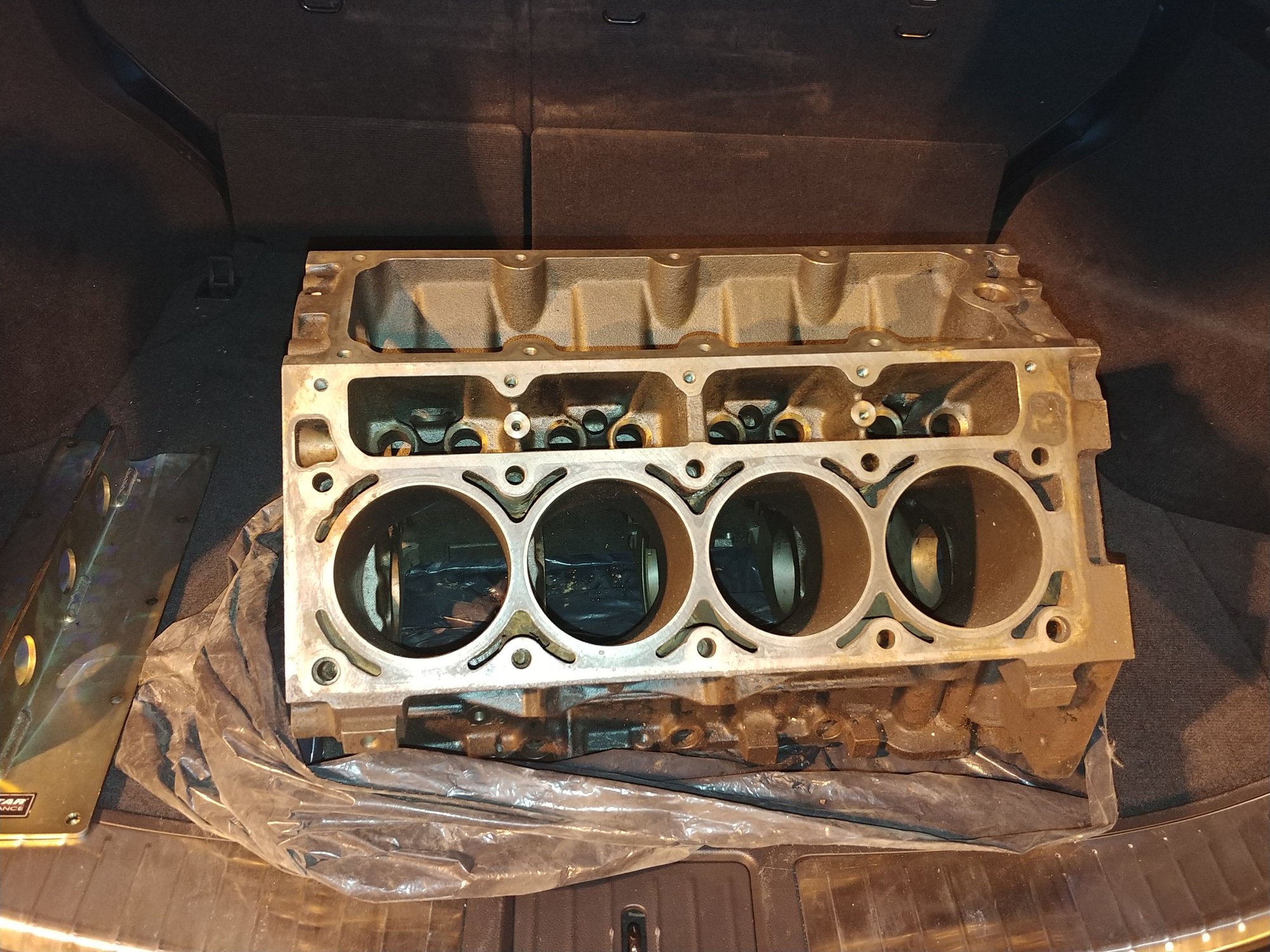

Old Jul 30, 2018 | 06:33 PM
Posts: 7,848
Likes: 5,202

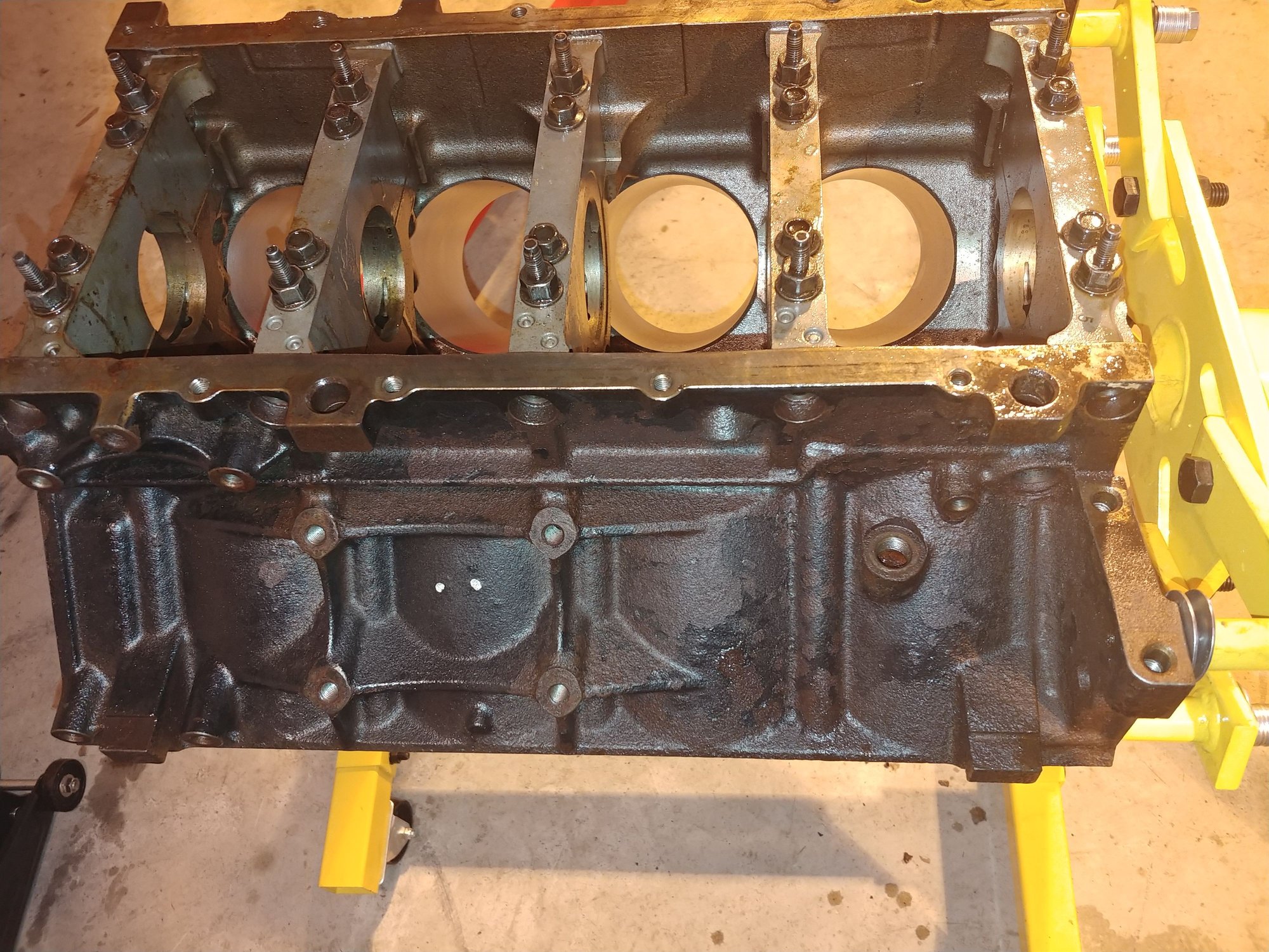

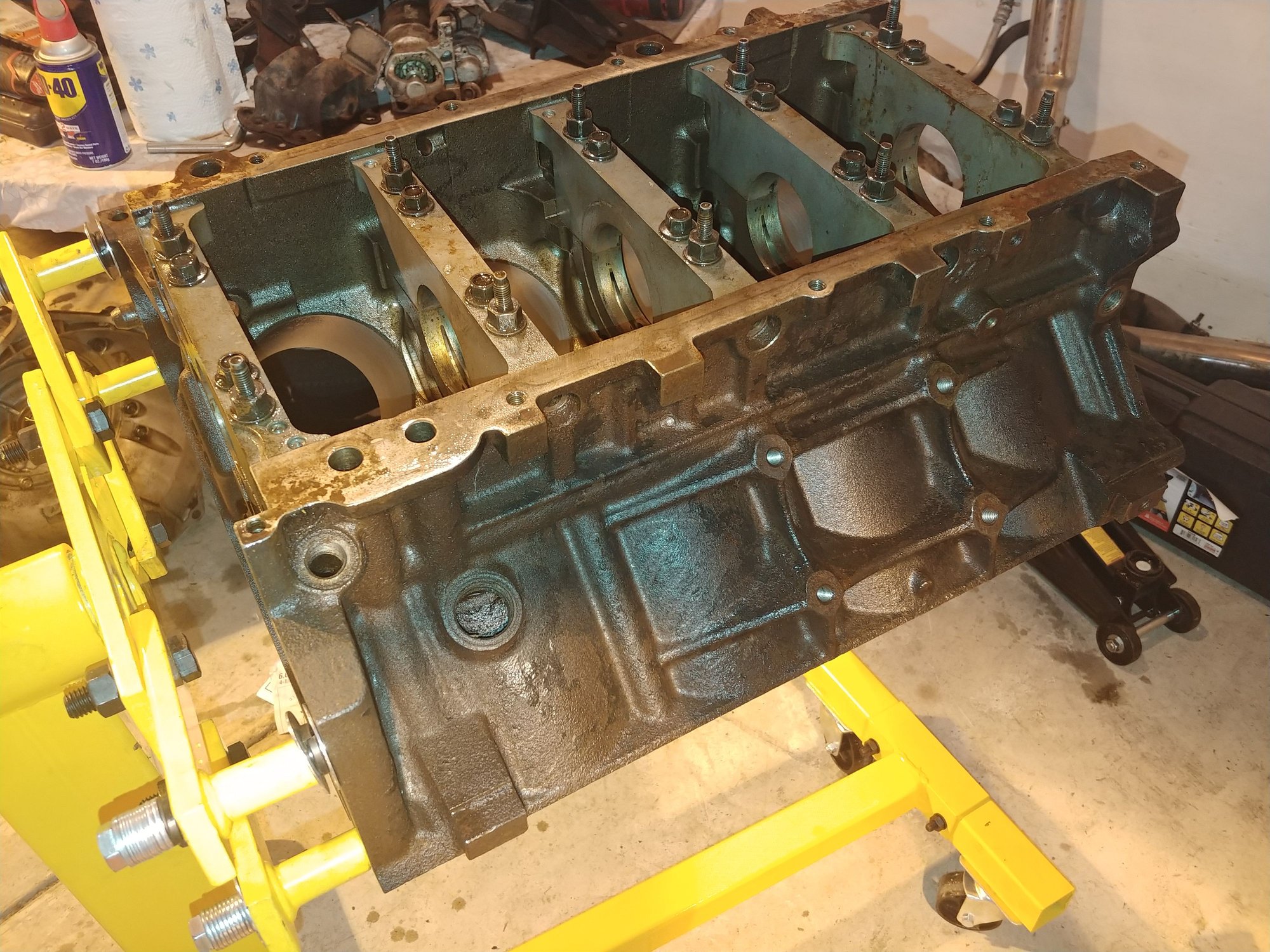

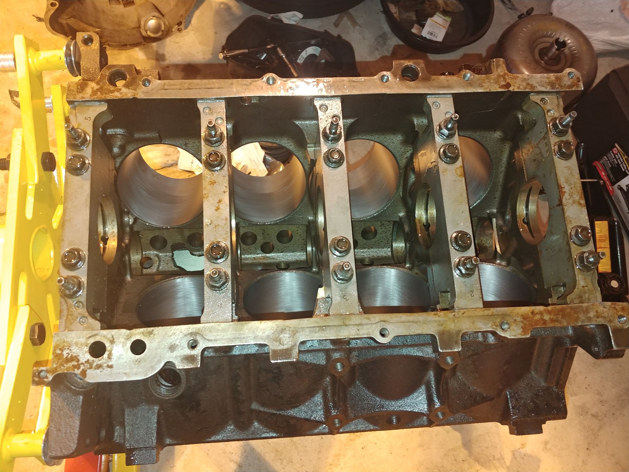

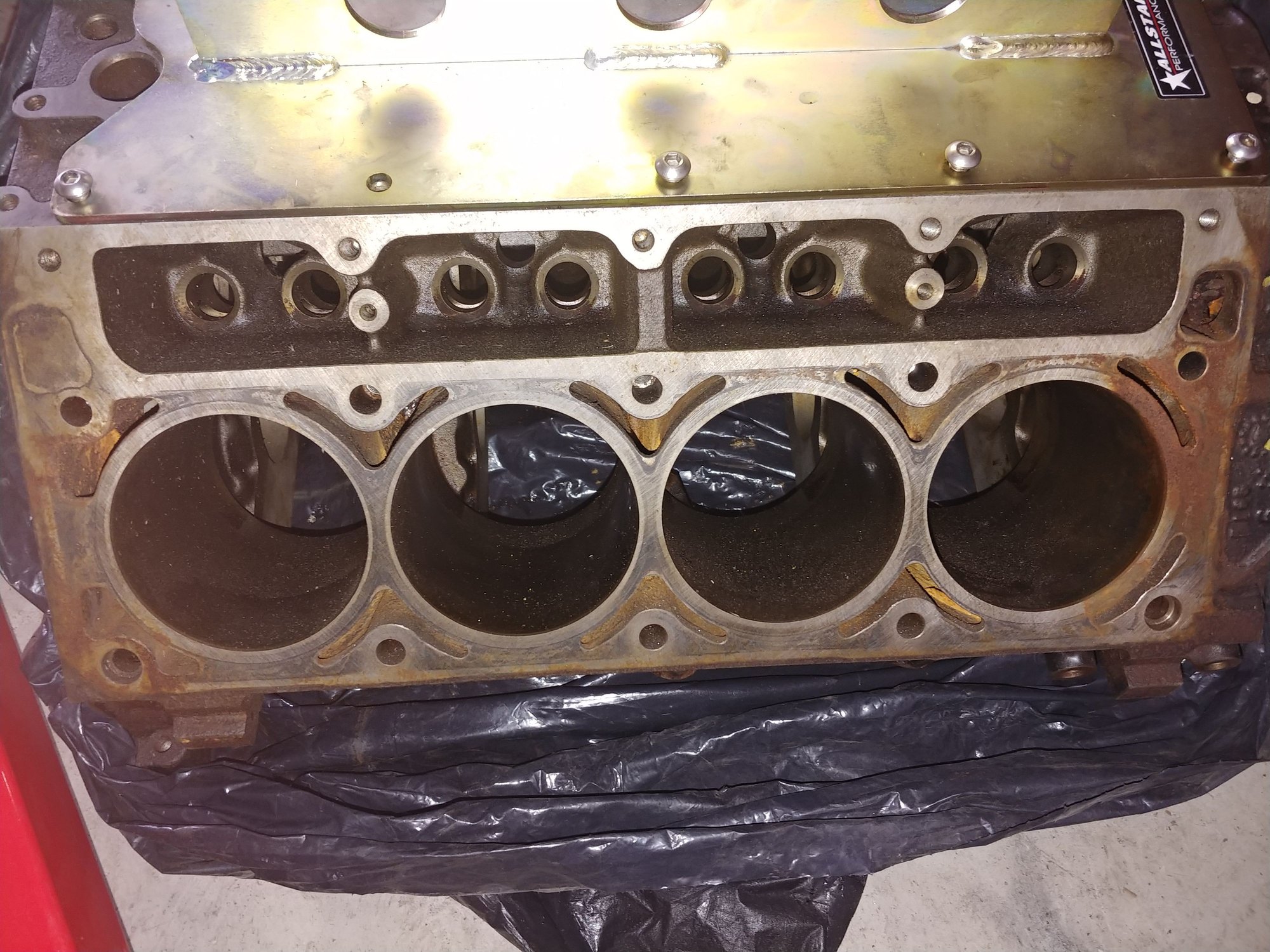

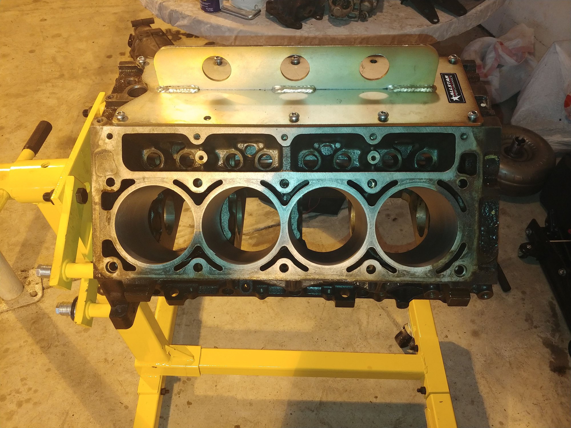

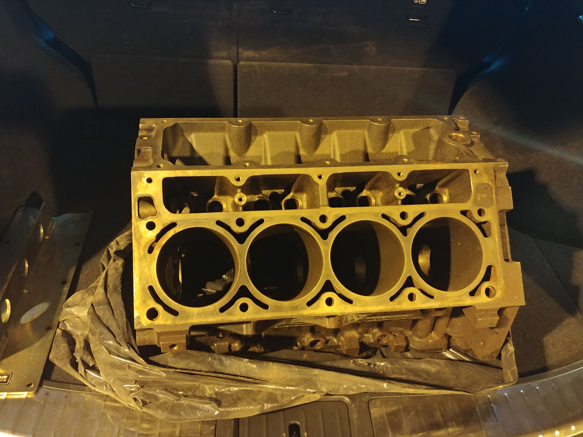

Show us a picture of the entire block. Gen3 and gen4 are two different animals.

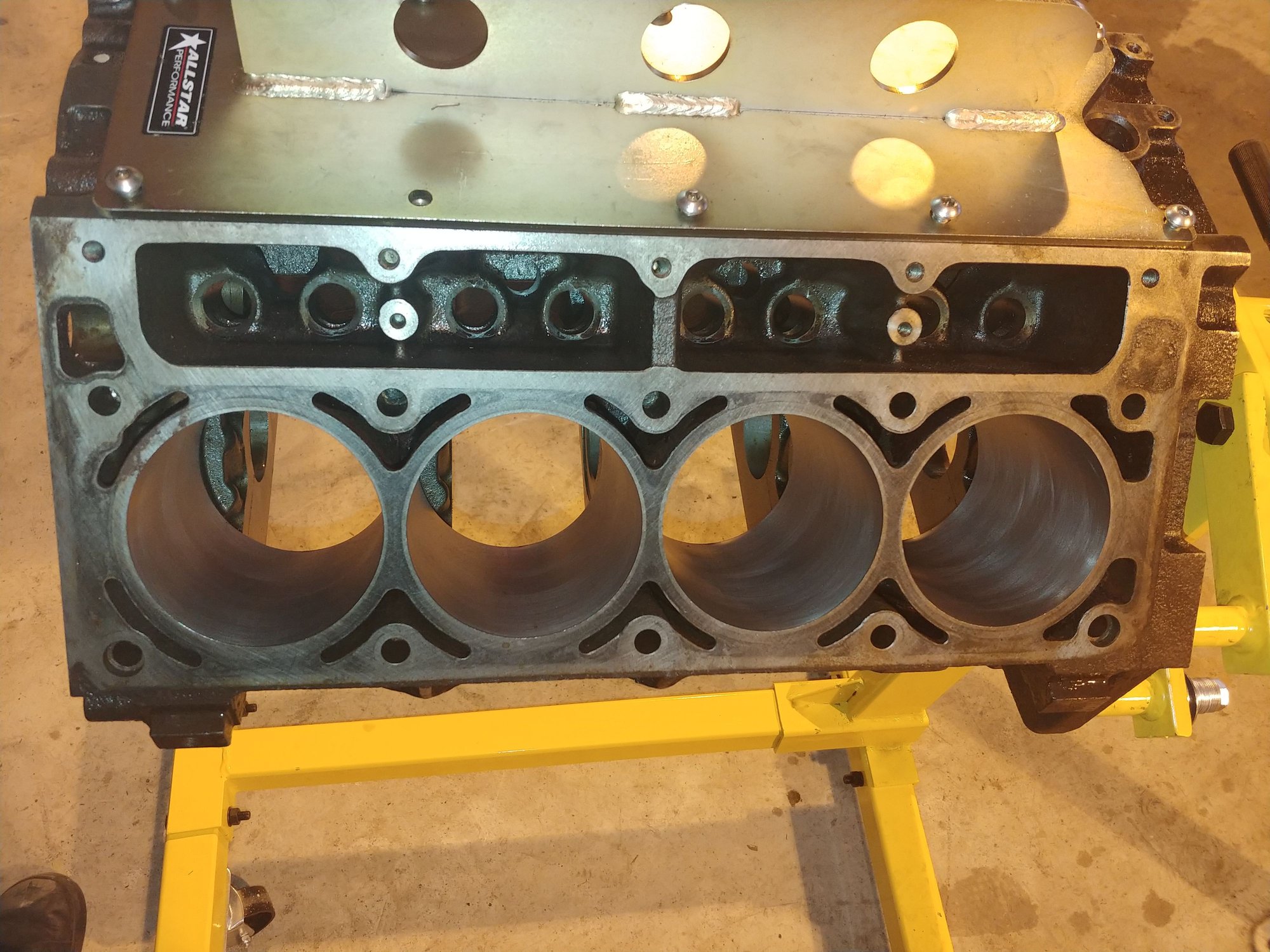

Does your block use 2 different length head bolts or just one, NOT counting the row of smaller bolts

Old Jul 31, 2018 | 06:56 AM
Philhippy45's Avatar
Joined: Mar 2016
Posts: 458

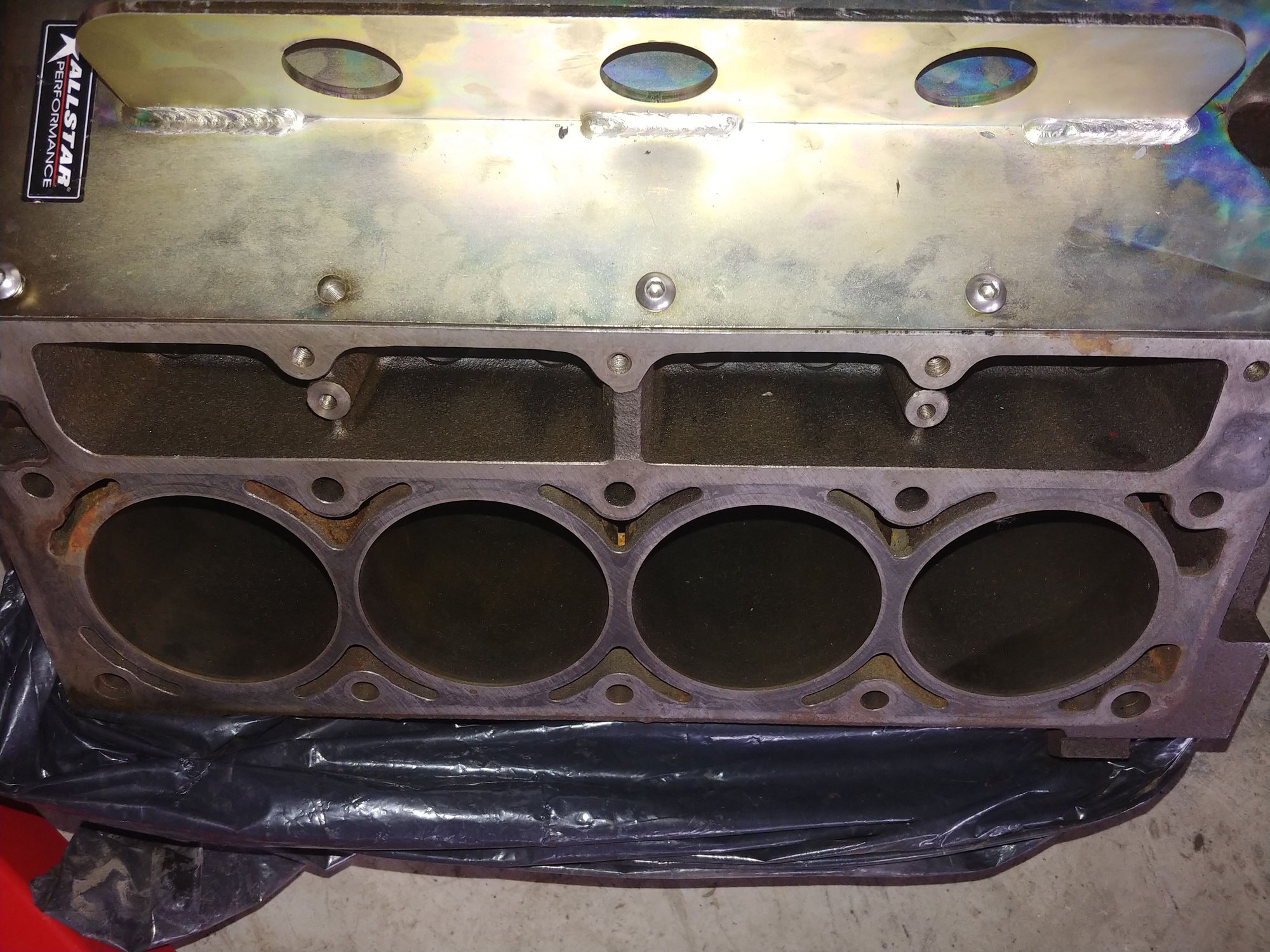

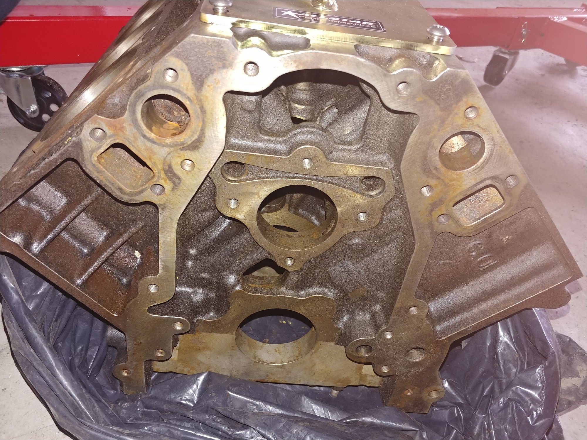

Can't see inside the valley with the lift plate on. Are the knock sensor bosses in the valley?
Old Jul 31, 2018 | 02:43 PM
Joined: Mar 2016
Posts: 458
yes they are on the top. It appears the cam sensor hole is up top as well.
Old Jul 31, 2018 | 03:48 PM
Posts: 22,307
Likes: 3,622
Definitely Gen III....

Figured I'd update this to see if anyone may need the info at a later date. The clock stamp appears to be a 2005 stamp and the number on the block references to a lq4/lq9 block not sure as I didnt have heads or pistons or anything. But upon measuring the camshaft holes they damn near matched what texas speed had for there 2nd gen cam bearings then. I looked at the head bolt holes and found they were all the same length except the short ones by the intake. So it's a 2nd gen lq4/lq9 2004 or later model since the bolts are the same and the cam hole is bigger.
