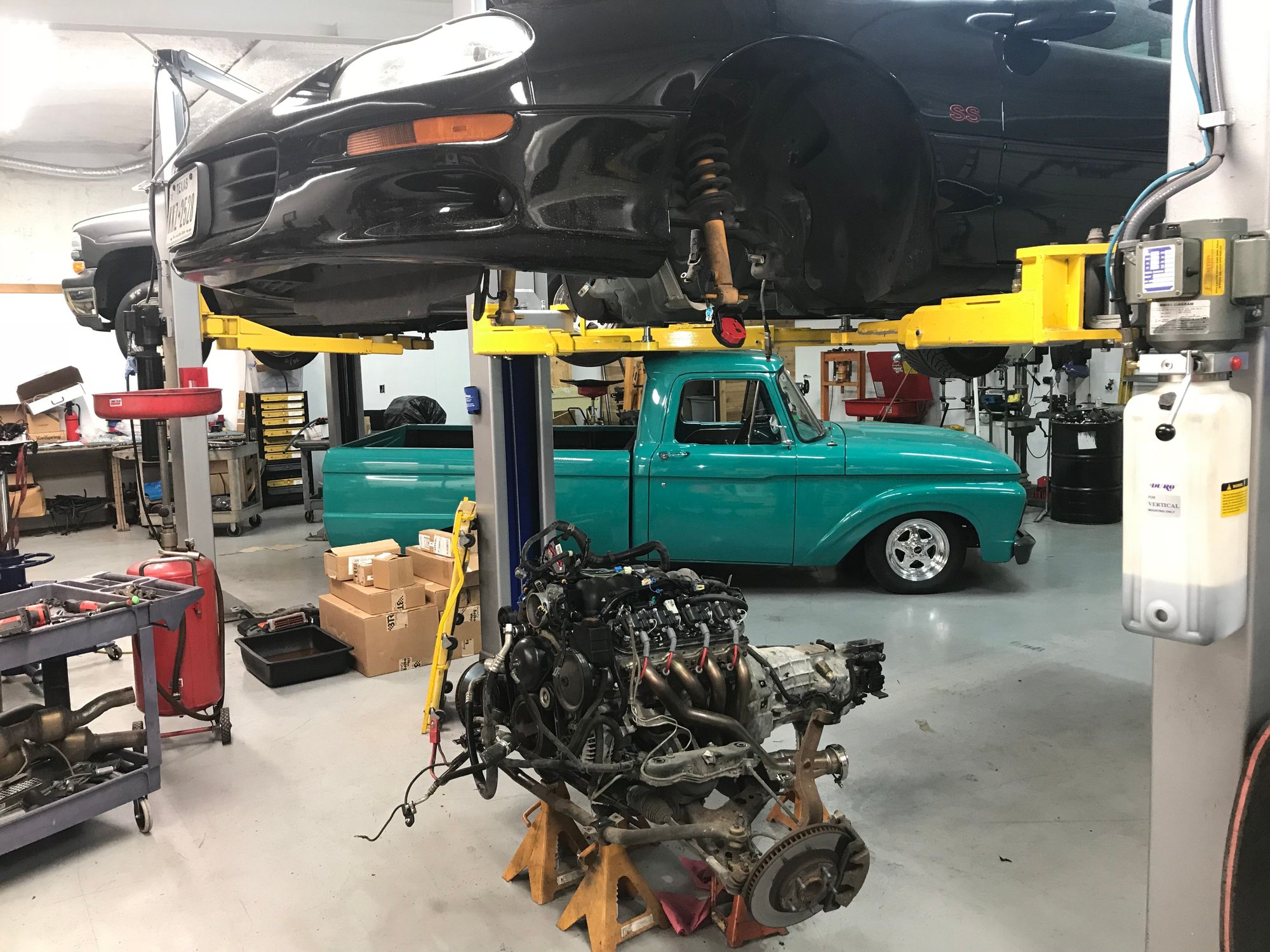

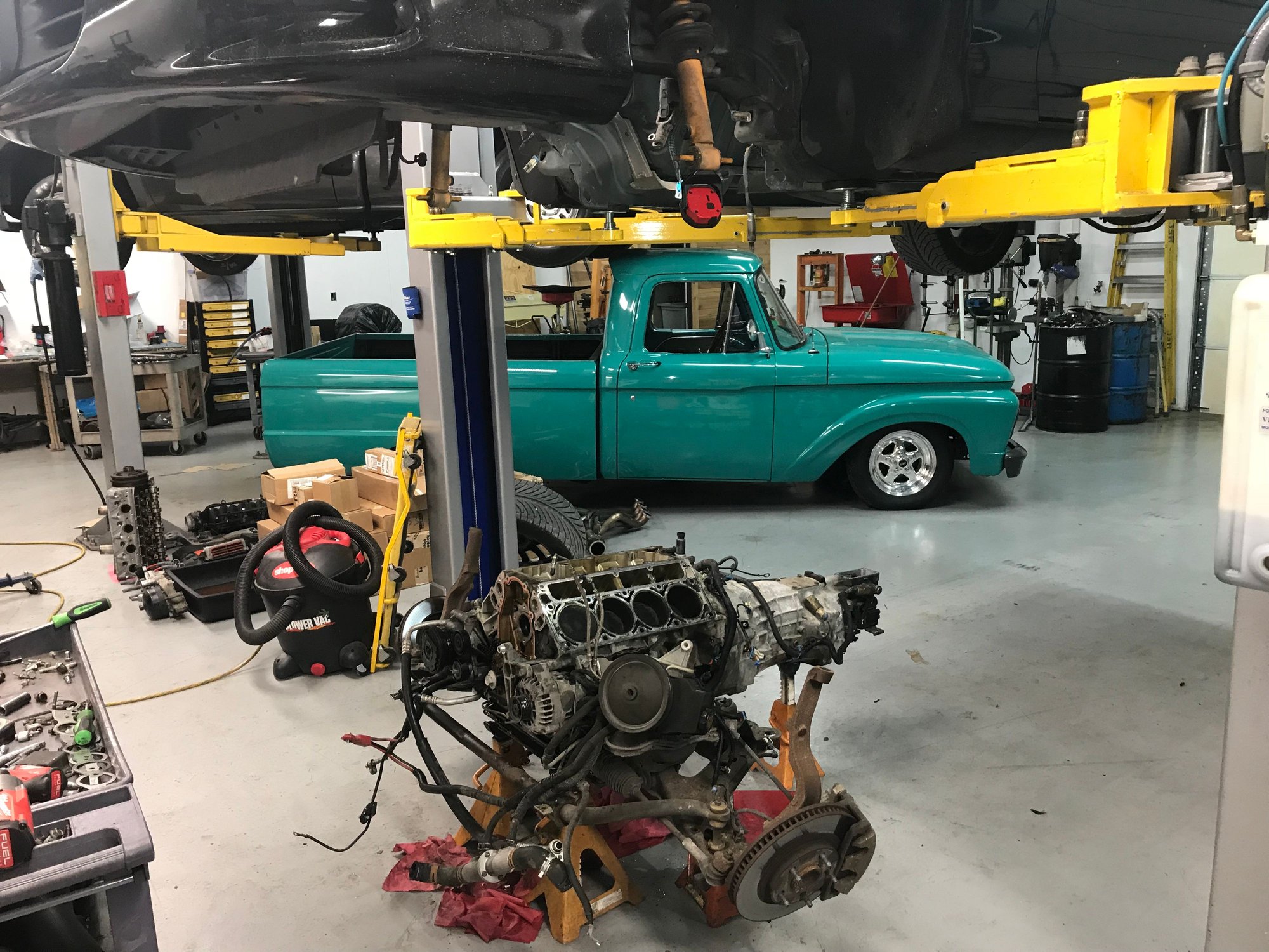

My very first car was a 2002 Black Z28. I was 18 years old, financed and made all the payments myself. That was in October of 2002. After about 2 years, I traded it for a truck. Through the years, I had come to find out it was a 1SC. It was Black, hard top, no options/power nothing, 6-speed. The only extra it had was Y3F, the Sport Appearance Package (RS Ground Effects). Took me until January 2018 until i would get another 2002 Camaro, only this time it is an SS. I grew up with rat-rods and Bowtie muscle. I've driven deuce coupes, hot rod wood sides and split window mercury's, through the years. As a kid, helped rebuild and restore Corvettes, Chevelle's, Nova's, El Camino's, and Camaro's as a gopher (go for this, go for that). And so, I began to make a weekend cruiser. I am no mechanic, and contacted Bill Ray Motorsports, in Burleson, Texas, and the journey began...
January 2018

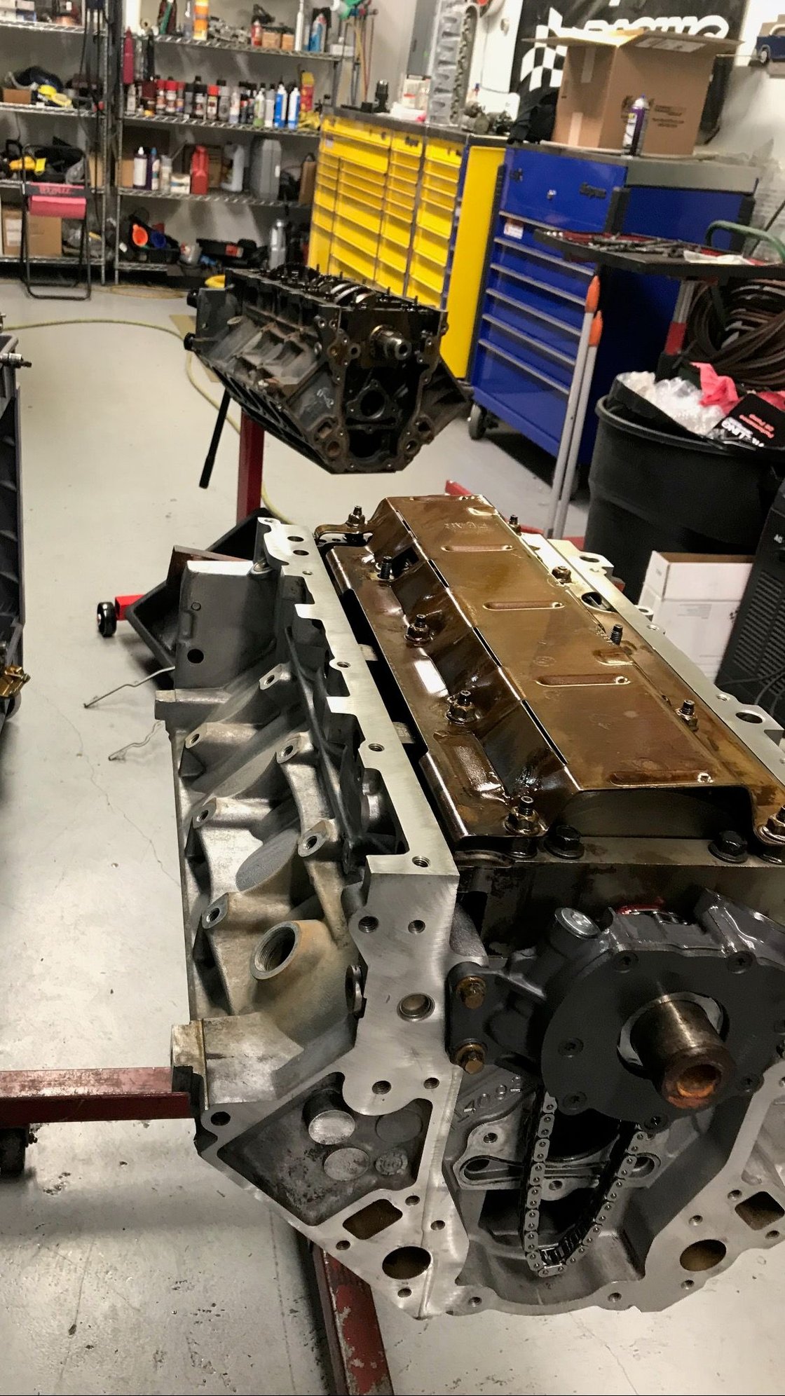

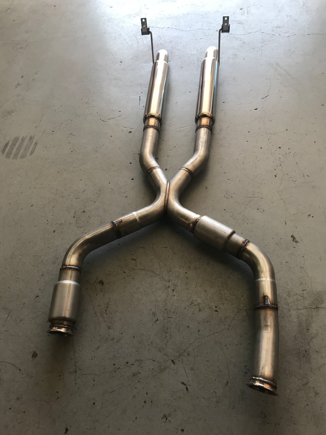

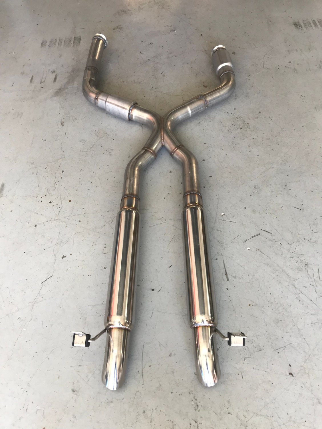

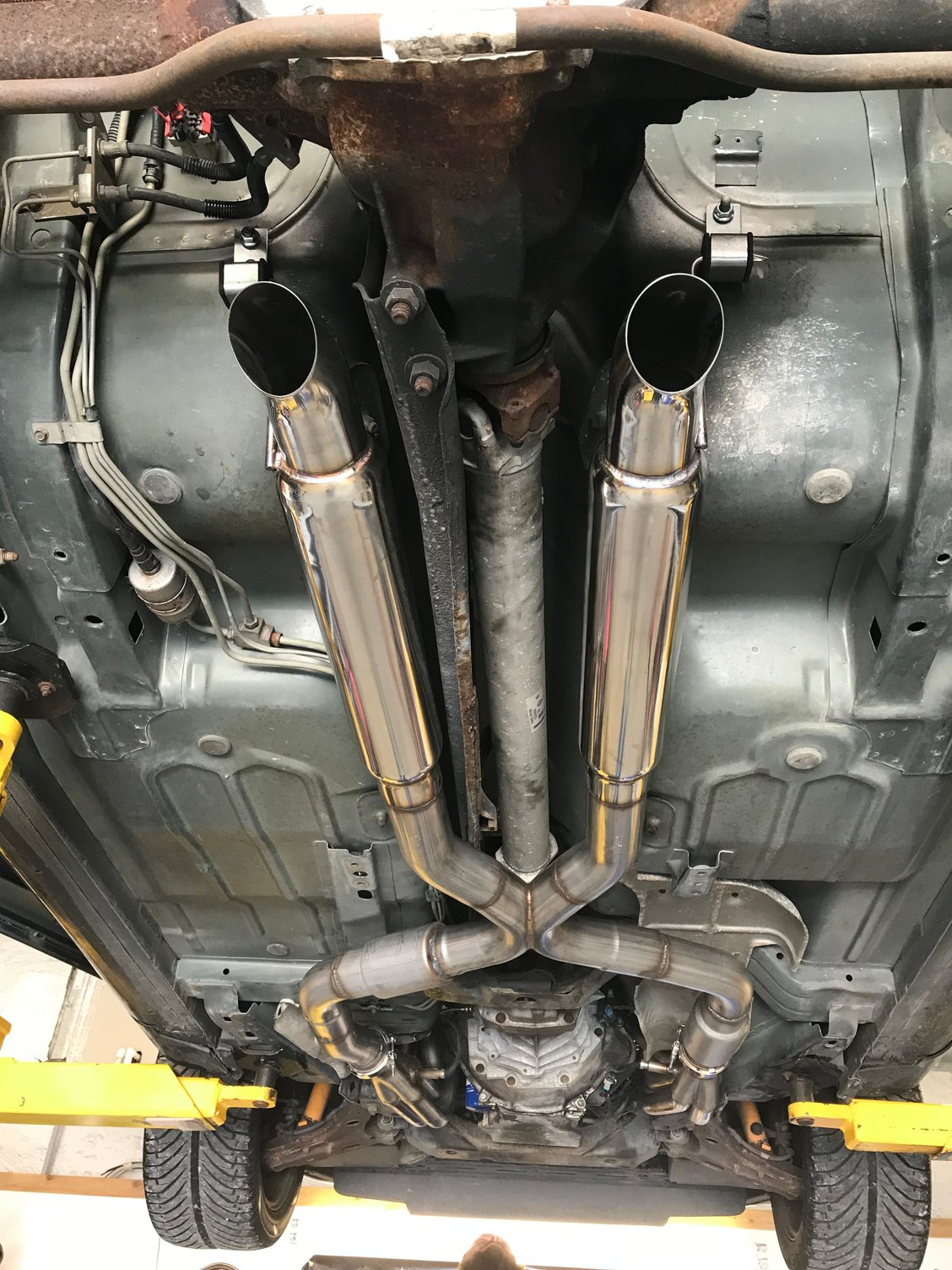

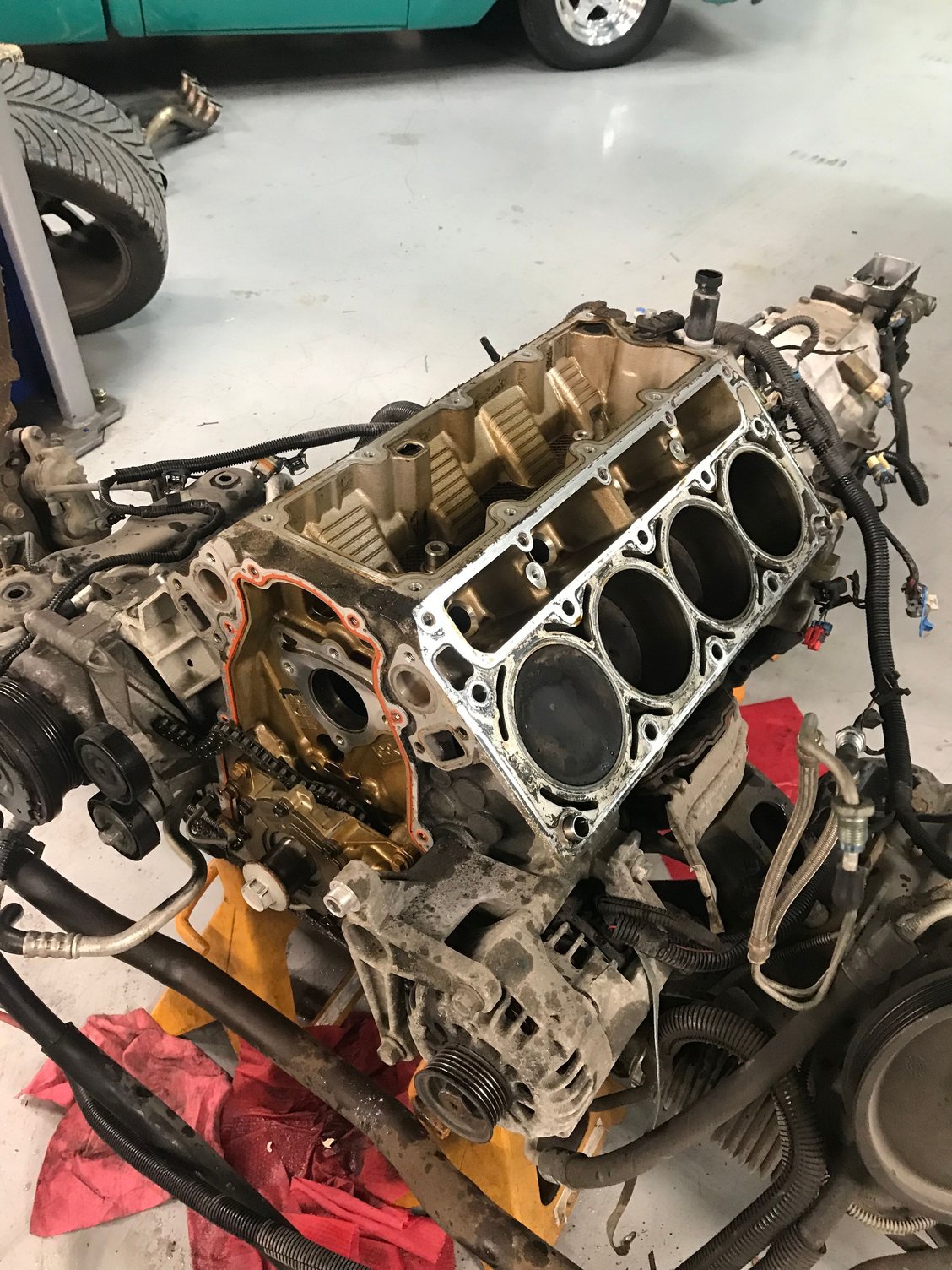

Texas Speed Long Tube Headers 1 7/8 with Texas Speed Rumbler exhaust. Had Dynomax mini bullets welded in-place of catalytic converters. Tuned, it Dyno'd (DynoJet) at 332hp to the wheels, so about 390.5 HP at the crank (HP / .85). Didn't get a printout with the torque, only HP.
Then the rats nest began for the top end build...
Rats nest....

ATI Steel 7.530", No underdrive, with A/C pulley
BTR LS1 Stage 4 Cam (235/242 .621"/.592" 111+3)
.660" BTR Platinum LS Spring kit, Titanium
7.400" BTR Push Rods
GMPP Crankshaft Damper Bolt
ARP Cam Bolts
Katech C5-R Timing Chain
GMPP LS2 Single Pole Cam Gear
LS7 Lifters
Trick Flow 215 Cylinder Heads (64cc) (Blend Valve, Soften Chambers by BTR)
FAST LSXR 102mm Intake (port matched by BTR)

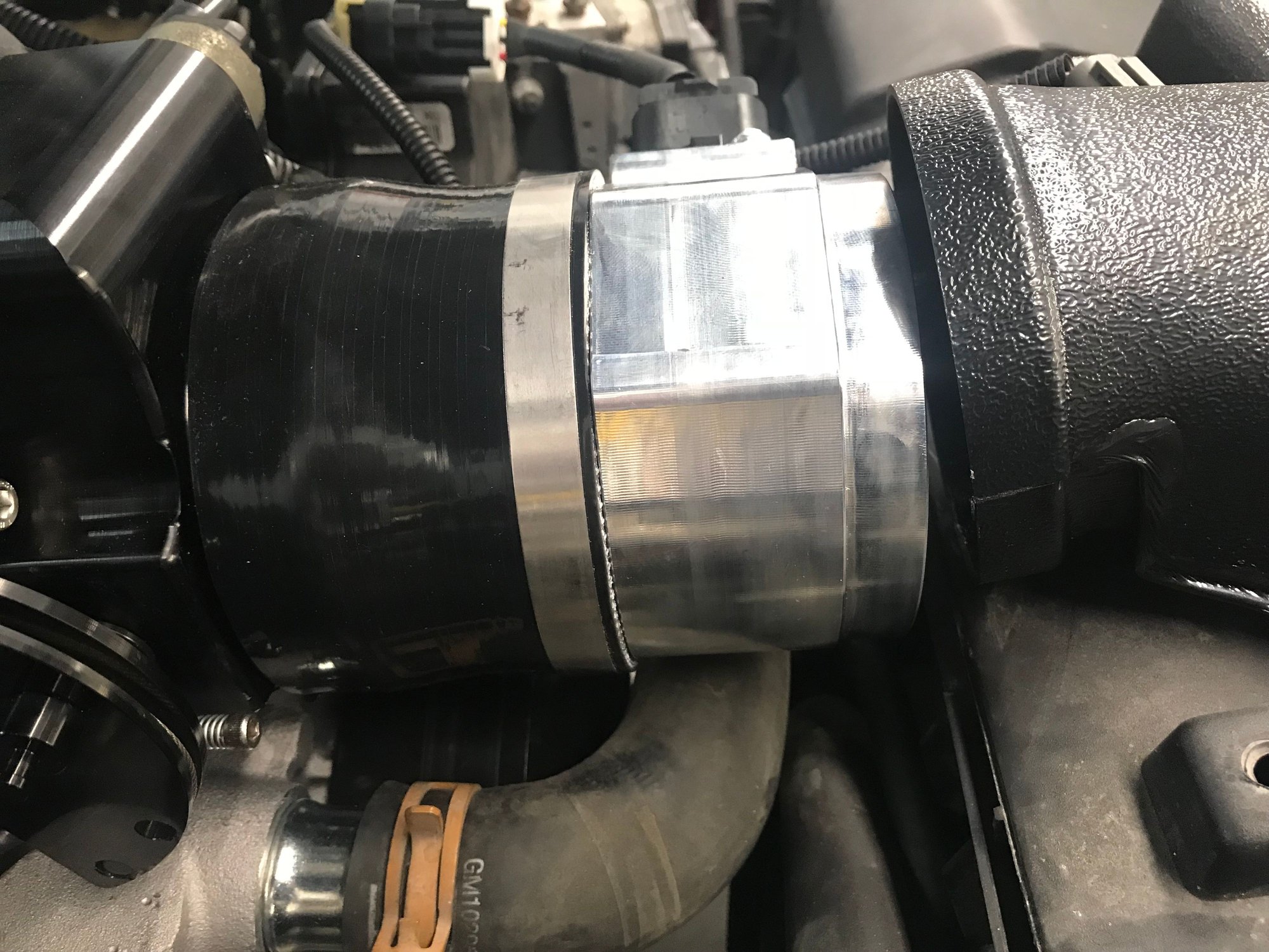

TSP 100mm MAF
FTP 104mm Lid
ARP Head Bolts
Chevrolet Performance LS1 Multi-layer Head Gasket
Nick Williams 102 Throttle Body drive by cable
LS1 Rocker Arms w/ BTR trunnion upgrade
Melling Oil Pump (10295)
FAST Billet Fuel Rail (red)
DW 42# injectors
Mighty Mouse "Wild" catch can
LS1 Cam Cover
FAST Fuel Line kit
Mechanical LS1 water pump
SLP 160* thermostat
LS6 valley cover
GM coolant crossover
Katech belt tensioner
...and it so it started

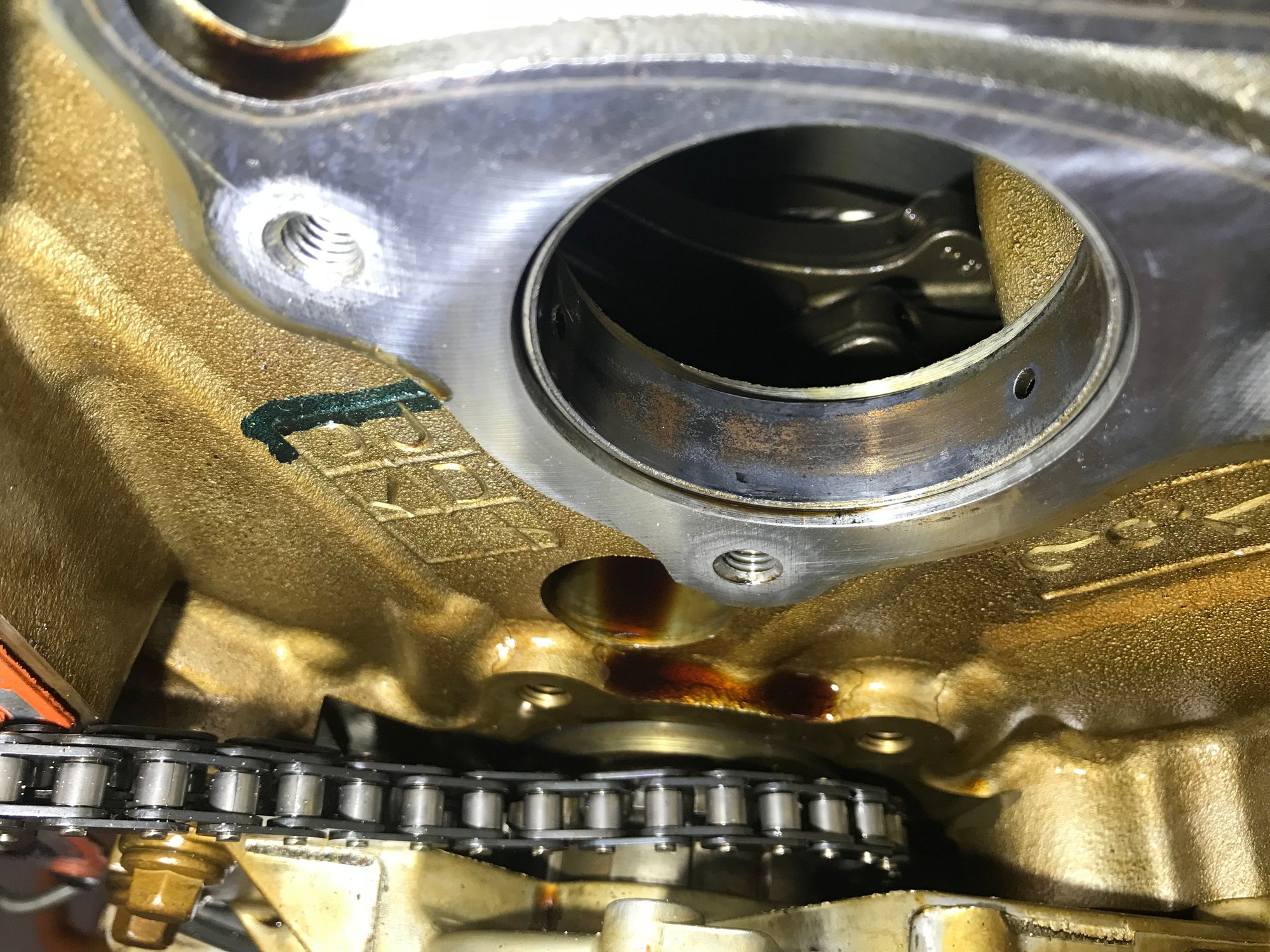

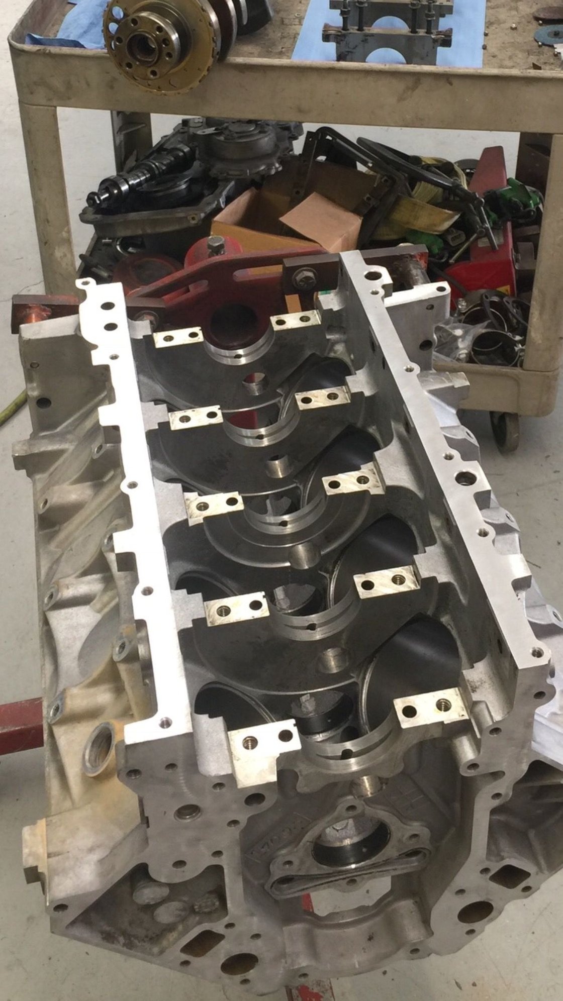

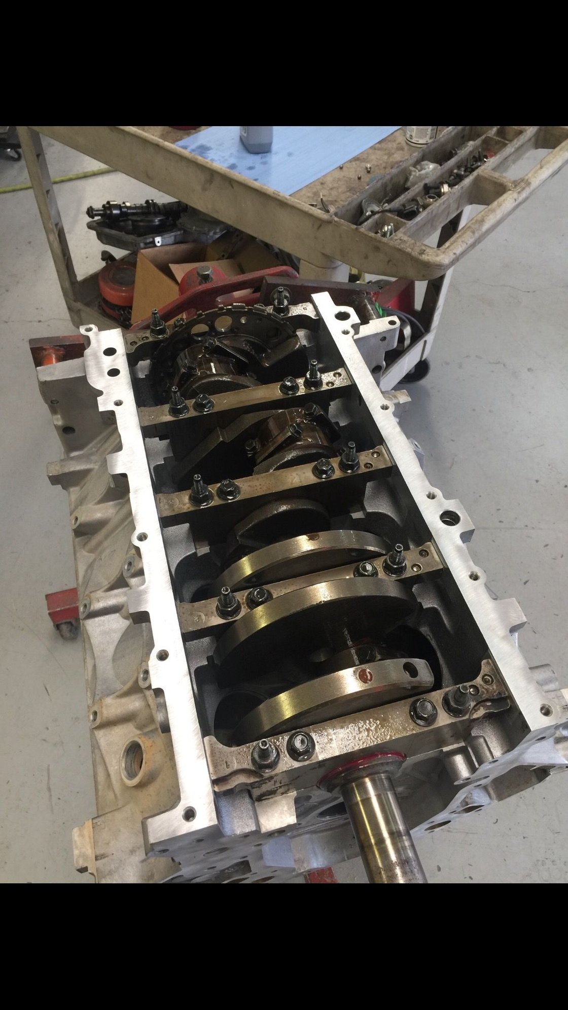

Cam Bearing showing wear...it was replaced

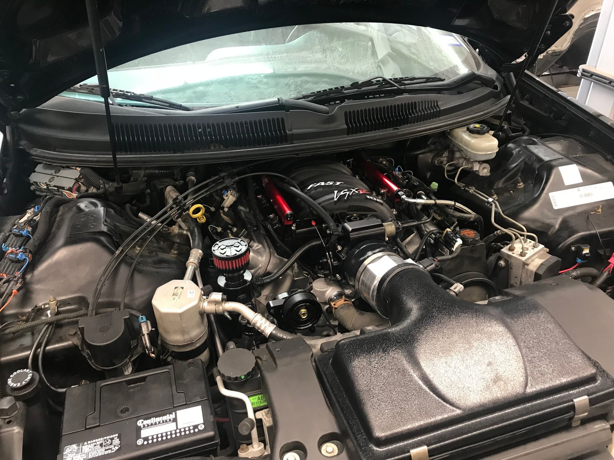

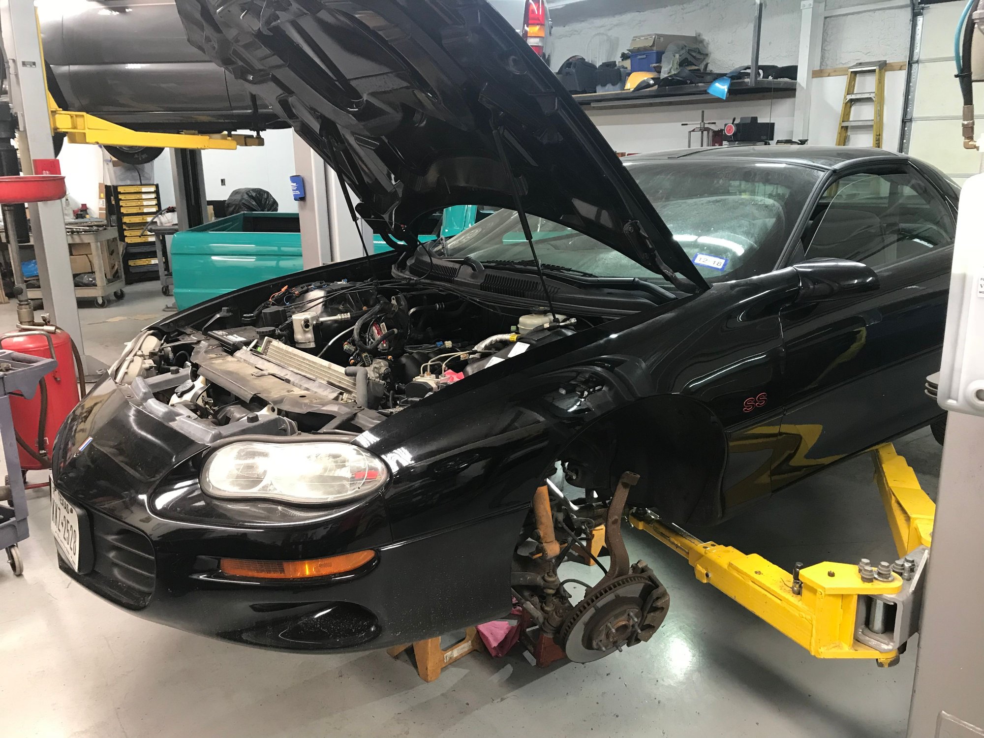

Ready for start up........

On the dyno jet, after top-end build....470hp at the wheels (approx 552.9 HP at the crank HP/.85), on a DynoJet. Again, did not get a torque print-out. Though 423 torque is seen in the video. Overall, I love it, and cannot say enough great things about the shop and shop owner, Billy. very little stutter/surge, but that can be worked out after i get the drive line beefed up. Next thing to try and do this year is new tires. Stock 10 spoke 17x9 and thinking of Nitto 555. Then a complete audio rework with JL Audio and either a Kenwood or Pioneer double din. And that will complete this years agenda. Next year is drive line with McLeod clutch, Texas Drivetrain Performance worked over T56, and a new rearend (and maybe driveshaft)....maybe some chassis and suspension thrown in there along the way. I'm not going to be taking it to the track or driving like a scaled ape, so i figure cruising around, the current drive line and suspension will hold fine....And now the wait...hoping that the anxiety doesn't kill me, to start having work done again.
