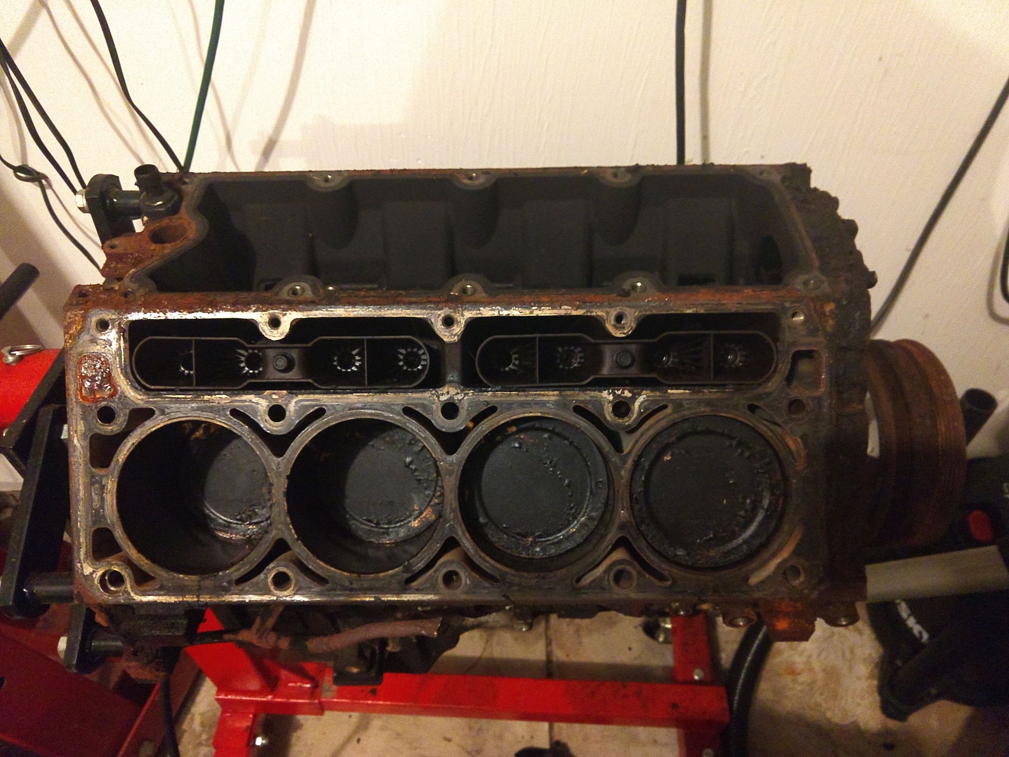

Working on a swap and picked up this LQ4. Mileage unknown but yard thought it was at 220k when van rolled in. In good enough condition to send it after replacing rings, bearings, and oil pump or is this crusty old girl in need of a bore and full rebuild?

The few 6.0’s I’ve done at work have had some water spots that wouldn’t clean with a ball hone. Probably wouldn’t have had any issues, but being do it once kinda guy, just thrown them in the rigid hone and took them out .005 oversized and ordered a set of ls2 .005 over pistons. Beats setting up and boring .010-.060 over and cuts out some of the “might as well” snowball.

dont put bolts in it unless you plan to resize the big end
i have yet to see a failure due to stock rod bolts.
clean the ring lands up by dunking in berrymans and send it

Any good way to clean the pistons without pulling them?

brake cleaner will clean the tops, but that isn't gonna help the oil coked rings. seriously just pull em and dunk 'em over night---one at a time-- in berrymans
