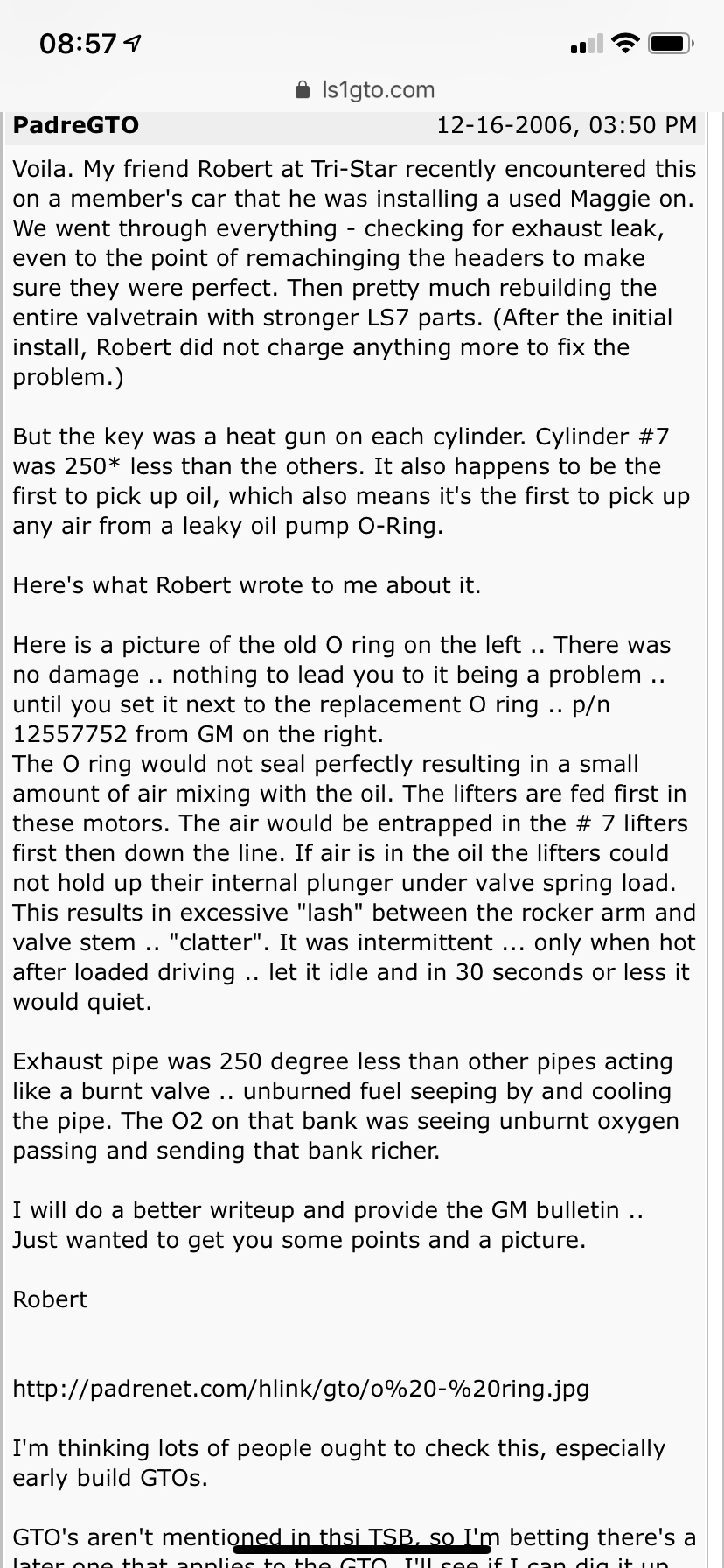

Small update. Took the truck to a mechanic and he looked at it for free which was nice of him to do. He said he definitely heard a tick on the driver side rear, but he couldn’t tell if it was lifters or rockers or what. Attached is a screenshot from another forum, where he said cylinder seven lifter is the first one to get oil, and if there’s air in the oil the lifter won’t pump up fully, causing too much lash and making a ticking noise. I went and bought an oil pan gasket and oil pick up tube o ring. Going to tackle it this weekend.

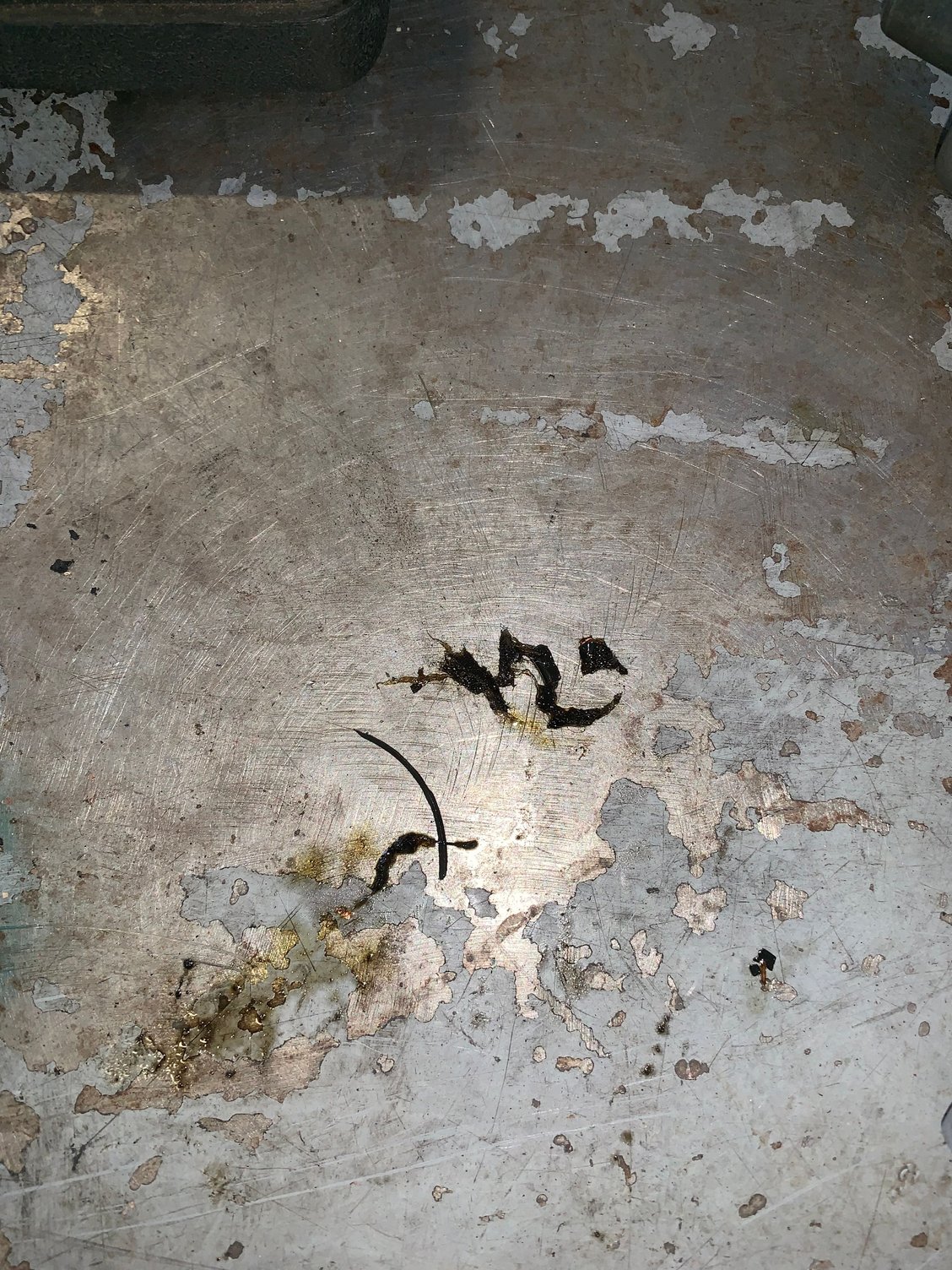

This is what was found in the pickup tube screen

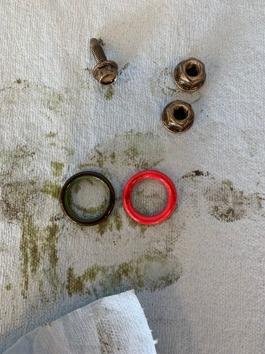

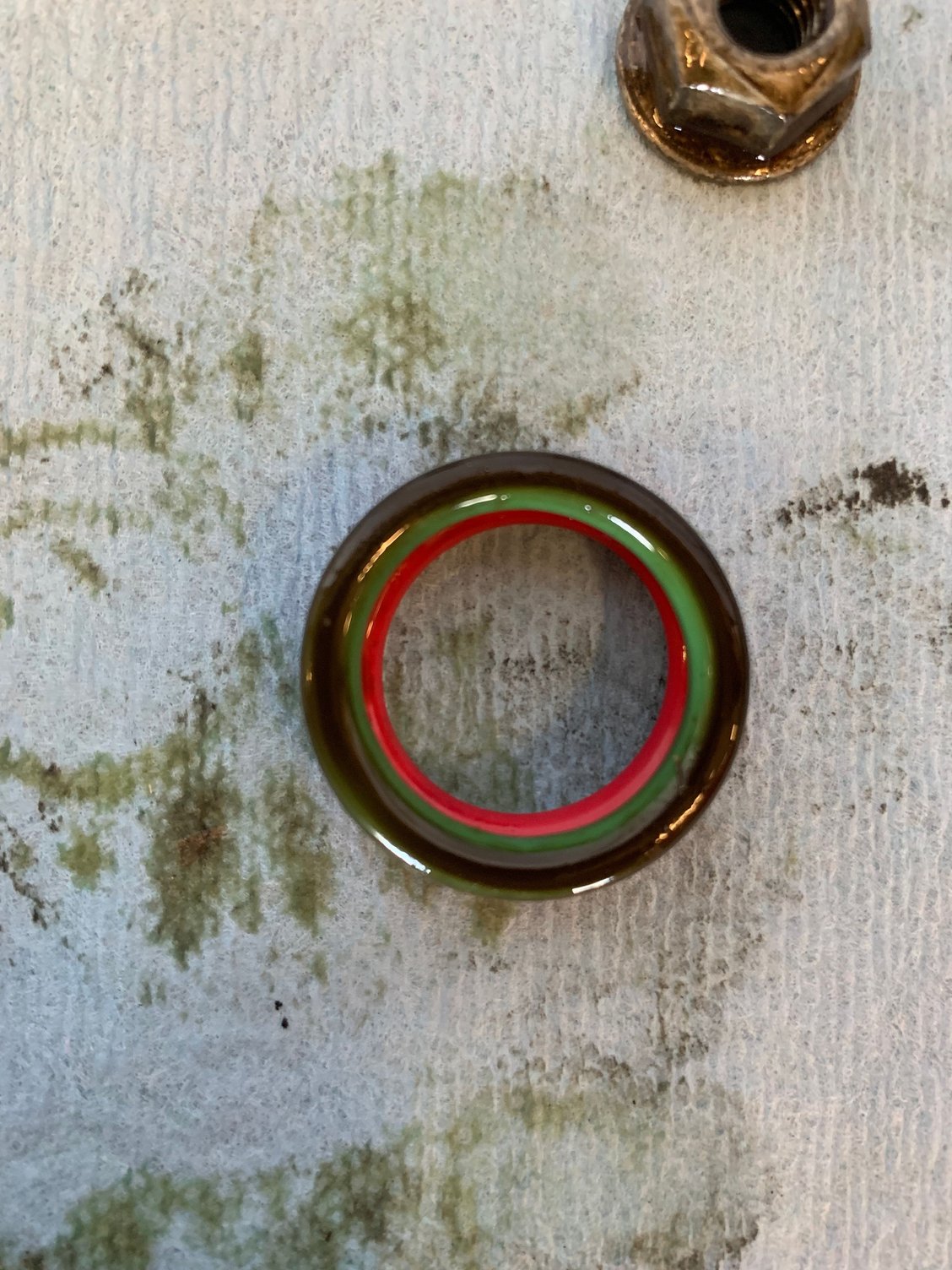

You can see the size difference, new one is the red one.
Everything was squared away and looked great.
Okay so an update. Got everything done and she still ticks. I’ll explain everything That was done and provide pics that were taken along the way.

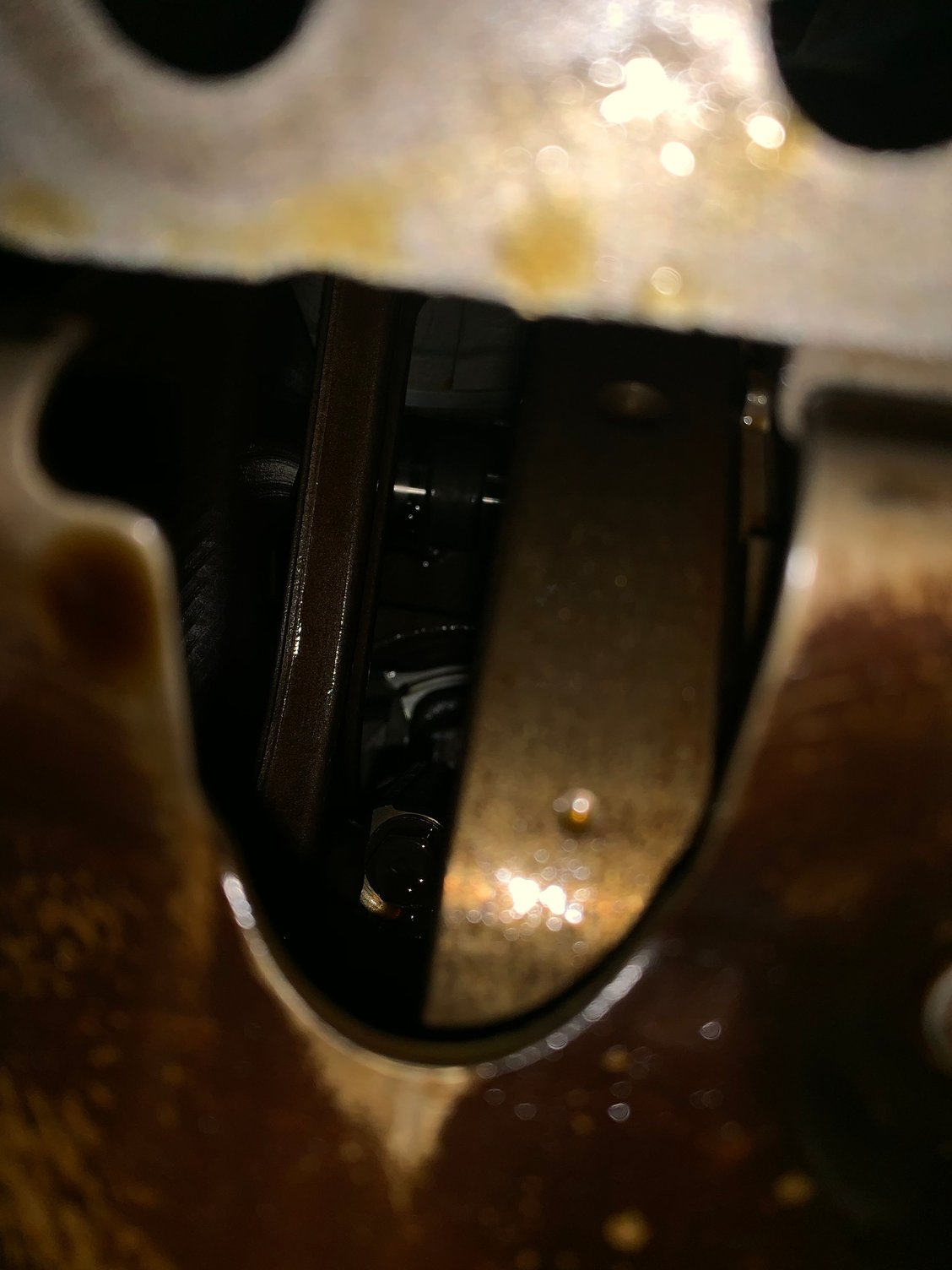

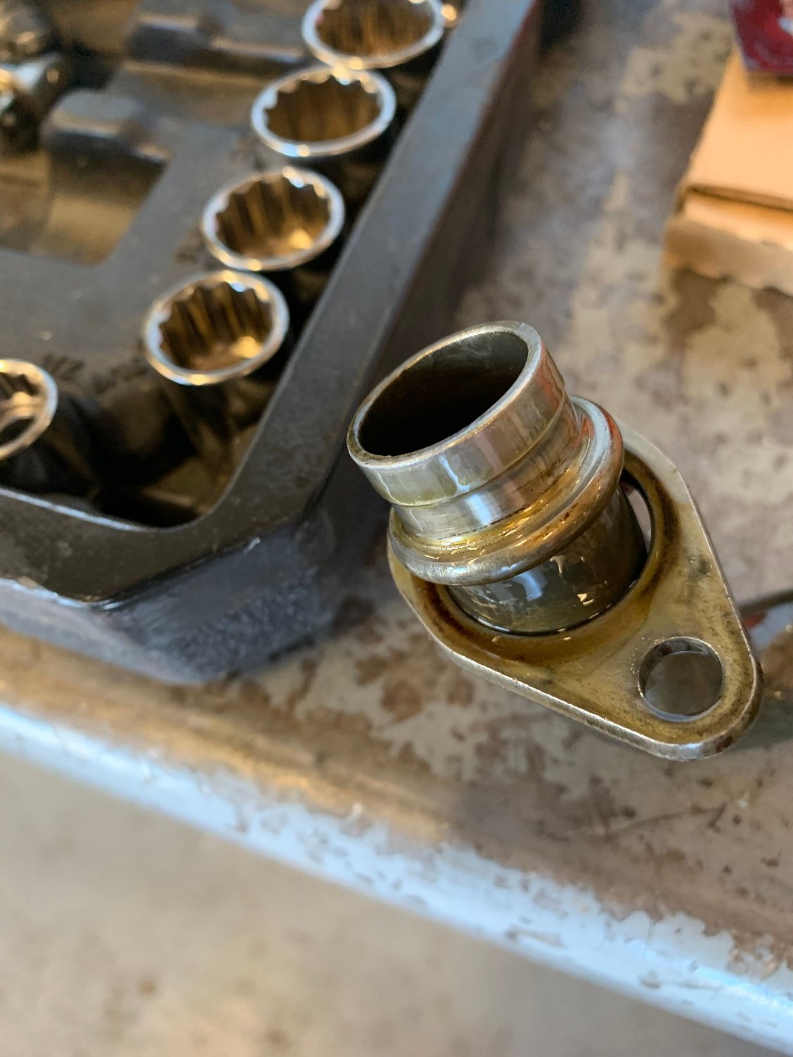

So I get the oil pan off and flexplate was dry so I know the rear main is solid still. I take the pickup tube off and i take the o ring off and place it next to the new one, and I can visibly see it’s a skinnier sidewall than the new one. My pickup tube happened to have an Indent and I know some do some don’t, and with the indent you need the thicker o ring, which I used. I lube it with fresh oil before sliding it on, and it “popped” and slid in before I even put the bolt in. I really genuinely thought this would be the problem. No bearing material or concerning metal was in the pan, but I pulled some stuff out of the oil pickup tube screen. It still ticks. I’m baffled at this point. Literally only other thing it could be is the rockers. That’s the only stock part left in that motor. LOL

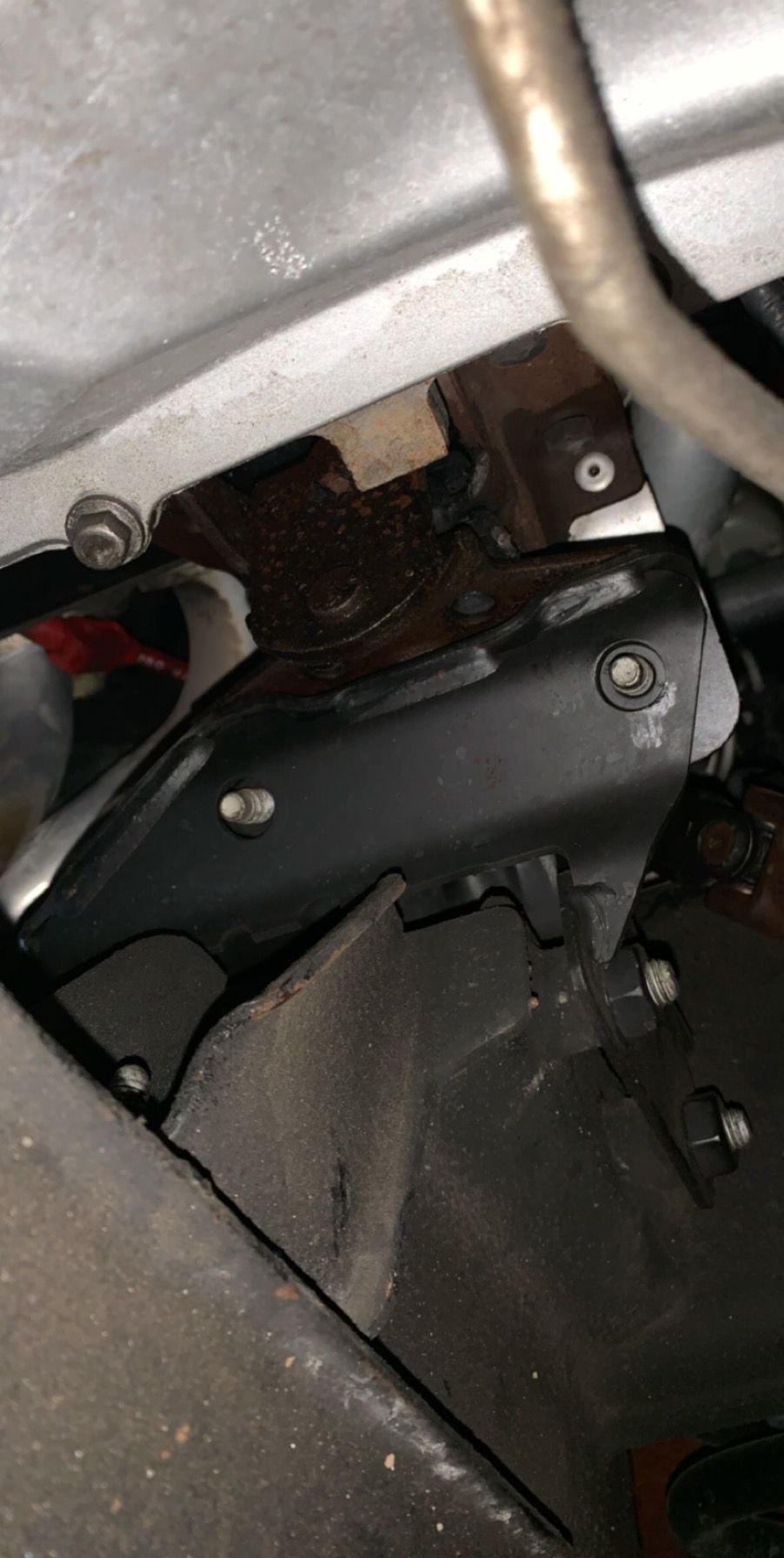

I also
I also discovered I was missing both nuts on the driver side engine mount. Doubt this could cause a rattle but I was in a hurry and I forgot to put to new bolts on.

Doesn't look like nuts go on there. Most likely there are threaded bosses there and you're just seeing the threads that hang through.
