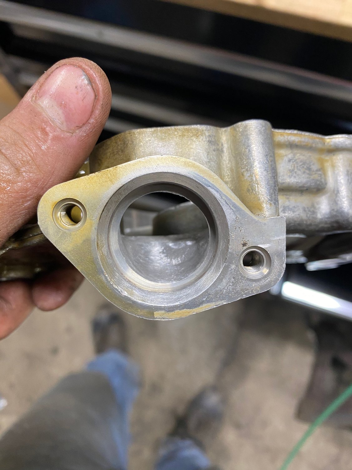

You know i thought there was alot of room for improvement in the oil pumps to till i talk to the guys that built hammers 388. They give me the part # to the one they use and said they didn't do anything to it. So i left it alone.

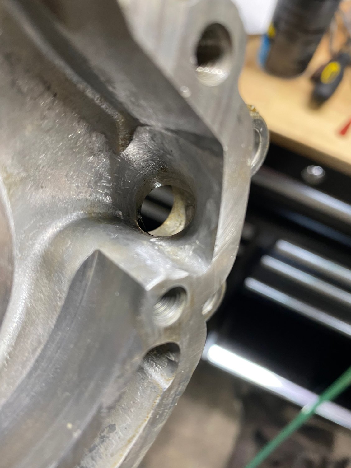

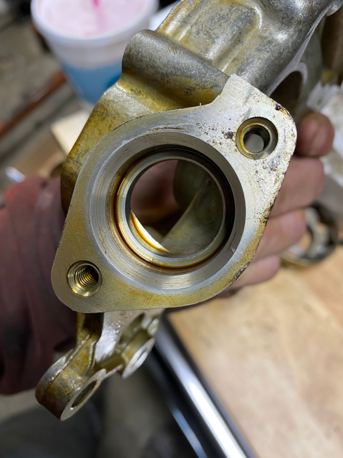

I’ve seen too many posts of people with all
kinds of frilly oil aiding items still losing oil pressure up top on pulls to believe there aren’t some serious issues with these things lol. I’m curious to see how this things does with a ported Dod pump and an external regulator
the schauman pumps are what Gave me the idea, I’m going to call them tomorrow and see what they have for regulators

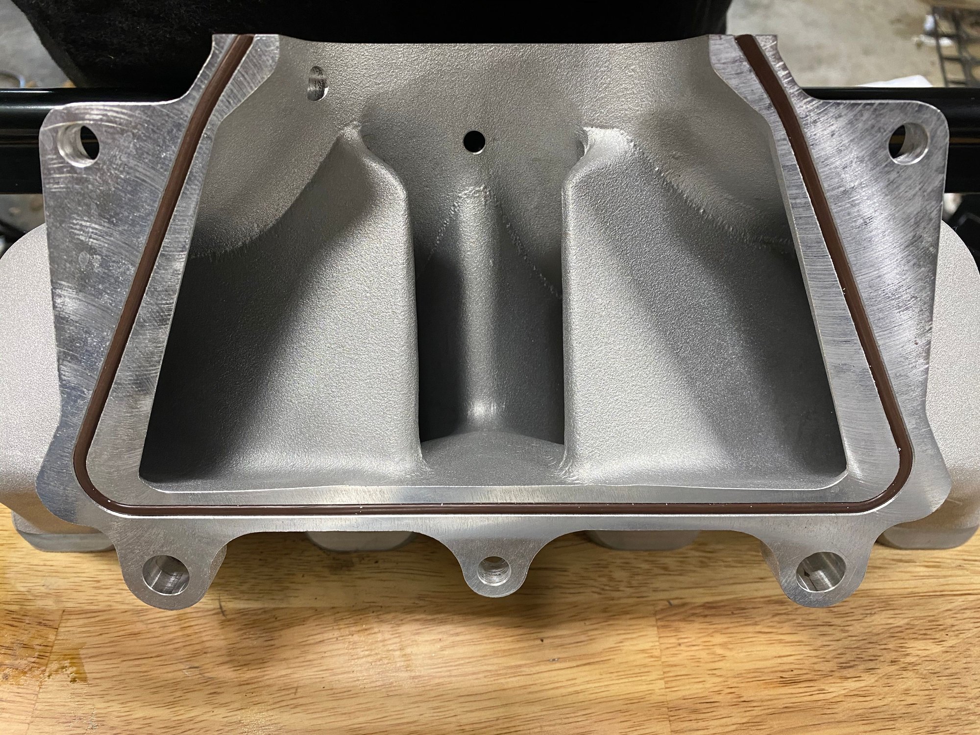

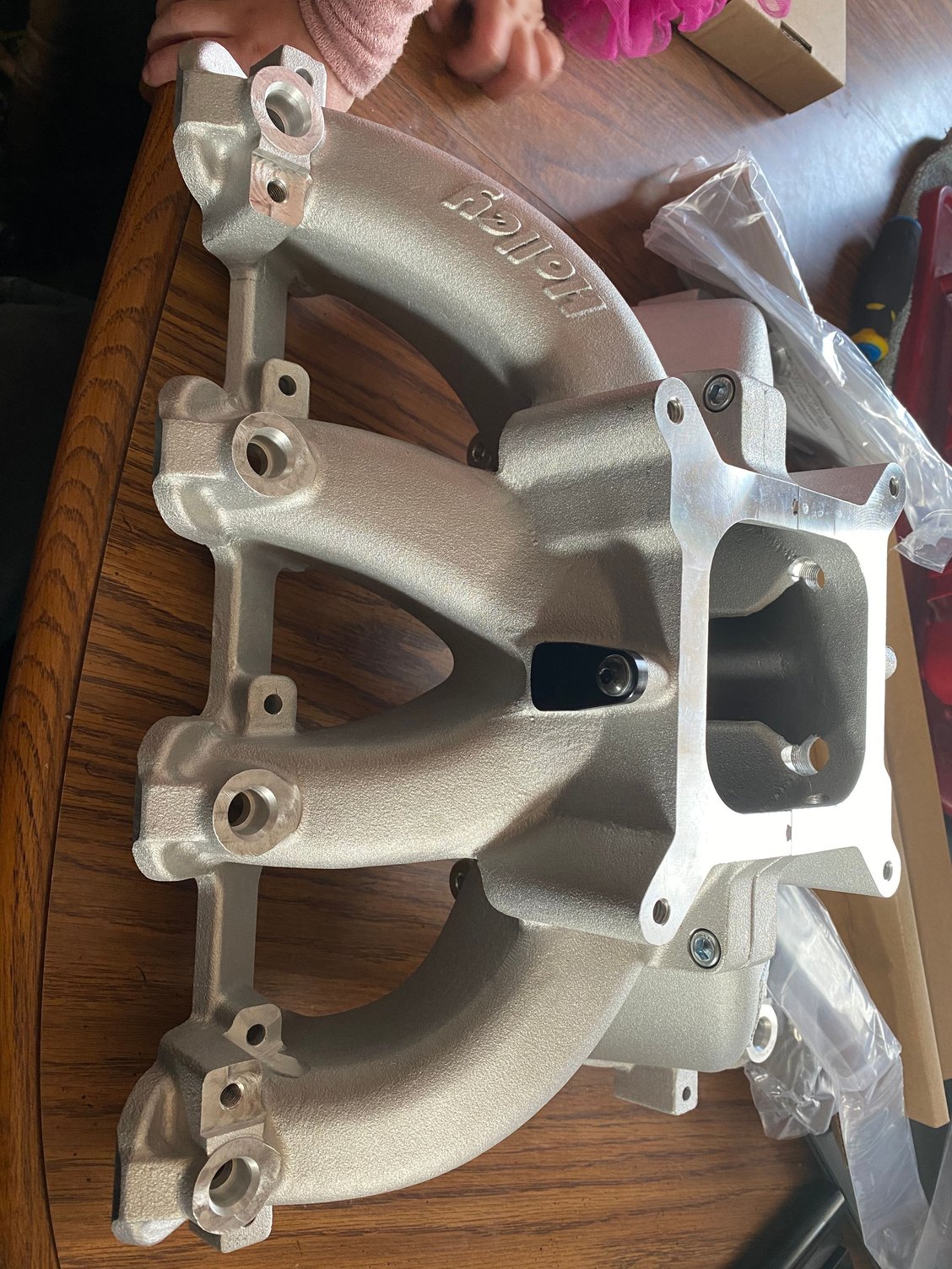

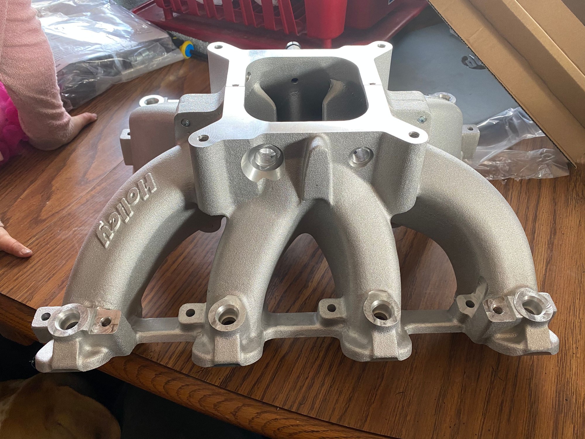

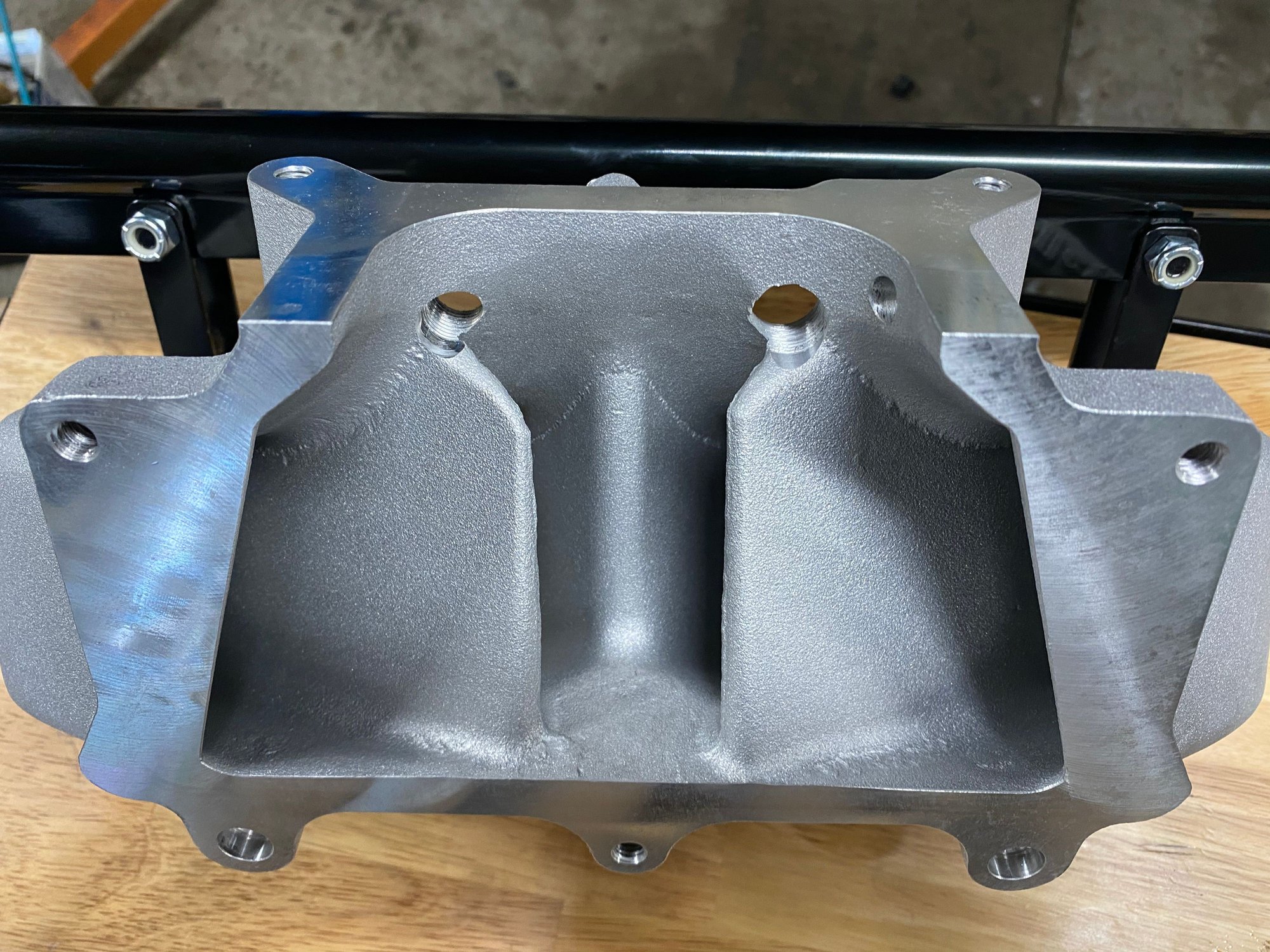

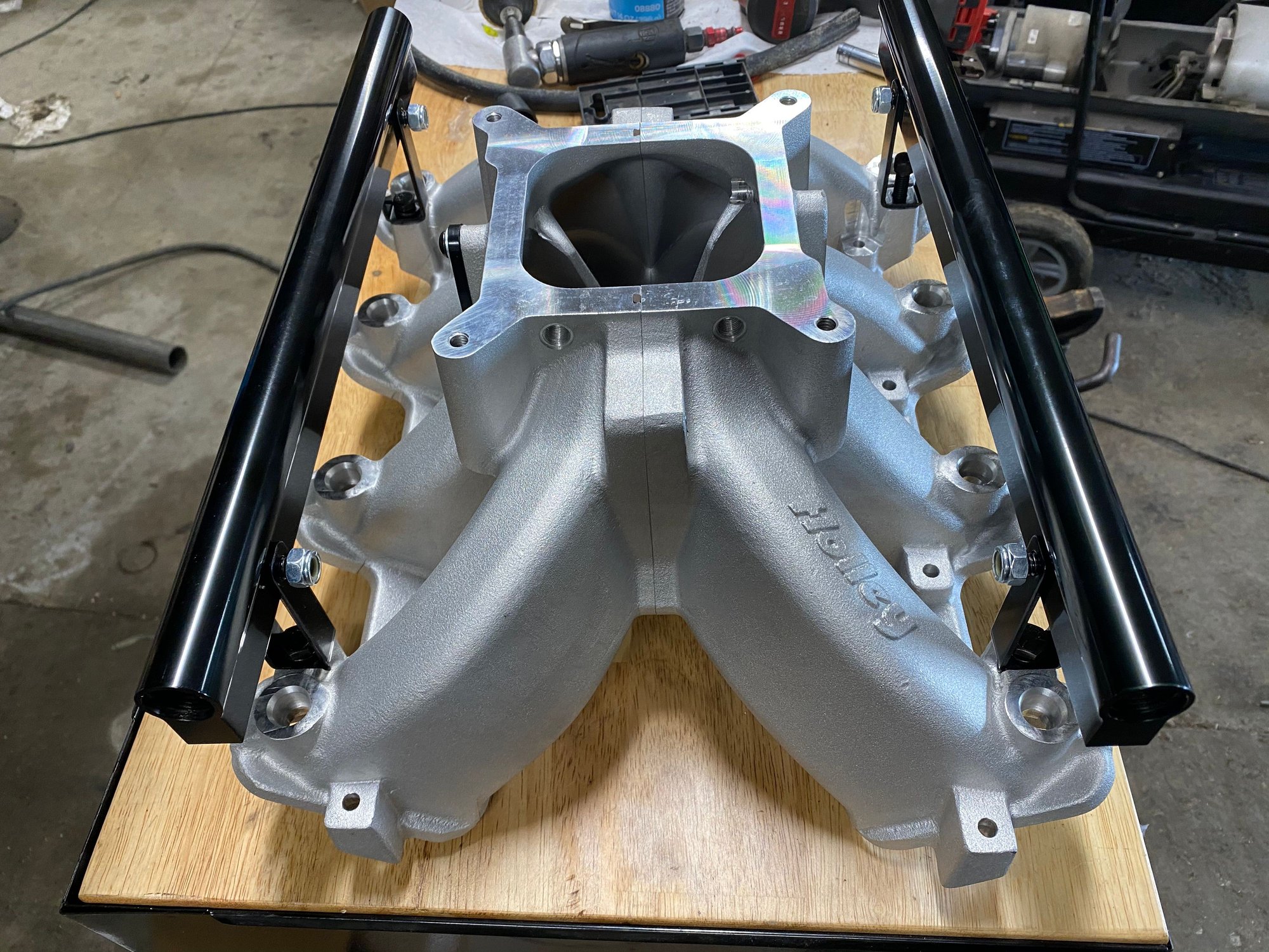

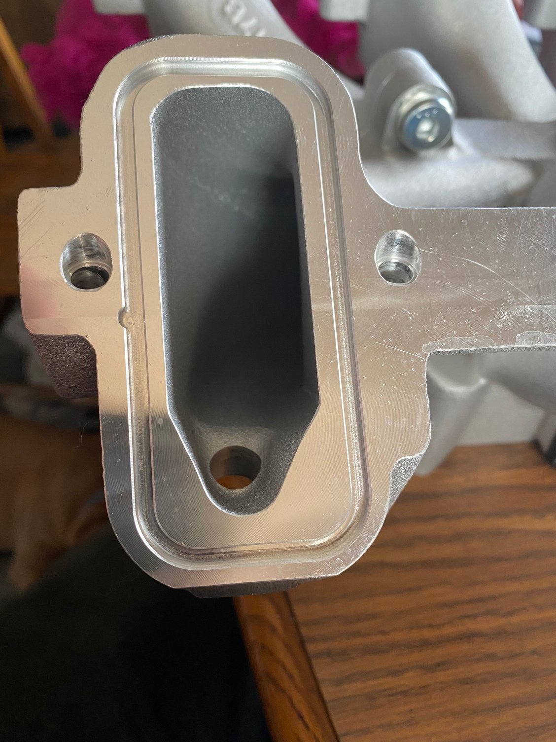

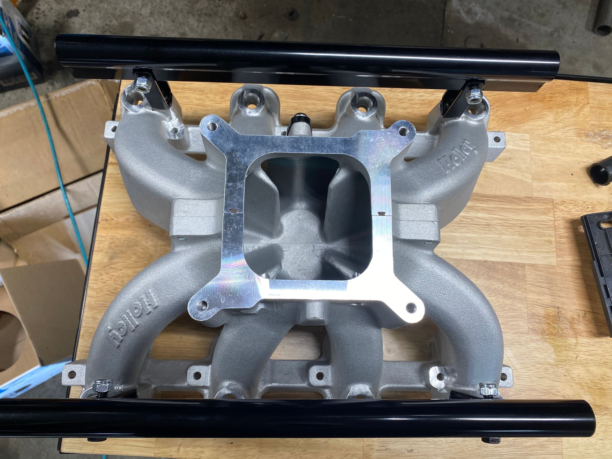

Intake looks like serious business

Yea the pump they recommended was a dod pump. But it was a gm part.

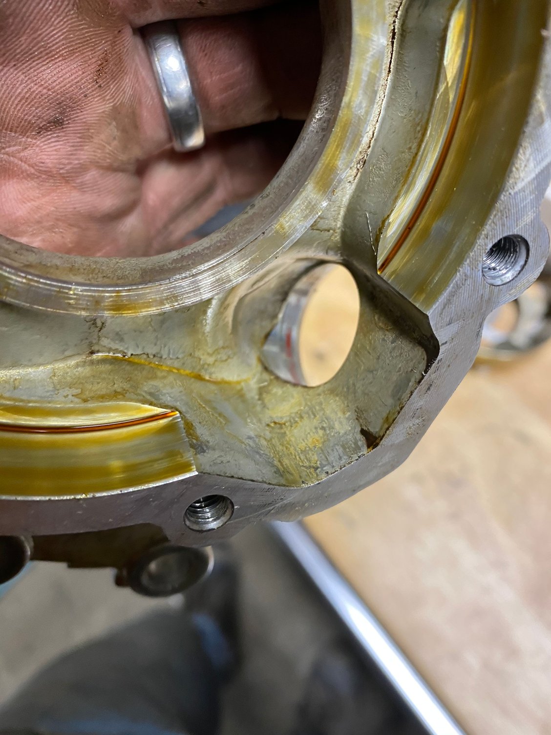

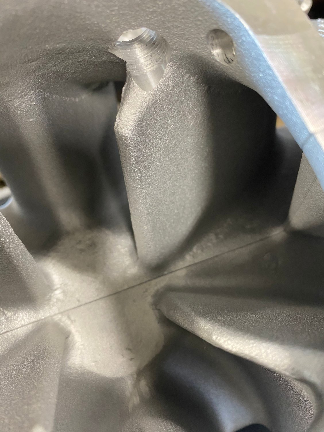

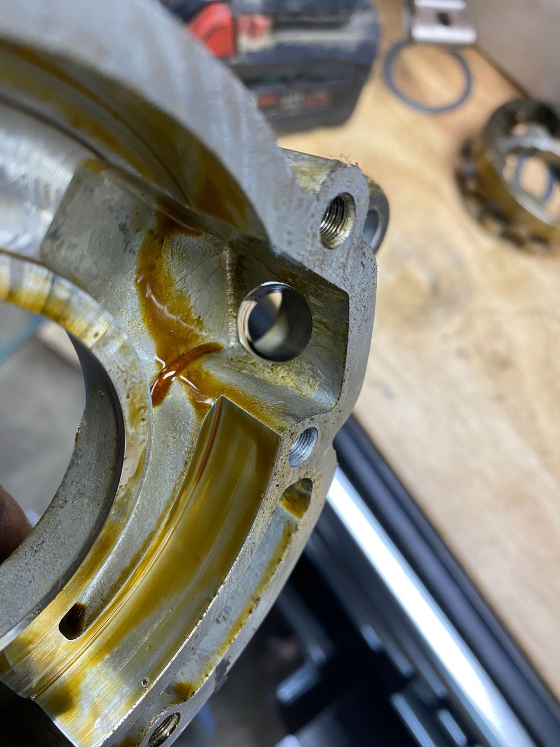

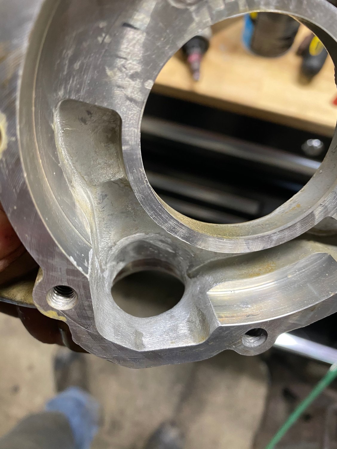

Hmm that’s interesting. I ported a stock ls did pump and I’m using that. Here’s some pictures of what I did, hard to tell but I did a ton of blending on the outlet transition, it was very abrupt before.
You could probably do it but you would need a angle drill.
Looks good cwarta.
Agreed, going to be a pain either way. and thank you!

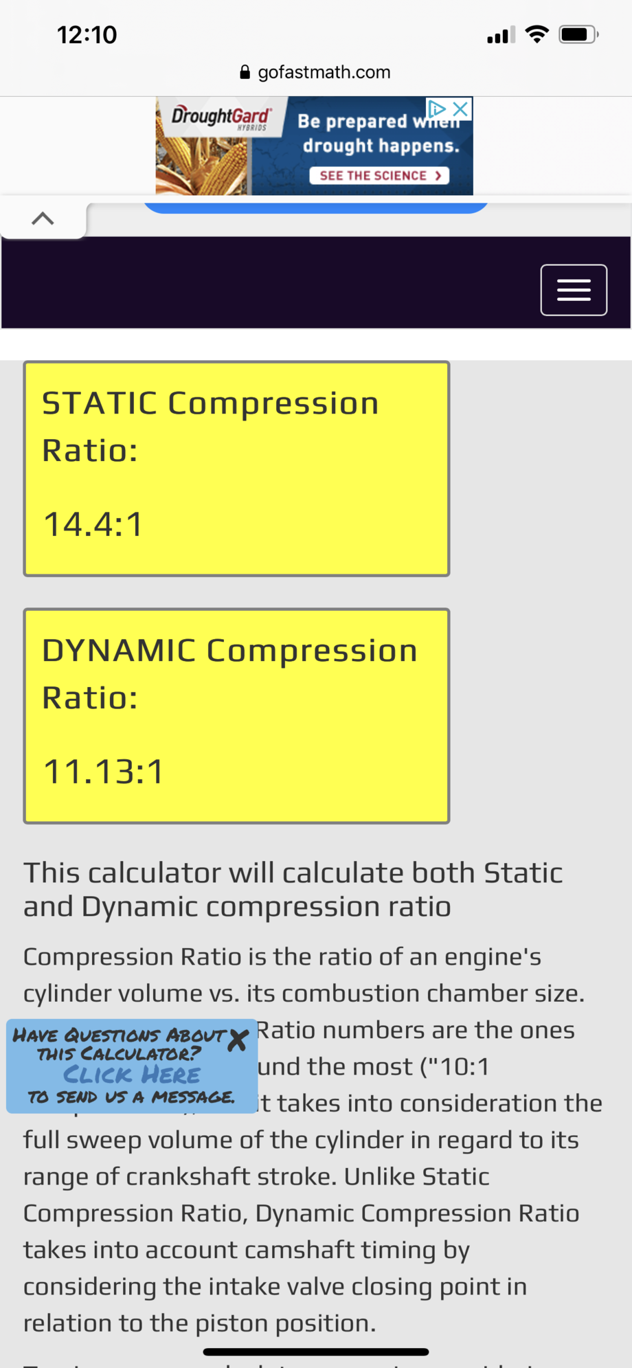

If I deck the heads another .020
these would be my new calculations.

You have to watch milling the heads that much with dome pistons. That's one thing that steered me away from a piston like you have. The ones i seen only recommended very little milling. And these gmpp heads were already milled .055. We milled another .035 off them. Stuff requires some fitting after going that far plus the .010 off the block.

Possibly have to do some work to the pistons and intake manifold and its going to be healthy for sure. Are you running alky on this or something like C16?
Thsts what the dykum is for, plan on port matching everything. Plan is e85 on it, worst case I’ll buy e98 in a barrel but I think I can do e85.
