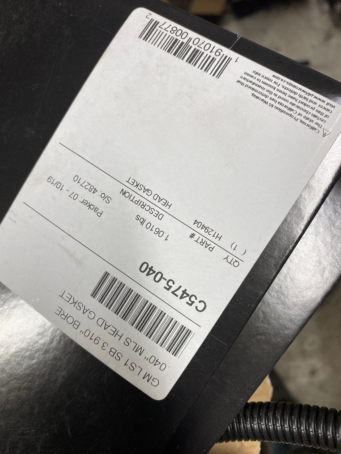

Headgaskets showed up today

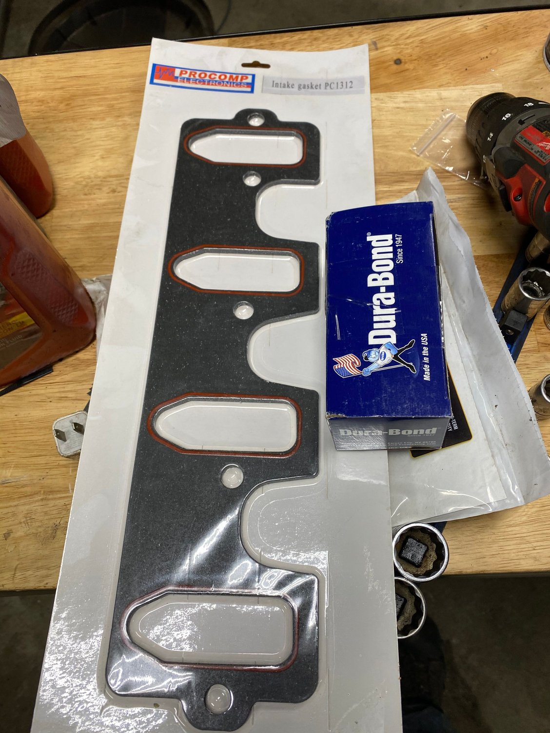

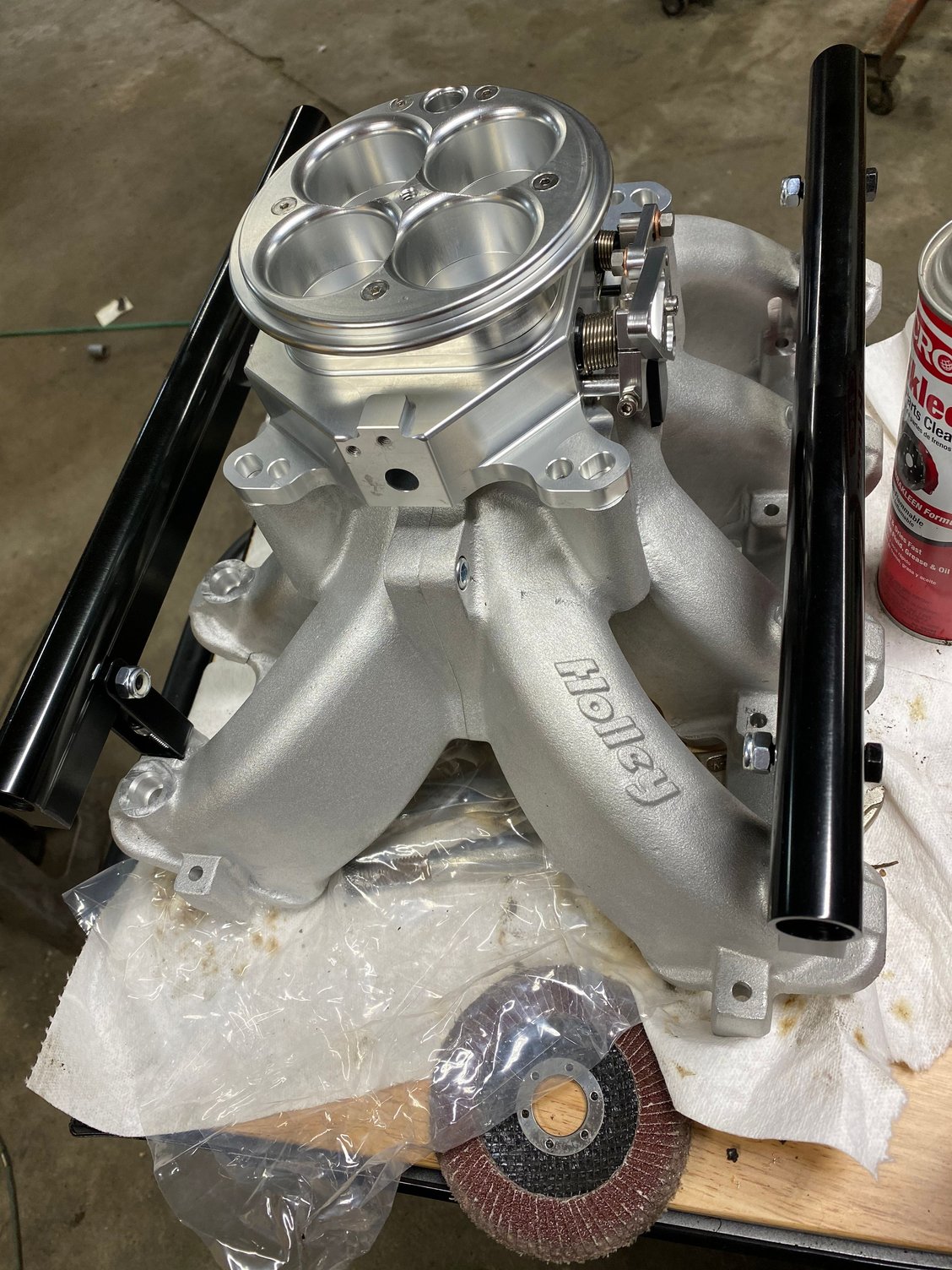

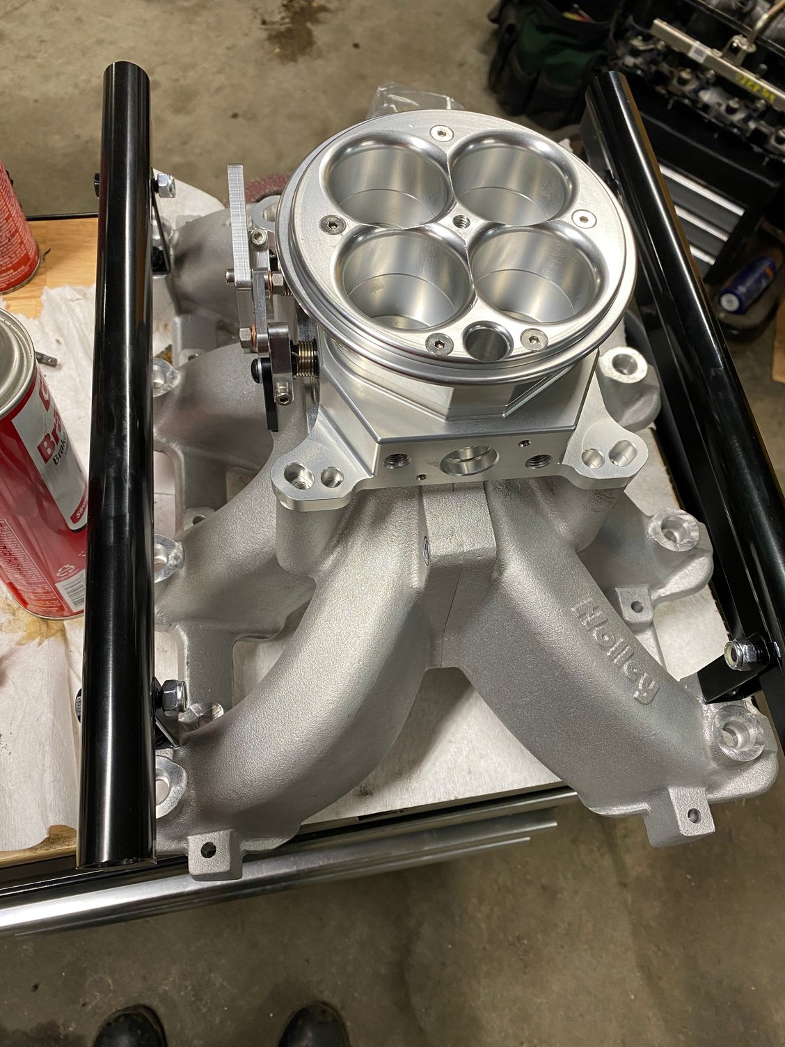

My cam bearings, intake gaskets for port matching, and my throttle body showed up.

  #56
HioSSilver's Avatar
Joined: Aug 2002
Posts: 6,128
Likes: 645
From: Winchester, VA
That's like ****
Old Mar 26, 2020 | 05:23 PM
  #57
Cwarta's Avatar
iTrader: (12)
Joined: May 2012
Posts: 1,796
Likes: 59
From: Elm Creek, NE
Originally Posted by HioSSilver
That's like ****
Agreed, it looks damn good. Can’t wait to fire this beech. Ordered my springs and my ferrea valves today, about all I’ve got left is my pushrods once it’s assembled.
