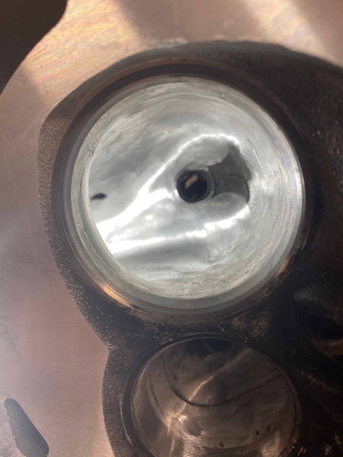

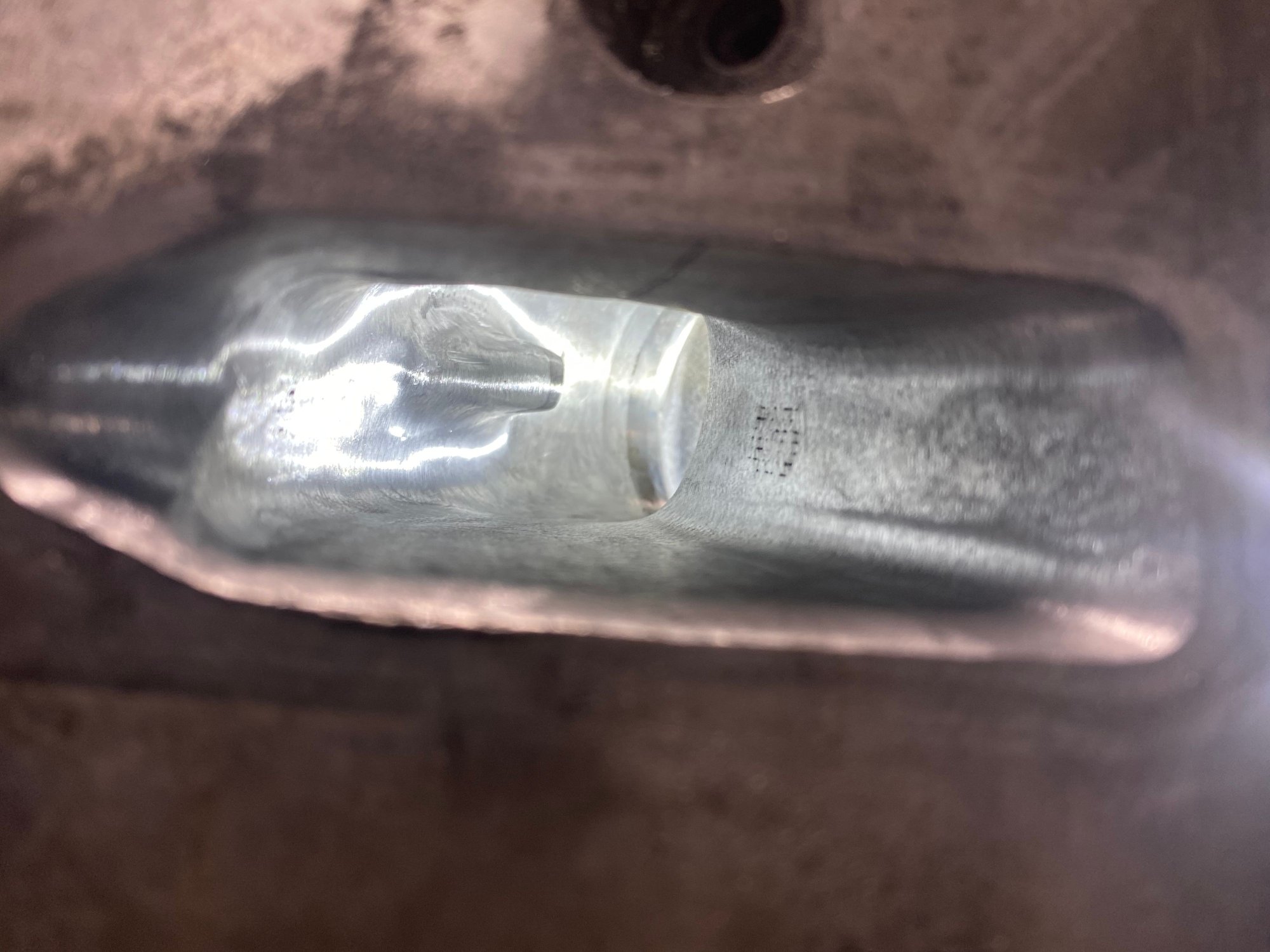

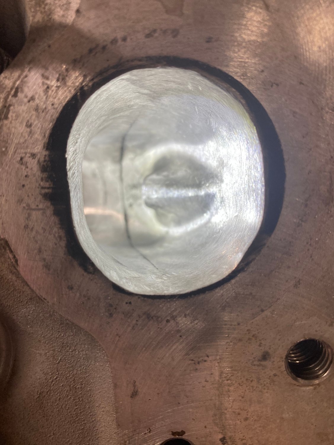

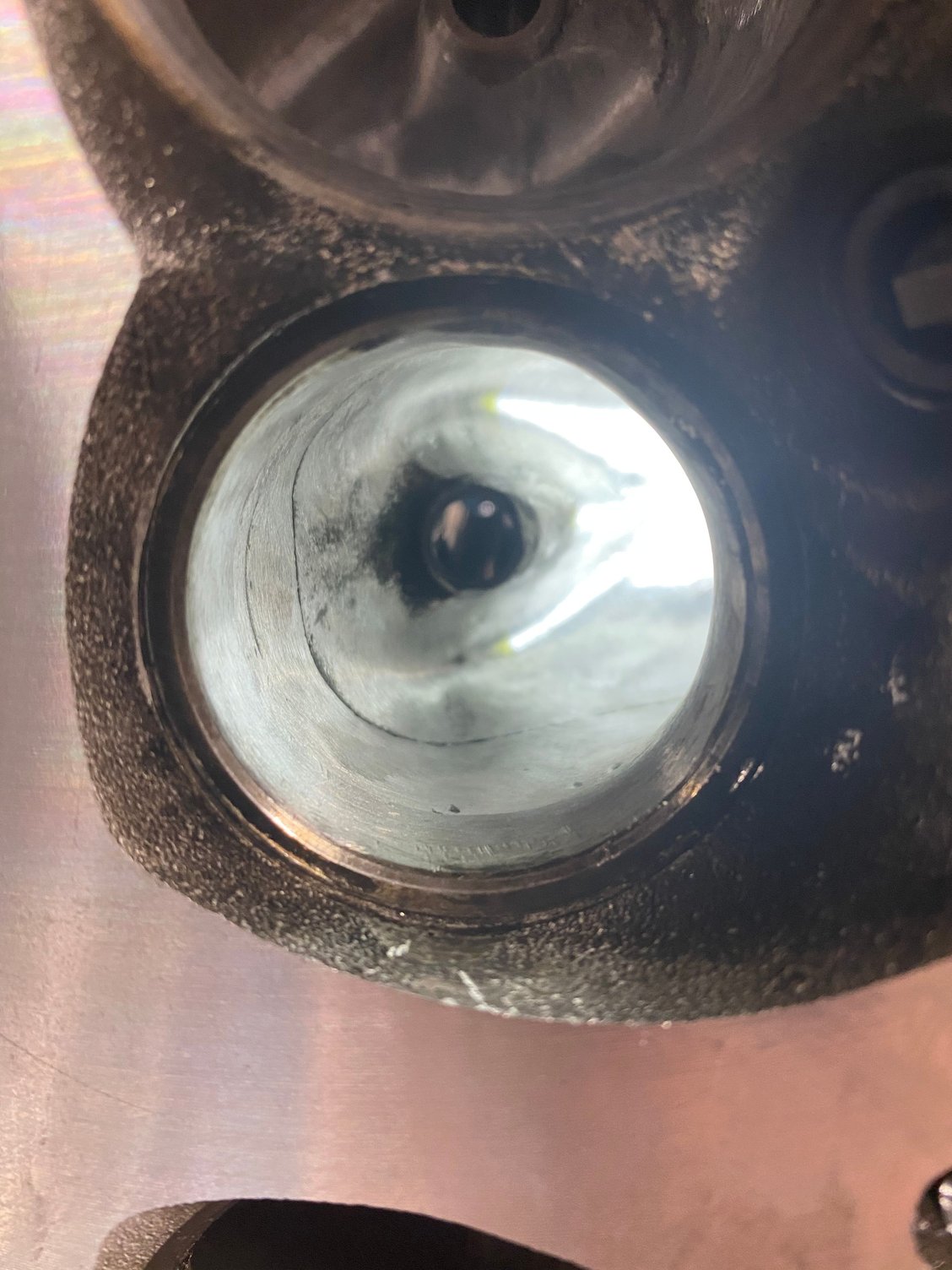

Started on the heads tonight. Got them roughed in, still waiting on my finer paper and cross buffs.

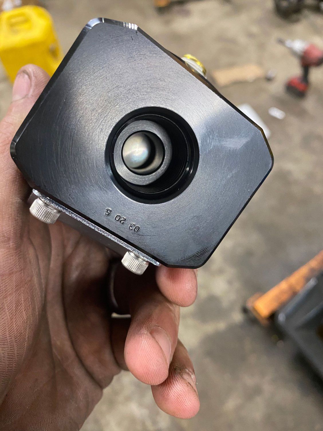

this big old honking reg showed up showed up today for the oil regulator, they were nice enough to send me this sweet banner

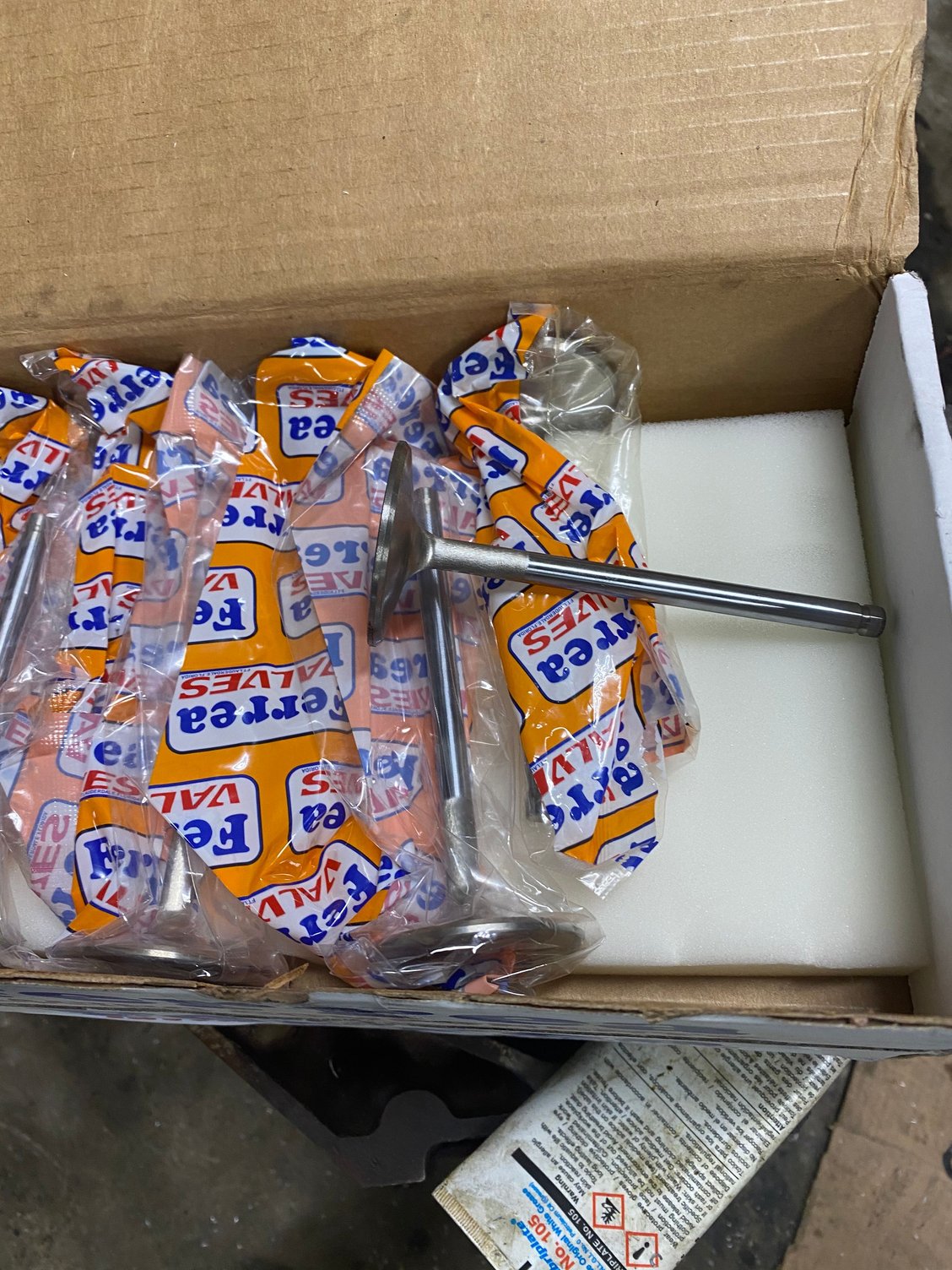

Valves arrive d
I have some 241's here that I wouldn't mind taking at shot at hand porting. Been watching videos and gathering as much information as I can on the process before attempting it.
Ive done a few sets now, this is by far the most time and aggression I’ve spent on a pair, they are coming along pretty nice. I’ve got one side pretty much done

Yeah I see you went into the rocker arm stud bosses when opening them up. So you have to use the PTFE thread sealant on the intake bolts but I've wondered how well that works.
works good, I cut the bolts a little shorter too.

Haha, well it doesn’t make much sense to get rid of the hump and then leave the bolt sticking out in its place lol.
Maybe I'm keying on the wrong part of this post, but that's freaking hilarious. The guy who puts the sticker in the box grabbed the wrong thing i guess?
Haha! When I ordered the Reg it had a box to check for the free banner lol
