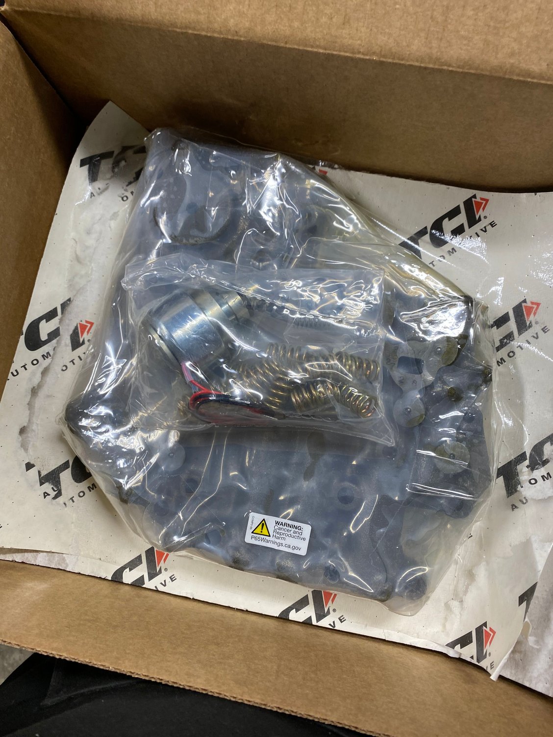

Ordered. Brake for this tci th350 I have.

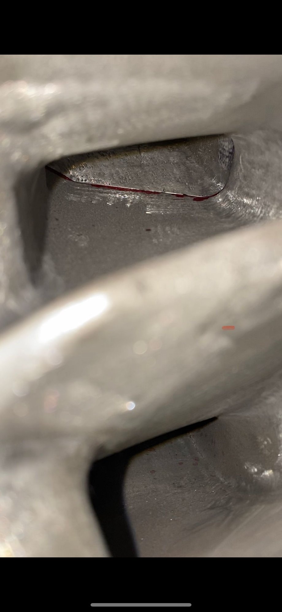

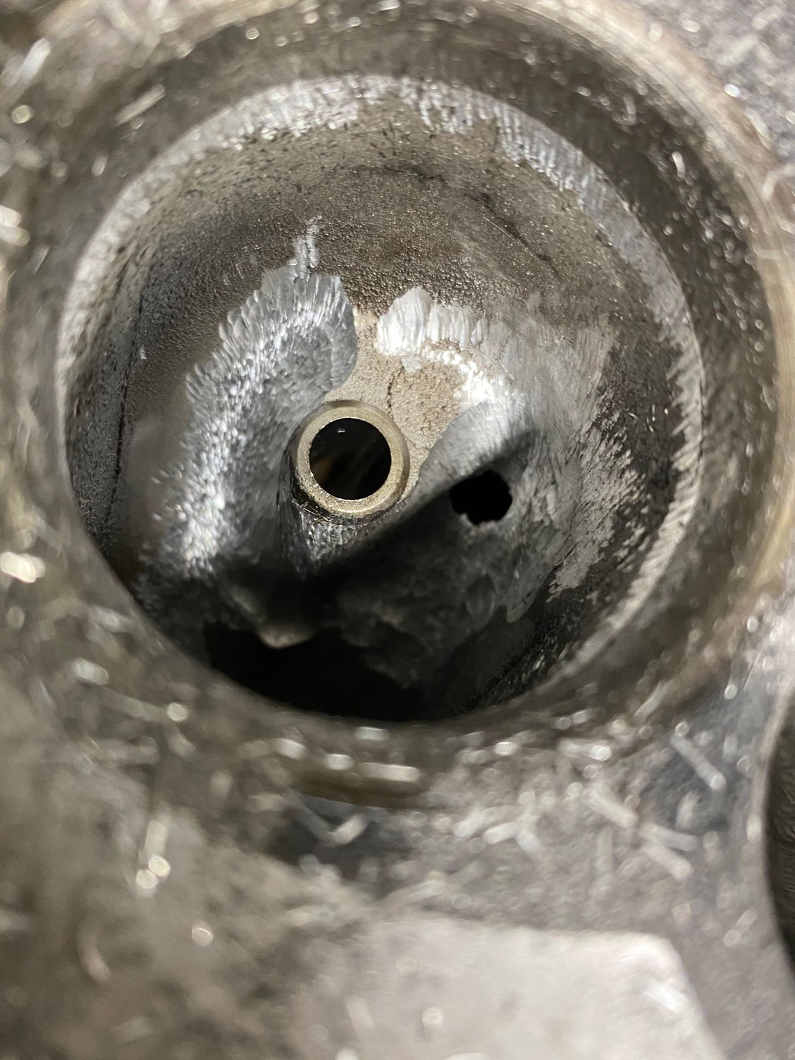

Well I was roughing in the last port last night night and then suddenly .......
luckily I was able to reach it with my tig and weld it up. Taking it to the machinest to be pressure tested today.

Oooooppss.....

Someone goin in deep!!

Yeeep lol. Last damn runner too. She’ll be alright lol.

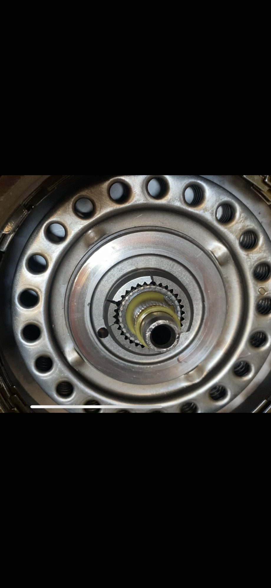

Well went to rebuild my tci th350 and install my brake, and found this lovely gem. Only supposed to be weak in third gear, I suppose this could be weak in all gears lol. As much as I couldn’t afford it, I knew I needed to upgrade anyways so I bought the ckc performance mechanical diode drum assembly and the bullet input shaft and drum.

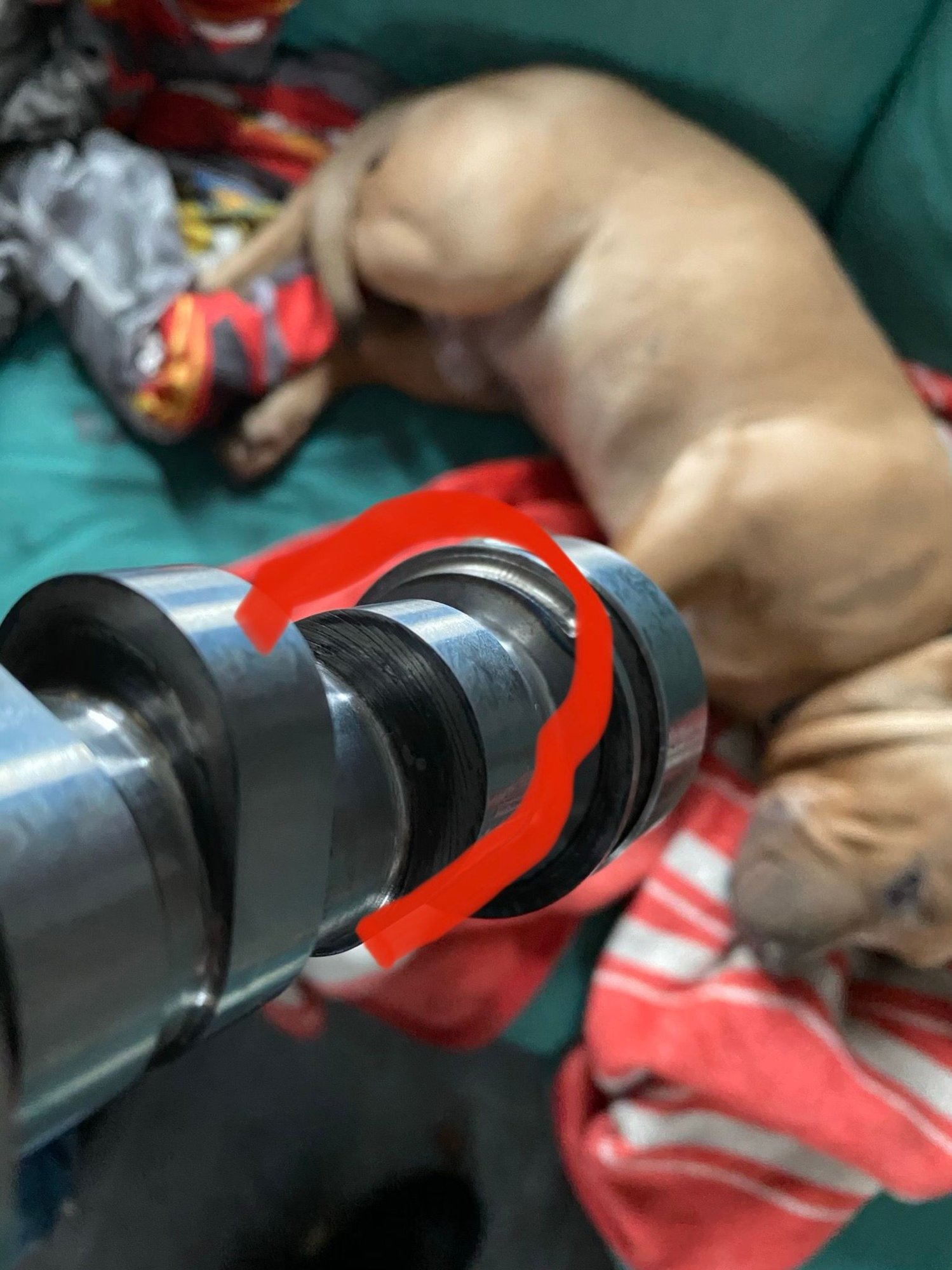

Ordered a crank scraper from Kevin Johnson, never ran one, curious how that will turn out
It was about to come apart.
The car quit moving lol

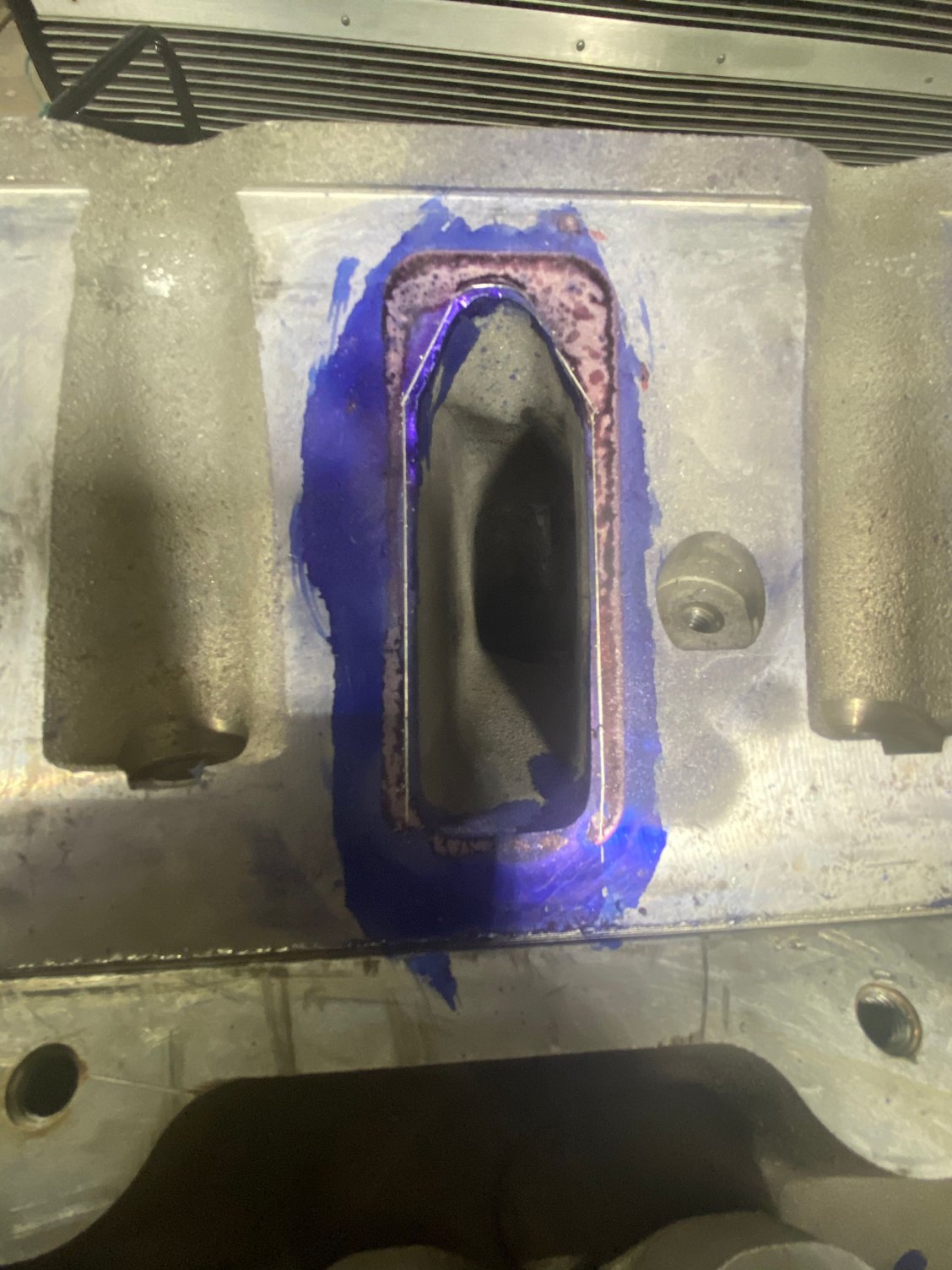

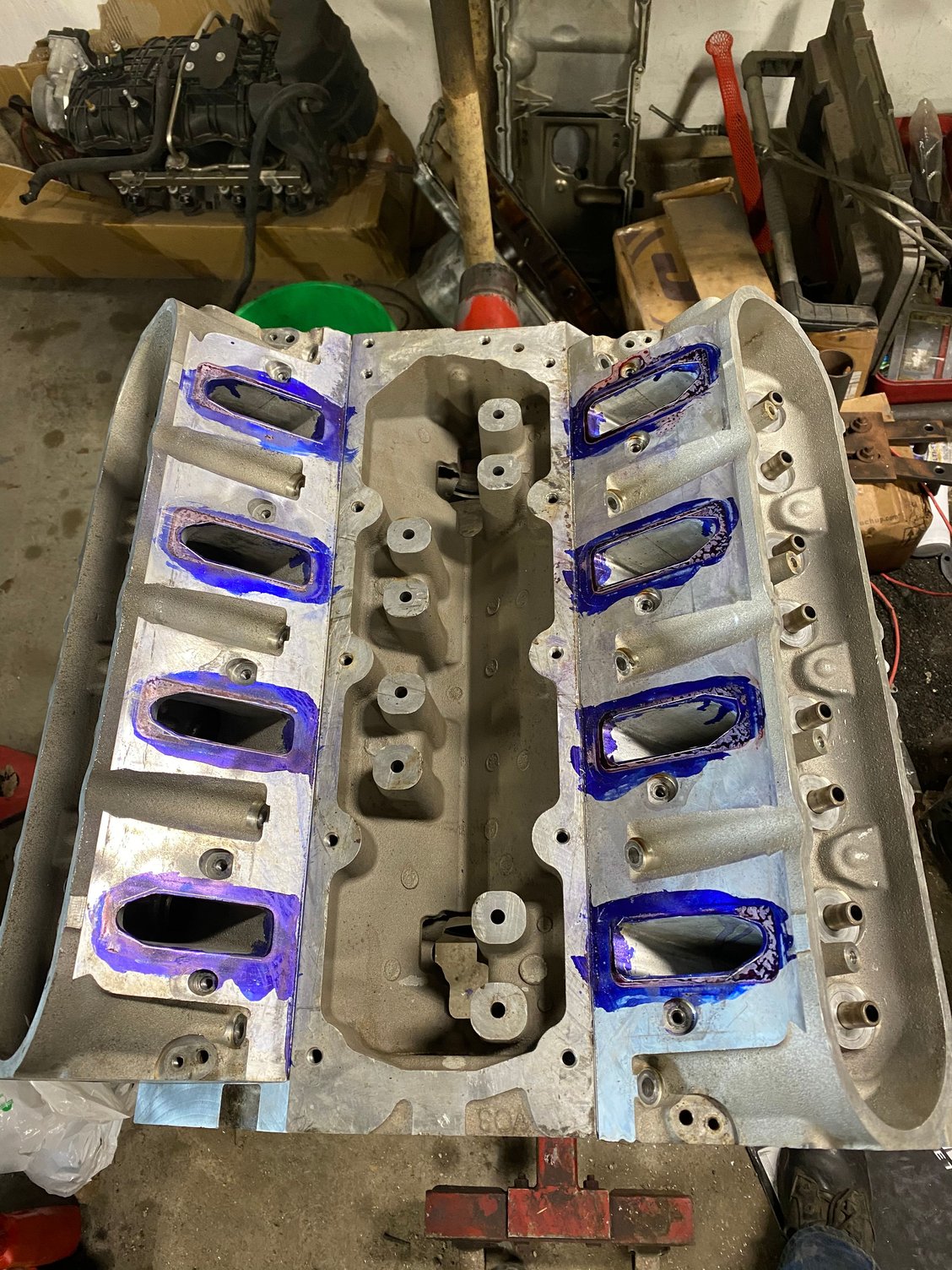

Got the heads scribed for port matching, quite lip they would have without.

Soooooooooo much better. Tapered the ports back about an 1” to 1.25 inch depending on how bad the lip was. That should help a ton.

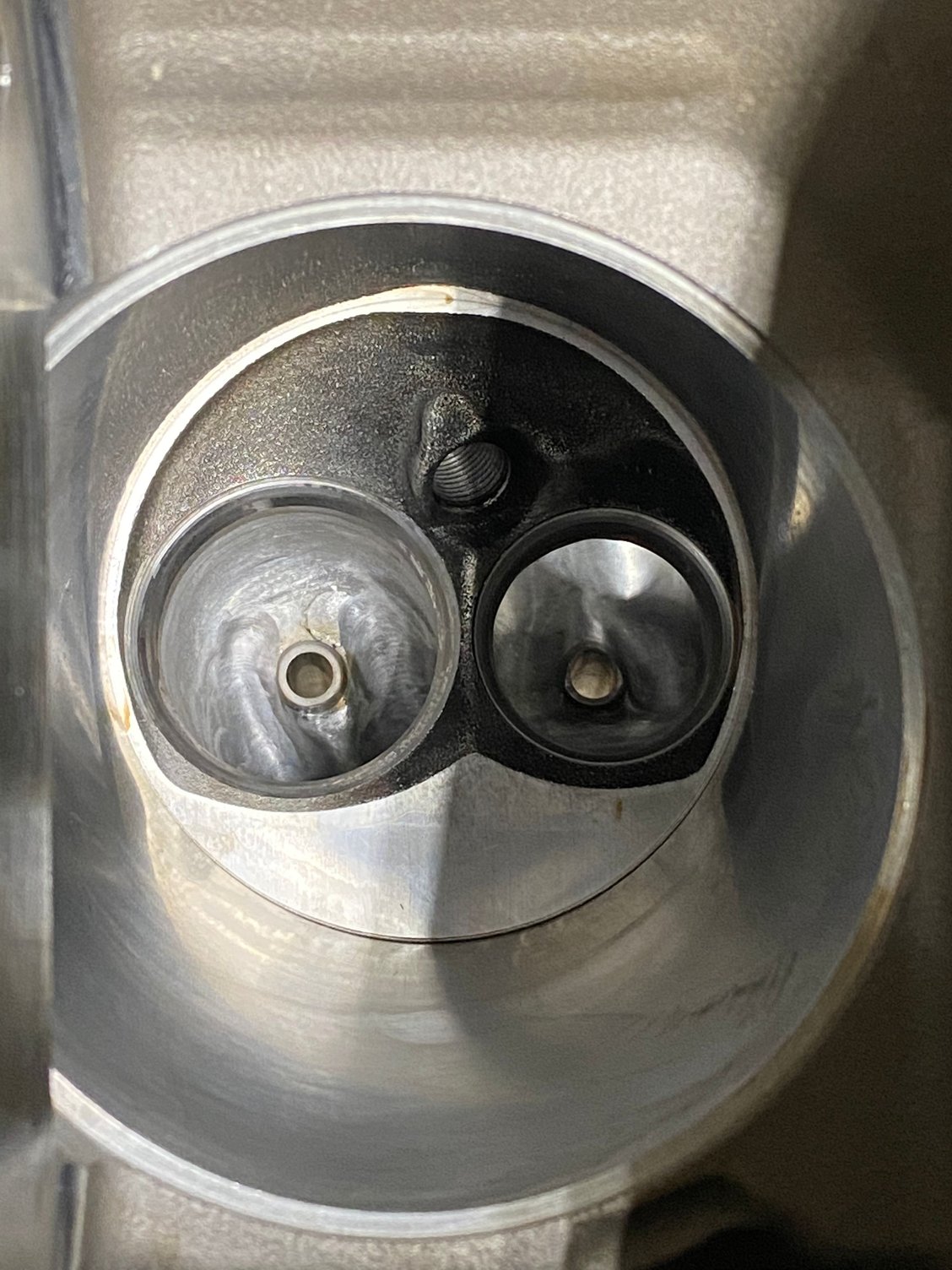

What am i missing here man. "346 high compression build" ... but the block in above pic has afm holes
