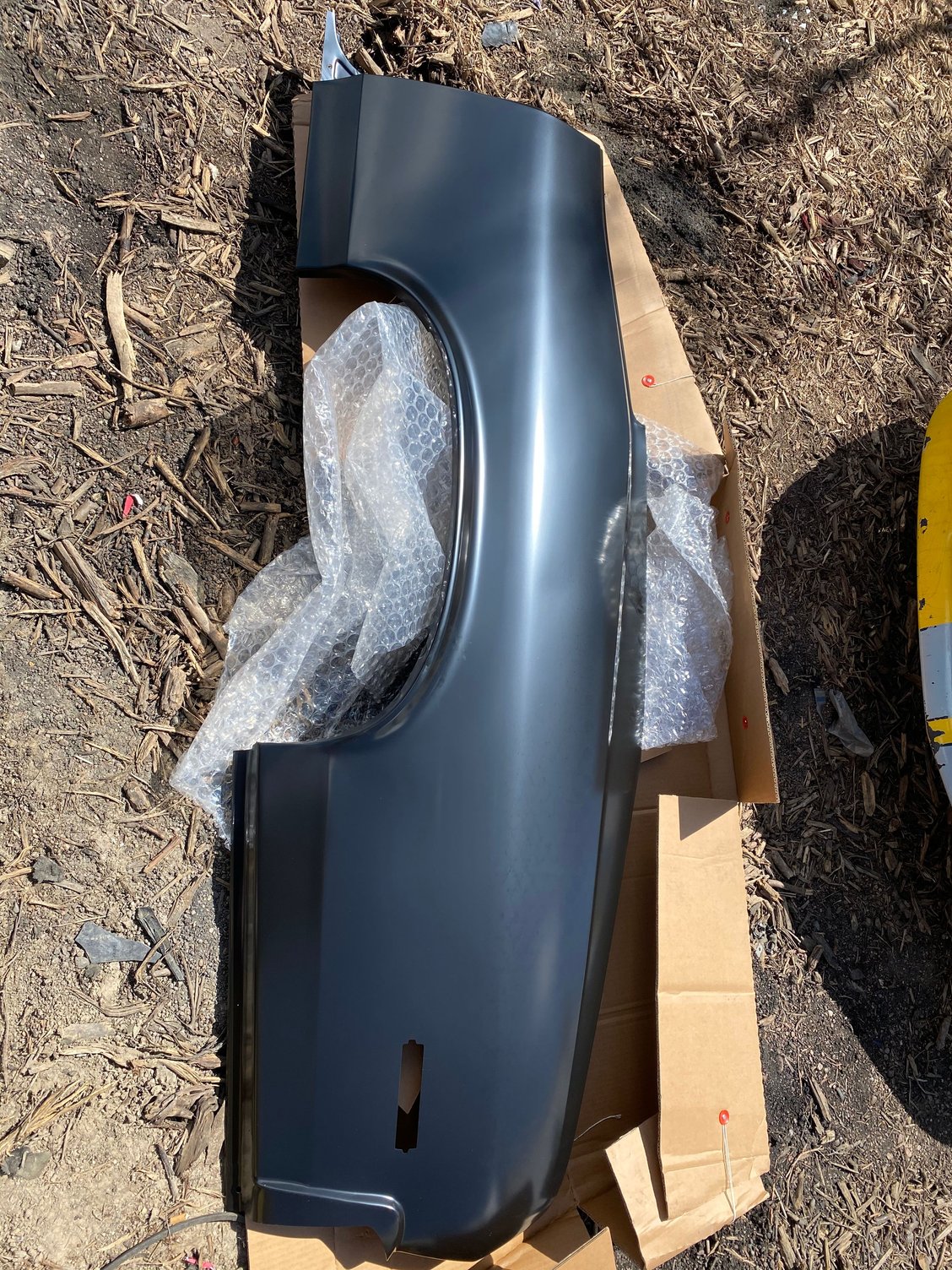

Quarter panels showed up. Plan to paint the car a Baja bronze, with holographic silver flake and orange pearl. Will be darker than the car above, and not hve the ugly cream top lol

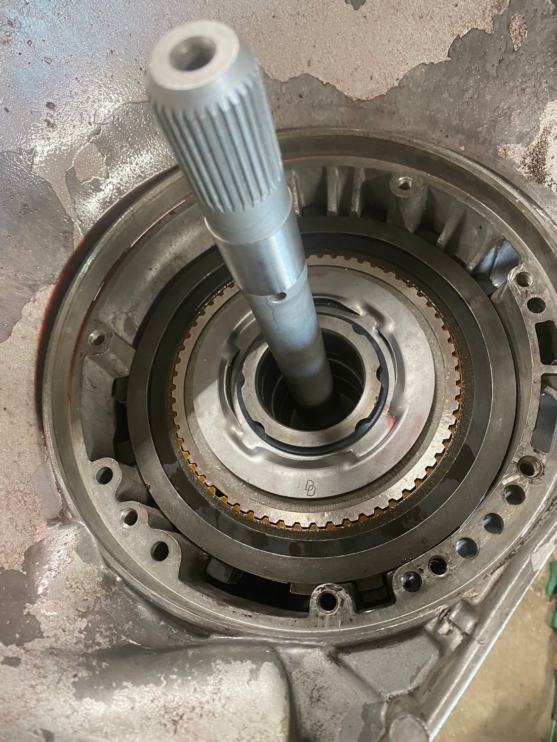

CK performance billet input shaft and mechanical diode 2nd gear setup showed up finally. Time to assemble the trans

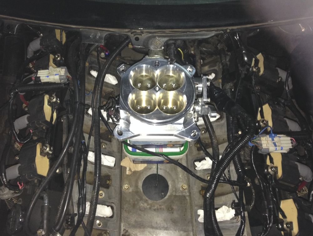

Originally Posted by Cwarta
My cam bearings, intake gaskets for port matching, and my throttle body showed up.
Looks awesome. What brand TB is that? I wonder how the new split Holley cathedral intake, compares to the Super Vic cathedral intake. I was thinking of buying the Holley but i live overseas and nobody had one here in stock and i didn't really want to wait 3 weeks for one.
I'm doing a Super Vic / 4150 tb on mine this week as an experiment. Intake should be here tomorrow but i spent some hours prepping the TB which arrived this morning. I grinded down the throttle shafts/screws some for more flow, fitted the sensors and then re-routed wiring etc to the sensors. I'm going to cut a nice hole in the hood and run a velocity stack so it can breathe properly.

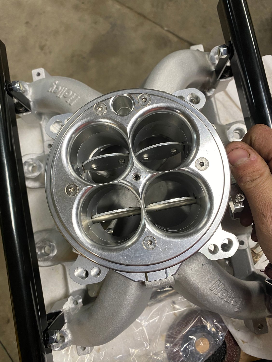

Its a pro comp throttle body lol. Was like $180 lol. Everything I’ve seen on the limited results I can find shows the holley making around 10 more hp than the super Vic

10hp is something.
BTR did 9hp / 4ft/lbs gain with the Holley over Super Vic for the LS3 version, but i haven't seen any back to back with the cathedral one.
$180 for that throttle body? lol nice buy. I paid $480 for mine with 15% ebay special and i thought i was getting a decent deal.

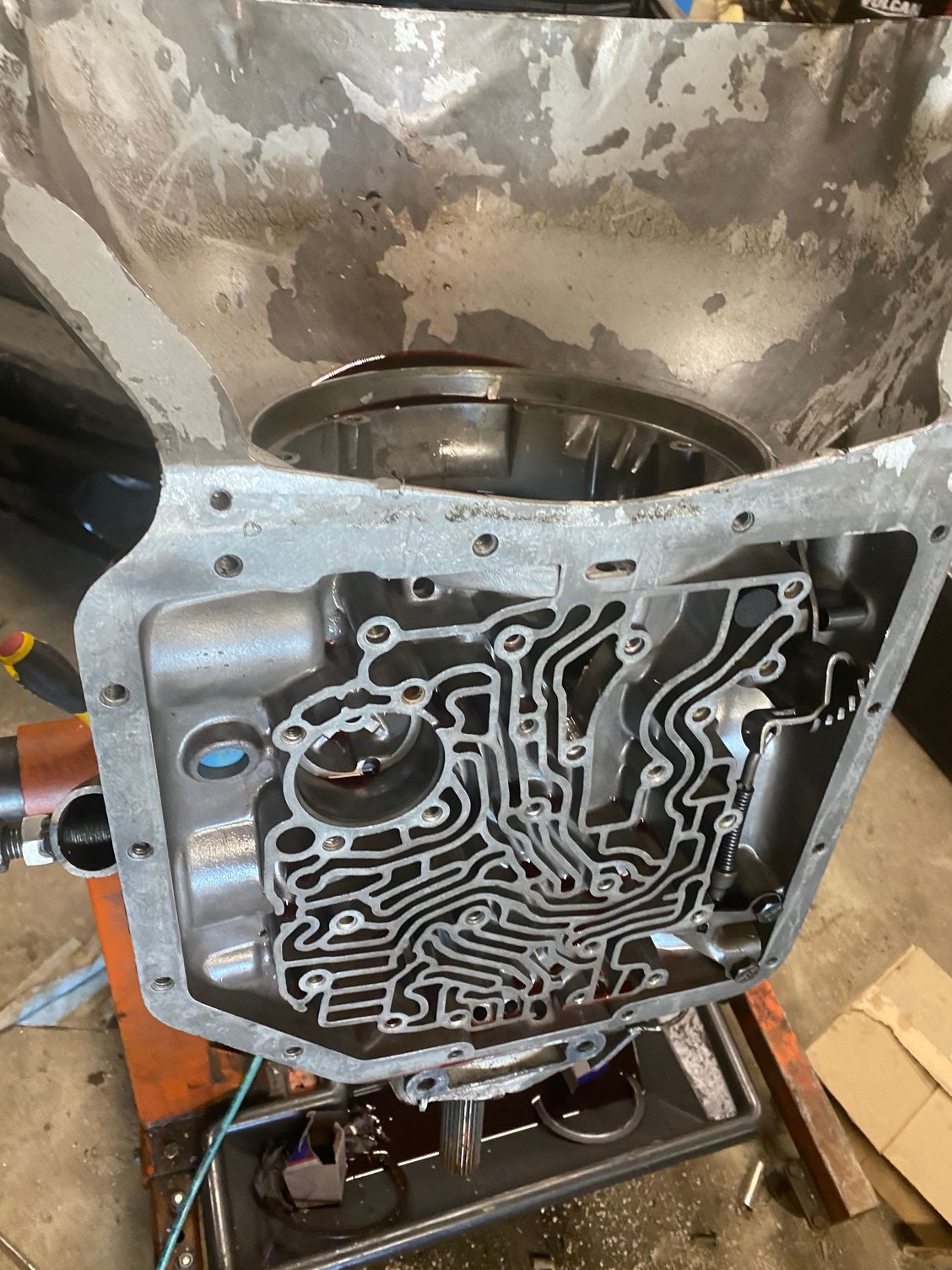

trans is finally done! Put all the ford stuff in at and she should be ready for a beating haha.
