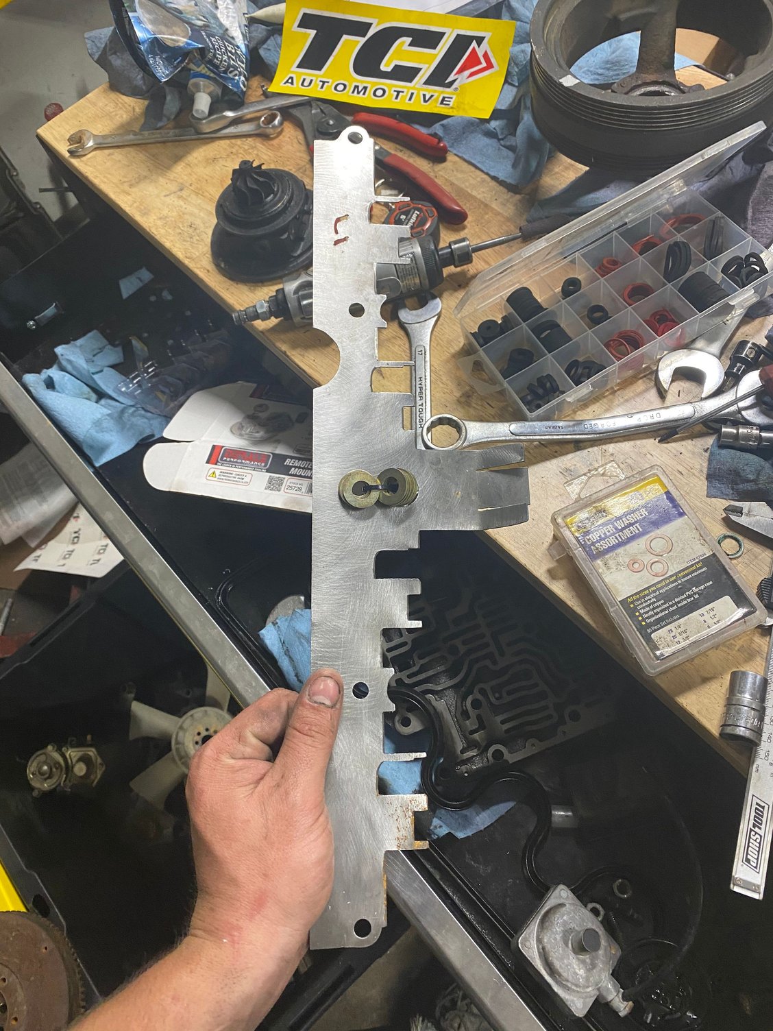

After what feels like an eternity my crank scraper finally showed up.

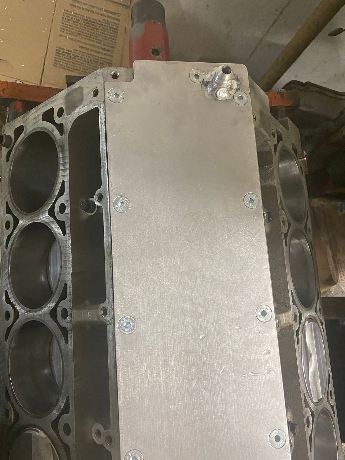

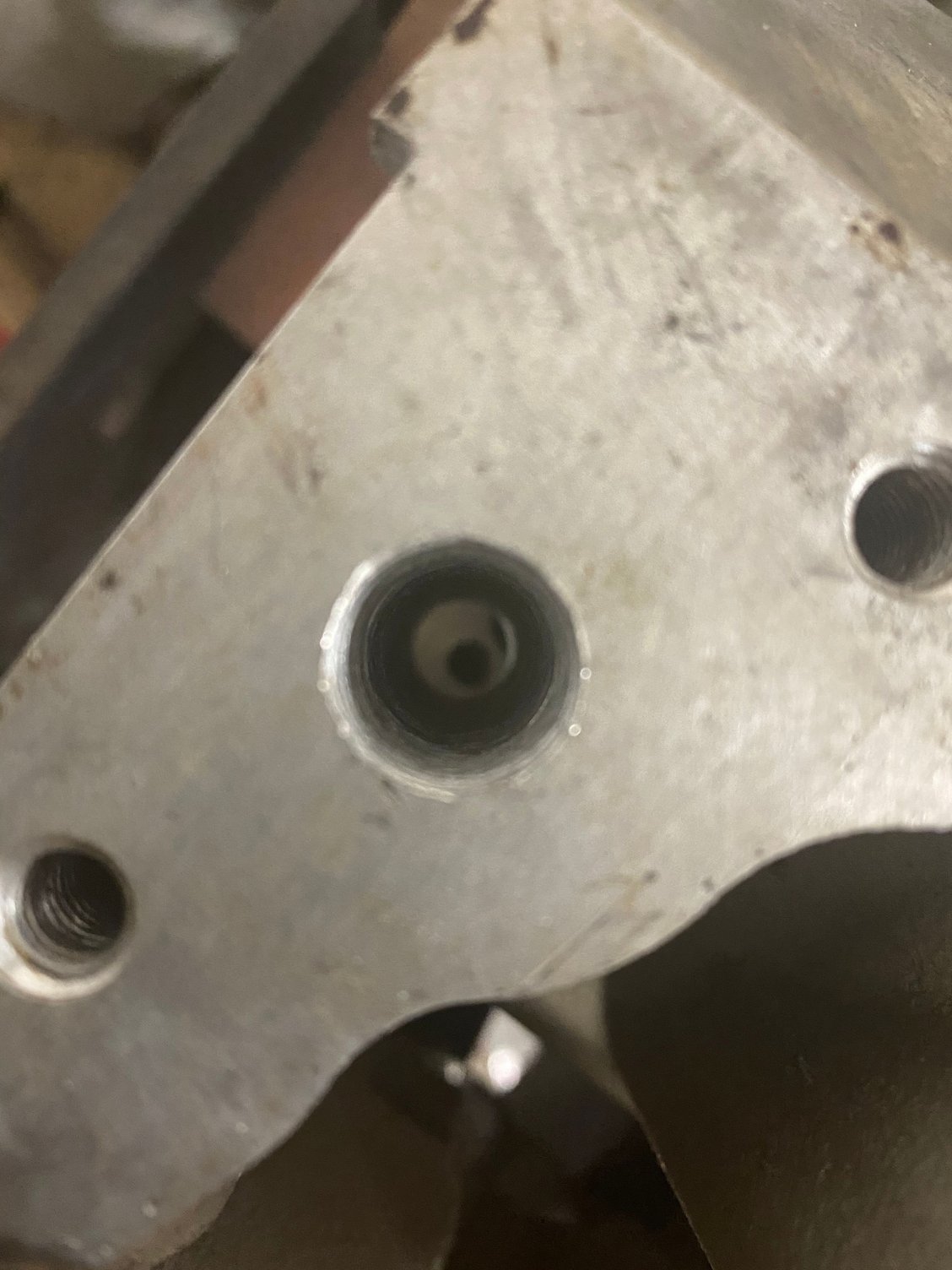

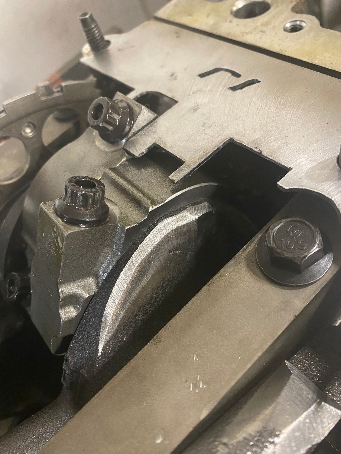

Got back on this thing some today. Drilled out this passage on the back for the sensor to 1/2 to make sure I got plenty of flow to control oil pressure. Tigged on my bung for the an line on my valley plate, started test fitting the crank scraper. Little
bits here and there lol

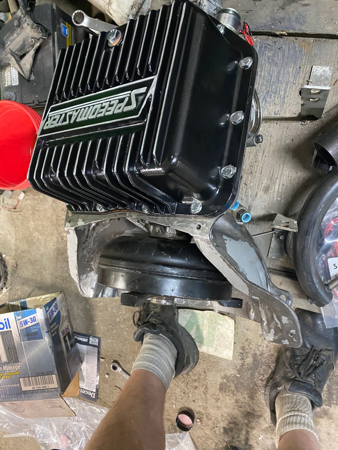

Cam degreed and installed, oil pan fitting tigged on for the pressure return, oil pump installed, spent probably 2 hours trimming on the crank scraper to get it to fit, nice part about this aftermarket pan Is I can use a full length windage tray. So that’s installed too.

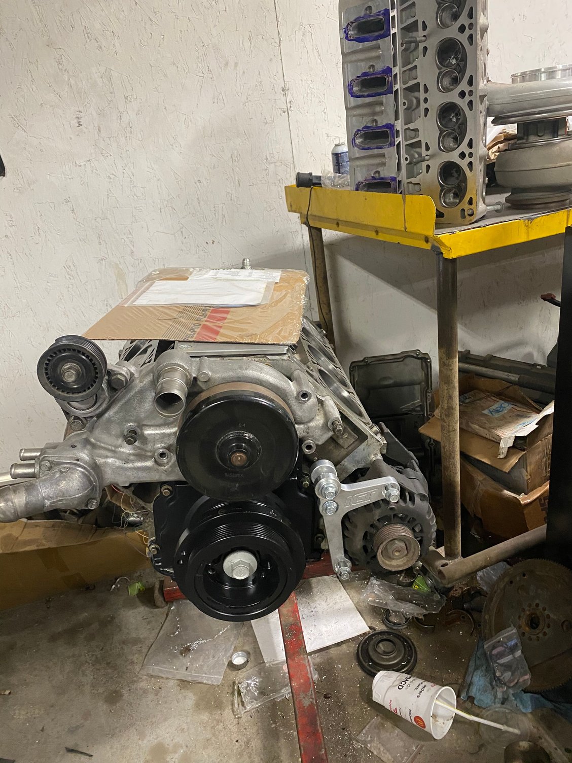

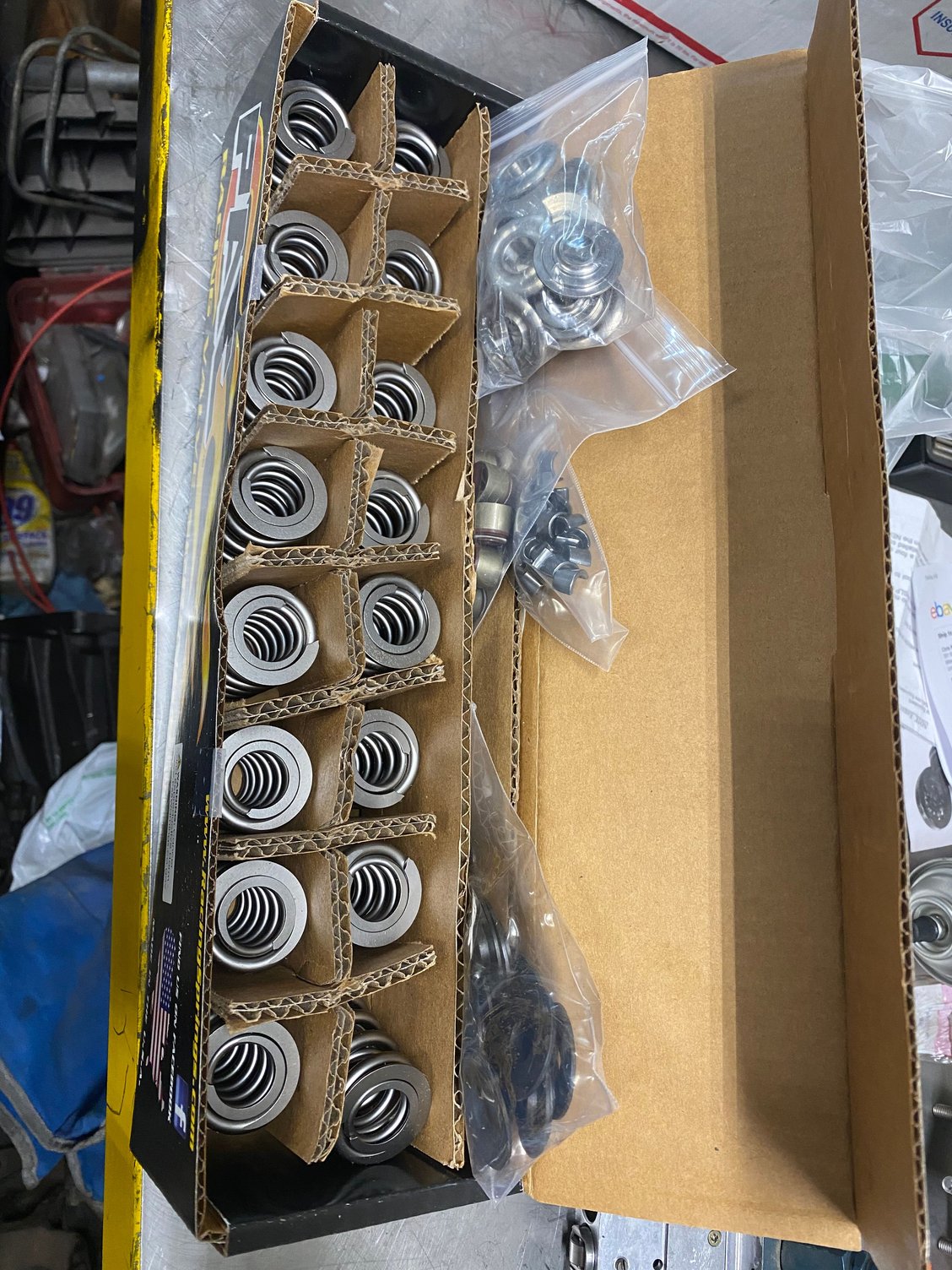

Short block is completely done, decided to ditch the btr springs and ordered a set of the pac 1208’sZ

Picked up a brand new g8 slp 25% underdrive pulley and water pump today for $150, so
looks like I’m running g8/vette stuff up front.

Ordered a ict billet low mount alternator bracket today and the 1208x springs. Had a hell
of a time finding them. Everyone was back ordered.

BraCkets and udp showed up

PAC springs showed up, thanks Tick performance. Everywhere else was sold out
