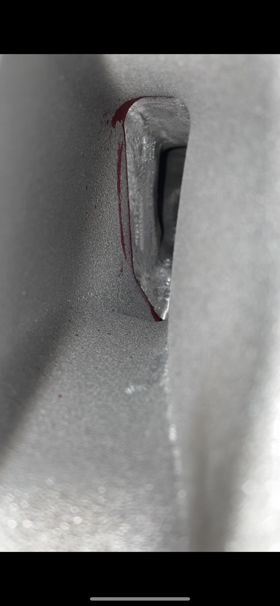

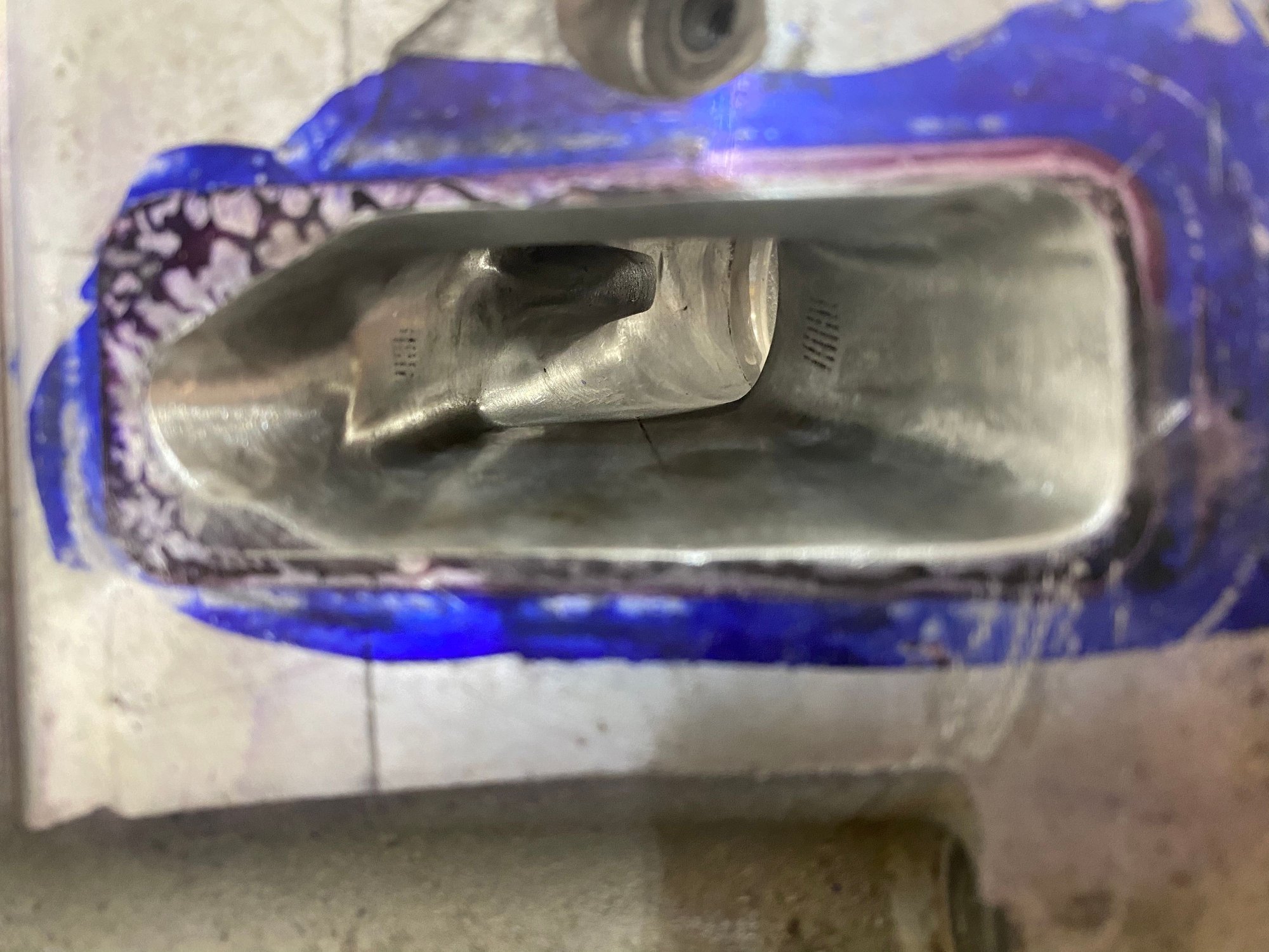

got the heads roughed out to the intake, very very pleased with how well it all came out.

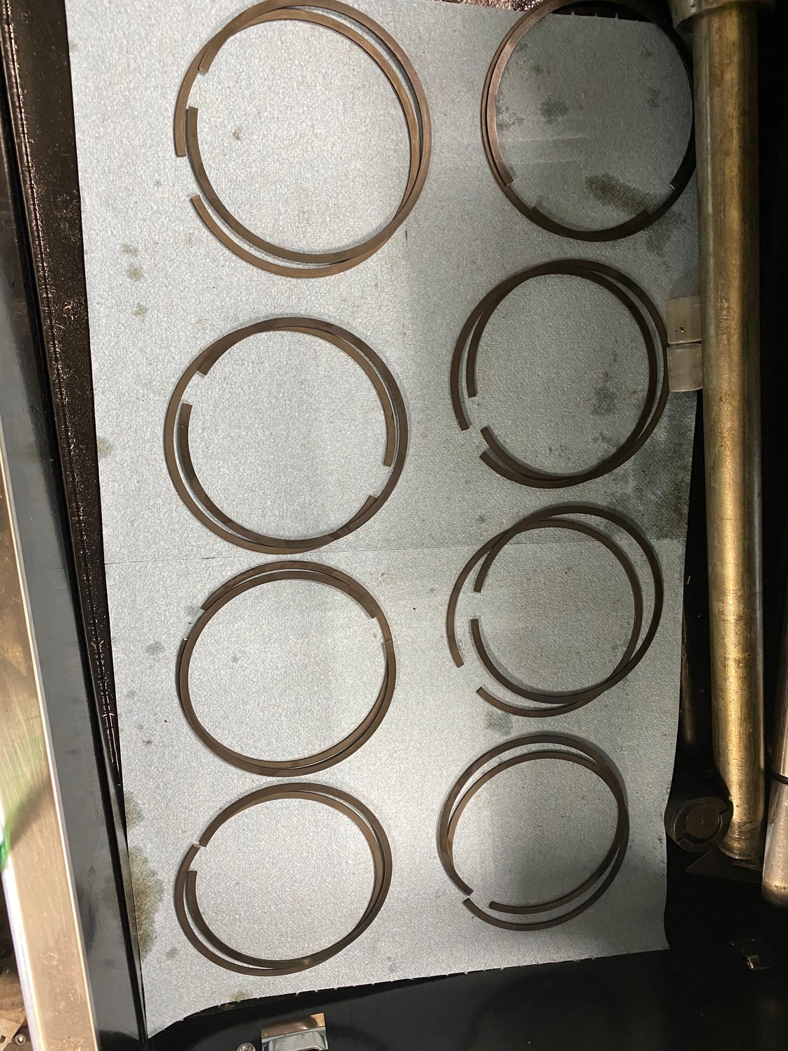

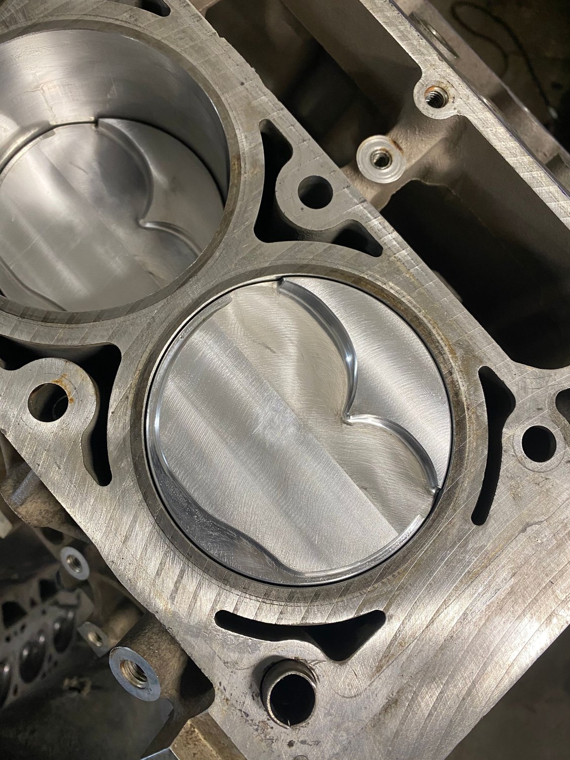

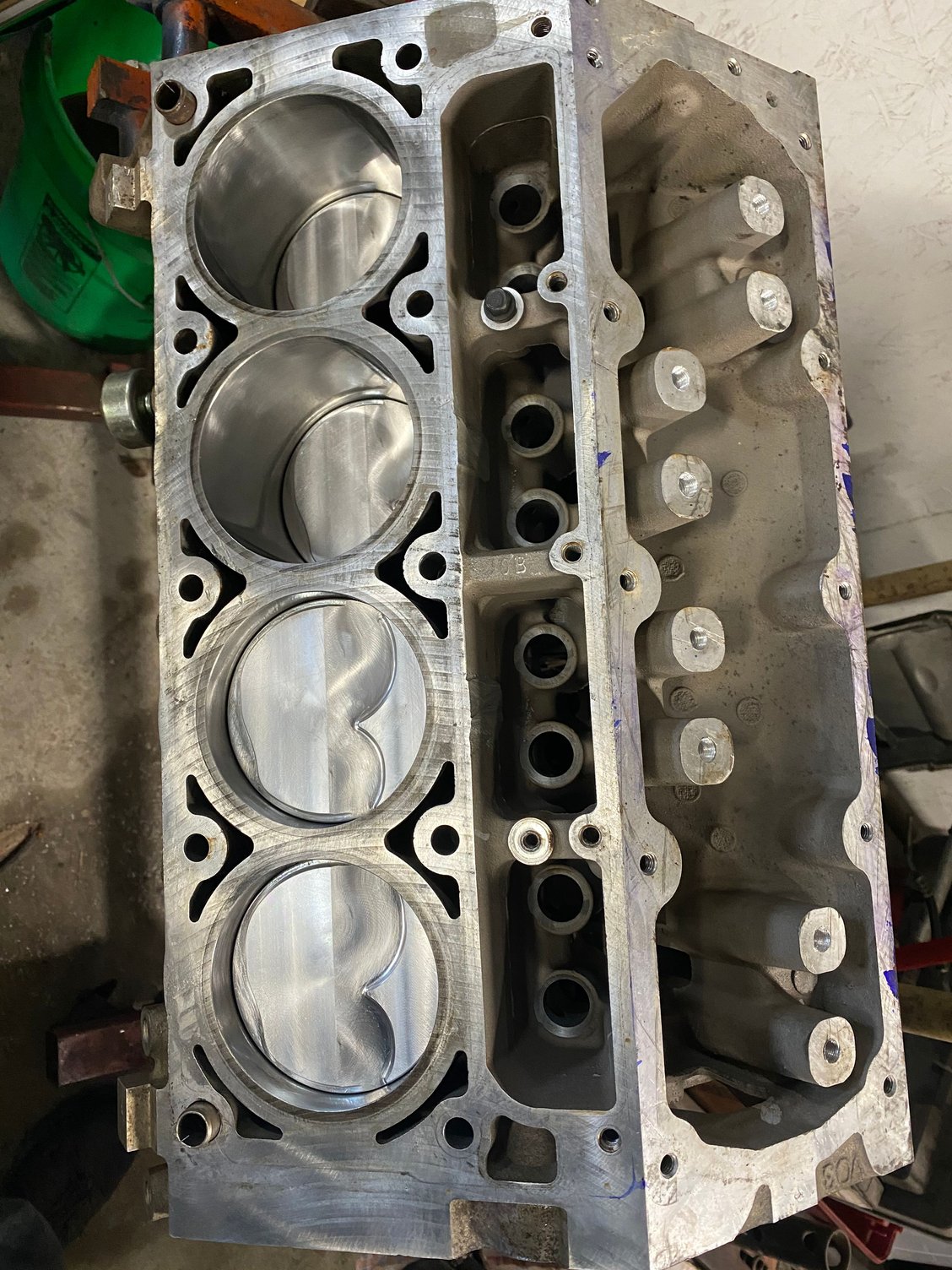

Assembled the short block today. Gapped the top rings at .0024 and the bottoms at .0026, rods and mains all came out right at .0031/2. Also happy to report that the dome clears the .060 milled 862 heads with .040 headgasket. Progresssssssssss

Nice.......clearance is the reason i didn't go with a dome piston. The ones i found when i bought my mahle's were not to be used with mild heads. The mahle's was alot lighter so i figured it was a fair trade off.

So, did you have the deck milled or anything else?

Yup I was wondering if they would fit these tiny chambers without touching them.

Nope! .060 off the heads, .040 headgasket, stock deck.

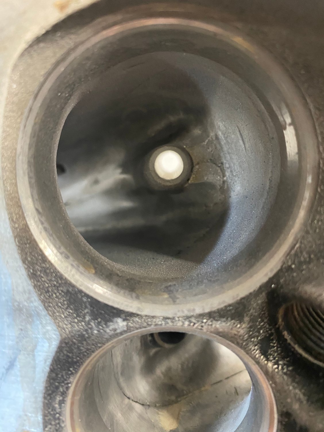

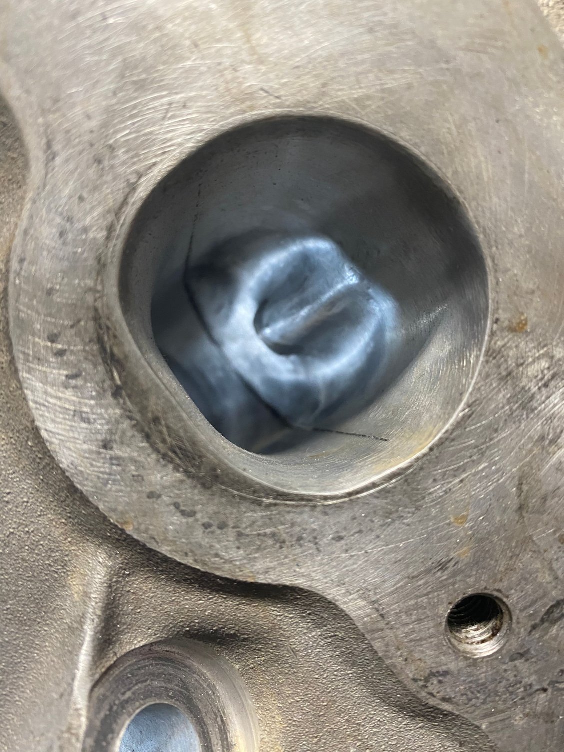

Assembling the heads now. This is the final port work I did. I’m happy. No idea if I hurt it or helped it but I think we will find out.

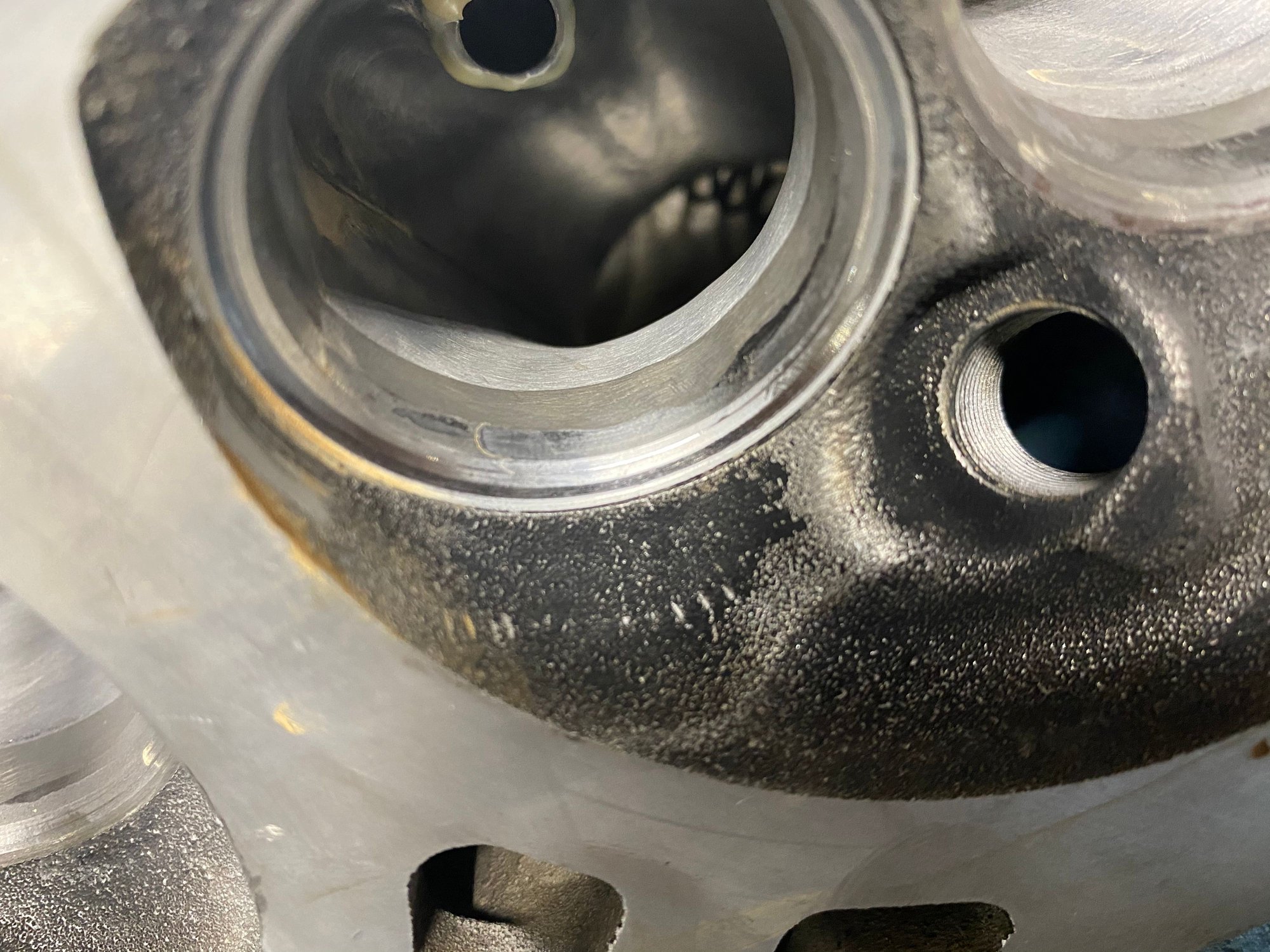

Well just got a bit of a kick in the dick. Just realized BTR sent me the .650
lift springs and not the .685’s I ordered. Fml

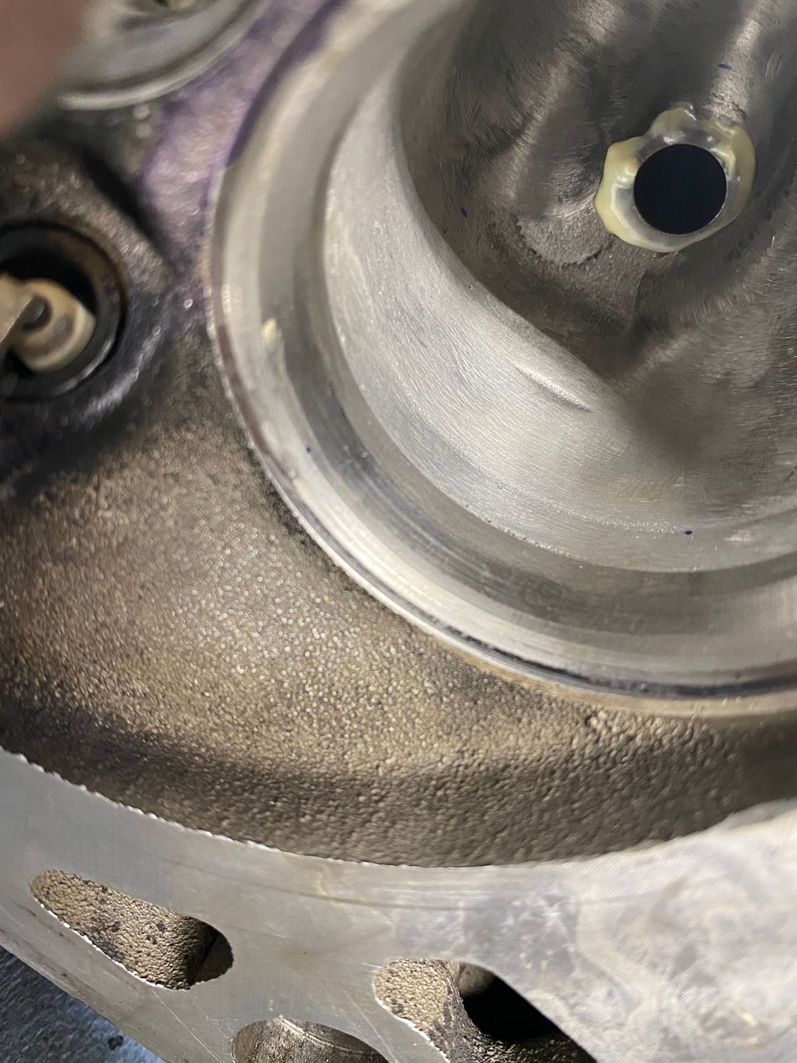

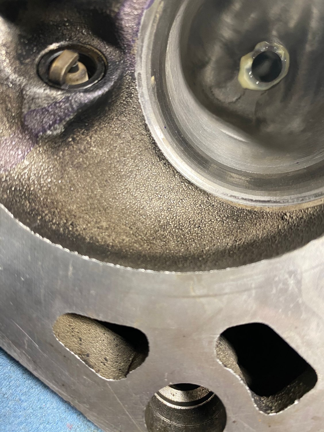

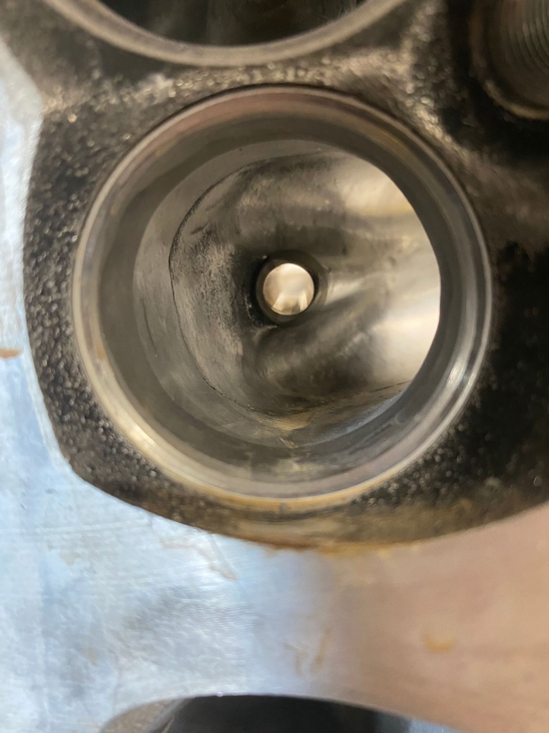

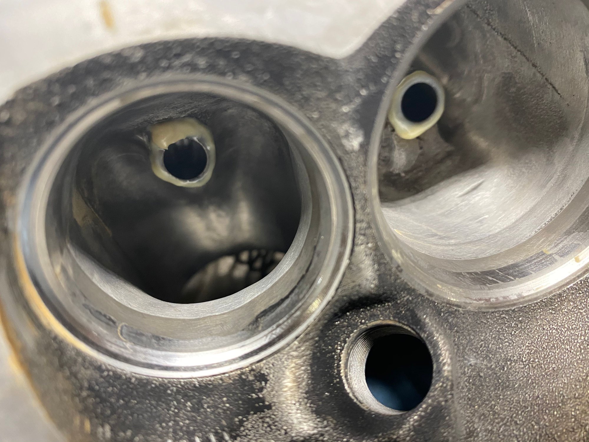

What do you have the throats opened up at? How much of an edge is in the chamber around the intake valve top cut?
Old Apr 27, 2020 | 10:40 PM
  #135
Cwarta's Avatar
iTrader: (12)
Joined: May 2012
Posts: 1,796
Likes: 59
From: Elm Creek, NE
I didn’t do too much there, what I did was-
port matched to the intake
removed the rocker bolt hump and smoothed that area a lot.
blended the seat lip into the bowl, smooth as glass in the transition.
removed the swirl ramp and cleaned the area up on each side of the guides and bullet shaped the guided.
same with the exhaust side, bullet shaped the guide, cleaned the whole port up and slightly gasket matched the sides and roof of the exhaust port while leaving the floor alone except for polishing it.
there is is a pretty decent lip around the valve seat in the chamber. I’ll go get you a picture now.

Not the best pics but the best I can get

What size valves do you have?
1.55 exhaust 2.0 intake
Old Apr 28, 2020 | 10:05 AM
  #139
WE TODD DID's Avatar
Joined: Feb 2007
Posts: 1,627
Likes: 290
Open your throats to 1.80” and 1.40”. Blend that edge on the intake valve to the top cut. Don’t worry about the exhaust side.
I’ll see what I can do, got plenty of time to wait on btr now. Thank you!
