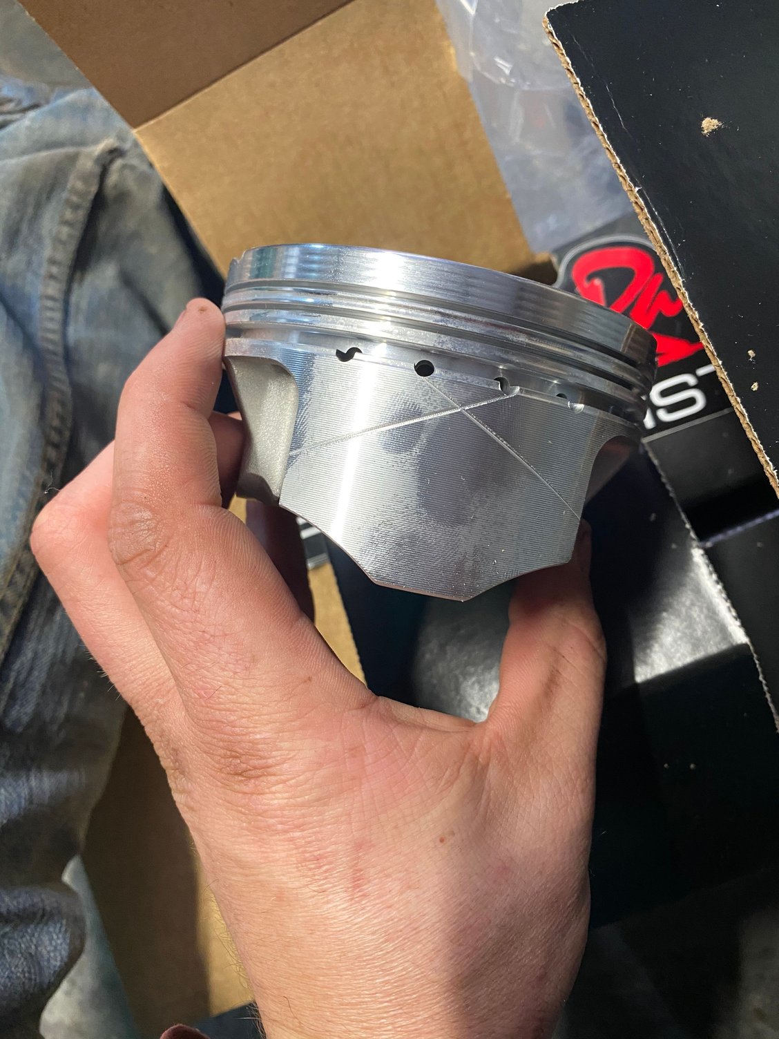

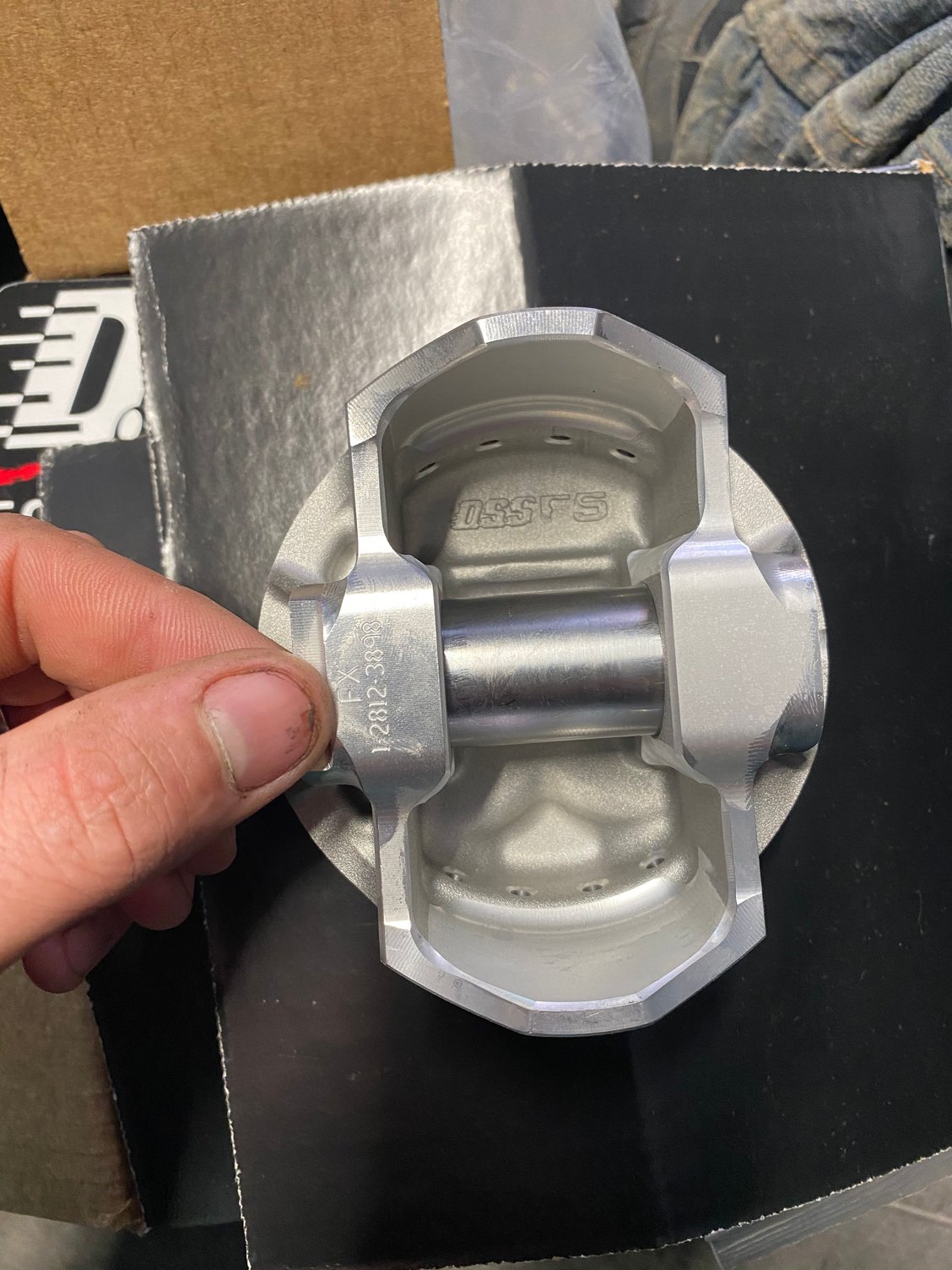

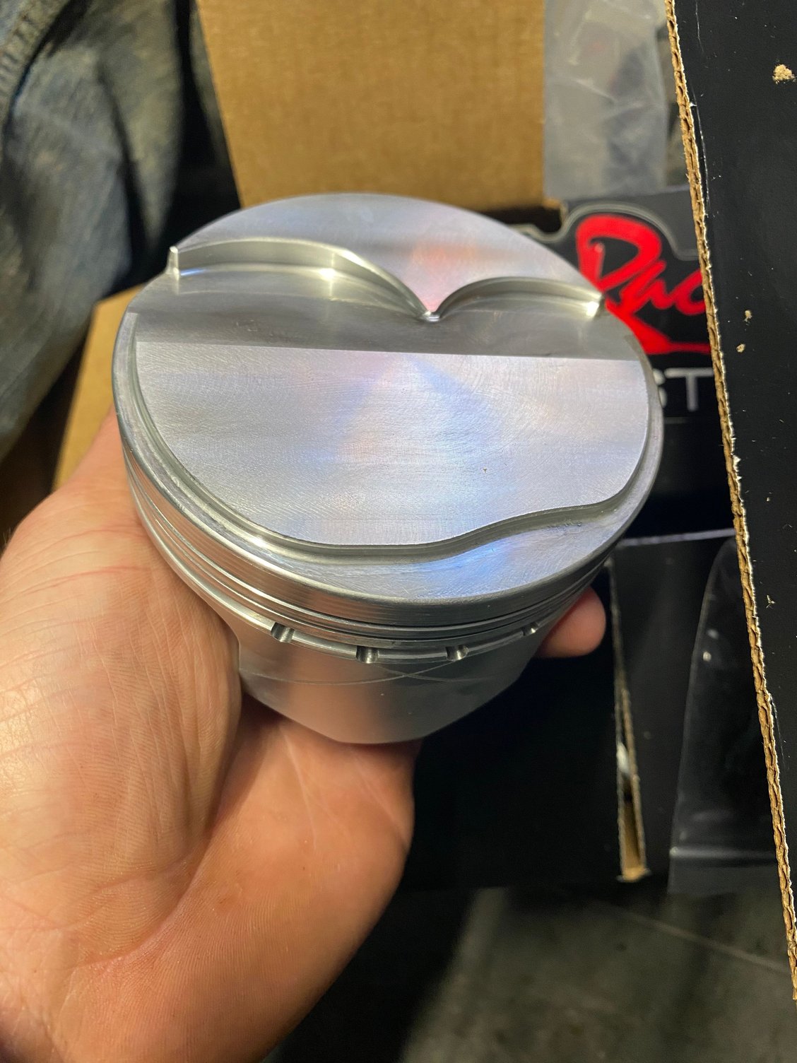

Pistons showed up, these are the rings I ordered.
Piston Rings, Gas Nitrided Steel Top, Martensitic Ductile Napier Second, Std. Tension Oil, File Fit for 3.898 in. Bore, 1.2mm, 1.2mm, 3.0mm summit pro series
As soon as these rings get here I’ll be sending it off for balancing. Intake will be here Friday.

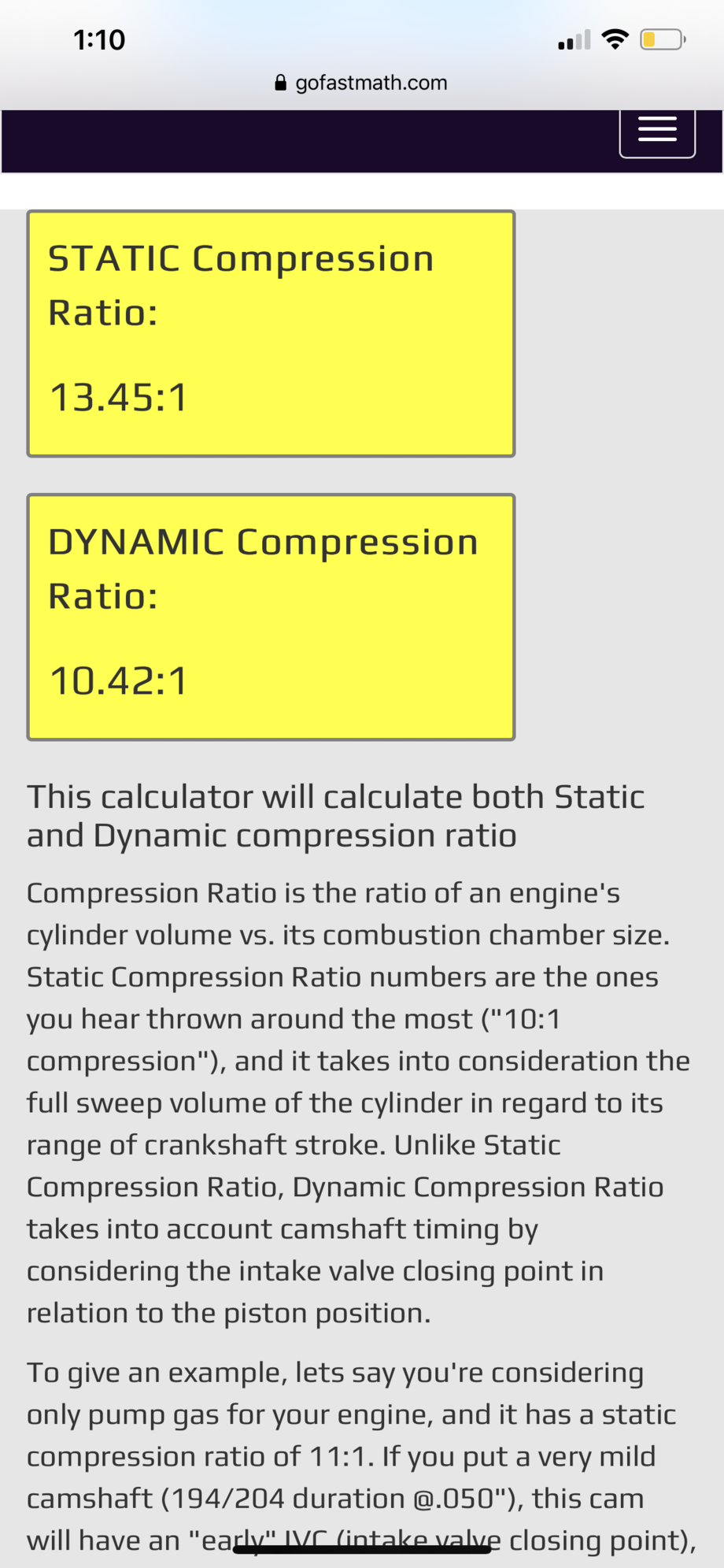

Originally Posted by Cwarta
Correct, I’ll cc them but math says right at 55,, plus I have a bigger valve in there now that takes up more space so should be right around 55.
Better check. I think you might be short of your compression goal.

Posts: 1,627
Likes: 290
I would check your piston to valve clearance, and then cut the heads as much as you can.

From: Conroe, Texas
Definitely will want to check P-V.
55 cc's is what I came up with and 13:5.1 static assuming zero deck.
Same, not sure how much the bigger valve in there effects the space but it can only help

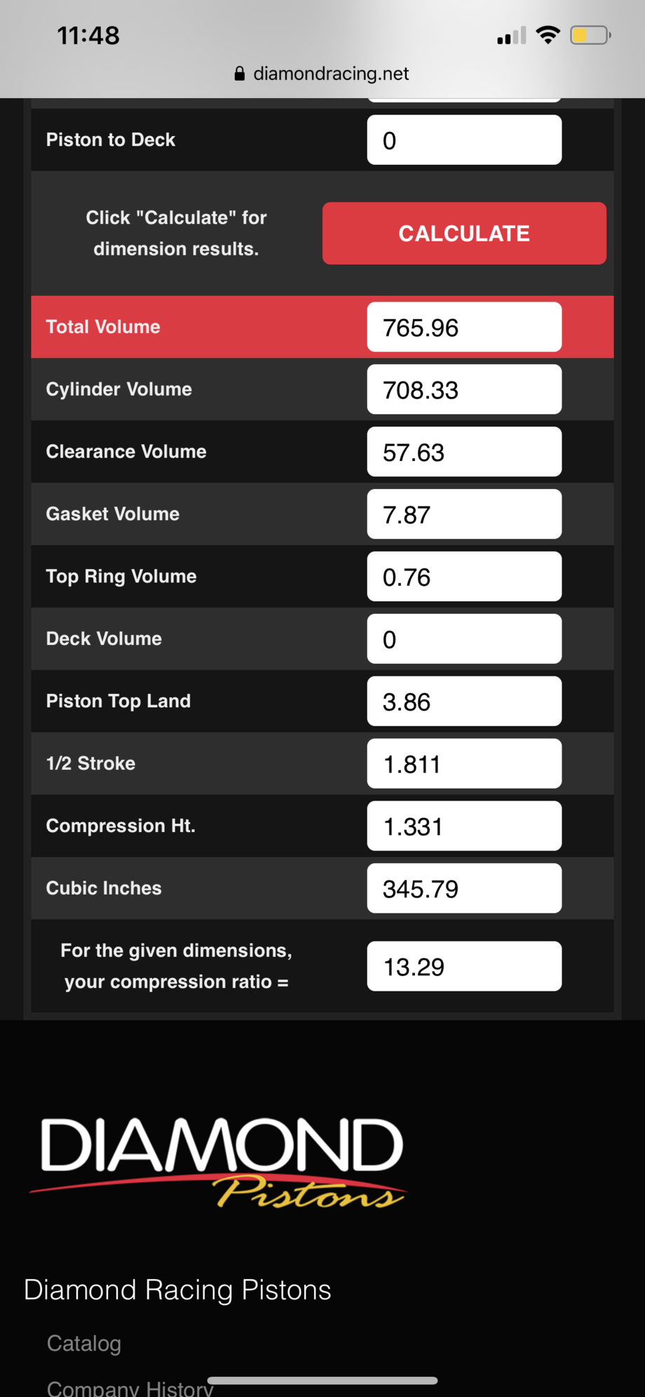

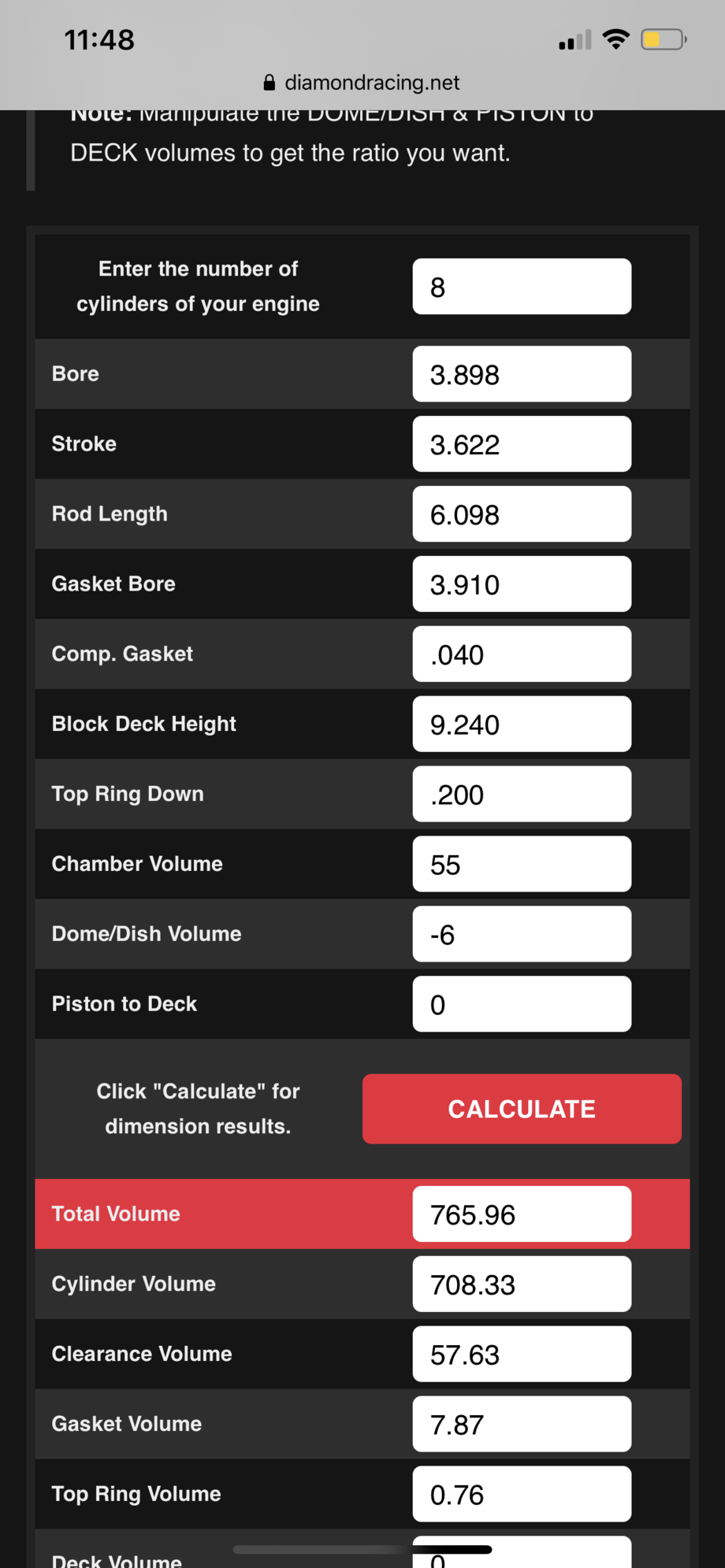

here’s my most accurate As I can be compression ratio calculations for both static and dynamic compression.
