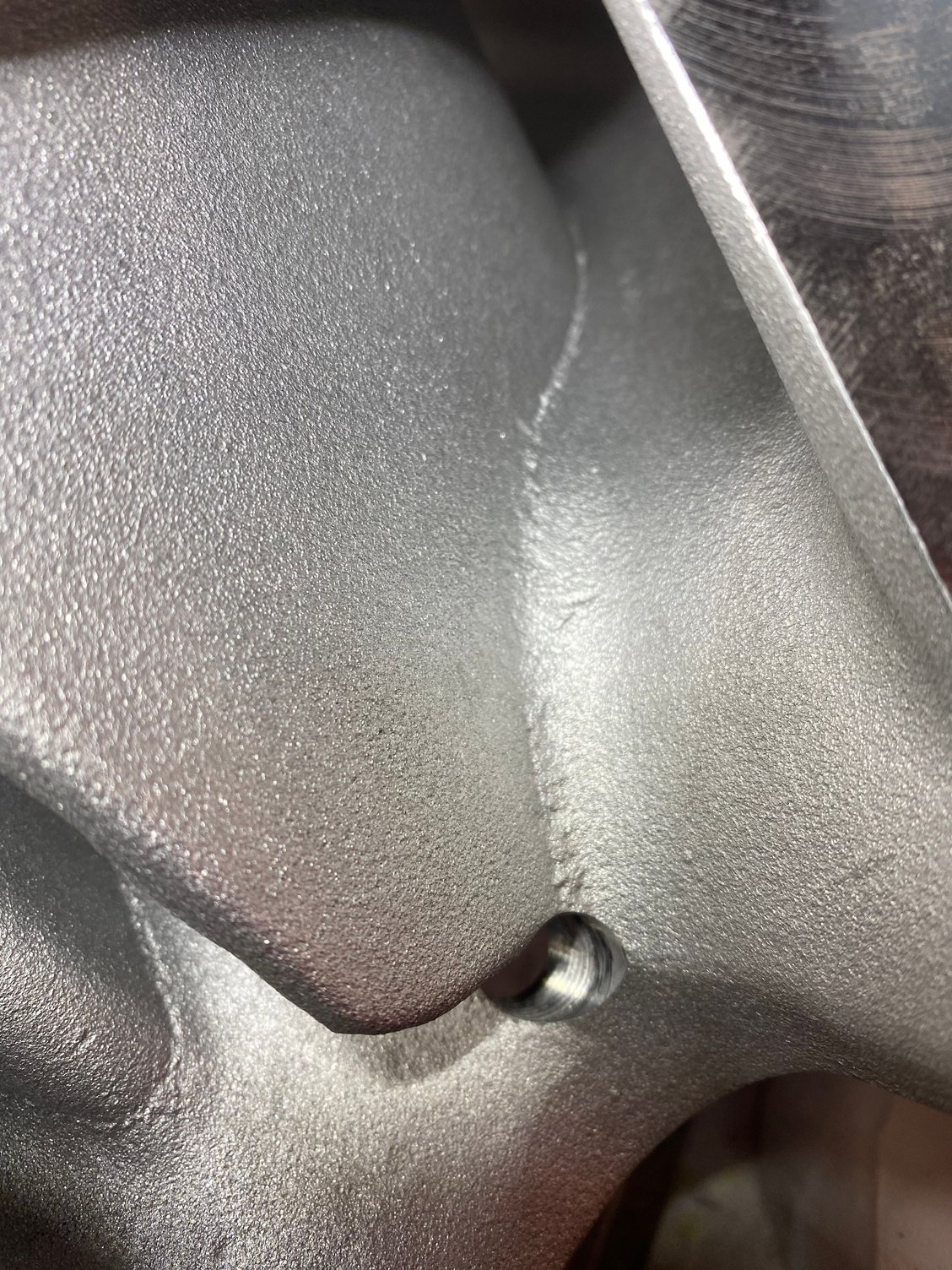

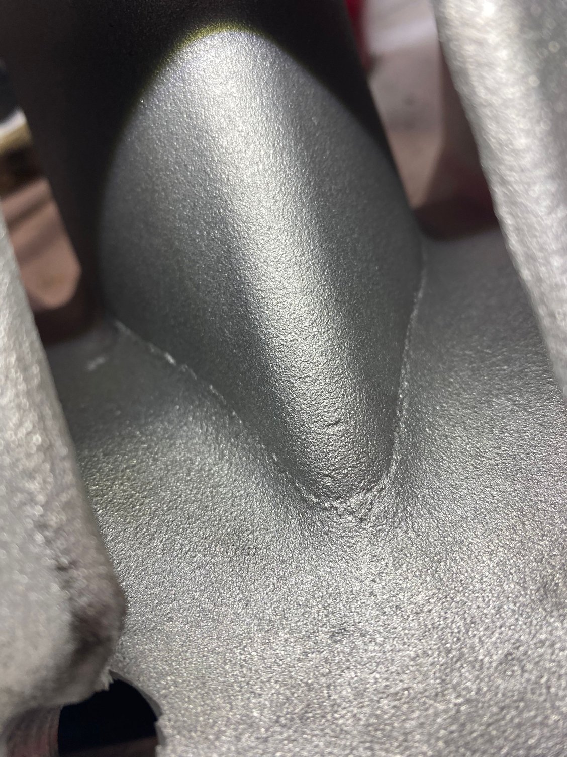

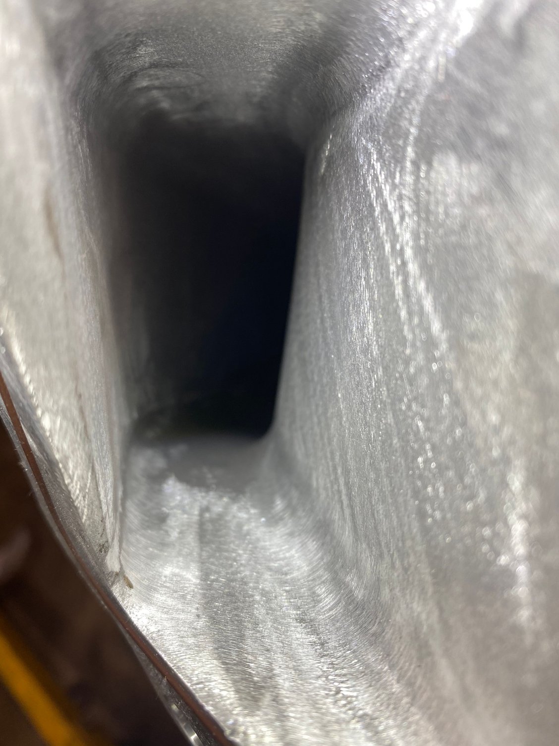

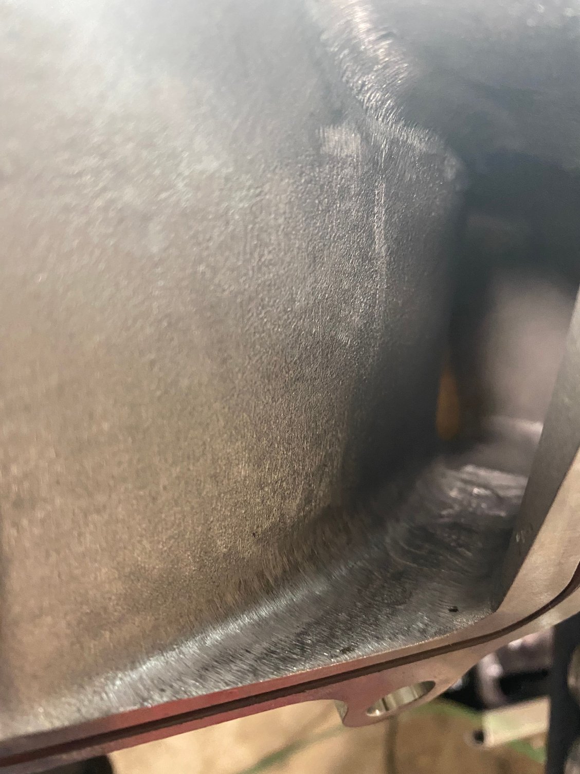

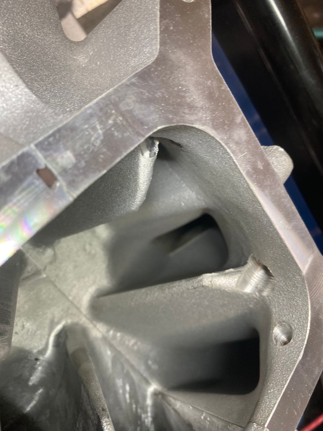

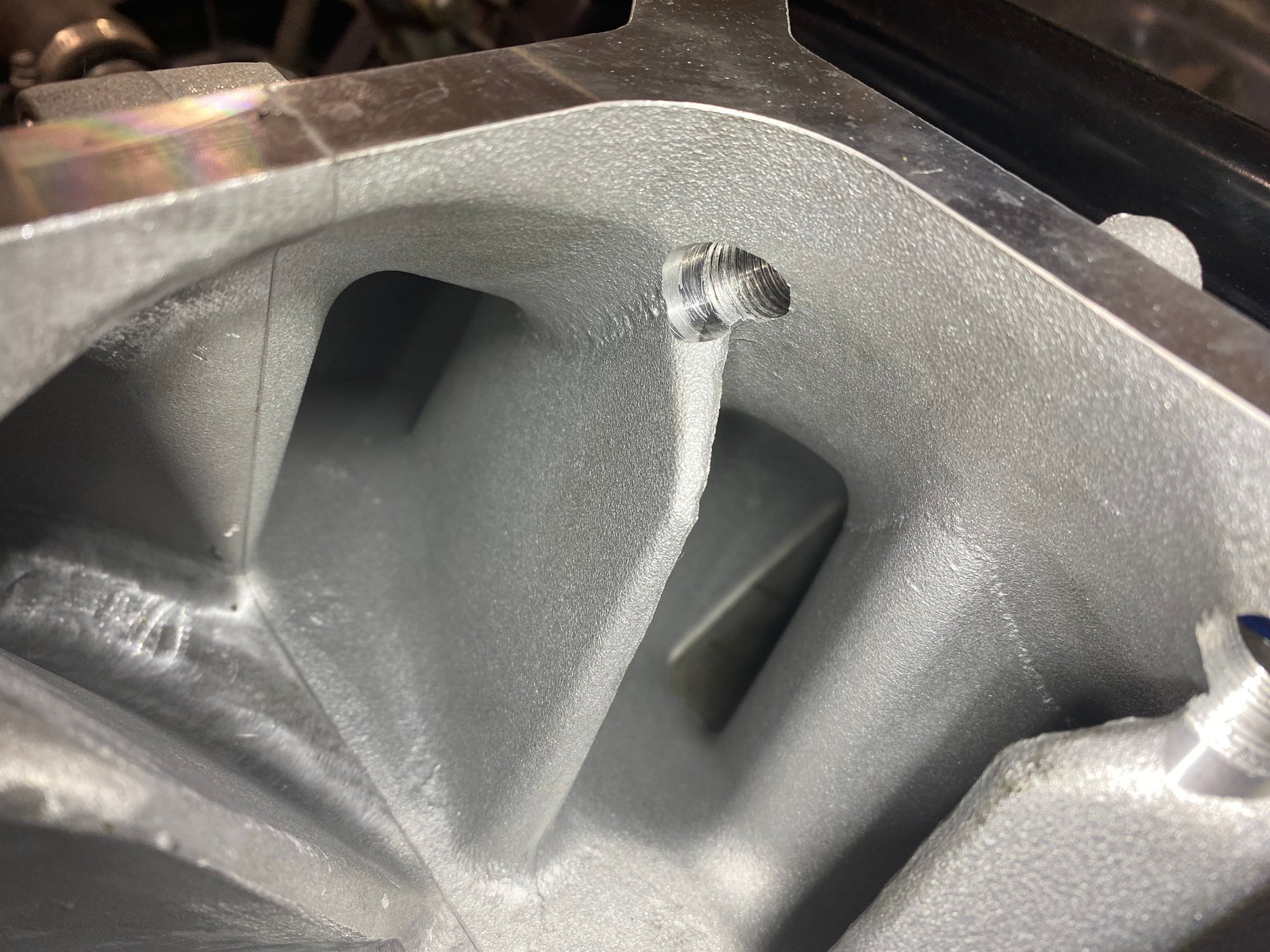

spent some time tonight cleaning up some casting slag in the Holley. I ordered some finer grit rolls and a bunch of cross buffs to really get it polished up nice.

Final step, wife helped me pull the ls1 out of her 73 camaro so I can get the block prepped. I set the intake on the heads and there’s a 1/16 of an inch or so lip all around the head port, so I’ve got some work to do on the heads for sure. Taking everything over to the machine shop for balancing

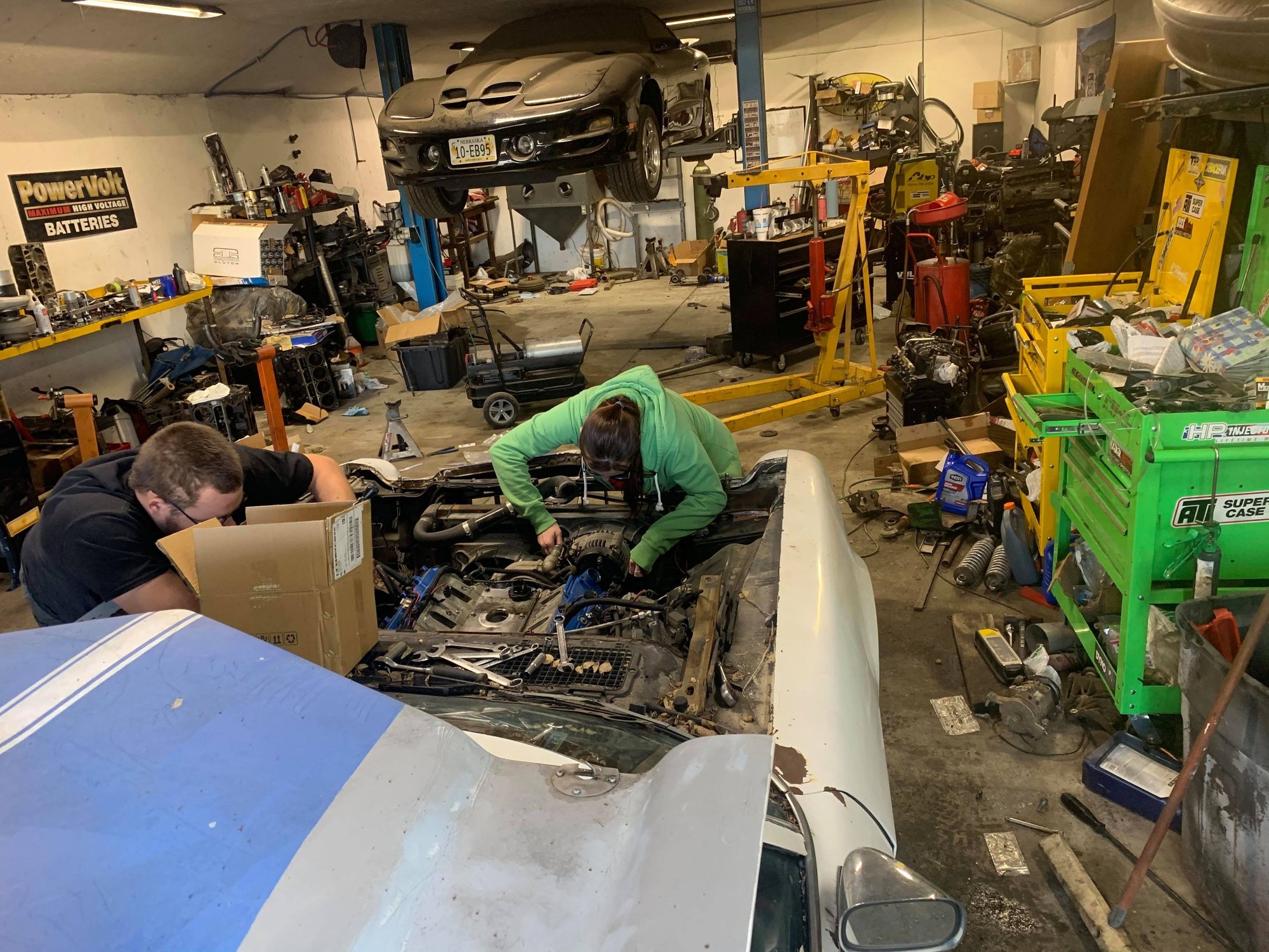

Don’t mind the desasterous shop 🤣

Don’t mind the disastrous shop 🤣
Just means a lot of stuff going on...

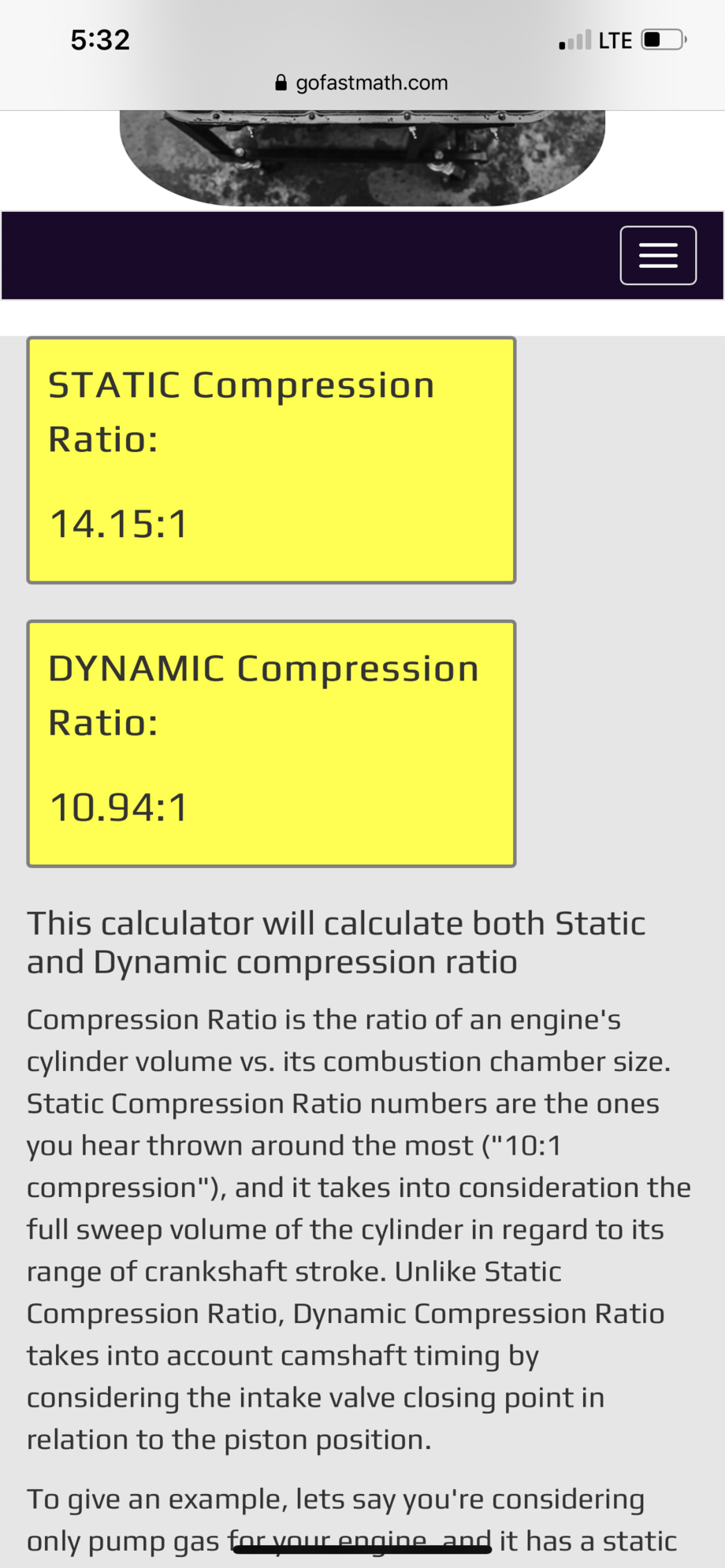

I dropped the rotating assembly off at the machine shop this morning along with the heads to get decked another .020, making it .060 total and giving me a static compression of over 14:1.

I hope so! I’ve been wanting to build a high compression stock stroke engine for some time. I wish I had the funds for better heads, but then they would kick my compression In the nuts. Ed Curtis has given me some tips on head porting so I’m going to do a little more work to mine when I get them back. I’m ready to get this show on the road. I wish it was as simple as dropping it in the car and she’s ready but I’ve got some work to do to the rest of the car also. I’m really, really curious to see what kind of power this thing lays down.

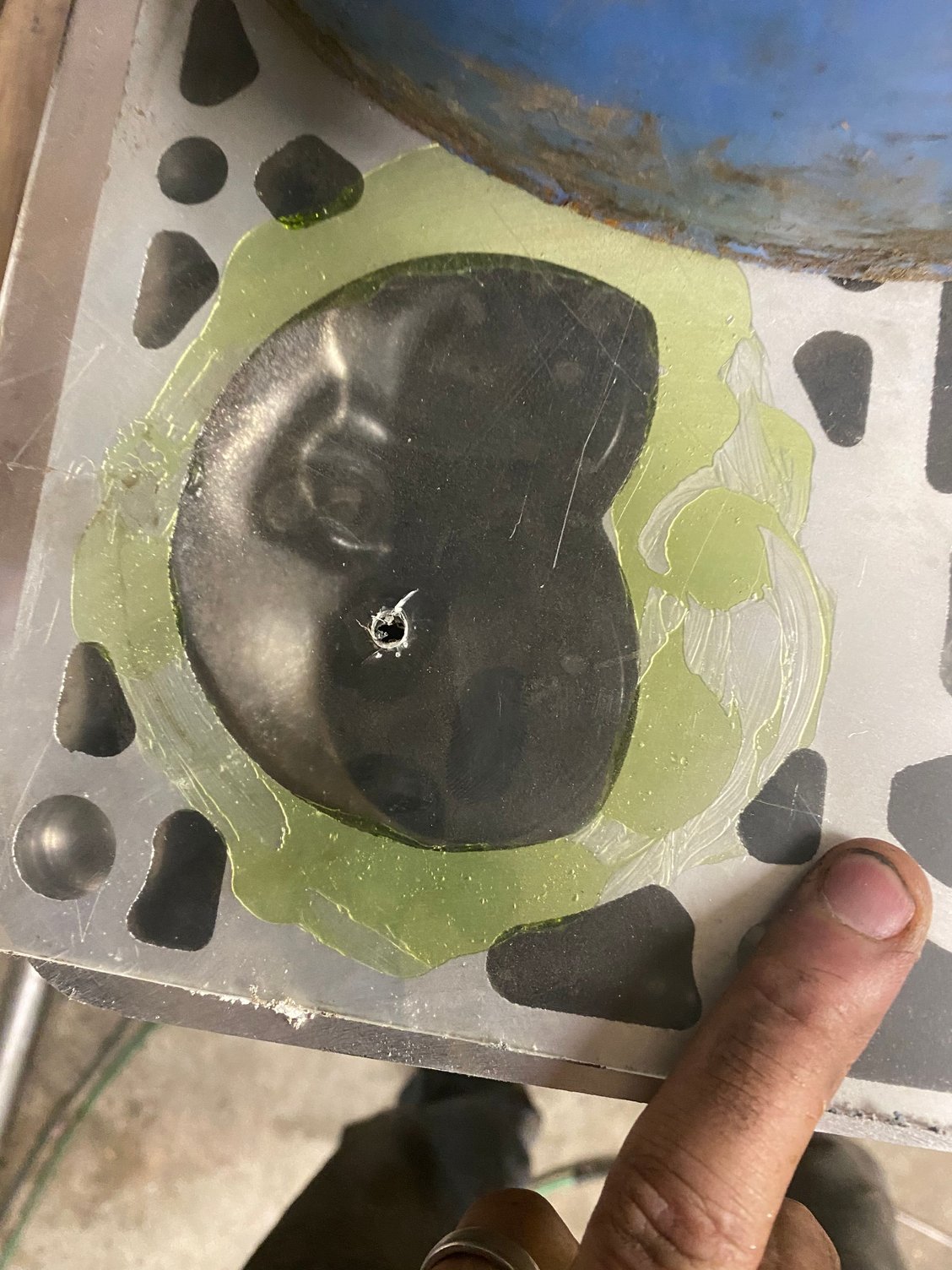

CC’d my heads 3 times, came up with 52cc each time with the current valves. So that puts things ending here, as long as the deck height is right at 0 like I’m figuring.
