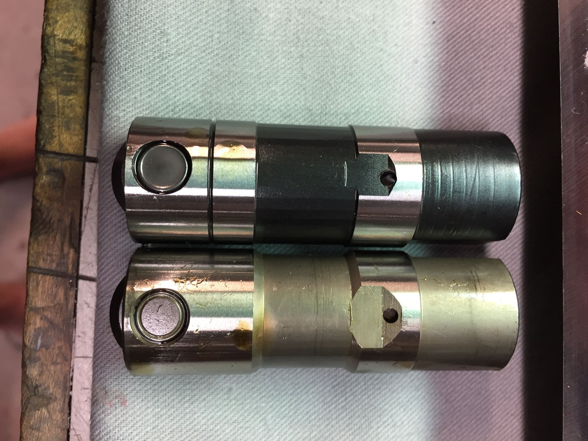

Mine look like the photo.
Got them from Jamisonline.
Interesting that the package came from Tualatin Oregon, just a few miles from where I live.
I'll see how they do!
My springs are 155 on the seat. Other than noisy, the LS7 I was running did not fail......
Ron

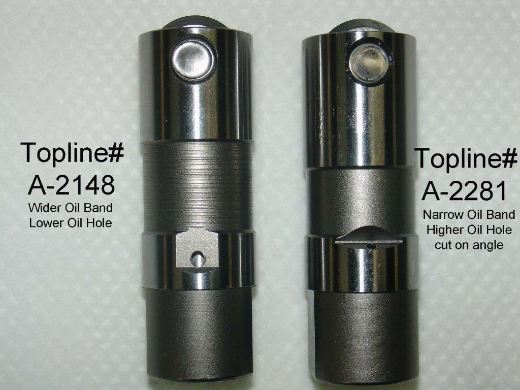

I just want to add this. I bought the Hy-Lift P/N: 2281S which is the "true" LS version. I guess it more mimics the original LS1 lifters, not the LS7 style. Pretty sure its just the oil feed hole size, position and cutout.
Anyway, I took mine apart to clean and found that every oil hole had a burr on the inside. 16 out of 16. This is the hole on the main body, all the other internal stuff looked fine.
It was pretty thin, covering maybe 1/3 to 1/2 the hole, and I was able to break it off with a paperclip with one push, but I wasn't impressed.
I'm still going to run them I guess, wont be for another month or so probably.

Yes I bought the part # A-2148SE a couple months ago for my rebuild. Your #2281S made me wonder if I got the correct lifter.
I had a 2013 year catalog down loaded so I did find the part # A-2281SE for Gm LS 1997-2013 engines.
So I went back to the inter web and found a 2016-2017 year catalog and found the #A-2148 listed for 1999-07 5.3 T ,2002-07 5.3 B ,2005-09 5.3 J
and 2007-2015 5.3, 6.0, 6.2 with De-Activated fuel mgmt
with no mention of the A-2281S
here is the link page 64 for GMC
http://toplineauto.com/wp-content/up...on-Catalog.pdf
So maybe the number has been super seeded?
Looks like I will be taking mine part and look for burrs, thanks for the tip.

No the number has not been superseded they t are diffrent lifters both for LS engines the 2281 cost them a little more to manufacturer .. If you have the 2281S it's a slow leak down and a good lifter I would run them . Take a look at images below !

The flood gates been lifted in the last few days with good information for those considering to use Hylift lifters thanks for posting all info and your experience on the topic !

2148SE vs LS7

A little confusing about the 2281SE being listed as LS specific. I’m wondering why Dave E wouldn’t have recommended that over the 2148SE?
Not sure why they changed the oil groove.
FEIW, the GM part number for the LS7 lifter is also used in the older roller cam small block.
MFR recommendations are just that. We used the Morel 6504 in my buddies turbo LS and I know it’s been to 8000 with no issues.
