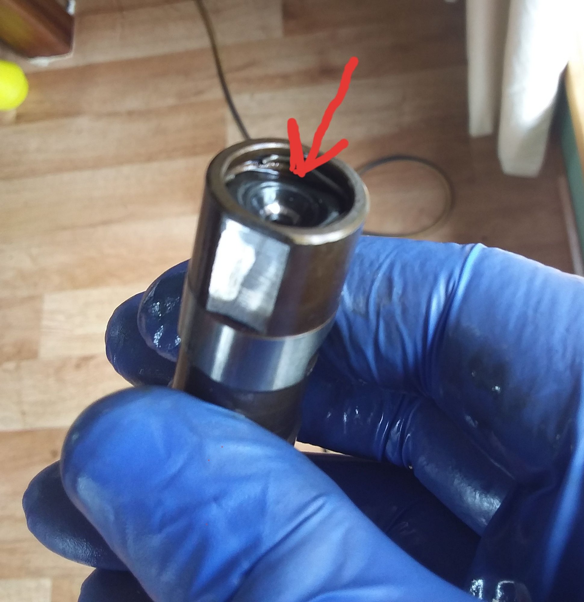

​​​​​​One of my 2148 SE lifters was harder to push the plunger in by hand than all the others but I still used it.

I think that lifters cause the most grief in LS engines.

Rev limit was at 6300, but I only reved it to 6000 a few times.
I'm glad someone has run them at higher lift safely. 0.600 is too much for them.

I think .600" is too high for them also. My new cam is a small duration that peaks at 6300, so on my new tune I have it set at 6200.
Going for low grunt and is working well. Hope you get your valve train quieted down.

I went with the Johnson 2110 Slow leakdown lifters in my new build. Bad luck with Comp and the LS7 lifters I had are what let go, making me rebuild the motor. I looked into The Hylift lifters and almost pulled the trigger but the more I read up, the more I knew they would not work in my build. They seem to be about the same as the LS7 lifters in performance for the most part. I was going higher lift and have preaty heavy springs. These are not up to the task.
Do yourself a favor and get the 2110s if you are spinning over 6000 and have more than 570 lift. about double the price but seeing as i have had 2 motors go because of lifters... it makes sense. it is pretty much the weak link in these motors

Hello, thanks for your comments,
After talking to the seller of the Hylifts and reading "patss/00" post , I took out the .060" locators and the .015' shim to give me a installed height of 1.795" using the Top Hat OE type seals. OE height is 1.800". Ended up with about .078" distance to spec. coil bind which is 1.140". I corrected the the max coil bind height [bench vice tightening] to 1.040" in the early post.
Start up noise is the same but maybe a little better sound when at operating temps. Just a little tick now and then. Which is livable.
The rev limit is set at 6200 rpms, low duration cam runs out at 6300. Good torque at highway cruising speeds.
