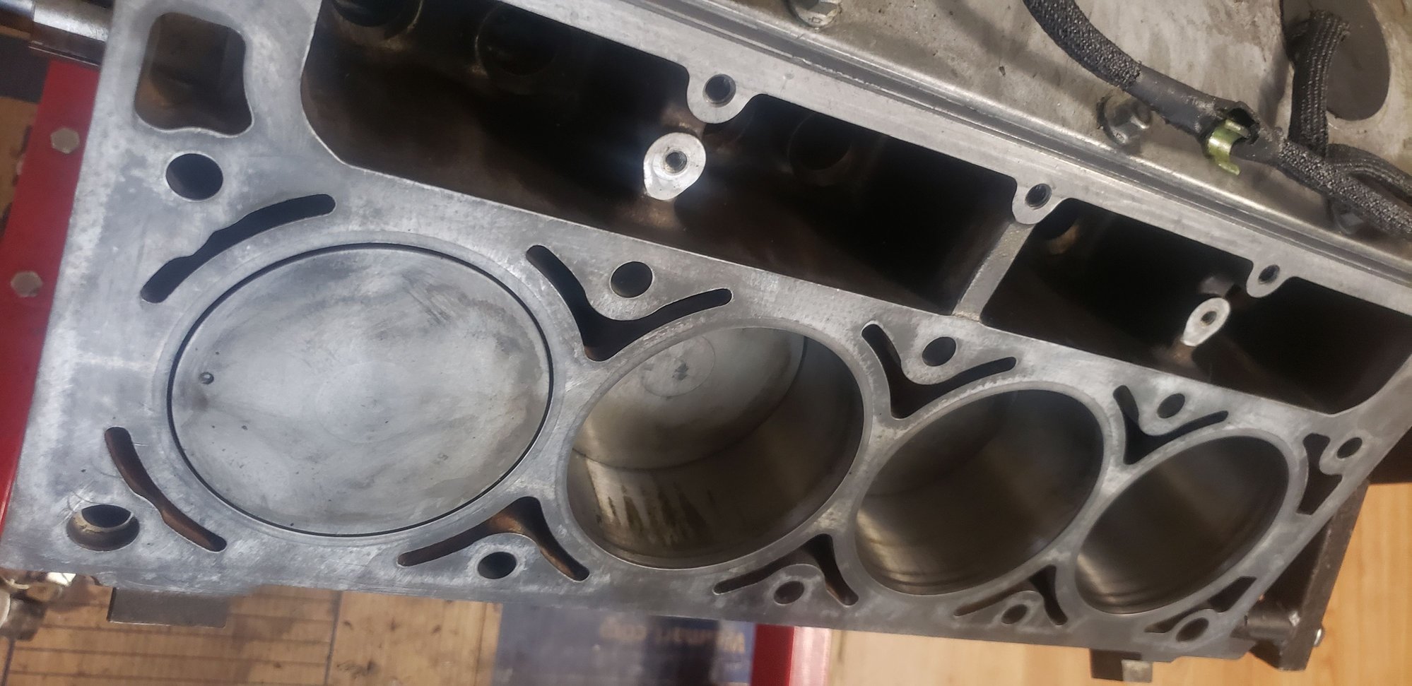

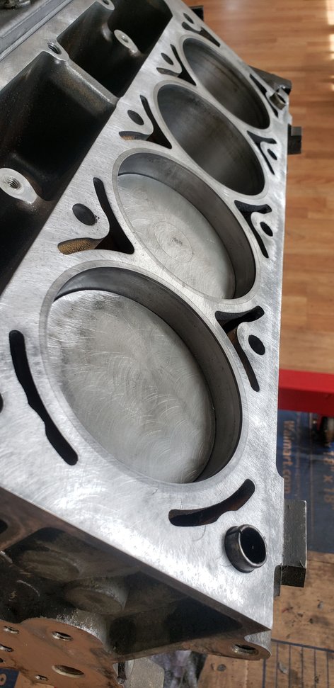

nice clean deck !

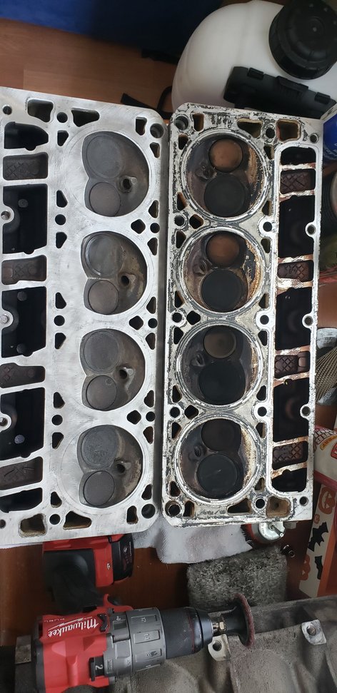

Some 706 heads for this build . Ls1 + 706s = power Before ans after on cleaning the deck
