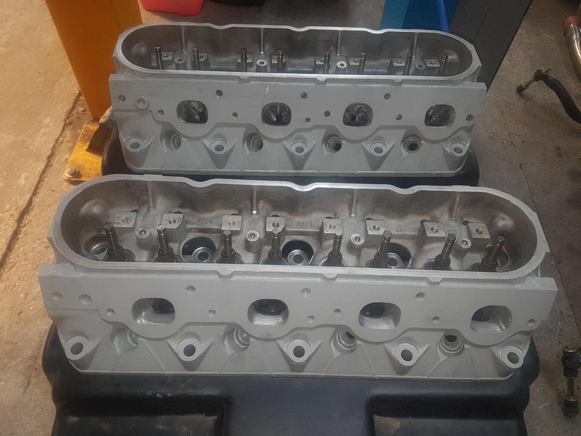

A bit of progress. I reused the lq4 pistons even though I have ls2s. My 817 heads are junk like the rest 😂 the seats are all worn and the valves too. So I bought real z06 243s. Guess what... they are not perfect either. Something went through 1 chamber. I already welded them up and will have them resurfaced.

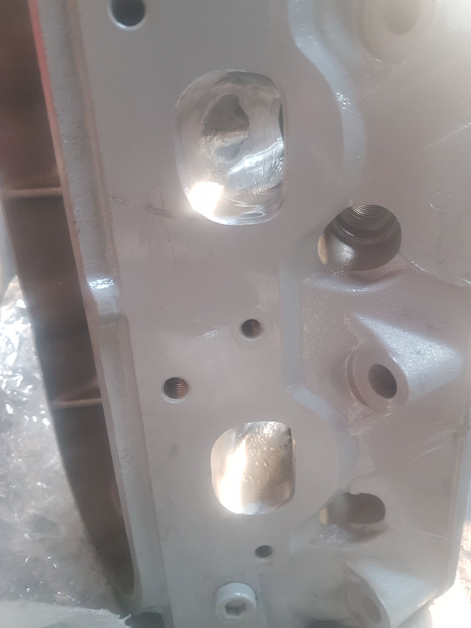

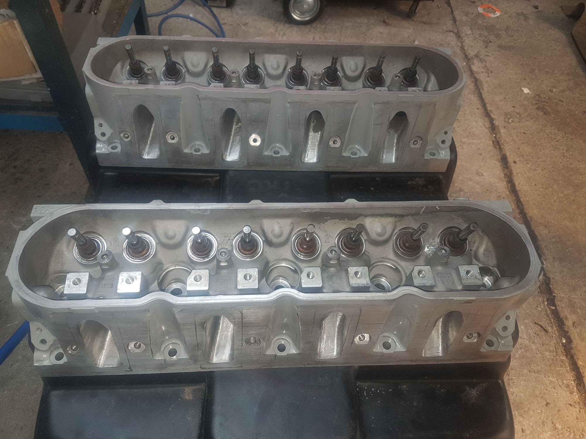

Turns oit the real z06 heads are ls2 heads. 100 and 88 grams on the valves. What a rip off (the heads were sold as in good condition)... so being not as advertised and somewhat junk... i figured Id go to town with the die grinder. Still need to get a new batch of polirolls to smoothen it all out.

Only have to reshape the chamber a bit and lap the valves and these puppies can go back on

Heads are finished. I got them all pretty close to identican ising inside measuring calipers (sorta like a spreader thingie dunno what its called in English) i smoothem the port work. Most effort went into the long radii the guide bosses and the ugly bowls and bowl transitions.
