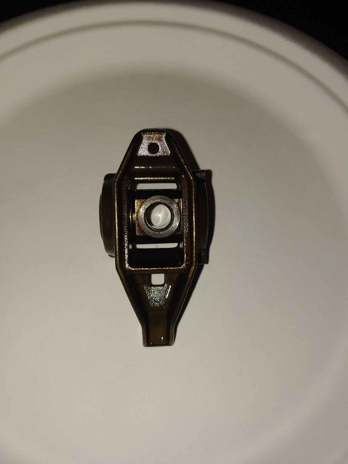

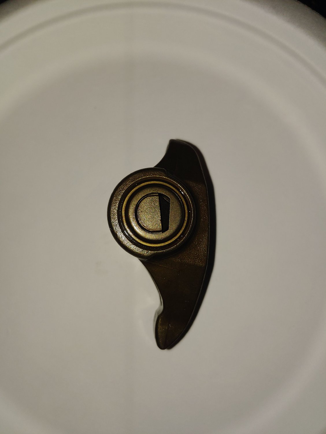

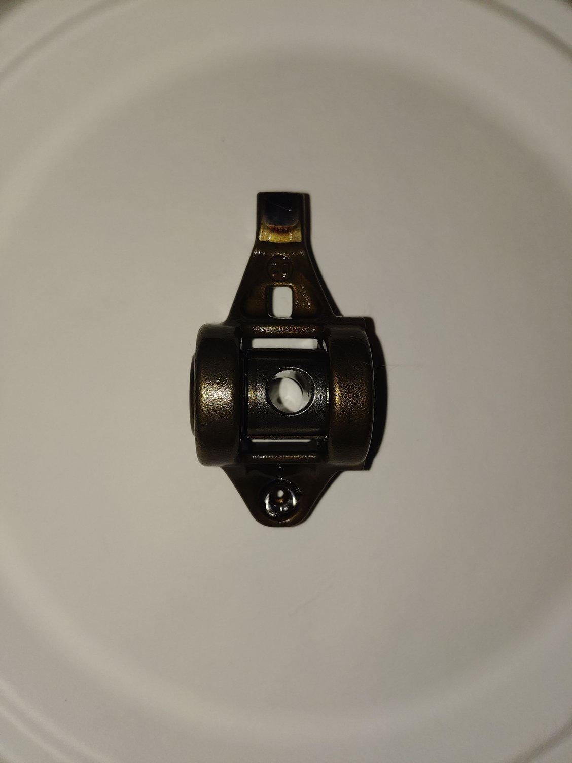

Can you show a pic of the bottom side of the affected rocker?

I dont see anything that says problem with the rocker or pedestal. What cam lobe and spring are are you using? Preload?
