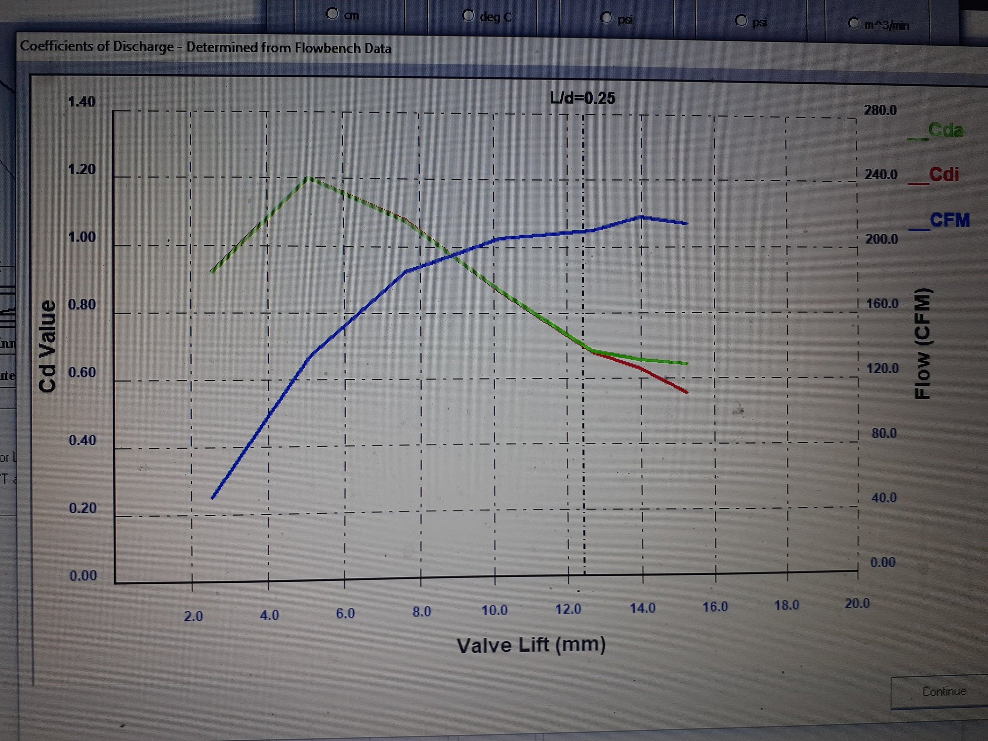

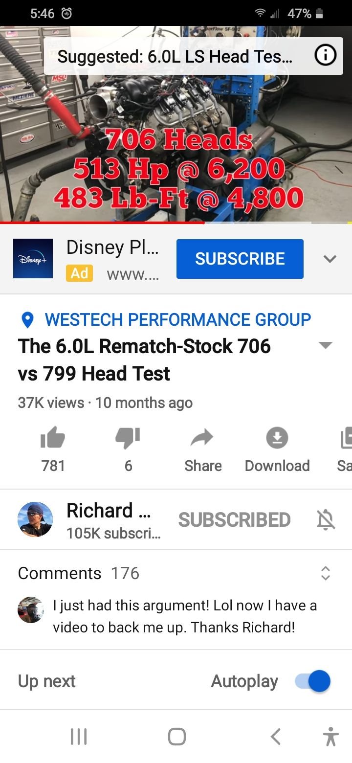

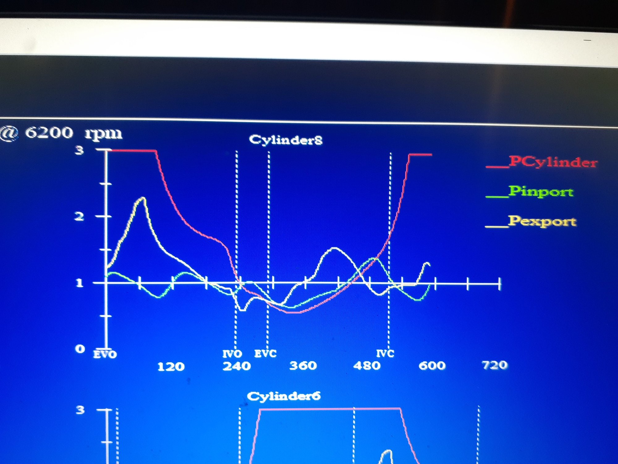

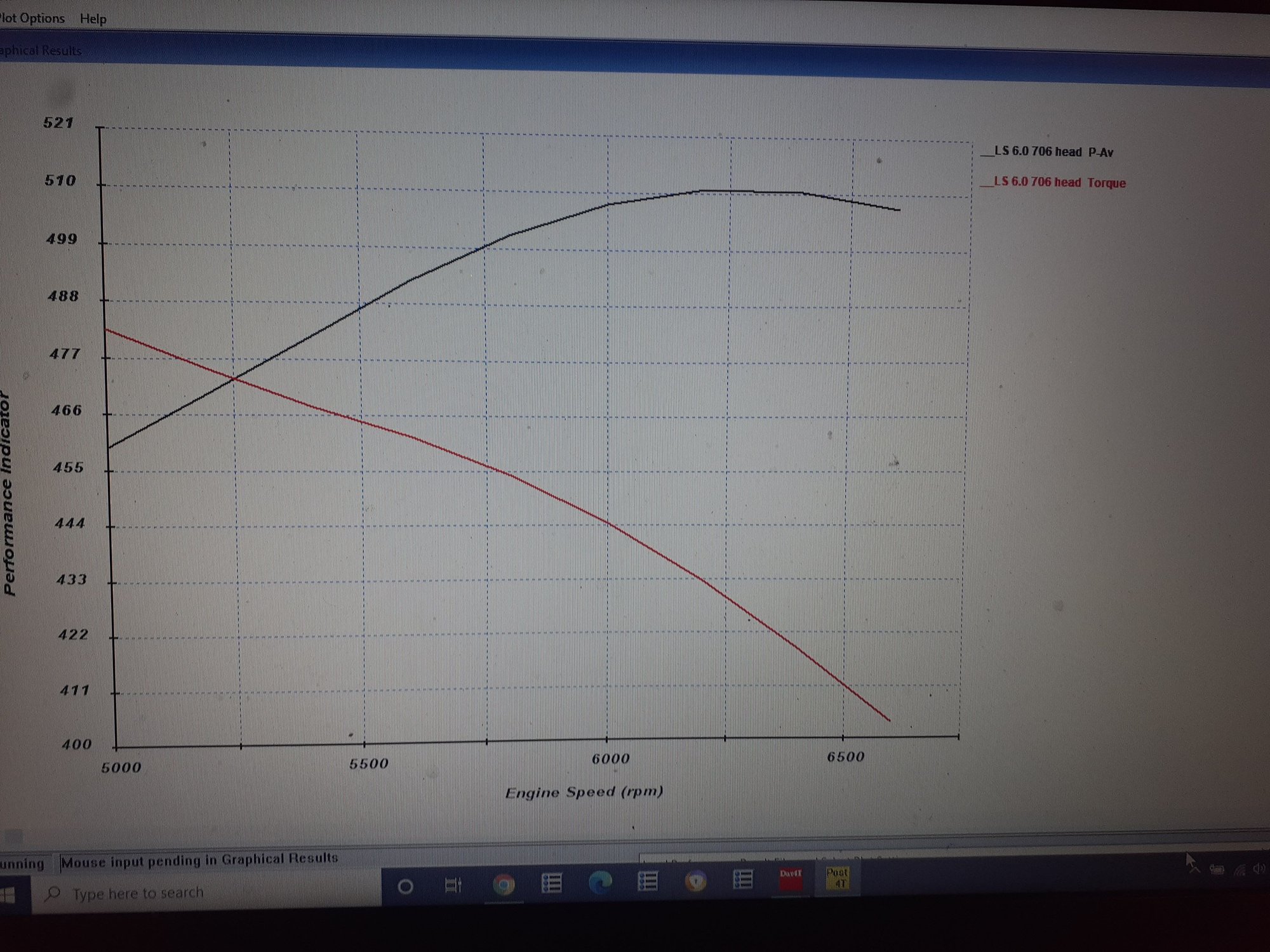

706 1d simulation. On a 6.0
same intake and cam as run by Richard .
what would happen if I lower compression and add some flow and change all the other things required to sim correctly with 317s
and yes i have 799 sim to. Same result as richard. There more to it than flows
Flow curve from my bench used in sim
