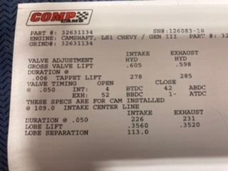

I’m putting a 6.0 in my “shop truck” replacing the 5.3 in it now. Trying to do it on sort of a budget as I have 2 other race cars finishing up. Wanting to transplant the 706 heads and the cam ( see specs below) off the 5.3. I’m putting the summit forged pistons and rods in it as they seem to be budget friendly and bumping up the static compression to about10:1 Mostly wanting any cam gurus to tell me that I can get by with this cam. Thanks

Since. Budget Build and if you can just Hone, I would suggest Ls2/Lq9 Flat Top Pistons for less money and like 11.2:1 Compression with 706s. Cam will be fine with about a 3200 stall and 3.73-4.10 gears. Just my 2 cents. Good luck.

I got 9.6 dynamic with this calculator using flat top pistons, -.005 deck clearance, 61.5 cc chambers and a 4.040 gasket. I'm not sure what the gasket bore actually is though.
But that cam is in now way odd for a 6.0, should work well.

I don't know why I was entering flat tops in the calculations yesterday, that's gonna make the static compression really high. I was thinking "guys run cams like that all the time in similar setups" but they usually do 706's on LQ4's and I was putting it in like it was an LQ9 with flat tops, so scratch that lol.
What I don't know to give you an exact answer is head gasket bore, rod length, piston deck height, piston dish or dome volume, and rod length.
I played with numbers like 4.040 for the gasket bore, 6.125 rod length since they're aftermarket but still could be 6.098, set deck height at 0 since they're aftermarket pistons, took a wild guess on piston volume and entered like 8 cc for piston dish
But when I went back just now and played with numbers and got it to read 10:1 static compression I got 8.49 to one dynamic with your cam's 42 degree IVC
I think static was closer to 11.5:1 when I got the 9.6
Don't quote me, but I think 8.6 is around the highest you want dynamic, that's what I've read from people smarter than me.
