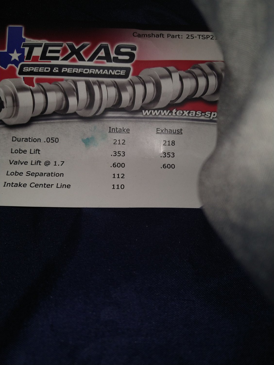

What is the base circle on this cam?

Not sure. Here i took a pic of the specs

I was reading that a bigger lift cam will require a longer pushrod because they have to grind the base circle of the cam to get the longer lift on it.. seen in this vid.

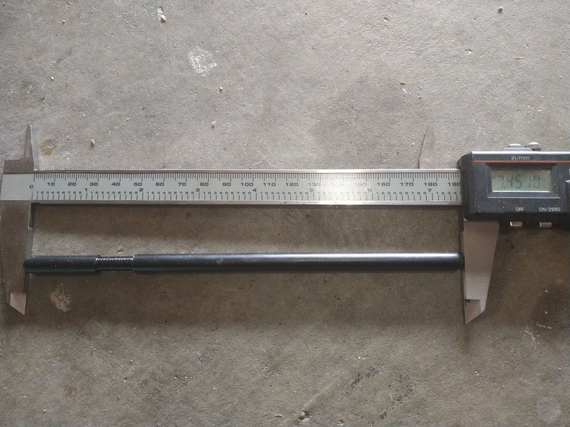

Checked the 13 turns its dead on 7.45

Hmm. Ill check the pushrods when they get here.
The stocks measured in at 7.36 i rechecked the 13 turns an its exactly 7.46. so i guess thats where the extra .1 came from?

Can't measure push rods with a caliper.
Well, you can; you just won't come up with the same thing as they list in the catalog. The "specs" assume that the entire end is spherical; but since there's a hole there, which takes away some of the sphere, they'll always "measure" shorter than "spec". Most if the time the difference is in the neighborhood of .015" but it could be something else depending on the dia of the oil hole.
The threads on the 7702 are .050" each (after all it's ¼"=20 threads), and it's 6.800" fully screwed in. That's more accurate, as far as matching to a catalog "spec", than anything you'll come up with using a mic.
You can "smell test" your results by putting it together with a stock one and seeing where it comes out. Stock length, by the aftermarket spec method, is 7.400". By your measurements there should be around .050" of free play with a stocker. Exactly 12 turns on your 7702 should very closely match it.
