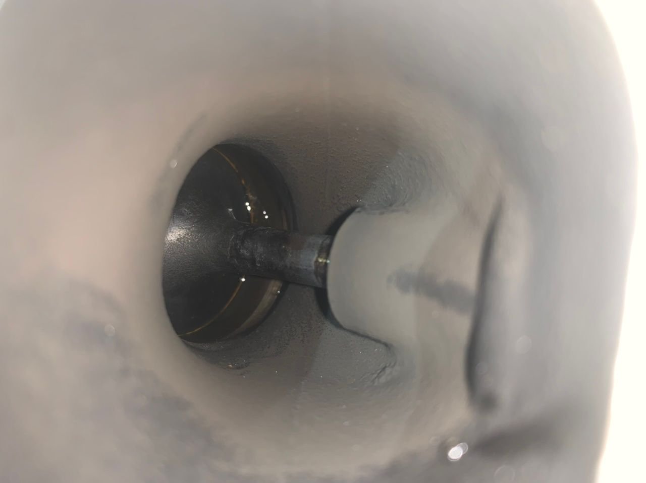

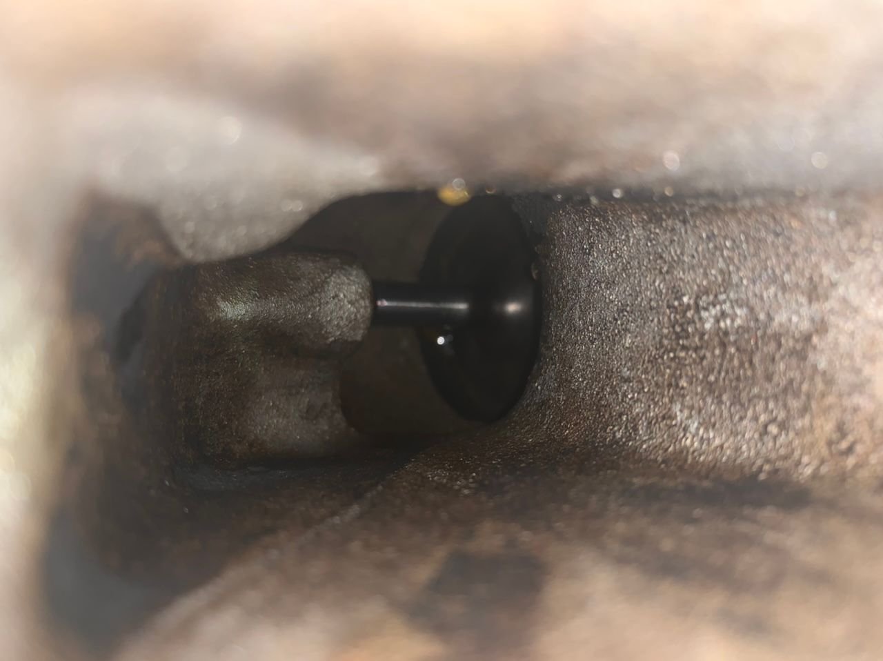

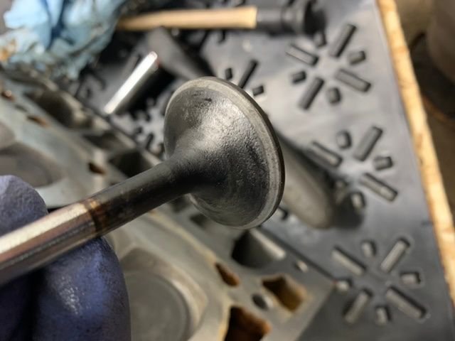

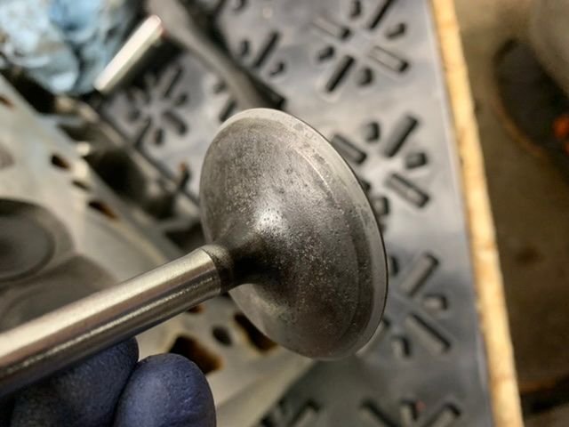

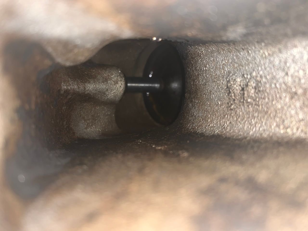

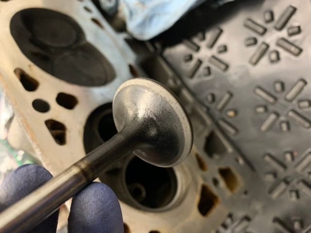

I have a unknown mileage (guy said he bought it from a yard as a replacement which said motor had around 90k) he got rid of it because he had a 58x motor and this was a 24x motor. I picked it up for $250. Ive been through the whole motor, cleaned and had the heads resurfaced, bottom end looked ok, not much hatching on the cylinder walls if any. I had to pull the heads bc of water sitting in one of the heads intake or exhaust tracks causing a lot of rust buildup. I pulled and cleaned the heads, swapped the oil pan to a fbody and put it back together to test it on a stand before investing further. Engine ran no problem but made alittle less vacuum than what I expect for stock.
Engine is now going into a car so I pulled the cam for a summit stage 1 truck cam, new chain and gears. Started pulling the heads to replace the lifters with morel 5315s I picked up for cheap. I decided to pull the valves and do another lapping as I remember some putting on them last time (over a year ago since I have been in this motor). Got the pass side off and apart and this is what I have found.
what do you guys think? The worst one is an intake valve with a large pit (darker area). Not sure if I need to purchase new valves and when they come do I just Lap them and verify a nice contact patch?
do you think they are bad enough to warrant change? Wondering if the lower vacuum around 14-15” with stock 5.3 cam if I remember was because of this? I was looking at the melting V1935 and V2000 valves as replacements. I haven’t gotten to the other side yet but wanted to get your thoughts. Getting the higher mileage lifters out of the bores has been a PITA!
Intake
Exhaust
Exhaust
Exhaust
Intake

I would spend the few minutes to lap them and see if they pass the water test, if so send it.

What do the seats looks like? Are the valves bent?
I bought some junkyard 799s a while back. The valves looked like that, the seats looked worse. Also several of them were bent. Spun them in a drill and it was very obvious. Ended up getting all new valves and valve job.
That was after lapping... lol. I did it by hand tho vs the drill method.

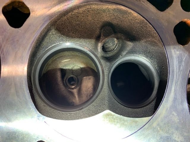

Seats look better on the head honestly... They are not bent. Like I said this motor was run after I got it on a stand before tearing it apart a 2nd time to do the cam/lifters which is where I am at now. They are straight as an arrow just pitted, not sure why but my brain thinks the driver side is going to be worse for some reason and that could be my memory of that side being worse coming through. Won't know till I yank the head and remove of course.
Do they seal up?

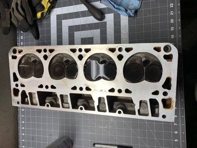

Yep. I put them upside down with water in the chamber and let it sit. See if you get bubbles or a slow drain.

Not a darn thing Its a sanity check.

That pressure is against face of the valve as well, so it can actually help sealing. Kinda like like when its not totally sealed sometimes and then you put the valve spring in and its fine.

There aren't many other ways to check for a leak with the head off that I'm aware of, so that's kinda what you get. But so far every valve I've had pass the water test held compression, the ones that didn't, didn't.
And there's a hell off a lot more than 150 psi in there lol, that helps seal the valve like said above.

If it's a super budget motor I wouldn't get new valves or machine work. Just lap and see if it seals.
Where I had worked there was a vacuum testing machine that would pull vacuum on a hose. We had flat pieces of aluminum with a hole in the middle with rubber on one side and a fitting on another. You put the vacuum hose from the vacuum pump on the fitting side and the rubber side on the port(s).
They looked like this:
https://www.ebay.com/i/402340606215?...BoC2RUQAvD_BwE
I've personally never done the water method, but if you don't have the means to make your own fittings and have a vacuum pump I'd just try the water method the other people have suggested.

Ahhh gotcha. Followed everyone’s advice and pulled the driver head. Flipped it over and installed spark plugs. Put water on it and let it sit for 10 min and no bubbles or leaks. Decided to redo the lapping on the pass head with a drill this time and gave it all she’s got. Assembled the head back together and put water on it and didn’t see any leaks but I had to leave in a hurry so I will check tmrw to see if it’s leaking etc. So far so good!

Well ****, left the head with water in the chambers over night and all day basically 24 hours and had water come through on every exhaust and intake valve on this head....
is it because I left the water on too long? It was showing signs of rusting already. Figure I could just replace all these valves and let it eat or screw it and just clean it up and throw it back together?
they all basically looked like this and these are all different runners mixed exhaust and intake.
