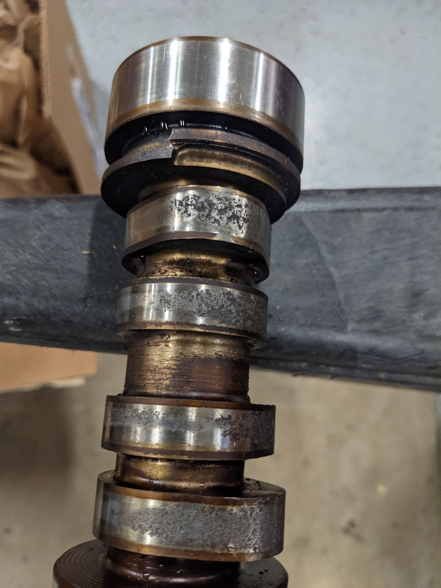

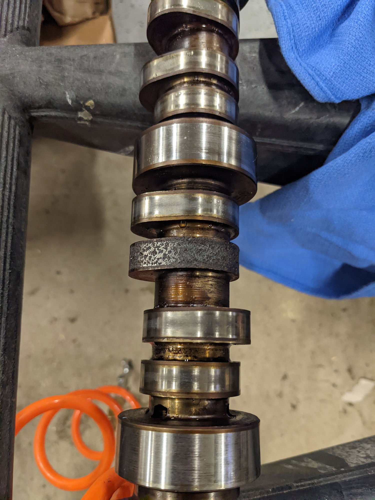

I'm rebuilding an LS1 from a 2000 Z28. I was replacing the cam with a Summit stage 2 car cam. But when I pulled the cam out I saw this.
What caused this?
2nd question. I was planning on keeping my stock LS1 heads. Now that I have to take them off I want to upgrade to 243/799 heads. Would I do better with a summit stage 3 cam at this point? I can ask them about exchanging (It has not been installed yet)

How many miles on the engine, and was it serviced with good quality oil at decent intervals?

110k miles. Unknown history. I bought the car to swap the engine and trans into another car.

Brinelling, spalling, unless this thing has broken springs or failed lifters I wouldn't be surprised to find that the lifter guides on the wiped out lobes weren't holding them square.

Looks like the engine sat for a period of time, opened to the elements. That's some heavy corrosion and pitting on those lobes.

Looks like condensation in the engine neglected service and stored at the bottom of a lake.
What does the rest of engine look like???

I guess I'll be going through it at a higher level than I intended to. I'll let you all know what I find. It ran ok when I bought it. Shrug.

That cam gives us the feeling that this engine has lived a hard life and was put out to the pasture! Good call with diving deeper in now. You might spend more money upfront but could very well find other problems that you can fix before they cause an engine failure.
Dive in and see what all you'll have to replace. We'll have parts for you no matter how far you have to go with it. Regarding our stage 2 SUM-8707R1 cam. We would shelve thinking about a different cam until you get the engine apart and see what all else is needed. Then you could let the community know what the combo and goals are for this swap. It may end up the 8707R1 will be just right for you. If you needed to return it that isn't a problem as long as it's new and unused and within 90 days of the date of purchase.

I Dug into it... Some lifters show a little corrosion at 1 spot... Likely where it rested against the cam for a prolonged time. I need cam bearings. I'll replace the trays too, though they look fine. The knock sensors were a little rusty. There's definitely a little rust in the coolant.
What I think happened... The steam pipe leaked at some point (hard to diagnose since I've already replaced it). The corrosion areas are where water would have dripped down from atop the valley cover. There is minimal buildup on cylinder walls under the Pistons. Not too significant.
I'm guessing it got a little water in it and sat.
