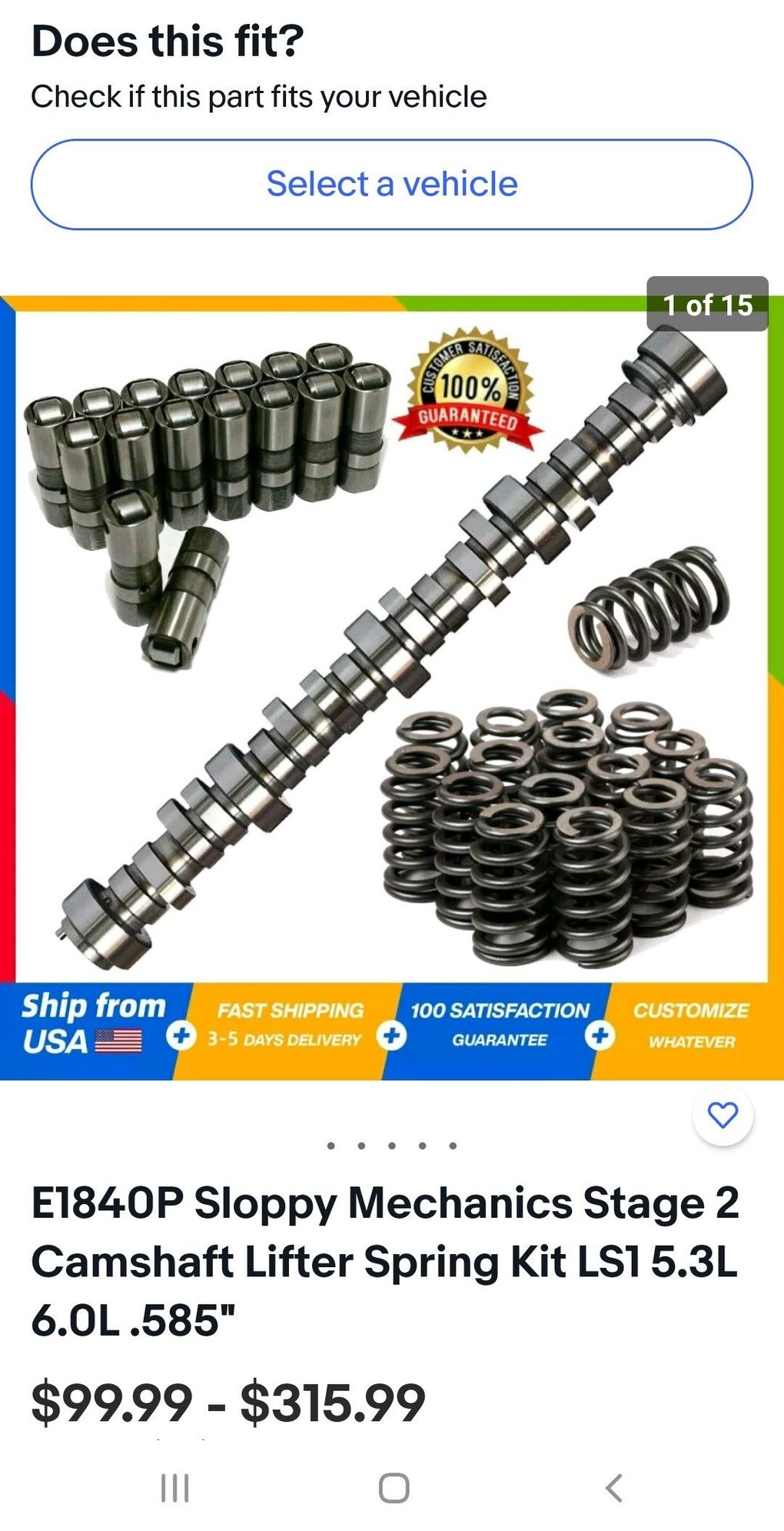

Currently running this cam in a 6.0 in my 2004 Mazda RX8 and while I'm "happy" with it.. It certainly is NOT a good choice for low RPM street use. As light as my RX8 is this cam won't build any power until at least 3500RPM.. This is a manual trans car and without a stall converter-its a f'ng DOG down low.. It's like you've hit a nitrous button at 3500 rpm as it will begin screaming from there on... NOT a good choice for low end grunt though at all. If you want to KILL all low rpm grunt-just run the sloppy stage 2 cam.. Guaranteed to make you smile at 6500+.. Guaranteed to make you weep, or fall asleep, at anything under 3500.. That's why I wanted the tighter LSA.. It supposedly really wakes up the LOW END. LOW END is all I want for this car. I've got the compression. I've got the gearing 3.73 with 27.5" tall tires.. I just want some good grunt off the line-NOT a 6000+ RPM screamer as the car will never see that.. Factory exhaust manifolds.. NO long tube headers.. If that helps. If the CRUCK falls flat on it's face at 4500 RPM-thats fine! As long as it spins the tires until that point.

I agree the Sloppy doesn't have much low end grunt without a converter. I went from the sloppy stage 2 to the cam motion "little chopper" (222/232 .595" .587" 108+3*) in a 6.0 LQ9 truck. It noticeably brought the power range down lower and had a nice lope. It fired right up ran and idled well on the sloppy tune. After data logging the changes were minimal between the two tunes. The chopper closes the intake early at 36* degrees which builds the dynamic compression and with 11* degrees of overlap it has a nice lope. Without a decent stall you're shooting yourself in the foot with most performance camshafts. With a factory stall I'd probably go with the BTR Texas Ranger camshaft.
The "little chopper" in my LQ9 2000 Sierra (3200 stall)
