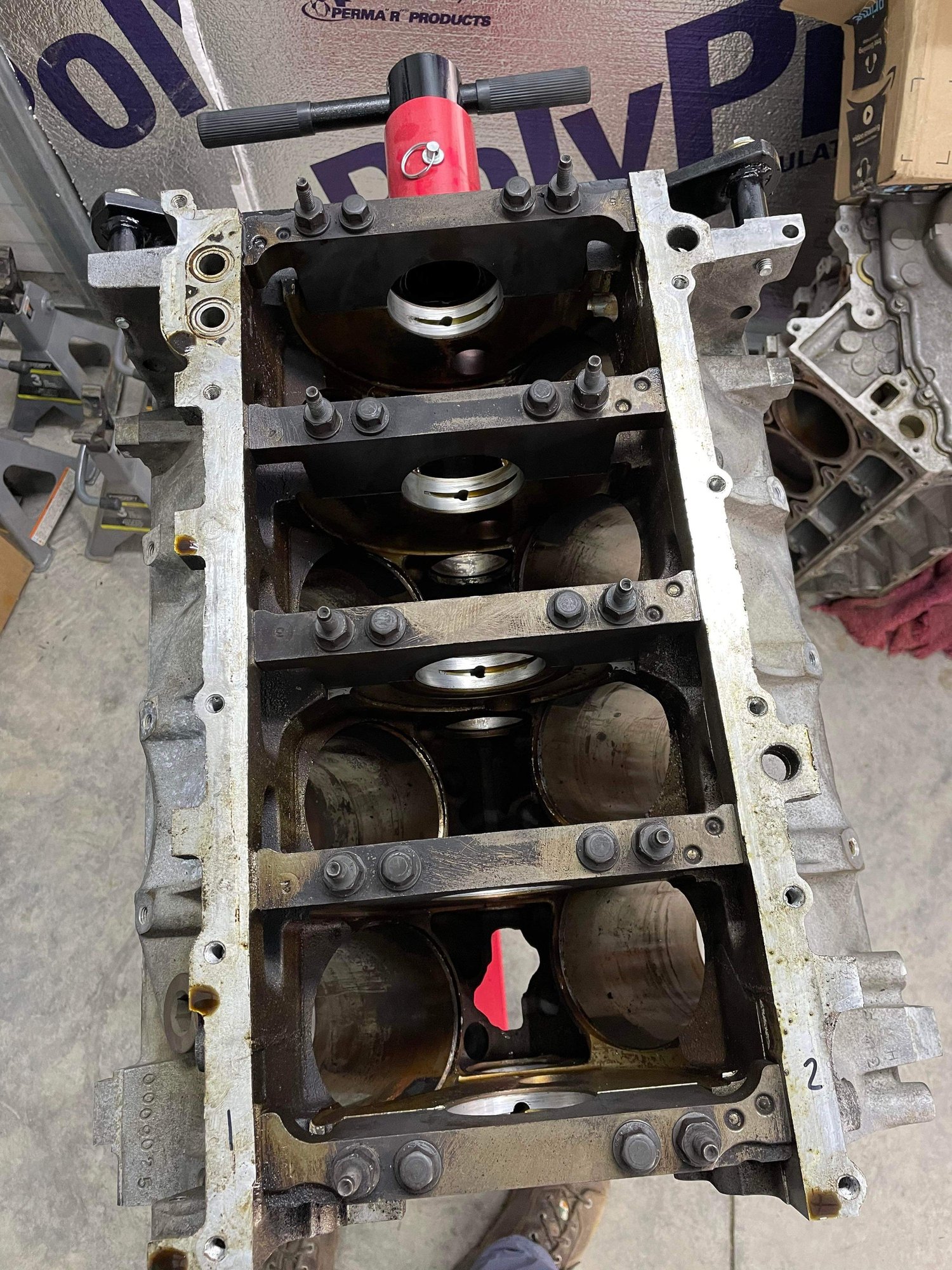

Unable to find that.
this is the only noticeable numbers.

dont have any casting marks there. Just have this

At first glance, if it is a 5.7L block, it looks like an LS6 block. it doesn’t have that column in the valley like the LS1 blocks do.
Are you sure there are no casting numbers? Double check the back of the block around where the bellhousing bolts on. It should be one of these two spots.
what is that arrow pointing to?
at work currently will check again when i get back home. May have to scrub that area.
It’s pointing to a little column that was cast into the old LS1 blocks. It’s significant because you had to cut it down to fit an LS6 valley cover on them. Heres another photo from an old “how-to” article.
Like I said in the other thread you have going, some of the other photos of the block show some things that make it look like it’s actually a 5.3L block.

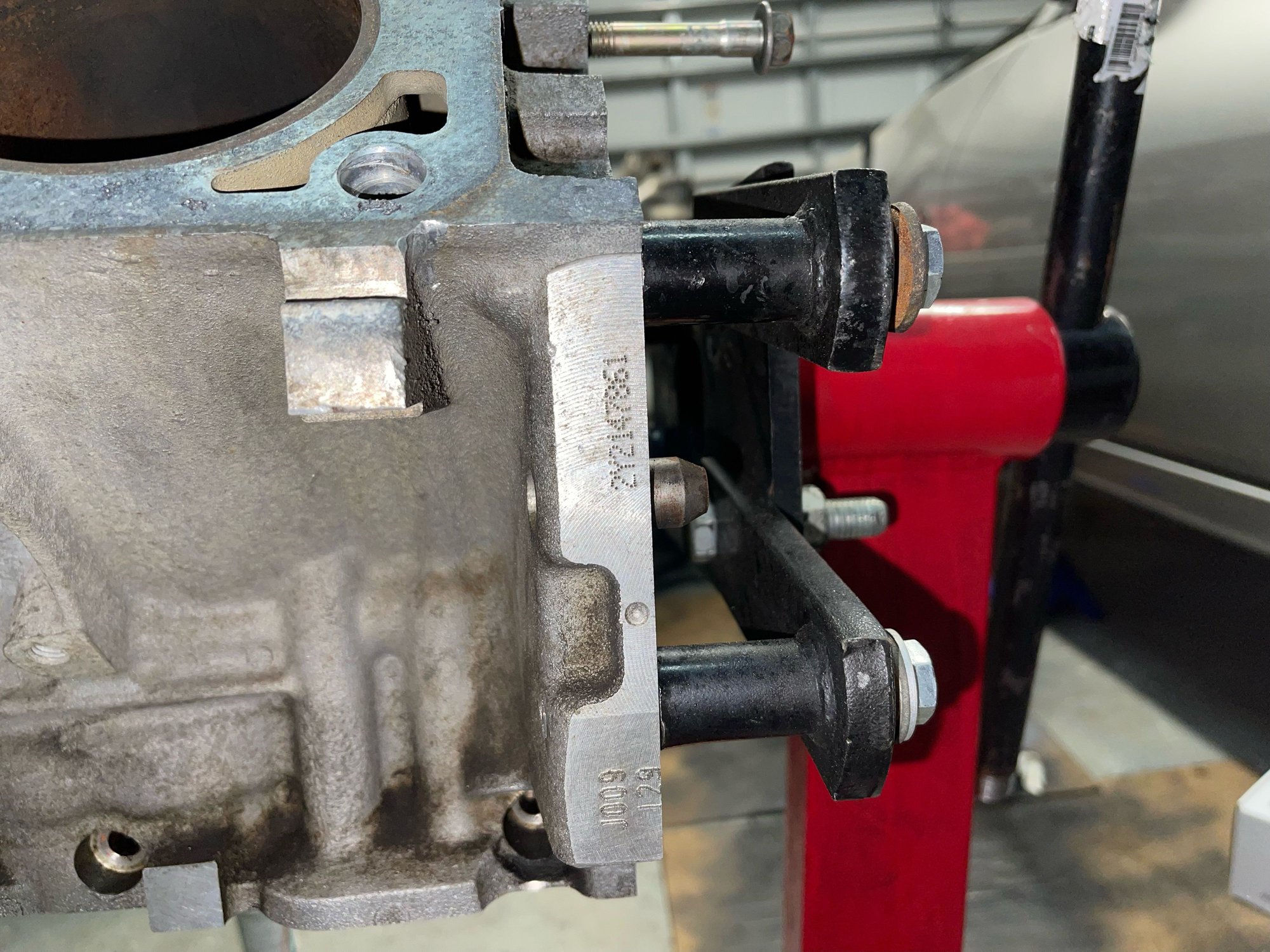

Found this
If I remember correctly the design of the backside here means it’s after a 98

https://ls1tech.com/forums/generatio...hat-block.html
"12560626"
there you go.
