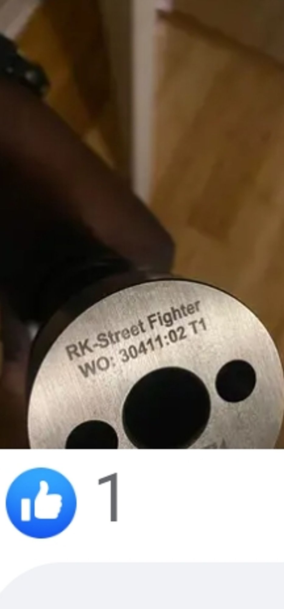

Anyone have any info on this cam? I called TSP and they are being bitches about giving out the cam specs. Said they won't give out there customers cam specs. So I called RK speed and emailed them with no help again.

Maybe you should try contacting RK Speed instead of Texas Speed for those cam spec's. Does the WO stand for work order?

I did call them and talked to them along with emailing them. They said it was a older grind and they couldn't remember the exact specs.

Looks like it's going to be degree wheel wheel and dial indicator time.

They're very secretive about specs. He specs his own cams. Seriously doubt he can't remember. I did see someone selling one I think on FB Marketplace and they advertised it as 239-247, 649-629, 114+5, but unless given to me free and I was willing to try as is, or have it doctored, I would not buy.

As mentioned other companies can cam doctor it and give you a print out.

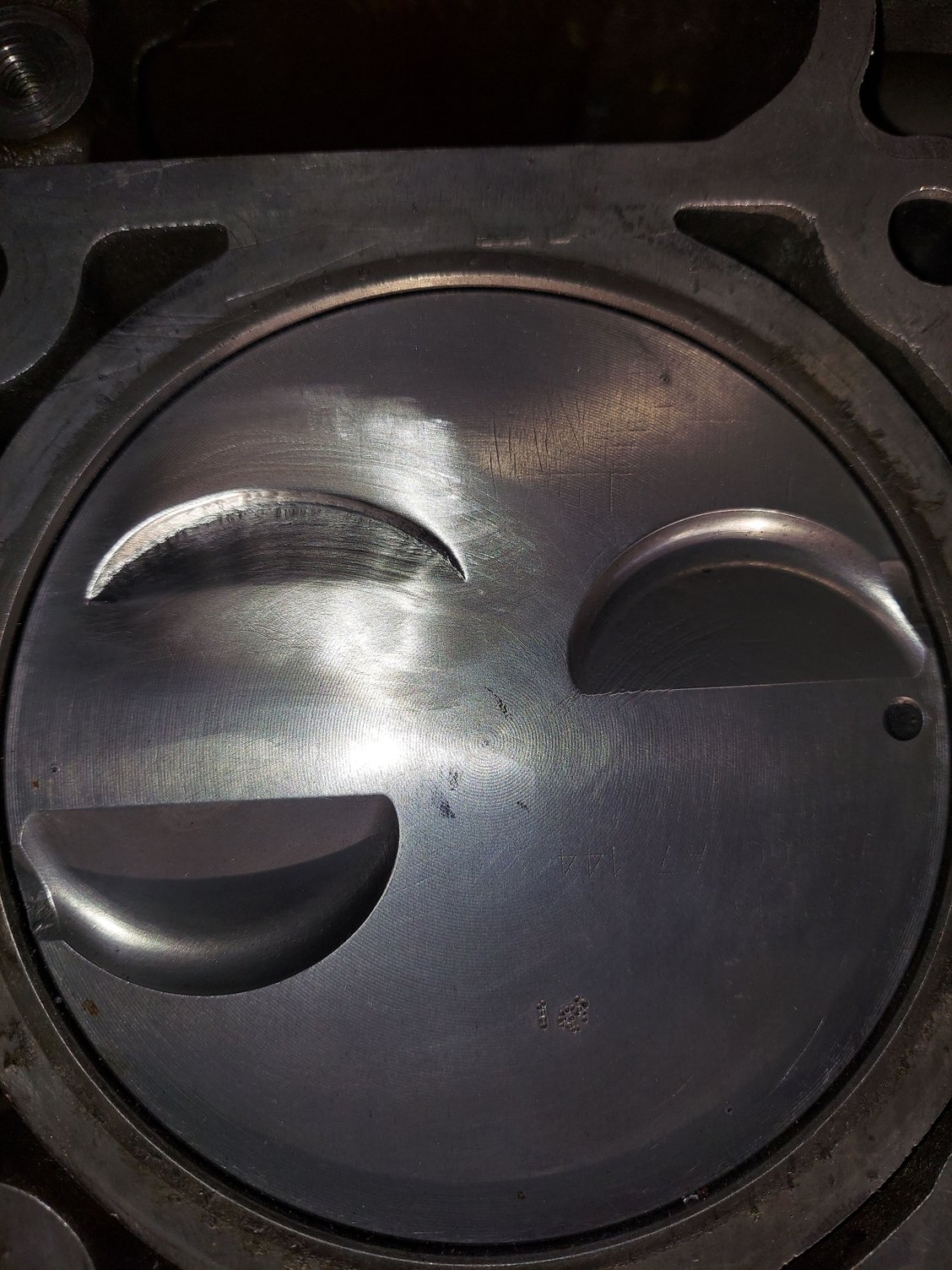

Guys I know how to use a degree wheel. Got my own tools to do it. Problem is I don't have a spare block sitting around to do this and don't want to pull the heads off to put a solid lifter in place. I was told this cam is a 239/247 .617/.617 112 lsa. Just want to make sure before I install as I don't need a piston to valve issue on the factory pistons that I have flycut .060 . The heads are TFS 235 milled down to 60cc. I'm also running a felpro 1041 HG that is .041 thick.

It's the duration that is of concern because lift can be checked with a micrometer and the camshaft in hand. That's probably too much duration for a flat top piston but you have valve reliefs cut and P-V would need to be checked anyway so maybe install it with some checking springs and confirm the duration and LSA.
