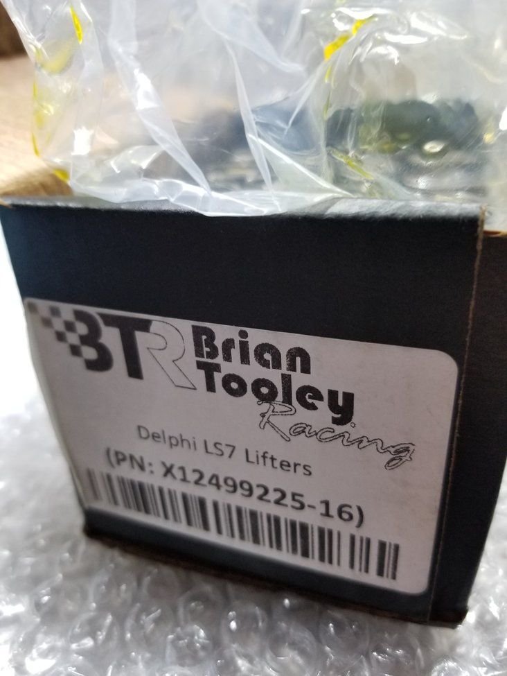

I used BTR Delphi LS7 lifters with GM lifter trays, for about 3 years now and buzz the engine to 6300 rpm almost every time I take the car out.
Yes they are in a ziploc oil bag but I don't care.
Here's a good video on BTR's website, the man himself tells you about the good and knockoff lifters differences. Scroll down on the link.
https://briantooleyracing.com/delphi...499225-16.html
