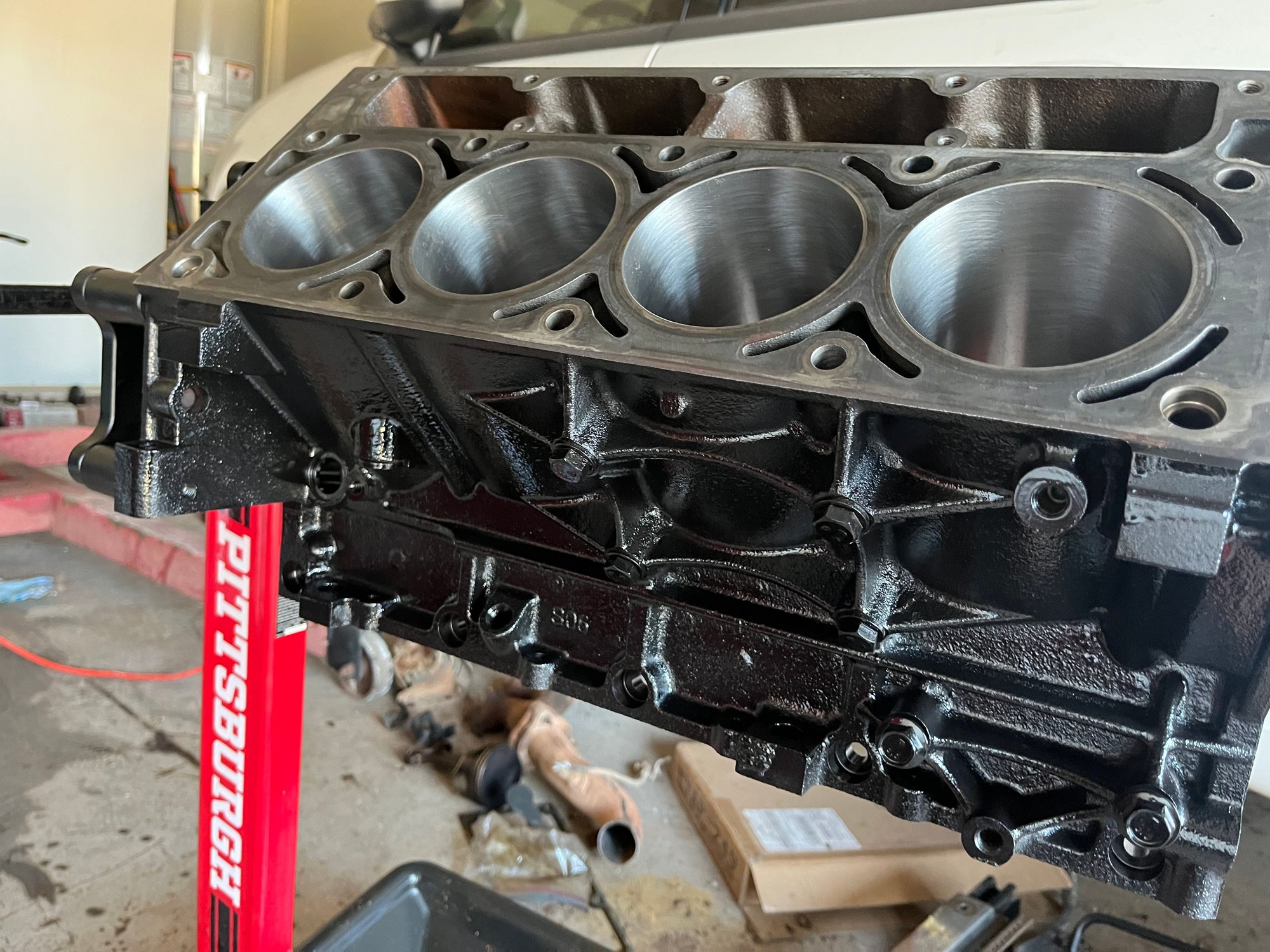

This is my first time to do piston rings ( done them in dirt bikes, but they come ready to install).
I have a gen 3 5.3, bored .30 over. What should my top and bottom ring gap be?
thanks.
