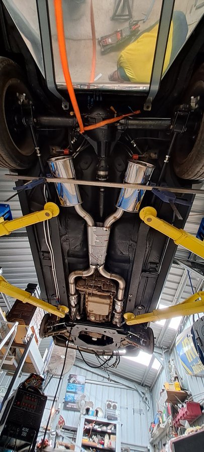

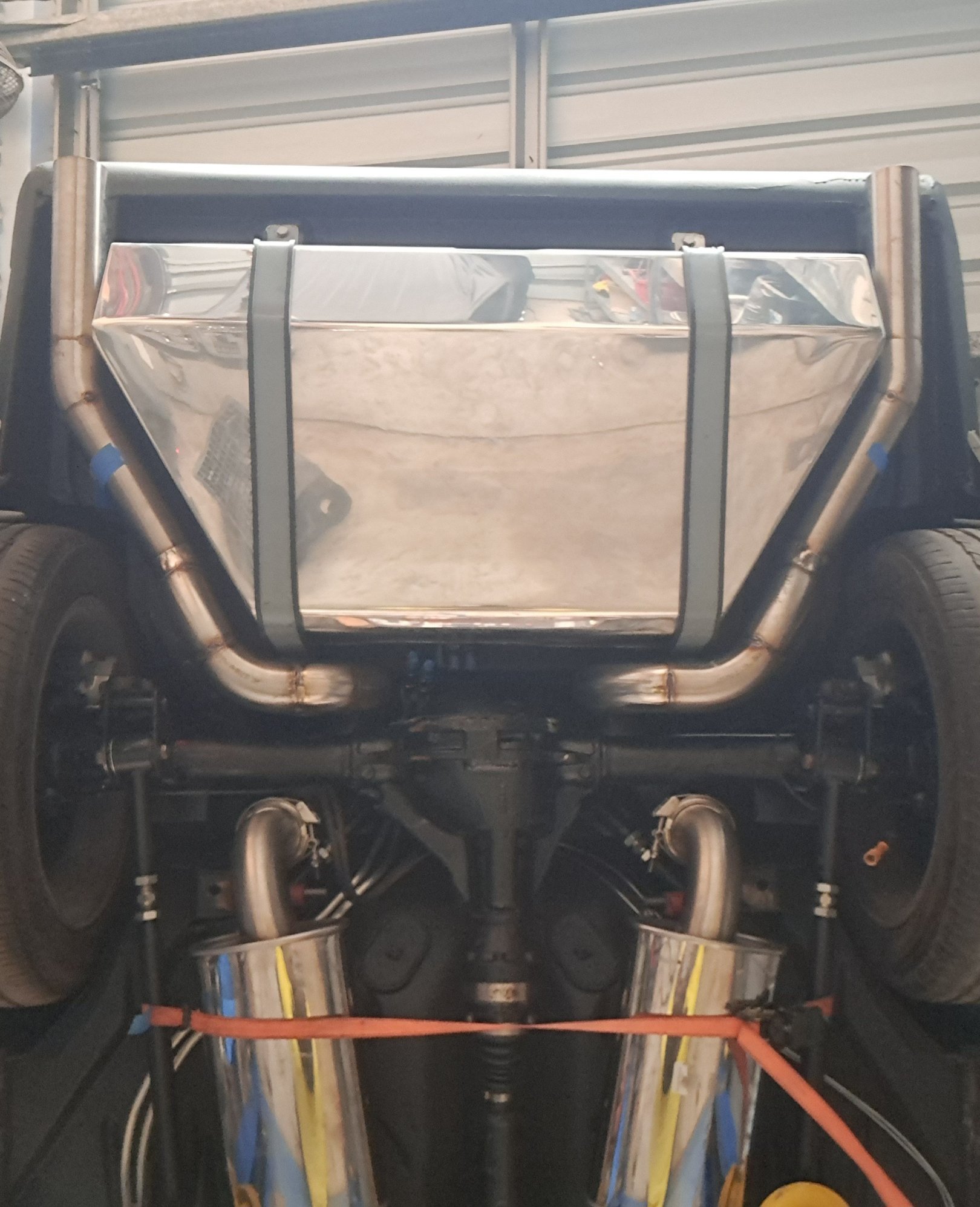

I have a custom built 4 into 1. The exhaust primary pipes are 1.62" inside diameter and 2" outside diameter steam pipe to retain heat to increase exhaust gass flow volisity further into the exhaust system.
they average 32/33" long. To a tapered collector 3.5" down to 3" that is 10" long. They go to 100cel cats and twin 3" true dual exhaust system with a expansion chamber that is 355 cubic inch in size. Mufflers are straight through race style glass packed Mufflers. This is when I was building the exhaust system
