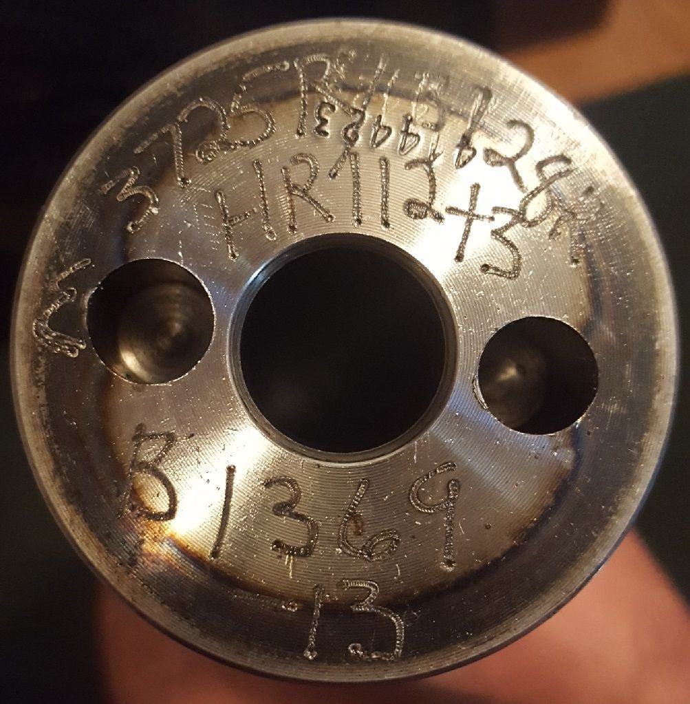

Just got done testing the original 1905 valve springs on a very accurate Intercomp valve spring tester
I will admit I was surprised to see how well they hung in there with the amount of miles on them. For a more affordable valve spring you certainly cant complain one bit....Im impressed actually
At 1.800 the installed seat pressure varied from 149 - 161 (advertised at 160 @ 1.800). Note I didnt actually measure their original installed height because I got the heads disassembled from Mike but I was informed they were set up at 1.760 so even the weakest spring at that height measure 164 lbs on the seat
With Mikes OEM rockers and the cam he had I would say with a high degree of confidence that reduced spring pressure (and potential valve bounce) wasn't the cause of the issue. This assumes smoother cam lobe designs and I don't have any info on those particular lobes but for the spring to last this long the lobes must have been smooth.
Btw the rate of the spring was advertised at 392 lbs per inch.....even the weakest spring came in at 420 lbs per inch (which is somewhat common....in the sense I see quite a few springs from the higher quality spring manufacturers come in above stated spring rates).
What else....hardness test on the cam lobes....to me it makes sense the really worn lobe had the lowest hardness as it had the most material removed. Surface hardness only goes down so deep and with more material gone the material that was left should have shown a lower hardness value
A big reason I was never a fan of cutting cranks .010 under....while you get the journal nice and round again the actual surface of that journal is softer than what it was at the OEM diameter due to the depth of the material cut and a lower hardness at that depth.
Also the depth of the heat treat is really dependent on how the part is heat treated so that's a moving target also
Anyway....we didnt find the smoking gun with the spring testing and good on PAC Racing to offer a spring at this price providing that much longevity
I don't regret pushing Mike to go with the higher quality 1200 series though....too much riding on the springs to save a few bucks there if your goal is trying to get yourself the most reliability possible

Normally, my go-to is 8620. not sure who is going to grind the new cam, so I'm not sure I know all the options. Given what you're already dealing with, i would ask about 8660 if it's available, as you're highly likely to get over a 60 HRC. I think comp does 5150 for most of their cores. Any of them make for good base materials. I just really like the nickel-moly steels, because they make a great combination of hardenability and material toughness. the -60 will be a harder material, and the -20 will be tougher. Again, given what you've dealt with twice now, i'd err on the side of harder.and go with the -60
Fun fact, on these alloys, the last two digits are the carbon content
8620 - 0.20% carbon
4140 - 0.40% carbon
5150 - 0.50% carbon
Carbon = harder and reduction in toughness / ductility. Since you won't be using the cam as a drift while hammering pins into place, you'd probably do better with 8660. Sorry for the long answer to a short question. Everyone always tells me that they want to cut one of my hands off, so i quit saying "but on the other hand..."

here is a simple example of a case hardened 1" bar. Polished and etched, you can REALLY see the difference.
There is a look at it under a microscope. The etch is kinda crappy - should used nital 4%, but whatever.
