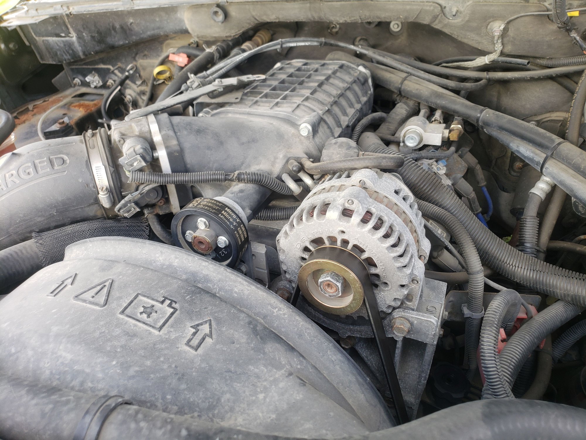

. 12 PSI Manifold Pressure. (drops mic).
