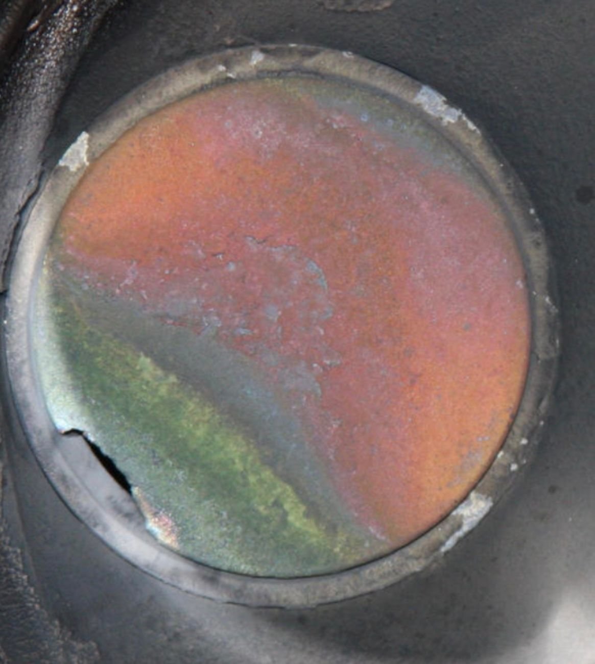

Would think if your exhaust valve was leaking due to a bad seat during ignition it would look more like this, the hot gases would be forced into a small area burning the valve. If the whole seat was bad from the get go you wouldn’t have compression.
Trickflow came to their conclusions because the whole seat was mushroomed, because it was annealed from the high exhaust gas temperature.
Oh ok so It would be on the valve face itself? Then possibly break off. My question is so how would I be able to see in a log high EGTs without an egt sensor? Do you know what temp it would show the headers glowing? I mean trickflow is right in the sense let’s figure out what caused it but obviously after all these posts no one really had any explanations besides them. Bad timing. Besides timing what other mechanical aspects could cause the temps? I’ve read blocked exhaust. Lean or rich air fuels. My thing is this was immediate at least I think so. Could the rockers of side loaded the valves not causing them to seal and cause the issue?
