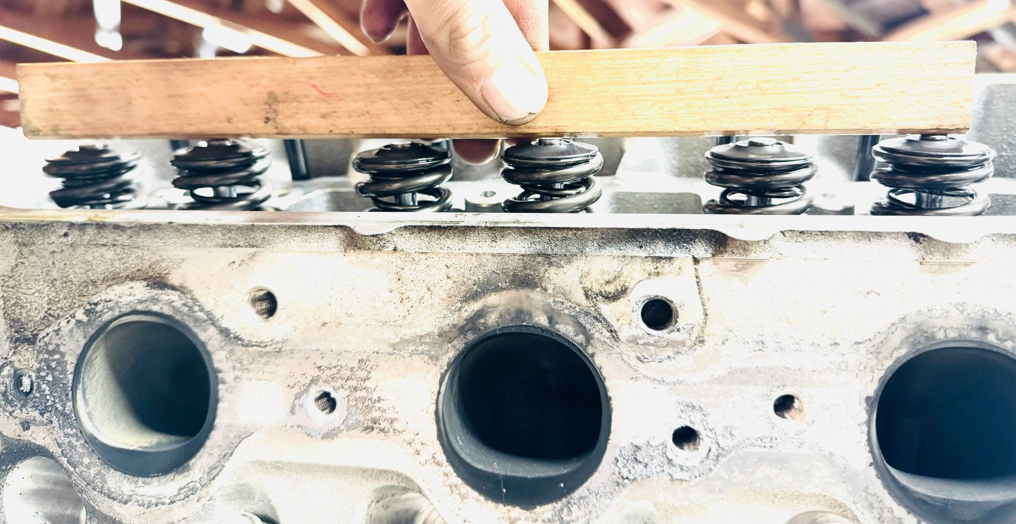

So little over a year ago had motor built. Got the trickflow heads had to get rockers to support them. Ate threw the rockers in no time preload was good valve tip height a little off was told it’s ok. Fast forward to 4 months ago pulled the motor. Noticed all the rockers were completely smoked. Harland took care of me says he’s never seen it something was off on the heads. Put a flat bar across the top valve tips all over the place. Call trickflow said send them in. Guy starts blaming me saying looked like I was running boost nitrous mind you this was in a pickup with a small truck cam. Guy proceeds to tell me over $1400 to fix them as they’re pretty much junk, after spending 2800 on them a year and half ago. What could have caused these things to smoke rockers and throw valves out of wack. I’ve heard of numerous complaints of seating issues guide issues you name it with these heads. Hindsight’s 20/20 but curious who else is running these or can recommend another company as I’m not putting a single cent into these junk heads. Couldn’t even take the time at the factory to take down the machining burrs

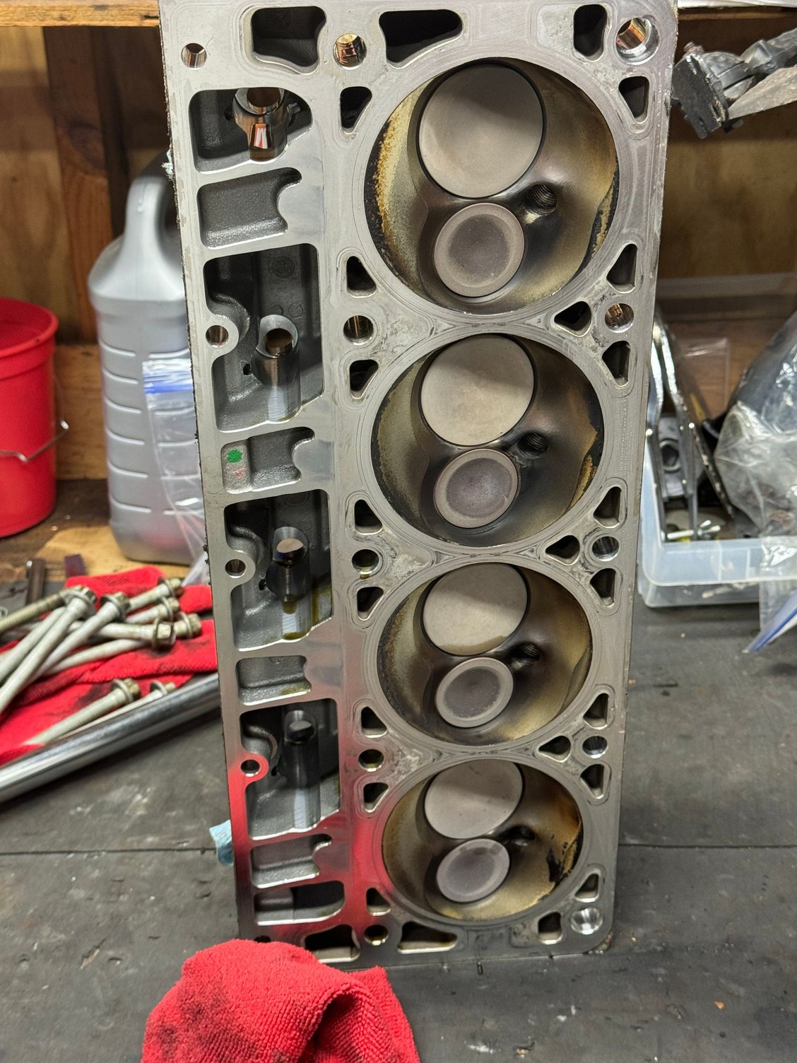

Yeah looks like they were getting pushed left to right right out of the box there was a variance in valve tip height so not sure. Got them back yesterday deep scratches all over the deck not cosmetic ones you can get with your fingernail.

Where did you buy the heads from? I guarantee someone swapped the valves and put wrong length ones in. Your builder is ******** for putting it together abd giving it to you like that. Truck Flow isn't perfect, but no way those left them like that.

Got them Direct from summit. There was a small variance between the two but preload was fine with the ls7 lifters. yeah in hindsight they should have been sent back then. But clearly something went wrong with the seats during break in and caused them to sink even further the heights are the same out im pretty sure. To me it’s like the guides or seats were wrong from the jump. The variance you see in that picture is after 10k miles on the heads. Guy at trickflow said it’s more abuse using them in a daily driven car versus one that gets launched down a track which is insane to me. Talked to another shop who builds his own ls heads says he’s seen nothing but problems with a lot of them same with the rockers but at least Harland took care of it. Harland said they’ve never seen anything like it.

Thats pretty bad. Id be curious to see a teardown and analysis on those.

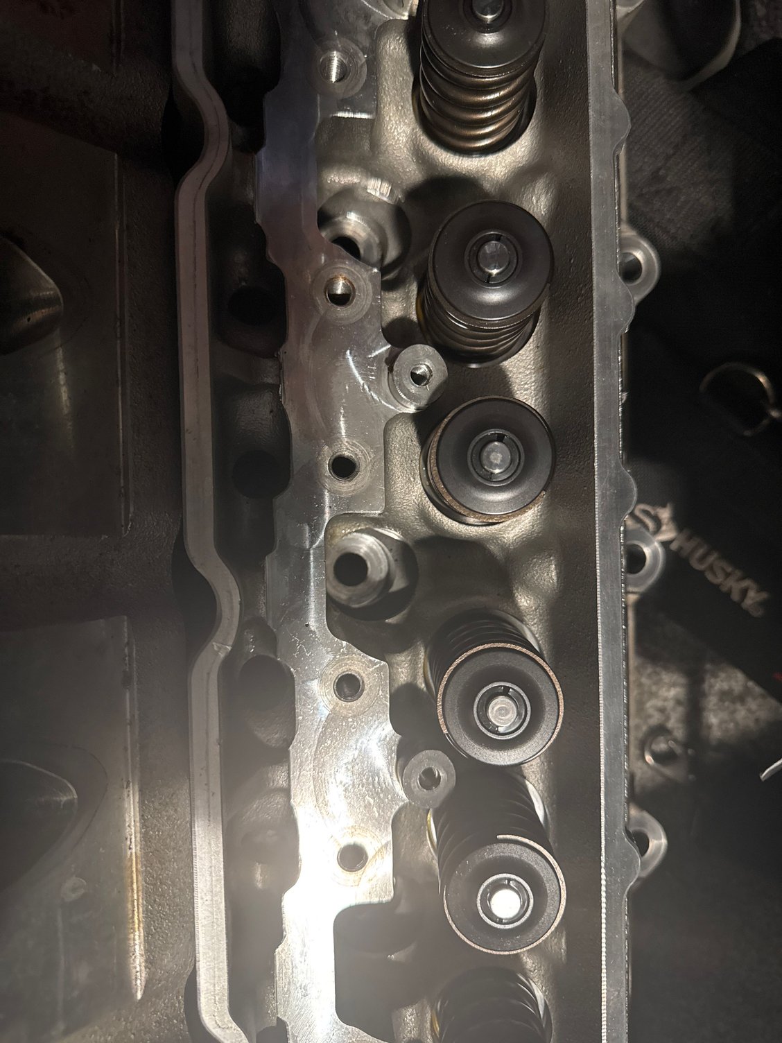

Do you have pictures of the tops of the valve stems, rockers, pushrods
are those powdered metal or bronze valve guides?
I also wonder about the length of the pushrods if they are all the same.

Pushrod lengths 7.500 in ls7 lifters with 85 thou preload on the low sides. Rockers were the sls17 Harland sharps which Trickflow recommends with the bronze guides. I wondered as well if the Pushrods were off because I have red that but they all measured same. I know they say calipers are to be used to measure length as the cup difference etc. but I was just measuring overall lengths.
