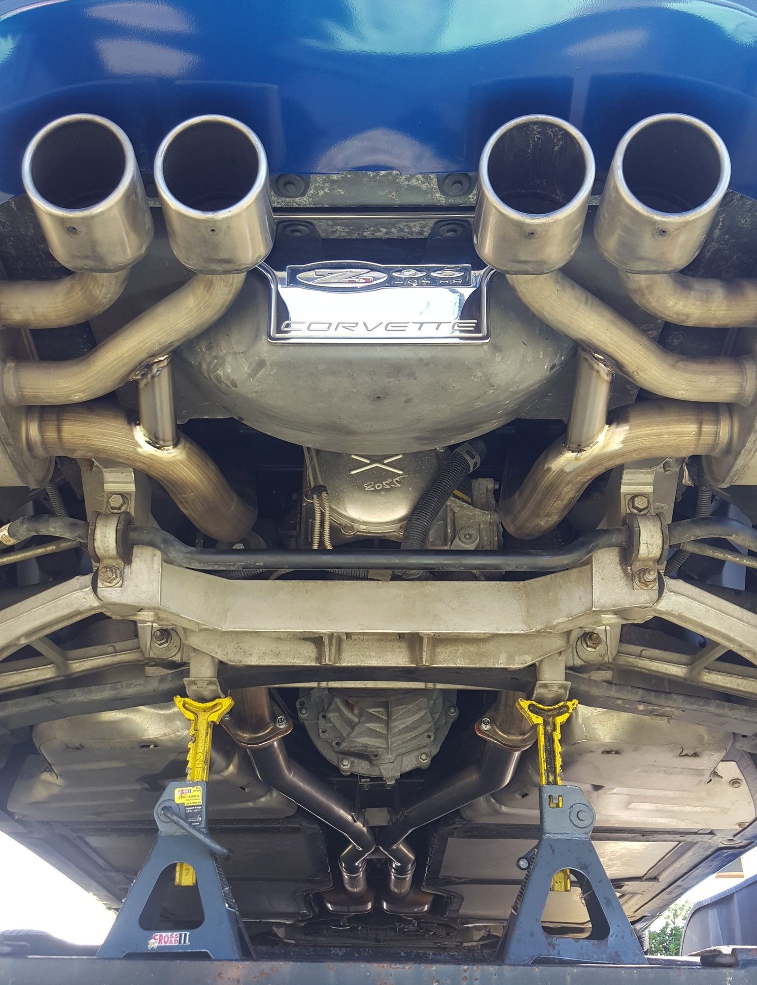

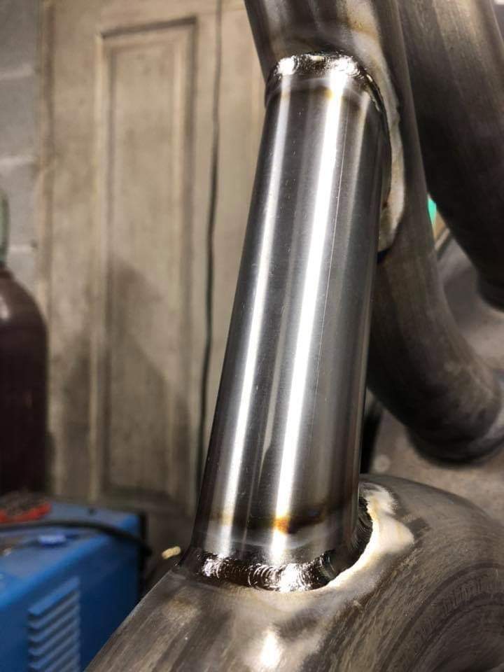

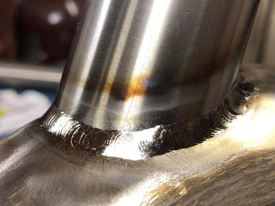

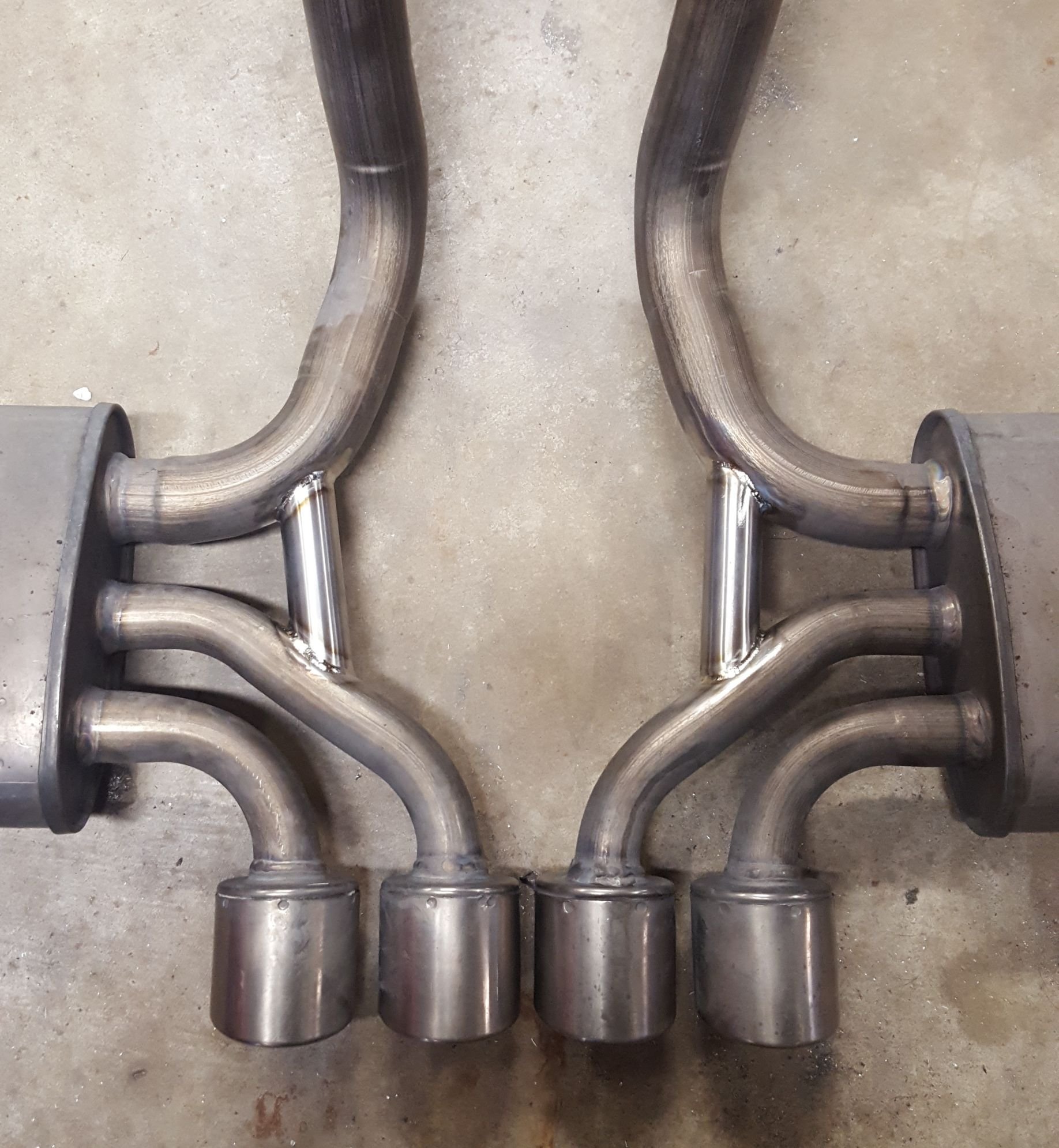

Local guy did my Ti Exhaust on my C5Z06, I wanted the 1.5" bypass welded in. I bought the tube and paid him for the time when he gave me the price. My welders at work can do the same we have the equipment for it and have done some. Just hard to sneak in the home projects on this scale..
Quality welds tho, stacked. I bolted them back up and been on the car since 2018. Added to the sound well. Posting pics because he did good.

Absolutely gorgeous work. A true artist. I can mig with the best of them. I own a tig that I’ve never turned on. That’s on my list for the spring.

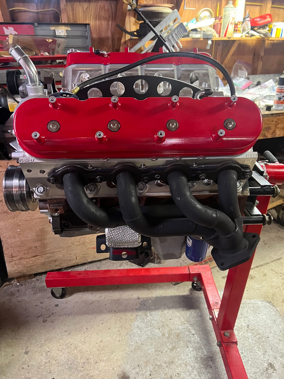

I’m curious of the other guy that posted in this thread what his issues were with trickflow. Ther a no recourse at this point with them blaming me. I told the guy I have days and days of data logs I would have seen if something was way out of whack or burning up. Let’s say I cleaned the heads up perfectly. Am I on the wrong track thinking it’s a seat issue that they sunk? Because I did some reading and if that exhaust valve was sticking open obviously would burn them up no?
I told the guy too it suck’s being limited to the roller rockers he said I could grind down a tab on the stock rocker mount. But the holes wouldn’t line up. Regardless they recommended the rollers because of the guides. I think btr puts the metal guides in these heads. And it’s crazy to me where they machined where the rockers sit, I could literally take burns of aluminum off with my fingertip. Can’t tell me that’s my fault too lol.
here’s a pic of when I was getting it in. No turbo no spray
