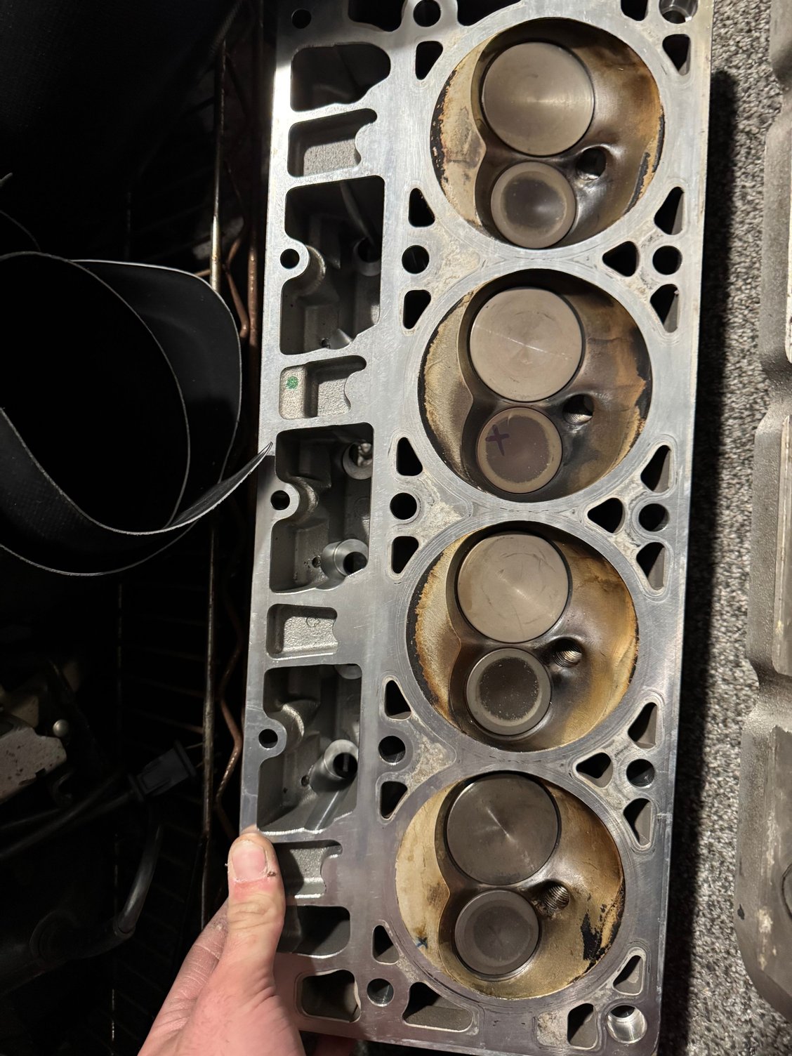

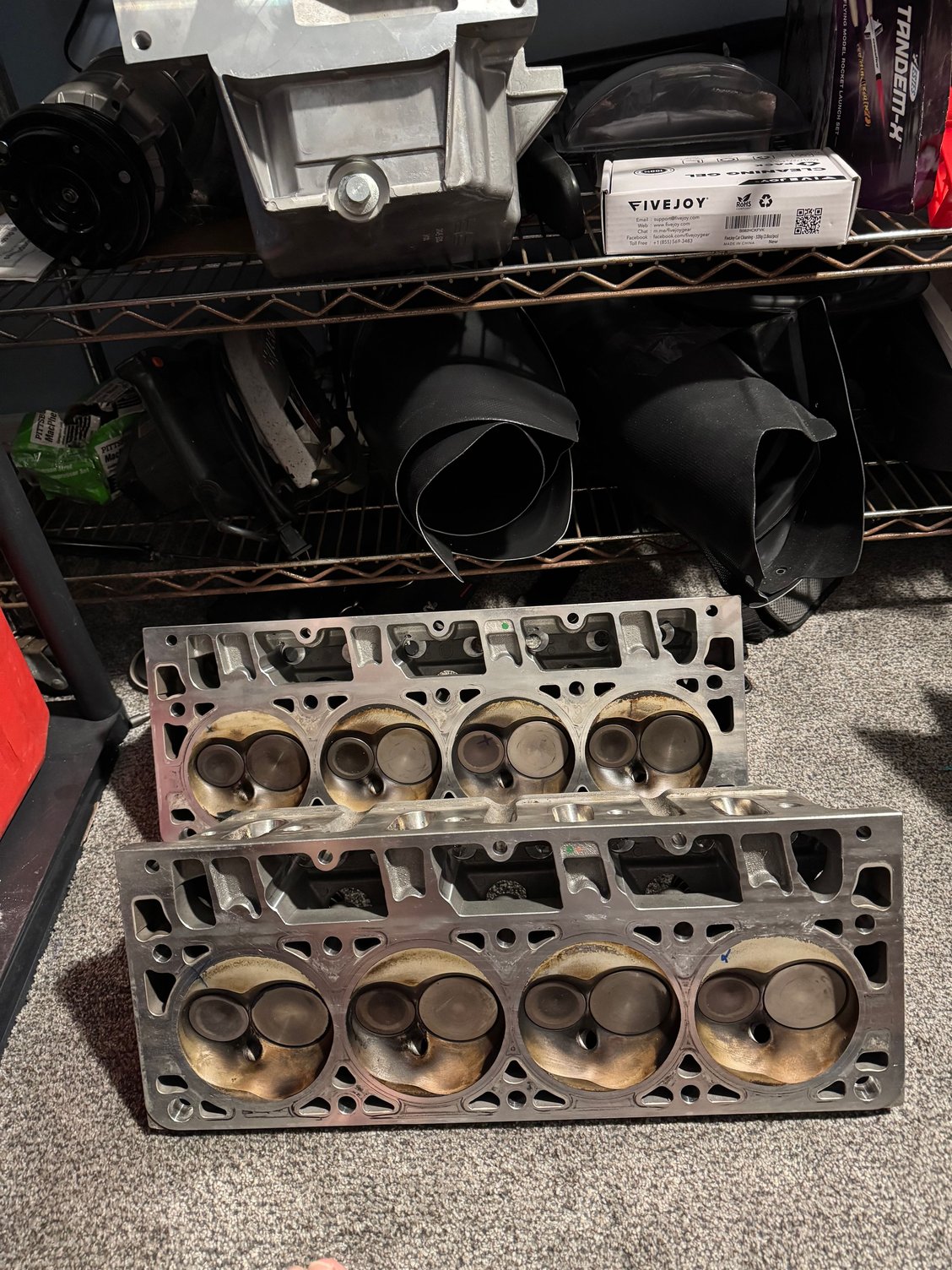

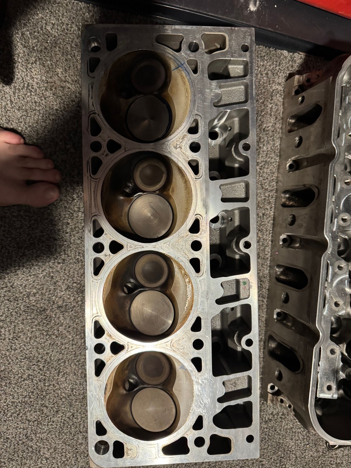

Well I’m assuming they are since the height difference. The numbers I got were just a few shops over the phone saying new seats and valves. Trickflow never sent a report just said the valves were burnt up needed new valves in a few areas. I’ll send the pics of which ones they marked

Too bad you don't have the tools to disassemble and take some measurements. You would then be able to measure the valves and determine if they're burned up and if you actually have worn out seats and excessive guide clearance. My guess is they gave a visual look at them and gave an opinion.

Well from what I've seen when ordering the Trick Flow valves the 2.00" intake valve length was 4.900" and the 1.6" exhaust valve length was 4.915 so that tells me the tops of those valves should line up or be within 0.015" of lining up. If the exhaust valves did get burned up to the point that the valve diameter was reduced then it would eventually sink further down into the valve seat which would cause the tops of the exhaust valves to sit higher then they should. You won't know any of this without pulling them apart and taking measurements.

And yes the valve seats could also be damaged but those can also be verified once you get the heads apart. Could be as easy as purchasing some new valves and lapping them in and you're up and running again. Won't know what you got until you get into them.

When the heads were finally returned to us, our engineering team, quality team, and engine builder/port developer very closely inspected and measured these heads. We found multiple bent valves (5 intake/6 exhaust), worn guides (bent valves destroy guides very quickly), and extremely accelerated exhaust seat wear with the exhaust valves sucked into the head about .040”. It was apparent that the exhaust seats had softened and deformed due to extremely high EGT’s (exhaust gas temperatures).
The only times we have seen our valve seats fail in this way is when EGT’s are elevated to 1600-1700° F for extended periods of time, which is not remotely close to a normal or acceptable operating condition. We use premium quality made in the USA CHE hardened ductile iron valve seats, selected for their excellent toughness (not brittle), machinability, durability, and wear properties. The material properties also reduce the potential for float due to less valve bounce off the seat. Our seats have been dyno durability tested, as well as street and track proven to be very durable - even on severe power adder racing applications.
How did the valves get bent? Why did the rocker arms fail twice? Why were the guides worn? Why were the exhaust seats melted on an NA street car?
Like anything, there are limitless opportunities for failures to happen, but here are a few of the most likely root causes we can determine without having the engine in our shop. Cam timing issues could cause excessive exhaust heat (a cam advanced too far could open the exhaust valves too early while combustion is still occurring). This could also cause piston to valve contact and bent valves, which would in turn cause rapid guide wear, and could cause premature rocker failure – all issues present on these heads. Bent valves don’t seal well, which would further allow combustion gasses to heat and soften the seats. We strongly recommend checking for correct cam timing and piston to valve clearance. Over-rich air fuel ratios can also cause excess EGT’s for extended periods due to unburnt fuel continuing to burn in the exhaust. Delayed ignition timing could also contribute to excessive EGT’s. An inexperienced tuner may think he has a safe tune with rich (safe) AFR’s, and conservative ignition timing, while he’s torching his exhaust valves and seats gradually over 10,000 miles due to the excessive EGT’s.
Our seat and guide bore tolerances are controlled to extremely tight tolerances during initial machining, and guides are later finish sized and 100% measured and gauge pin inspected for dimensional accuracy and straightness. Our valve jobs are performed on state of the art CNC newen equipment, boasting outstanding machining finish, concentricity, and consistent valve drops. A small degree of tip height variance is OK. We allow a maximum of .010” of valve tip height out of the box, which is actually pretty tight considering the tolerance stack up of the machining processes and components (valve lengths, valve margin, and valve drops). Our valve drops are measured during our valve job process, and controlled to very tight tolerances. We also closely monitor our valve job concentricity to very tight tolerances during our valve job process. All of these steps result in very consistent valve sealing right out of the box, as well as minimize guide and seat wear, contributing to exceptional performance, durability, and longevity of our cylinder heads.
