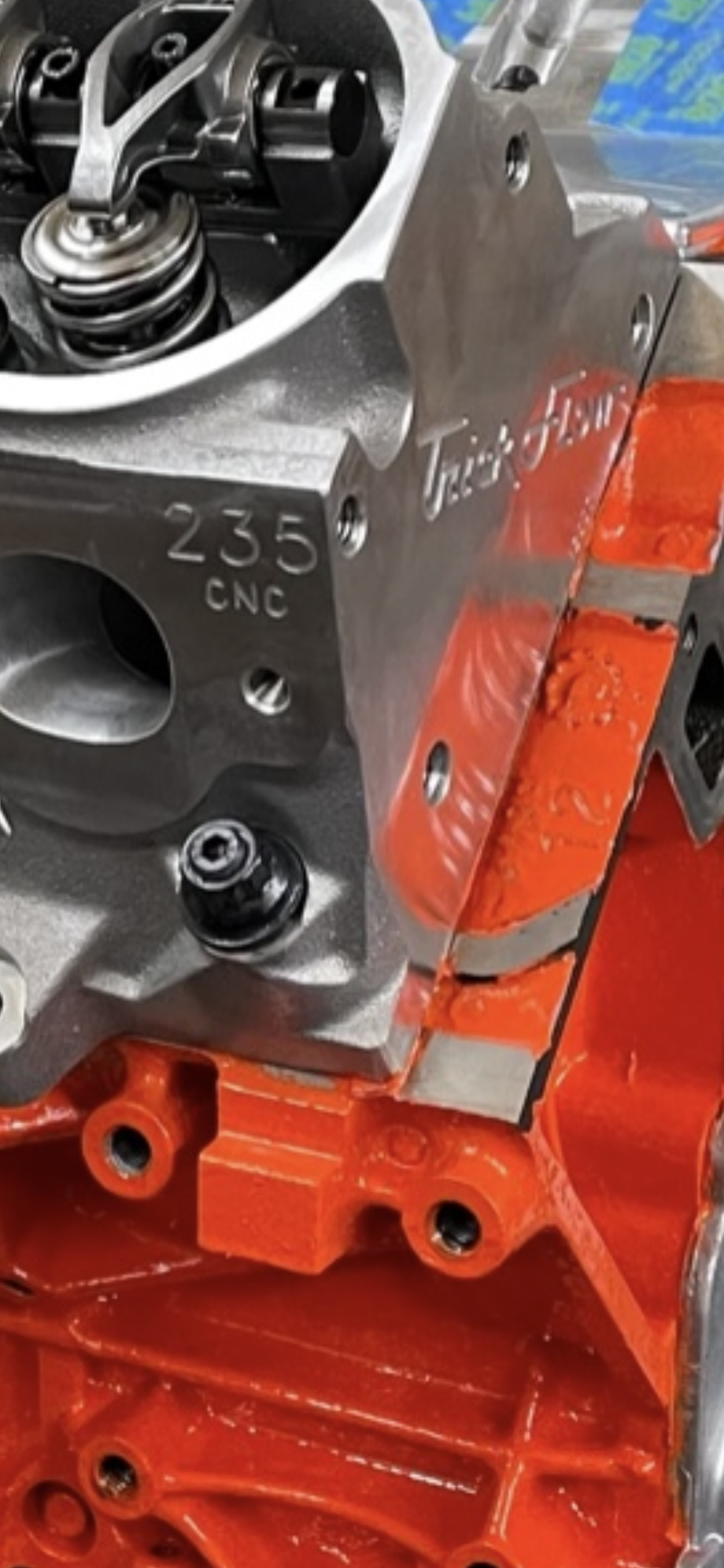

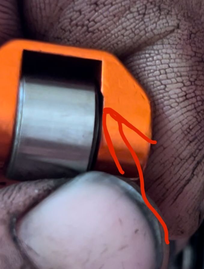

Here’s rocker you can see how they were potentially getting side loaded and pushed into the body cutting a groove

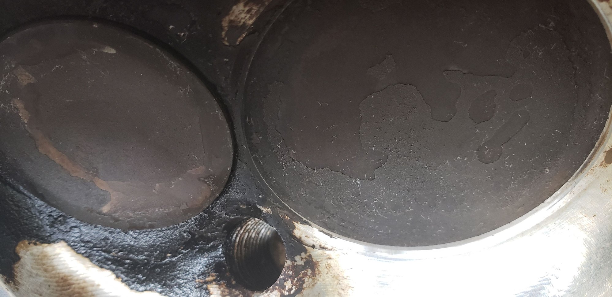

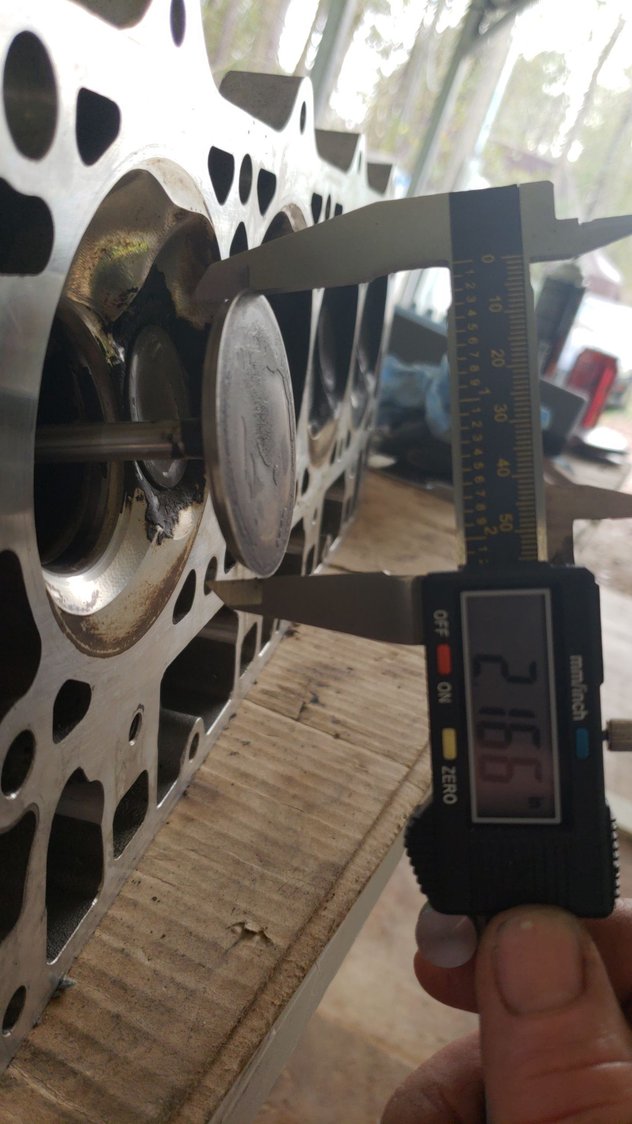

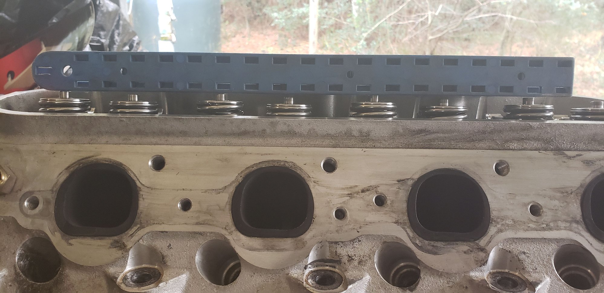

My gut tells me those intake and exhaust valves were not of equal height when those heads got assembled. How do you know the engine builder didn't swap the valves in your heads because he needed them for another build? It has happened because I'm living proof of this. Had an engine builder I trusted with some TSP PRC 265cc LS7 heads I had outfitted with Manley Ti intake valves and later found out he swapped them for some LS3 hollow stems and the tops of my valves looked similar to what you got going on there. I was blind to the fact at that time..Lessons learned!

My intake valves sat higher than the exhaust valves in my case.

Passing the blame is part of the game but I find it hard to believe that Trick Flow sent the heads out like that. I take it these are HS non-adjustable rocker arms and if the valves were set up that way you would have offset length pushrods for this engine.

Let’s say they were ten thou off from the jump would that only effect lifter preload ? Trickflow not once said they were different valves after I sent that in. All they said was I burnt the heads up and they needed a full rebuild. Is there a way to check if the dude did switch them? Guy that built it does a lot of older motors not a ton of LS stuff. How common would these valves be in another setup let’s say a small blocks set of heads?

That’s still crazy your builder would do that. I mean who knows nowadays with people. I just looked beyond the valves where there’s areas never deburred etc pissed they got slid across a bench enough to set some deep grooves. I mean at this point I have 2800$ chunks of useless metal lol

Gen x 225 heads I’m not sure honestly. Sucks would have been nice to keep on a motor. I’ve heard they flow great and everything I’m going to measure the valve heights again to see if they were swapped. To me it’s like new valves and seats don’t cost $1400 lol rather grab a set of prc 237 at that point

One other thing to keep in mind is that bronze valve guides do not like any kind of side loading or they wear out pretty fast. If you had side loading the guides may be shot as well.
